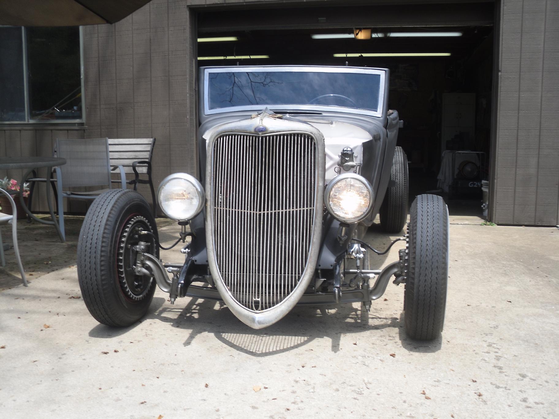

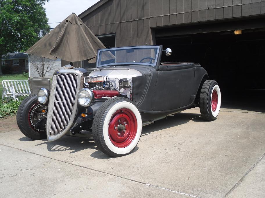

  3. The are 5.60x15 on typical 5x15" wheels. Everyone I know that has these tires uses the same wheels and seems to be no issues. Tim

  6. Ed: I may have been mistaken....my wheels very well might be 4 1/2" wide. I have a 5"x15" on the shelf but they are few and far between the way I understand it. My wheels came off an early 60's Ford pickup. They are fairly common (to me anyway), don't think it too hard to find them in the 4 1/2" width. The fours were all 16's I think. Someone will have a definitive answer for you.
