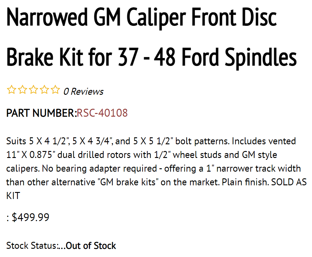

    Roadster Supply advertises a front disc brake kit for '37-'41 Ford spindles that states a track width 1" narrower than other disc conversion kits. They're showing "Out Of Stock" on their website and haven't replied my question about them or answered their phone. Does anyone know what they do differently to keep the track width more narrow than other kits from Speedway and others?
    I have the Speedway Metric caliper kit on the '37-41 spindles on a '33-'36 axle (50.5" kingpin centers) in my Model A coupe and my 185R-15 front tires are out quite far from the centerline crown of the front fenders.

    I have been looking at a number of these kits, including this one. Where i believe they pick up that 1" has something to do with item #1 in this speedway kit.
    Speedway indicates this to be a "bearing adapter" for the ford spindle.
    I will be following this thread to see if I learn more.

    The description says 1". I bet its 1/2" per side. I'm only guessing, but i bet Roadster Supply has created a race/bearing that fist the spindle directly and doesn't need that additional part.

    Since it says so in their add:
    "No bearing adapter required - offering a 1" narrower track width"

    I'd agree that it seems the bearing adapter not needed is where the difference in width might be, but the large diameter of the adapter is where the seal rides, if I remember correctly when I assembled Speedway's kit on my Model A. If the adapter is eliminated it seems there's no place left for the seal to ride? I'm still baffled.
    Both of Speedway's kits say in the details that they add 8 1/4" to the width from the spindle kingpin to the wheel mount surface. The example they give is a 48" axle ends up at 56 1/4" on either kit, but one uses Metric calipers and the other uses Intermediate calipers.
    https://www.speedwaymotors.com/1937...Brake-Kit-5-on-4-3-4-Metric-Caliper,2010.html (uses the cast brackets)
    and
    https://www.speedwaymotors.com/1937...ke-Kit-5-on-4-1-2-Metric-w-Spindle,468165.htm (uses brackets cut from plate steel)
    There is some other front brake kit that Speedway offers that says it widens the track width a bit, so is Roadster Supply maybe comparing to that kit? The one post above refers to the backspace and width of wheels and all I'm curious about is the wheel mount surface width. For some reason I seem to recall that Volare rotors make things wider than GM rotor-based kits.
    I guess a person could go to a 48" wide or even 46" wide axle to keep everything "tucked", but I'd like to know the details of what Roadster supply is claiming and comparing their kit to.

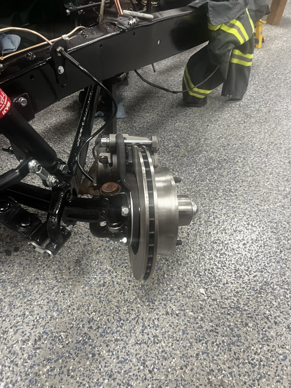

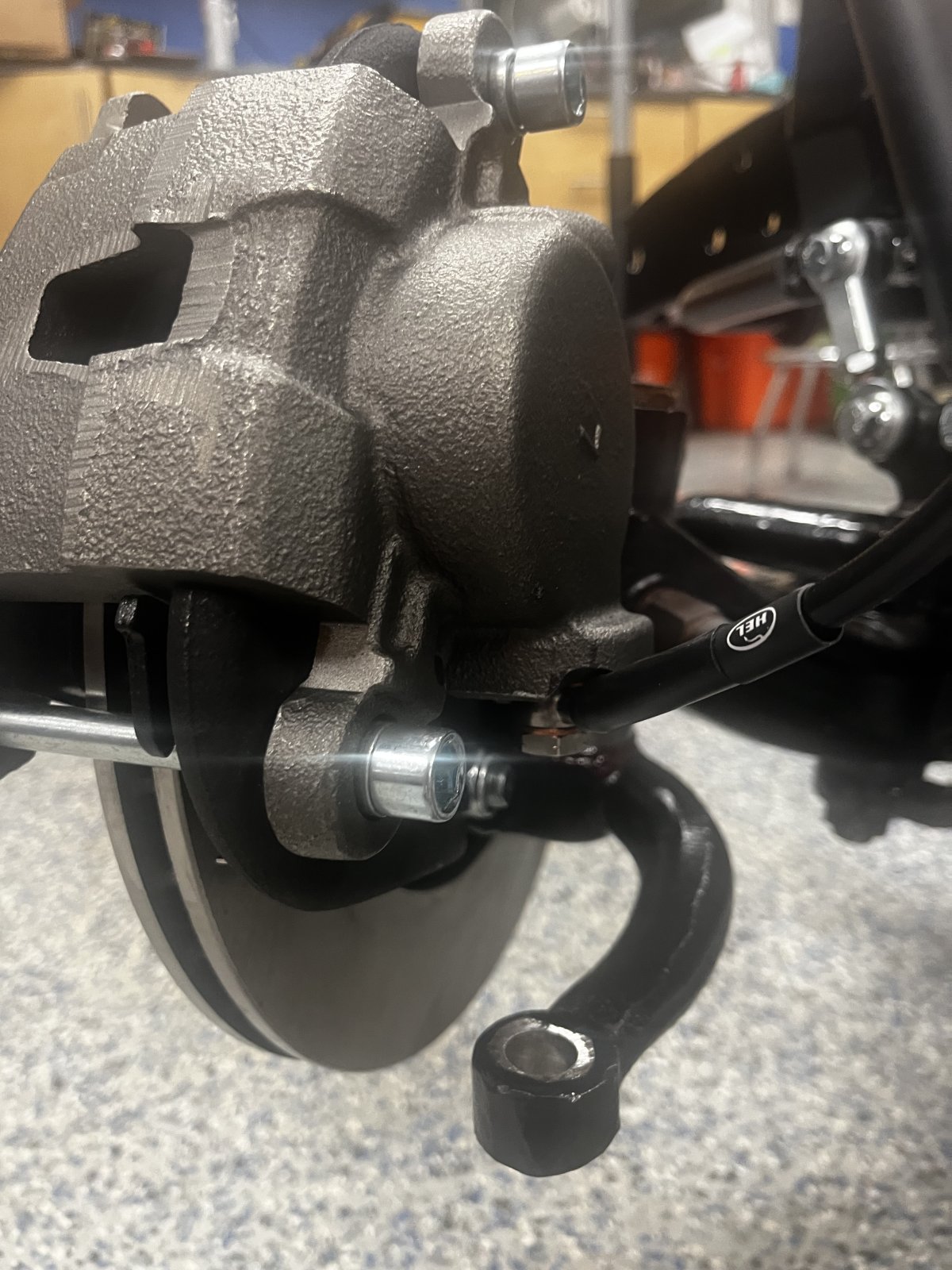

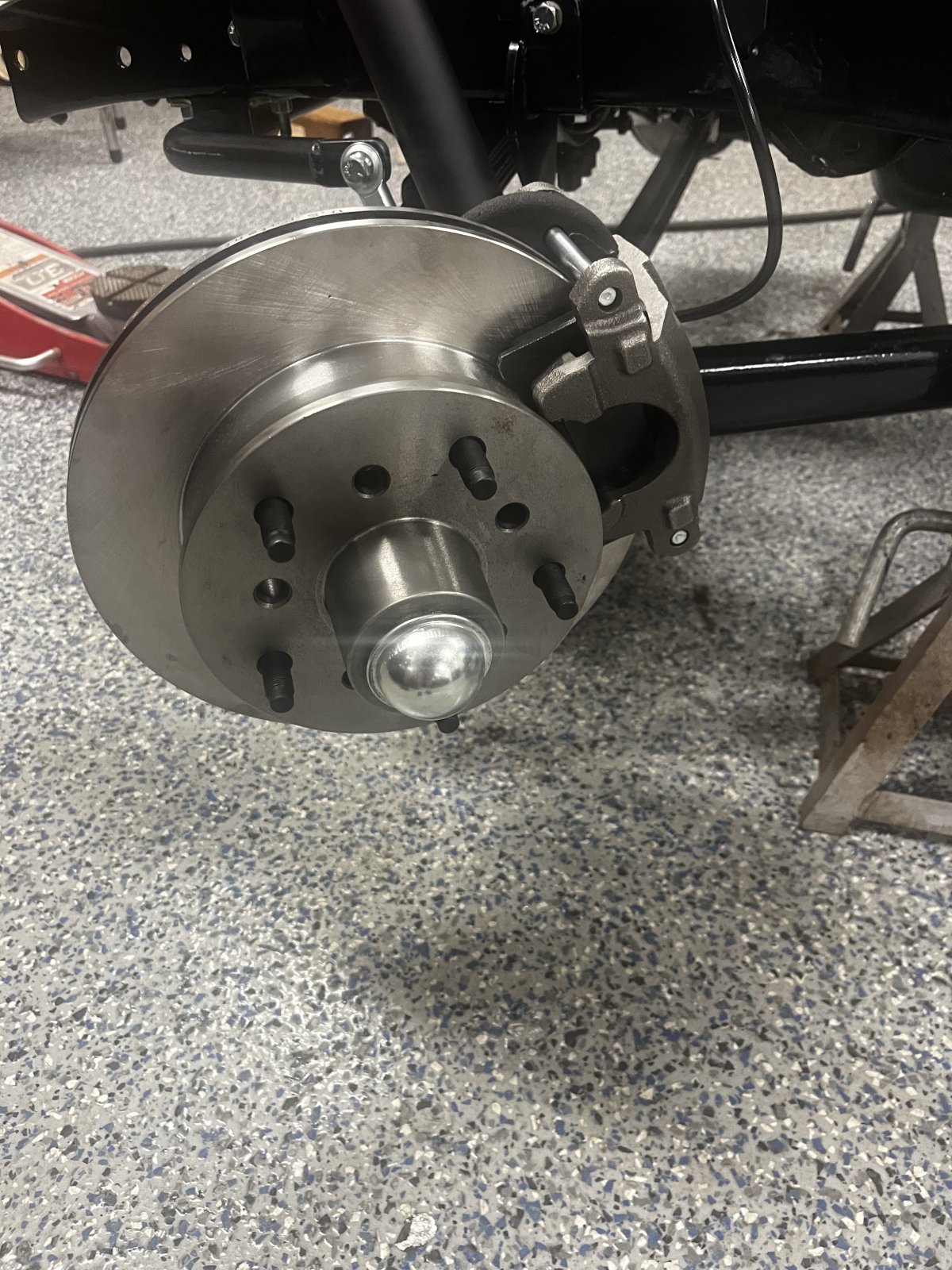

    Looks like I lucked out by ordering a kit a few months ago. I just installed the kit this weekend. They do not use any bearing adapters. The bearing is sized correctly for the spindle. I wanted to keep the 5x5 wheel lugs to use the original wheels. I’m thinking the rotors must be a custom part they have made.
    No complaints about their kit everything looked like good quality and fit. To get the banjo fitting to exit in the right direction I just filed down the calliper casting to get it pointed in the right direction.
    I measured the track width and ended up about 58” to the wheel mounting surfaces I seem to have lost my measurement but I seem to remember 57.5”. I think the claim is narrower than the competitions kit.
