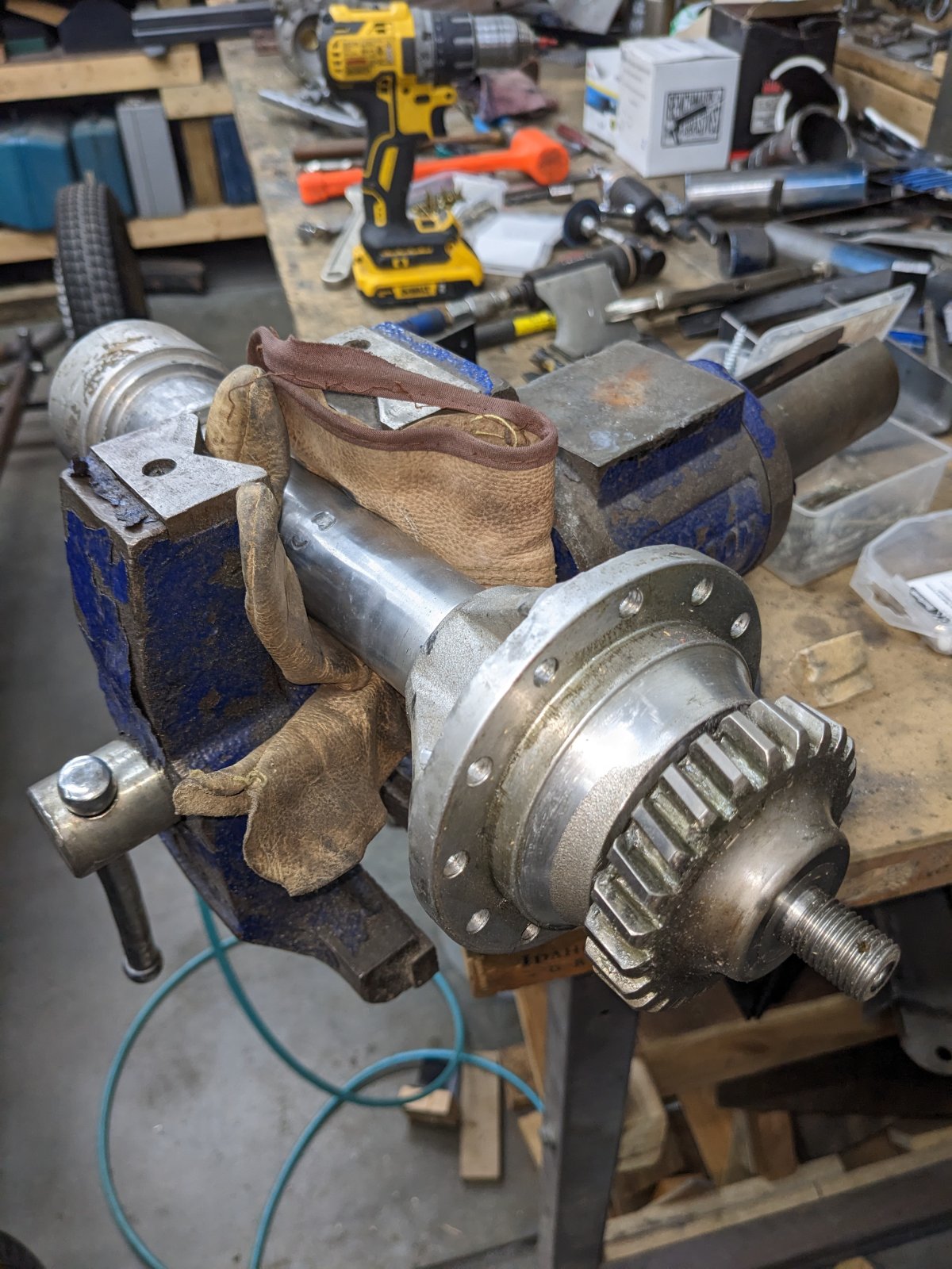

    I'm trying to see if it's feasible to narrow a Schroeder Steering Box. Now before anyone gets going on this, I'm not referring to the pitman arm, I'm talking about the steering box / housing.
    I picked up a Schroeder box with what I had thought to be the accurate width but after mock up I'm about 2-1/2" too wide from the end of the pitman arm splined end to the center of the steering shaft (column) centerline.
    I've spent the afternoon running through previous posts on the HAMB trying to track this down and have come up with nothing. That makes me think either I'm a fool for trying or it's not possible.
    Any input would be helpful, even tips on dis***embling the business side of the box (tube with the steering shaft from pitman arm to steering gear)...
    Below are a few photos of what I'm working with. What I've gathered is the pitman arm side has a roller bearing nested in the end aluminum cup which the shaft rides on. The other (drive side) has the steering splined steering gear pressed onto the shaft.
    Next steps is I'll try and press the gear off in an attempt to be able to slide the ***embly apart.
    Forgive the delay of photos, haven't posted for awhile....

    Posts: 617
    Xman
    I've run a couple but never had one apart. These were and I think are still being used by the circle track boys. Try to get ahold of them and see if they can advise.

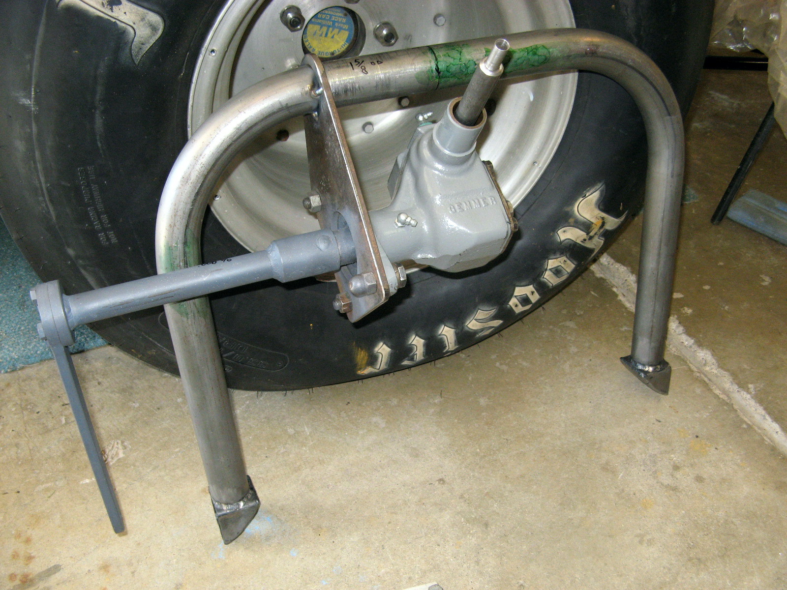

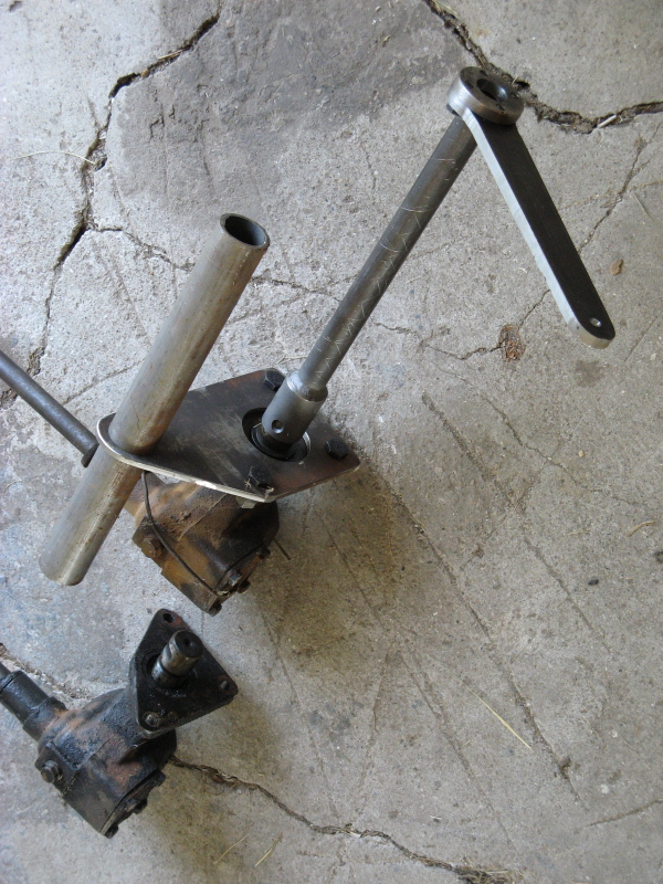

    I faced a similar problem using a Gemmer box for cowl steering. I cut the original, welded and plug welded a sleeve on the joint. Of course I can never dis***emble it - I'd just modify another Gemmer (F100) box if I ever needed to replace it. Not so easy with a Schroeder ($$$) but do-able.
    tractorguy likes this.

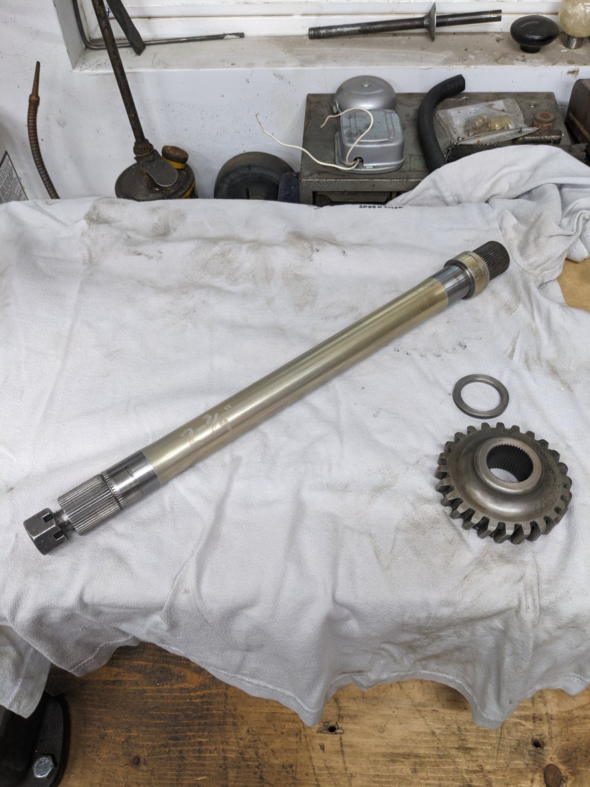

    Success! Made some progress tonight...
    Worked slow and finally got the splined gear to pop off with a bearing remover and patience. Once the gear was removed the shaft ***embly slid out towards the pitman arm side. Next up is removing bearings...then on the tubing.
    It does appear the aluminum tube is just pressed into the cast aluminum end caps so that'll be the next hurdle, getting them apart to remove about 2-3/4" total width from this side of the ***embly.

    oldsboy
    Thanks for the info Potvin. I'll send you a DM about the box, I'm curious about how the width differs between a Model A and Model T roadster.
    I'm going to try to press one end off the aluminum tube housing with a press and a little heat on the collar and hopefully get them to separate. Your info gives me hope...
