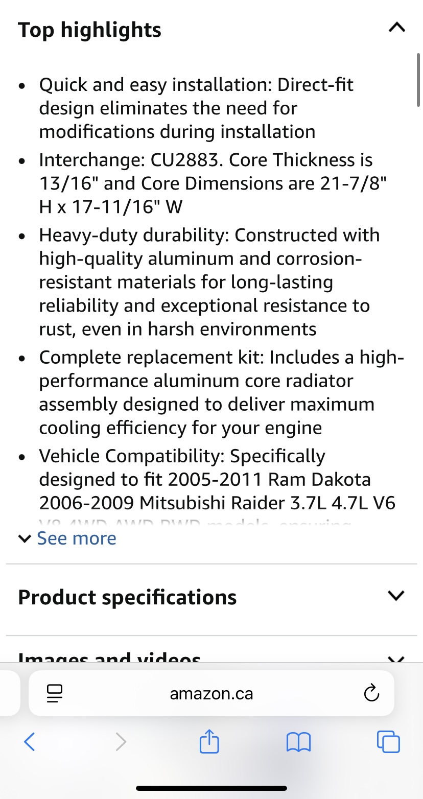

    I’m using a rear mounted rad in my speedster build from a Dodge Dakota. Probably is slightly too big for what you need, but it is way bigger in terms of cooling capacity than what I’ll ever need for my mostly stk flathead.
    Core dims - 21 7/8” H x 17 11/16” wide
    https://www.amazon.ca/dp/B08FBJ3QQ5/?tag=atomicindus04-20
