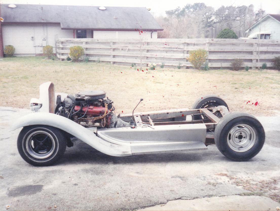

    this is my 51 chevy coupe. I used truck arms.

  11. chopstix
    Joined: Oct 28, 2005
    Posts: 91
    chopstix
    here it is . these brackets are from chevy truck too.
    I got the truck arms from junk yard for $20 each .
  12. Slide
    Joined: May 11, 2004
    Posts: 3,021
    Slide
    Thanks chopstix! Mine's a little different than that, but similar concept.
