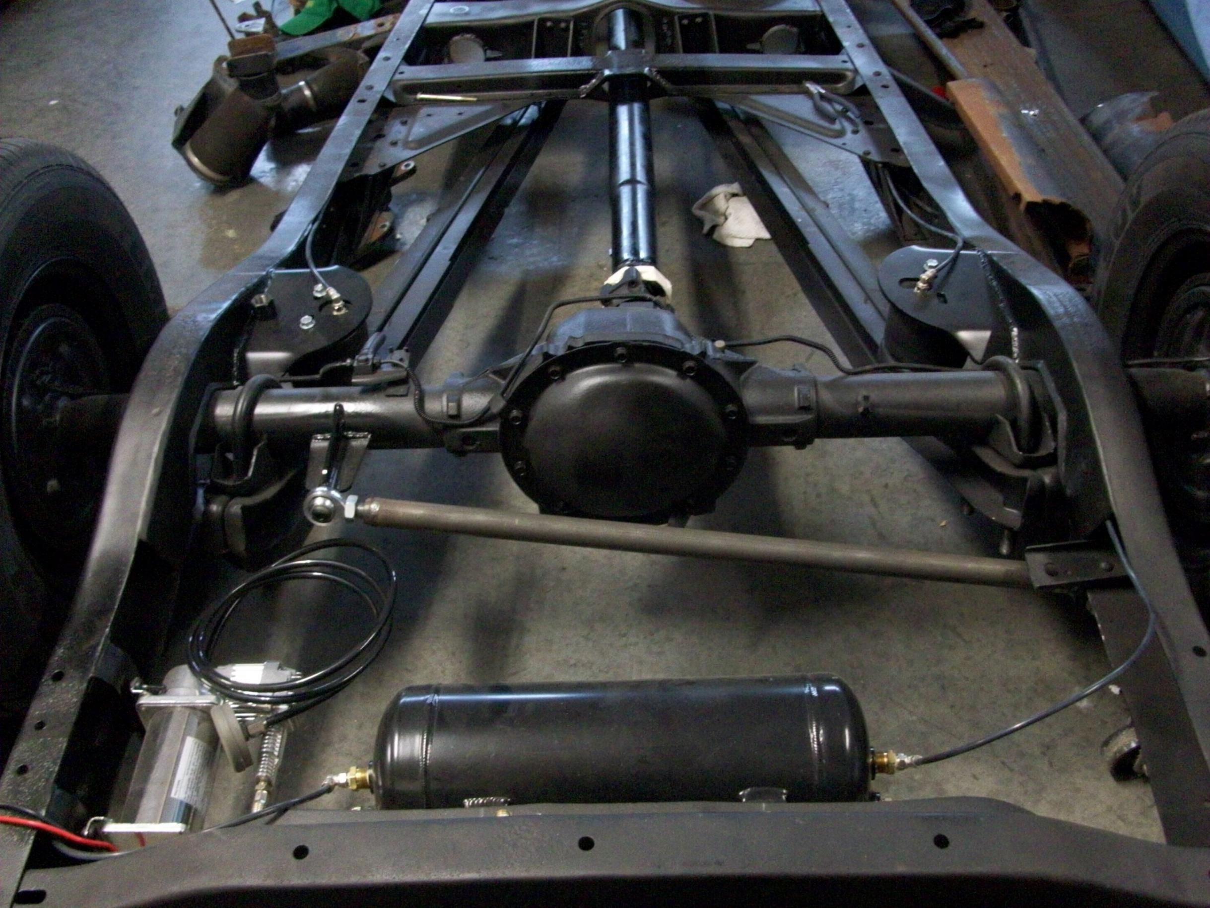

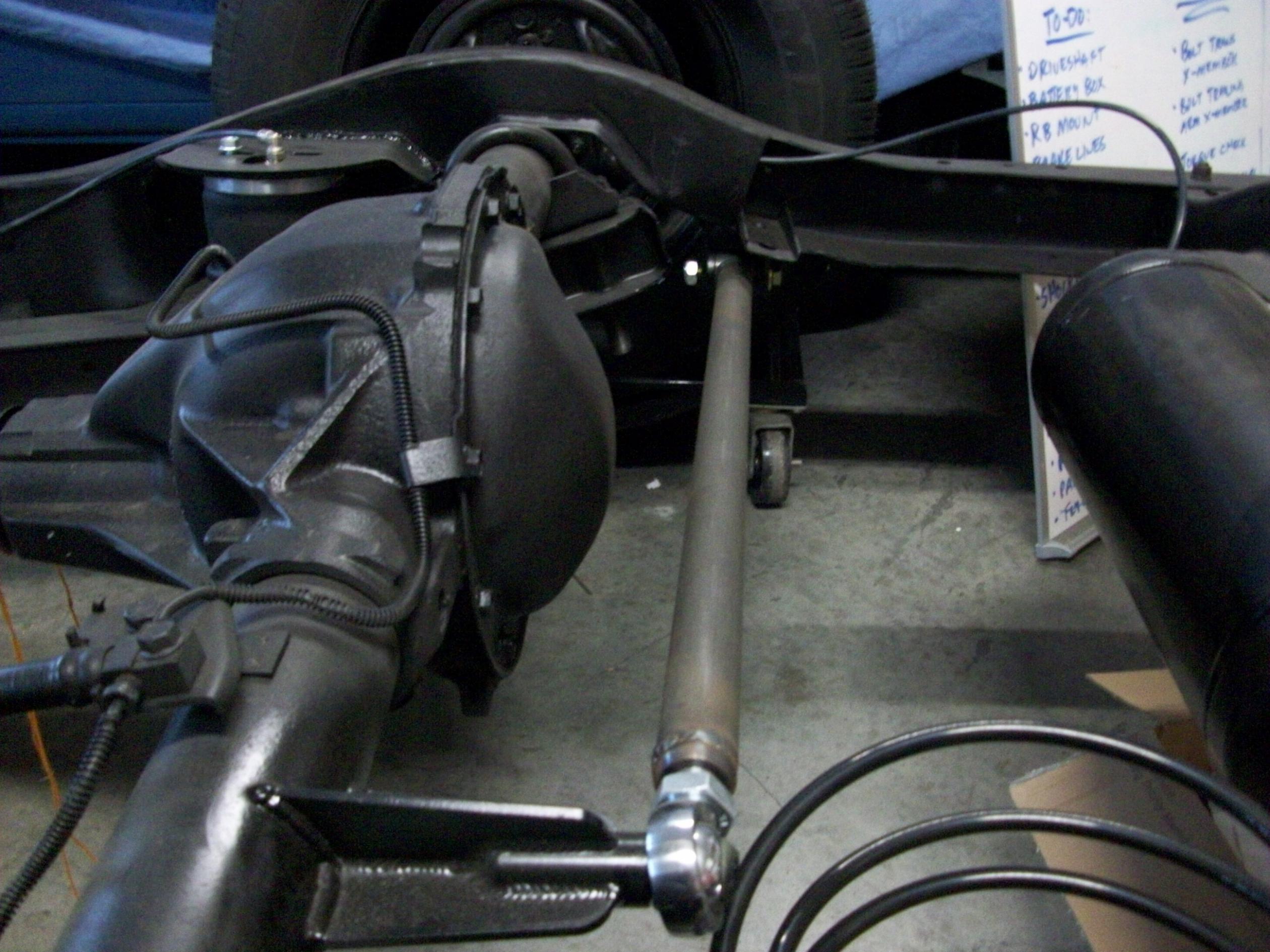

    Some update pics. The crossmember took maybe an hour to fab, I cut the ends off flush with the inside of the frame and welded on some heavy c-channel that slips into the frame, which will be bolted for ease of removal in the future. I tweaked the arms inboard a bit for locating the bag mounts and so the u-bolts would clear the c-notch and I could go lower. I used a universal panhard from suicidedoors.com and located it to be parallel / square at ride height. From full extension to full drop the arc moves the rear maybe 1/2" side to side. In the range I'll actually be using the suspension it's less than 1/4". Only thing left to do is mount the shocks, set the pinion angle and weld the axle brackets for good. And I agree with Harley Man on the exhaust, that's why I'm going to be dumping it before the axle.

    Just went out and checked... the centerline of my arm bolts are located about 5" down from the top of the frame or roughly within 1/2" of the bottom of the frame as you suggested, this mirrors the stock geometry closely.

    This is the same as my '71 swb frame:
