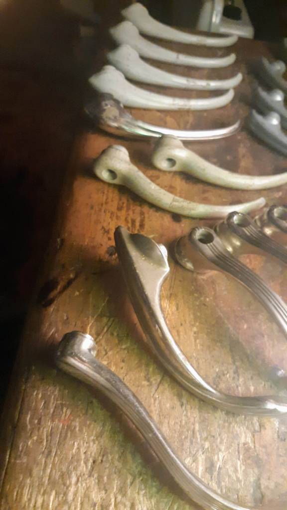

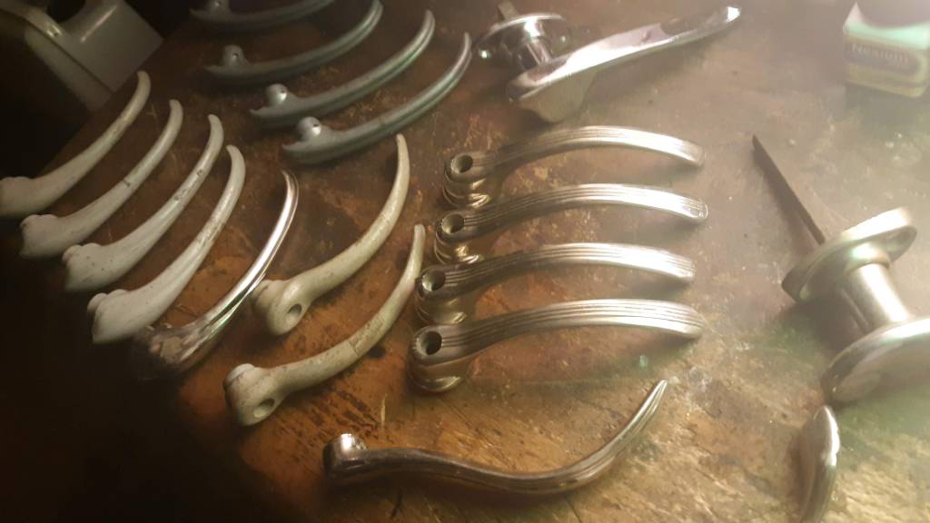

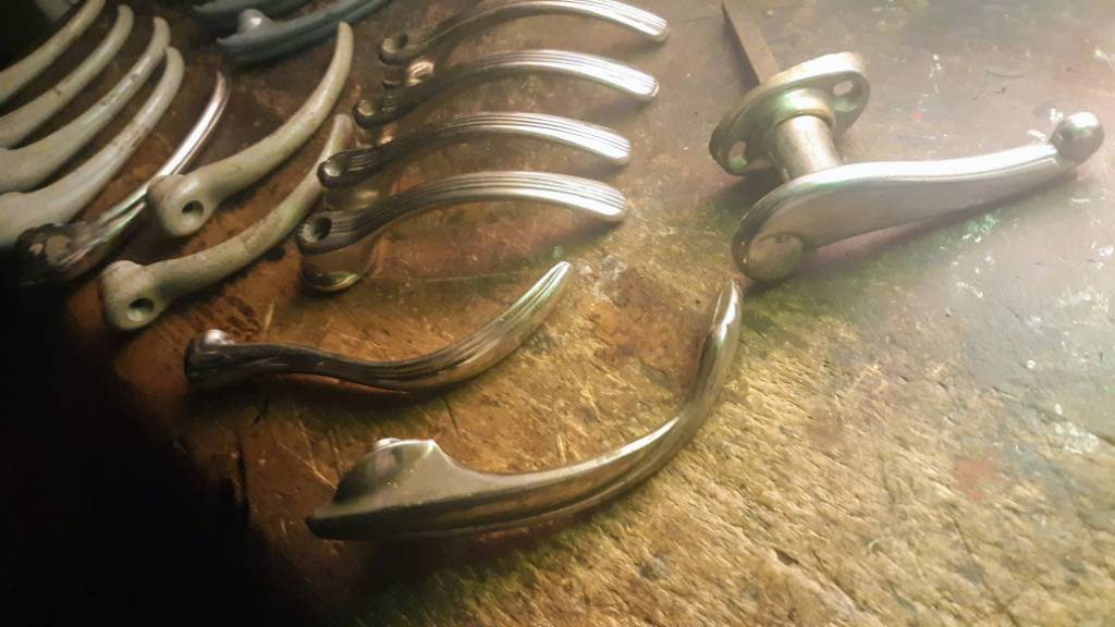

    Damn...I thought I could help on this one....no problem.?..well problem, everyone one of these are square holes. Sorry
    Now I remember back in the early years trying to put a square peg in a round hole ....a splined peg in a square hole?
    20201230_012911~2.jpeg 20201230_012918~2.jpeg 20201230_013021.jpeg 20201230_013015~2.jpeg
