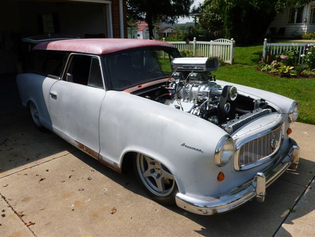

    Almost done took it out of the garage for its first drive image.jpg image.jpg image.jpg
