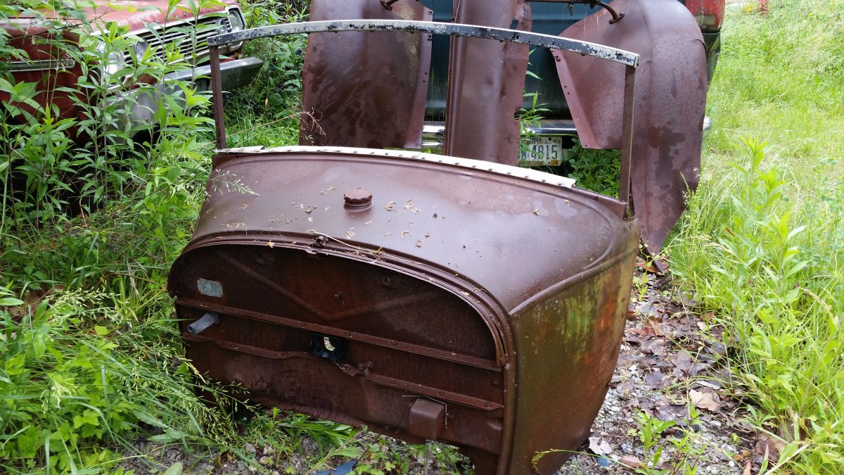

  2. Paid 50 bucks for this pile. Axles are good. Sheet metal is trash. Tank is only ok for a topper. 20200527_134916.jpg

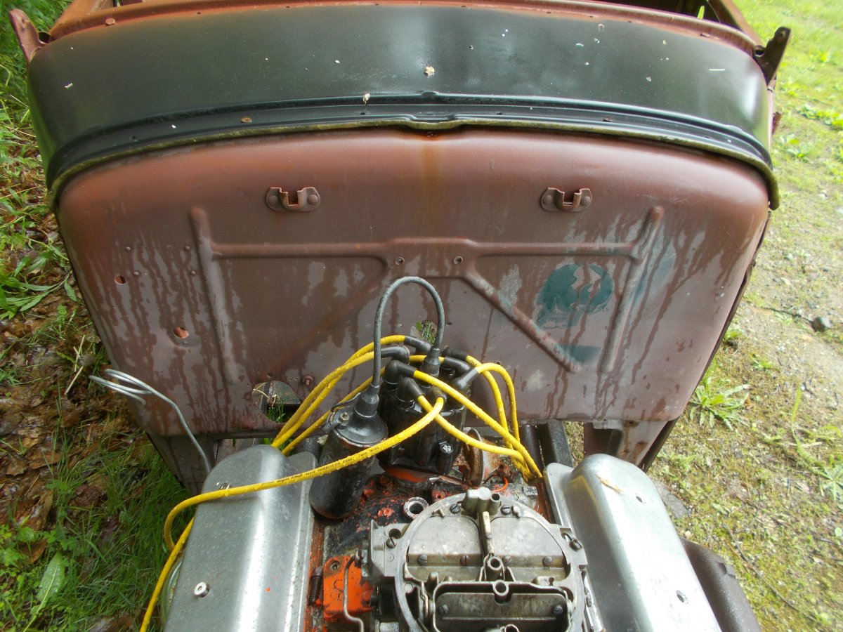

    Model A cut down, parts scrounger's view ;
    Left w/s post will help some one out... $25- up.
    the firewall needs water hose size holes filled...
    but not 3" hot air craters... reversible raw material... $50-up.
    hydrolic brake closed drive shaft banjo...$150-up.
    the filler panel [betwwen the w/s frame and the tank] were $125 re-pop...
    if still out there... more money for gl*** ?
    front pick up truck spring... A axle... $ Gas and lunch money...

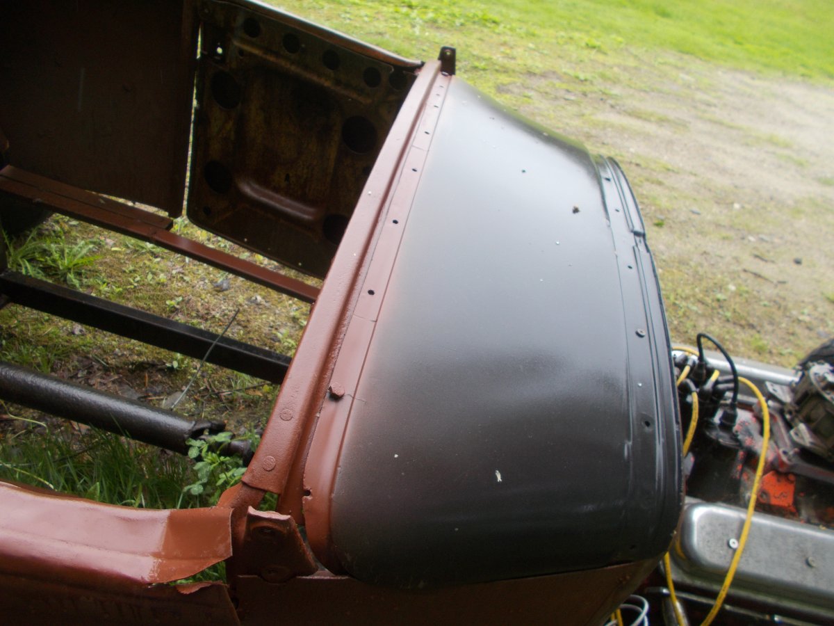

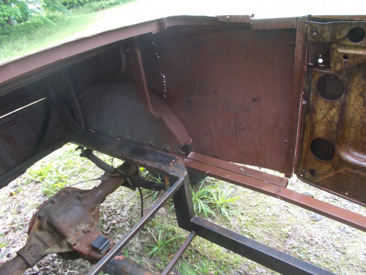

  10. sloppy jalopies
    Joined: Jun 29, 2015
    Posts: 5,256
    sloppy jalopies

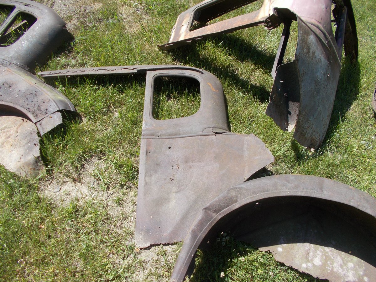

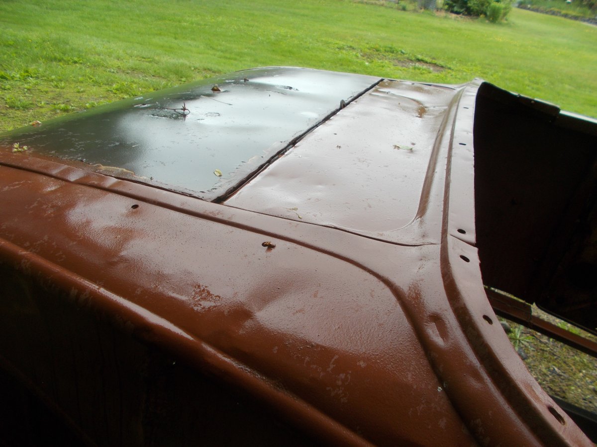

    Sheetmetal looks familiar...
    note the sharp bend just under the window...
    steel skin on a wooden inner door, thicker B jam post...
    Murray Ford... front half of the next coupester/truckster…

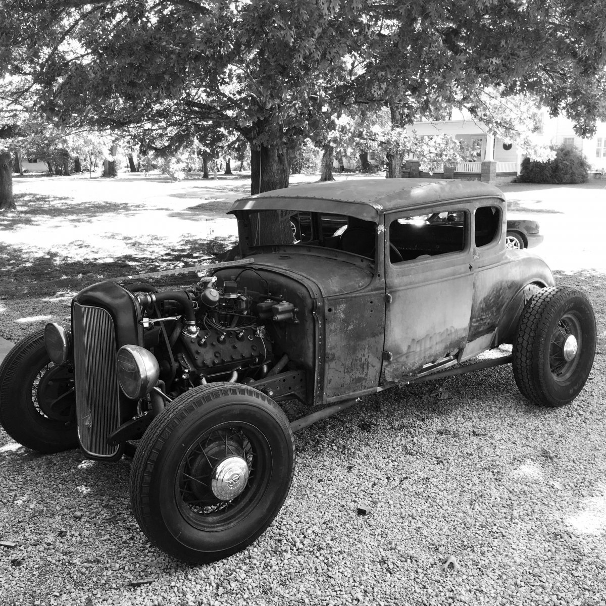

    There was so little left of this one that two old men picked it up by hand and put it on a trailer to bring it home. Quarter panels were flopping in the wind. It will not win though. Might be a strong contender for worst parts that got put back on the road. ?

    I still think there are more Model A's out in middle America than here. I think Doug Hines Coupe is just right!

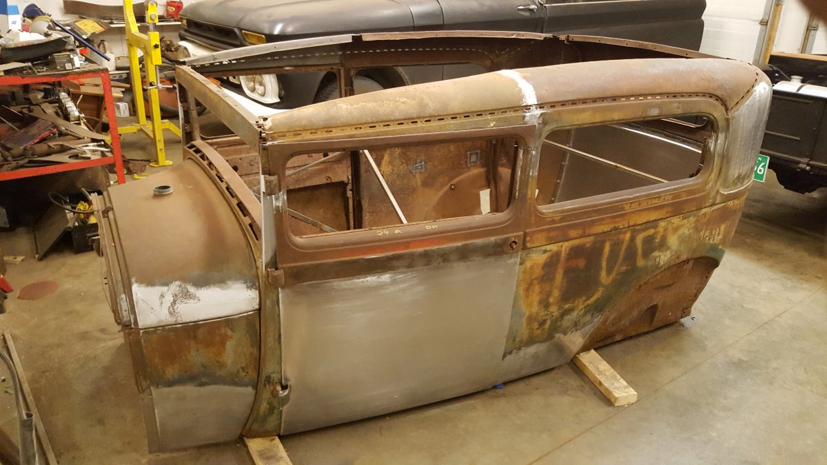

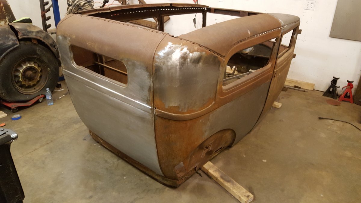

    This sedan I salvaged a few years ago looks mint compared to what others have posted. It had a butchered chop, no rear panel, no doors and lots of rust. I kinda pieced it back together and sold it...not sure if it ever got finished 20160807_090612.jpg 20161109_194805.jpg 20161109_194727.jpg

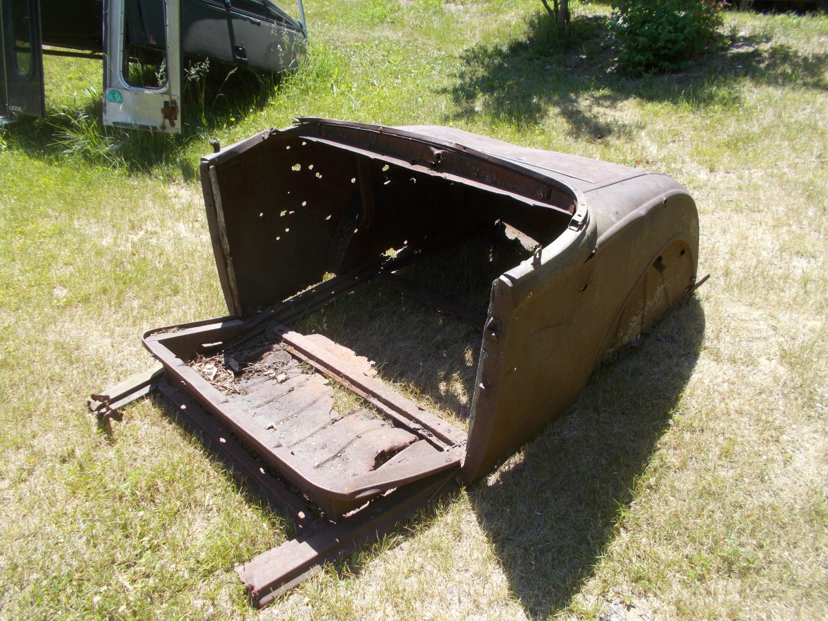

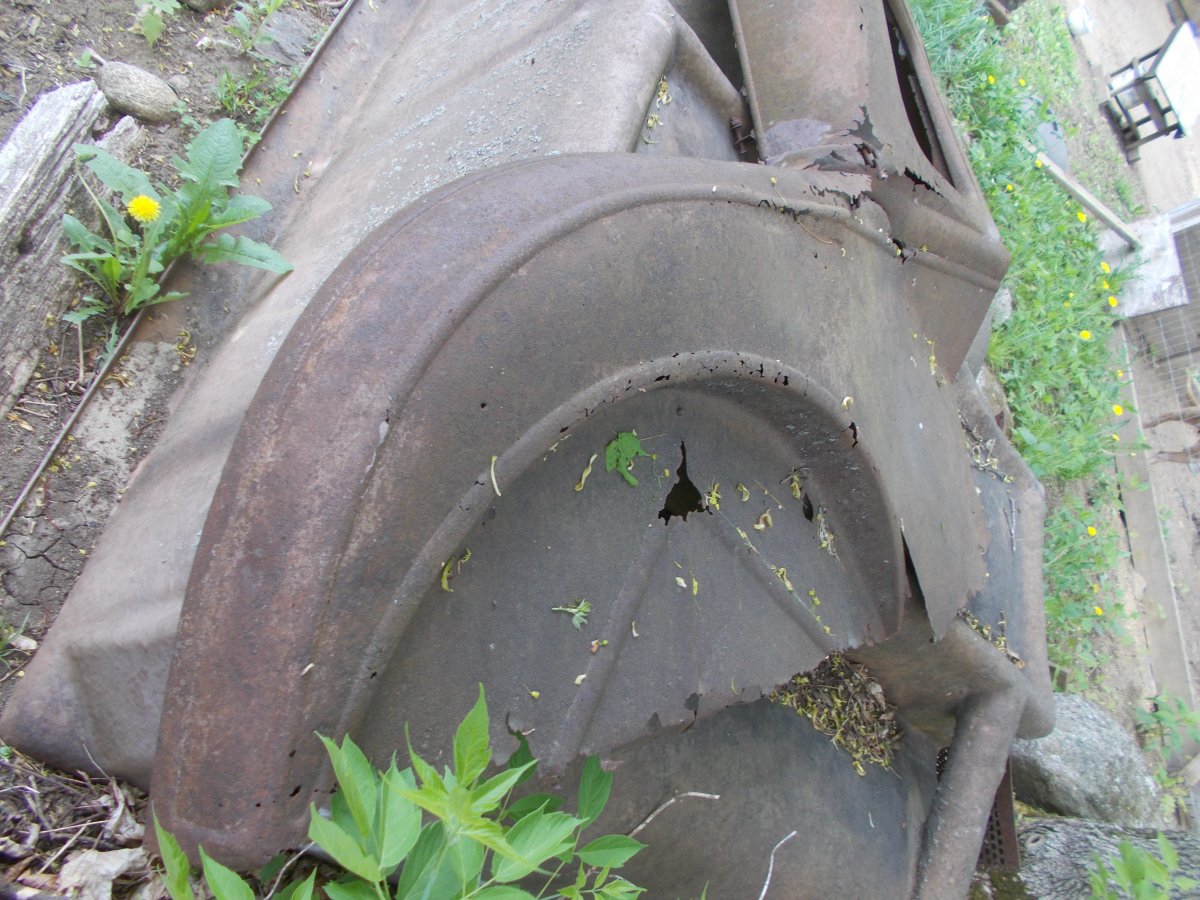

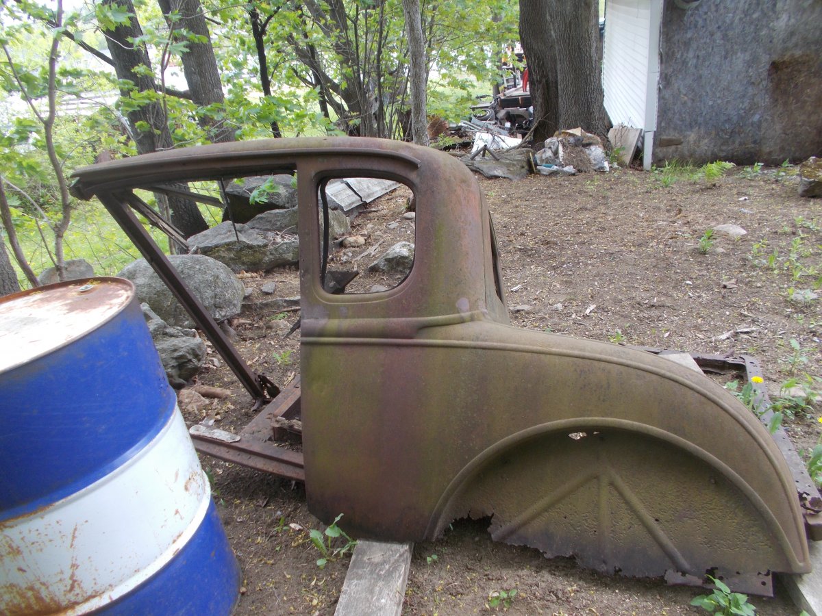

    not to my house, but I went and looked...
    wore a mask, should have brought a barf bag...
    there are parts I could use but need to be cheap, real cheap... DSCN6554.JPG
