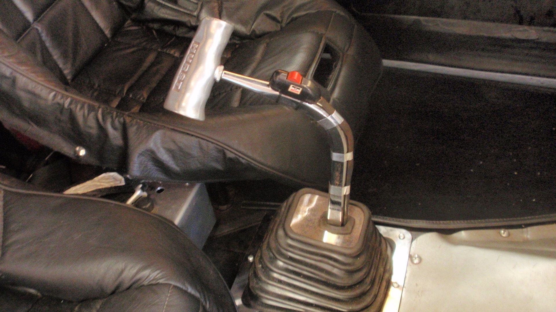

  21. Line Loc test!.....yep she's running again,now with brakes on all corners and a locked rear end. The line loc works good but not much smoke, it got traction pretty quickly. I'm out of practice.
    The Airheart brakes work great, the rotors are MG that were machined to work on the Willys spindles with new inner bearings. Brackets are home made.
    We ended up using the Mallory dual life. One reason being I have spare parts for it , cap, rotor, points, condenser. It still has a miss when you get on it but we decided that it's floating the valves, the revs just come up quick due to the 5.57 gears. Next Saturday we will put in a set of triple valve springs I have and some roller rockers that Perry has.
    Some roll bar padding so I don't bonk my noggin too hard in the big wreck.
    I'm trading my friend Greg for this Aluminum 55-57 Chevy radiator. Any weight off the front is good in a car like this and once painted black it looks the same as the stock one I was running.
    I have done a little fine tuning on the T shirts and they will be 2 color ink and have a small logo on the front. The color of the shirt is sand. Big thanks's to the guys who have already placed orders!
