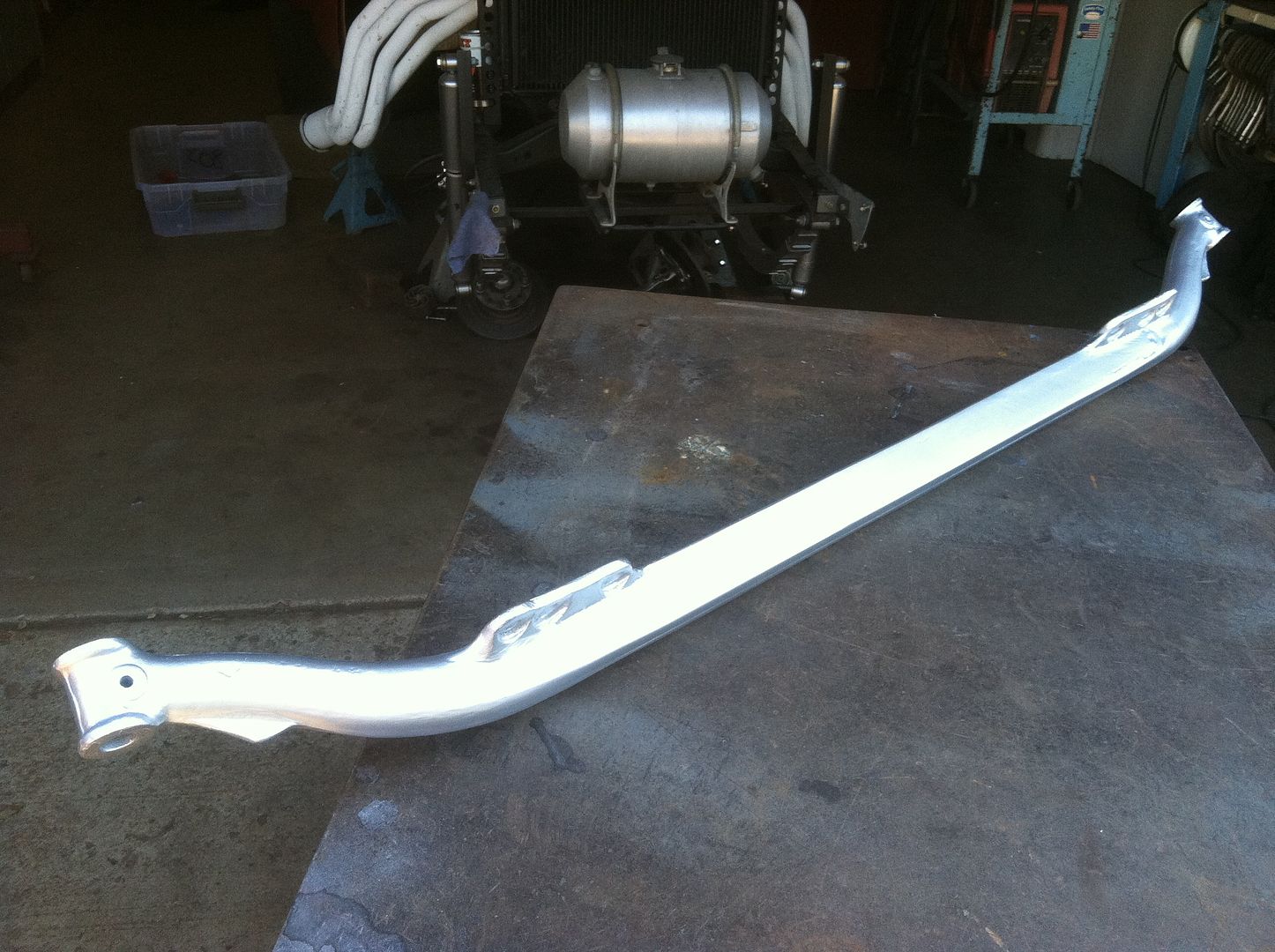

    To stop my bending axle problem I decided to use an undrilled stock Willys axle and box the back side of the I beam. It still looks normal from the front but a lot stronger. I cut some 3/16 plate to shape and mig welded it in.

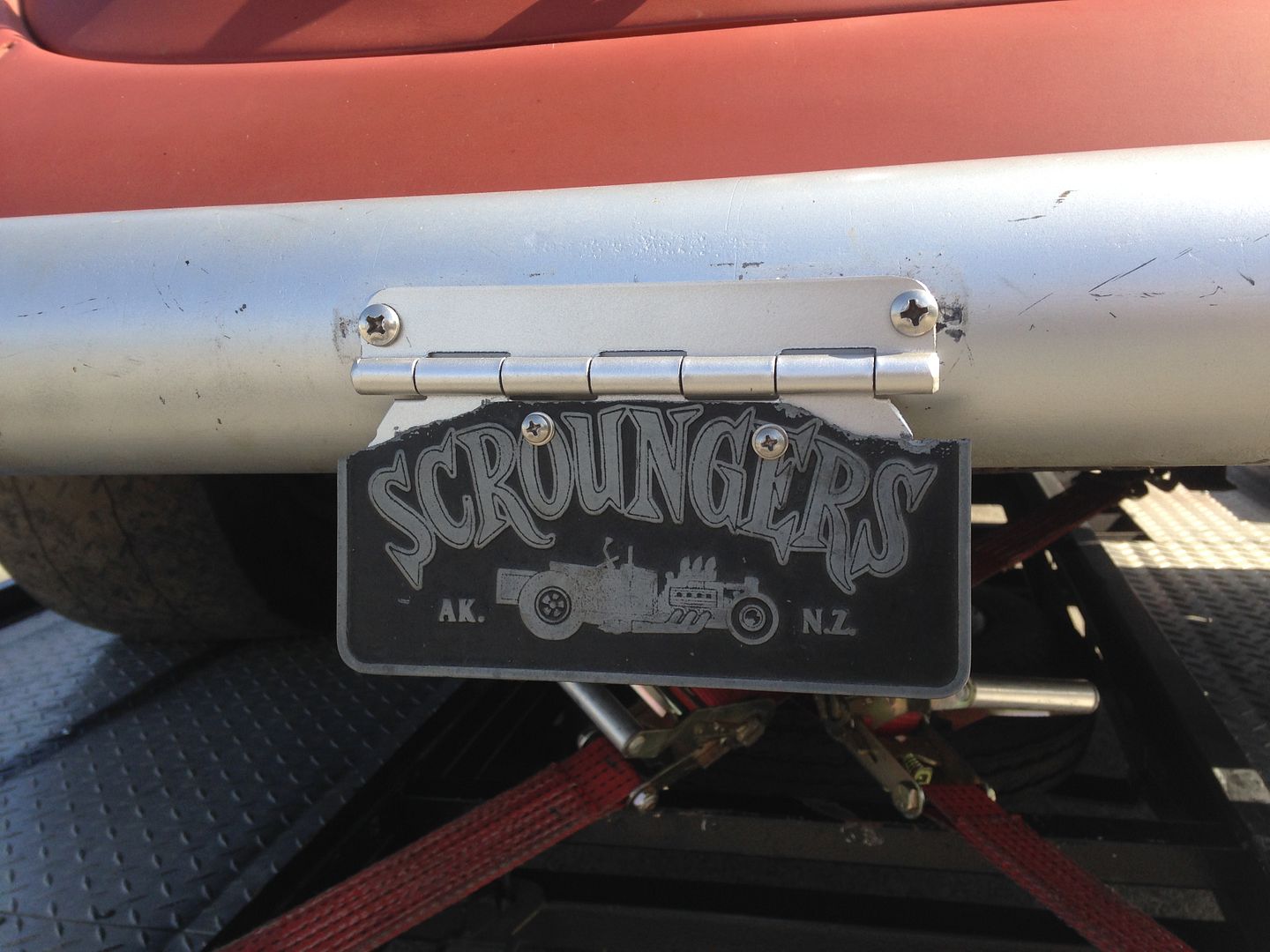

    I also put the club plaque back on, this time with a hinge.

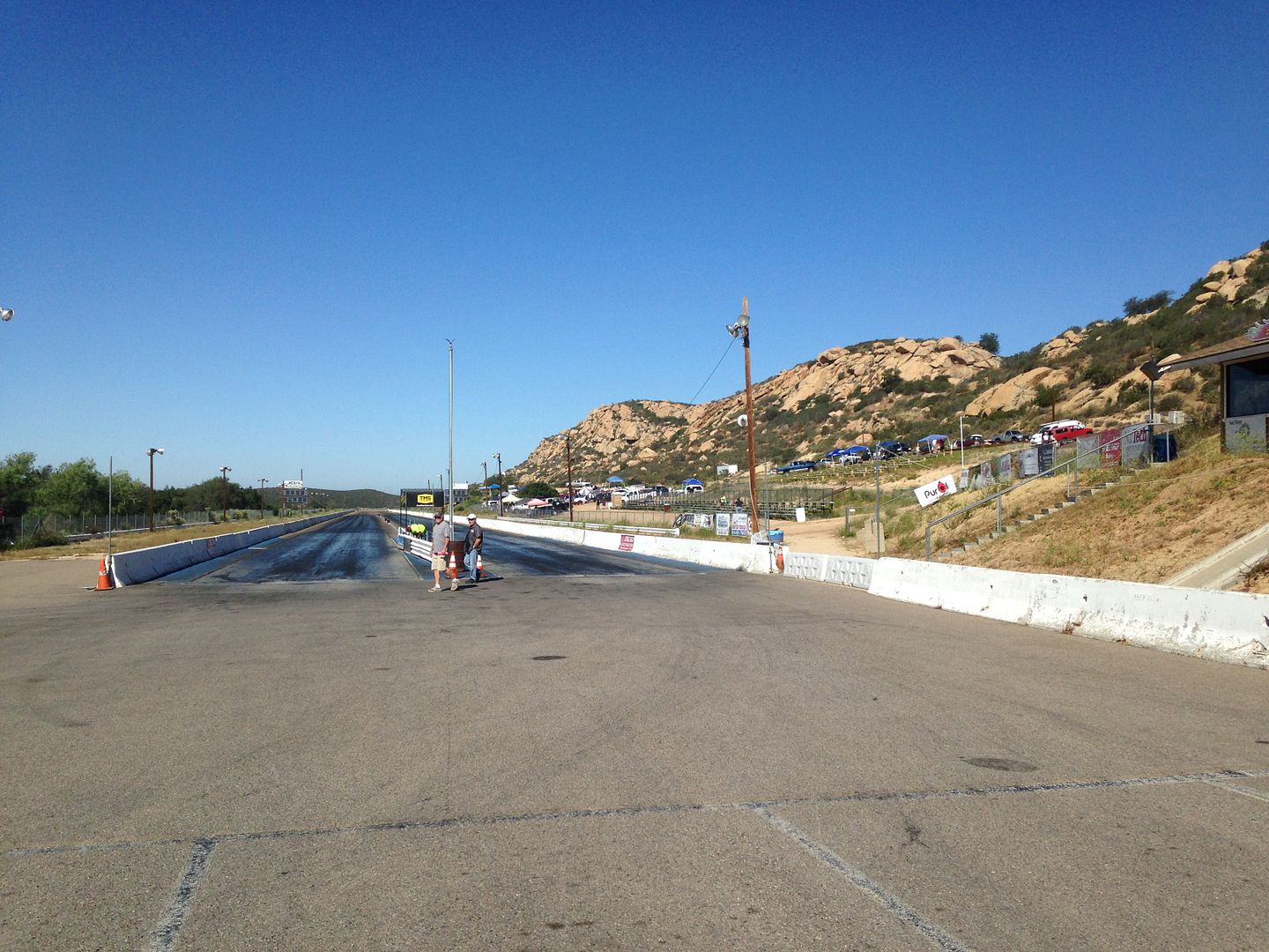

    I sold my funky daily driver 69 Buick Skylark and bought this 99 Tahoe so I finally have my own tow rig. Not bad for about 3 grand. Loaded up to go have some fun at the 48th San Diego Antique drags at Barona drag strip. I race at this meet back in the 80's when it was held at Carlsbad. My friend Perry went also and raced his roadster.
    Barona is such a great track, it is 1/8 mile and is like racing at a camp ground in the mountains. Really nice people running it!

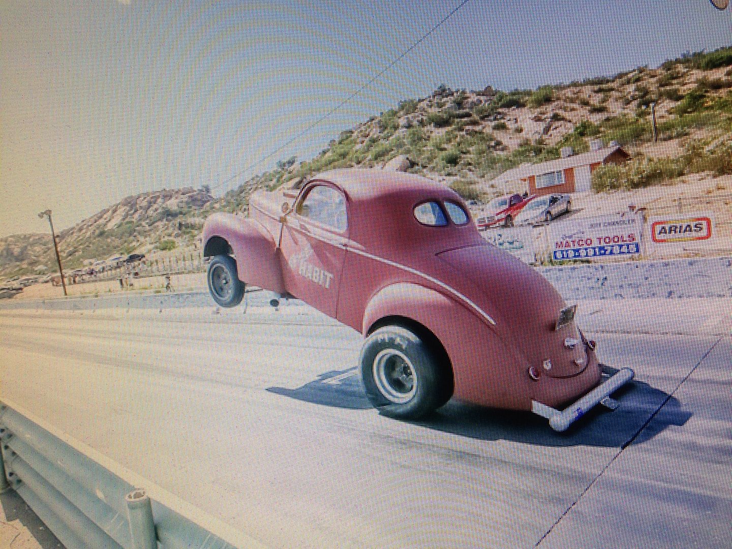

    First run went OK but I smelled all kinds of burnt clutch. I remembered I smelled a little on my last run the last time I raced it at the antique nats too, checked out the linkage and it needed adjusting so did that, second run it picked the front wheels and took off but wouldn't go into any other gears so I adjusted the clutch fork stop. Third run I was in the right lane and it pulled a wheelie and headed straight toward the guard rail, when it landed it missed the the wall by about 2 inches, pretty exiting!
    When I got out I went straight to the fender to see if I'd s****ed it but no. It usually launches straight so I put it down to uneven tire pressure. Everything worked fine for run 4. It stood up on the bumper and it went straight so I kept my foot in it and didn't miss any shifts. FUN! Rest of the day was more of the same with a few duds. Couldn't believe it when I counted my time slips, I made 11 runs! Best was an 8.0 at 86 mph. I have no clue what that equates to on a 1/4 mile and I probably don't want to know but this is a street driven car that only races 2-3 times a year. I can't believe how much abuse it will take.

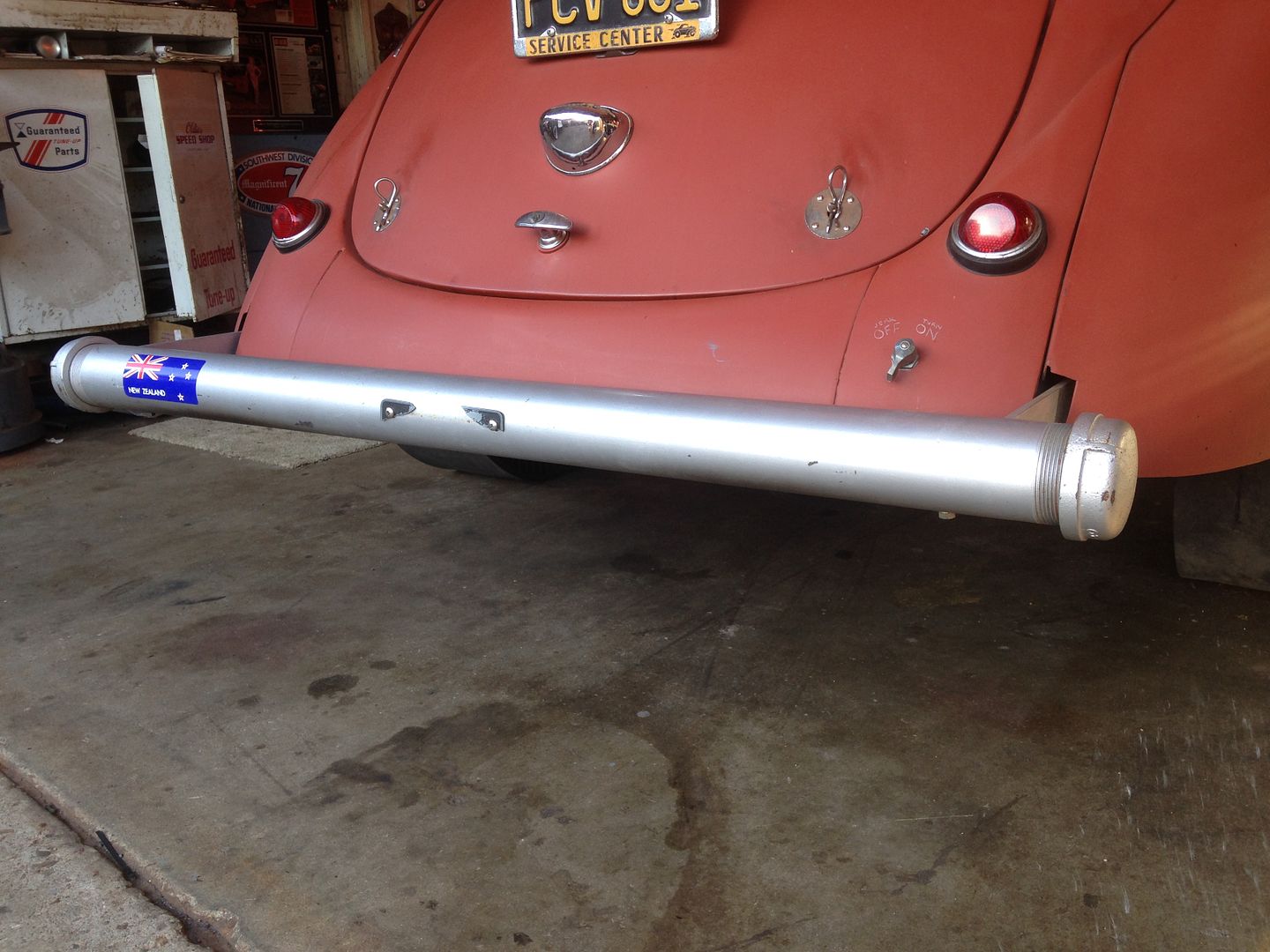

    Your rear bumper....do you have it filled with lead shot.........or plutonium 235? It would appear that you have balance issues! Or is it the helium in the front tires? Fronts 4' in the air and the slicks aren't even wrinkled!
    Looking great Kev.

  27. Woodbox... Looks like the tires wrinkle for the initial launch but only for a half car length or so, then again, weird.....
    9sectruck and volvobrynk like this.
  28. loudbang
    Posts: 40,346
    Spring wind up will do that tire loaded then unloaded.
