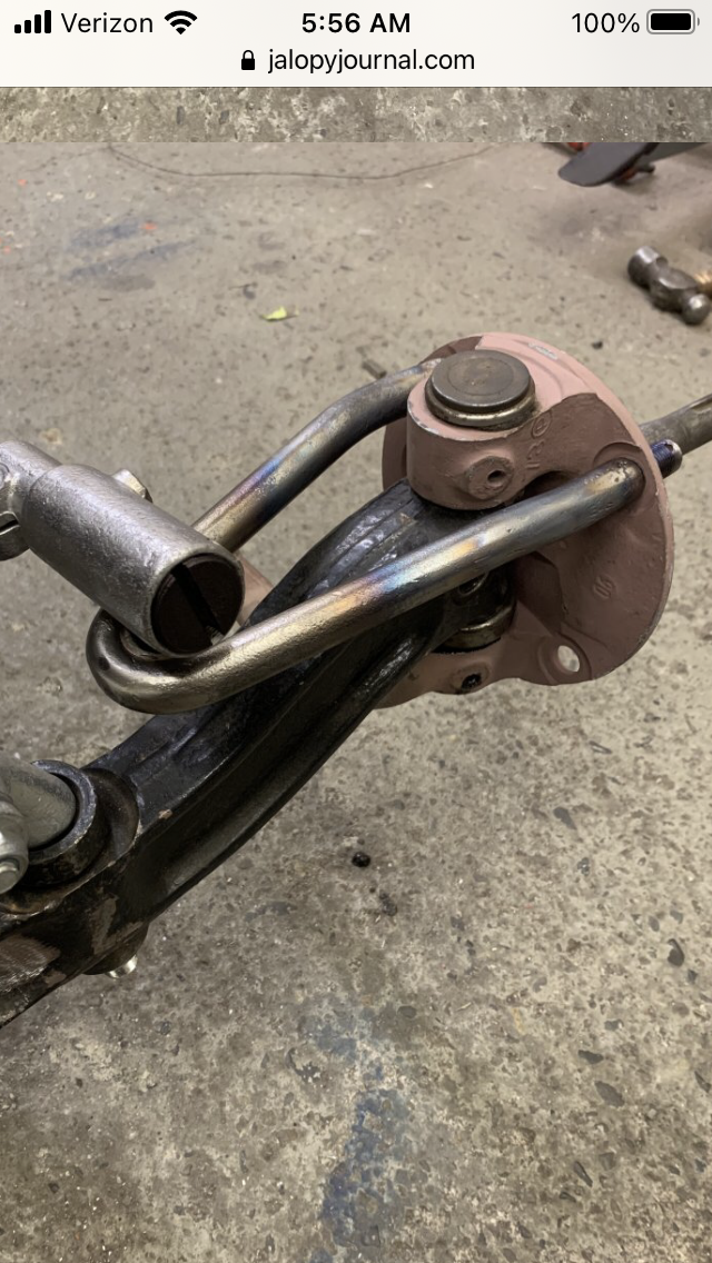

    Nate, did you make that steering arm or modify it to get correct steering geometry?
  3. heyitsnate
    Joined: Apr 8, 2004
    Posts: 1,774
    heyitsnate
    It was an old one . I ended up heating the taper insert out of it, and re-welding it back in, but yeah it’s estimated at this point
