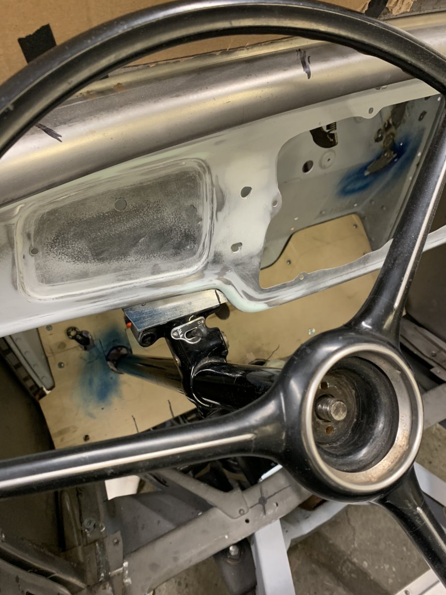

    I drew the dash out and converted it to a vector, then had a local place do an etching process they use for doing photos onto shiny metal. As I understand it the traditional etch has a flat look, and doesn’t stick well to polished surfaces . After it’s etched it gets cut out of the sheet with a cnc router. Thankfully it fit really well. It was an ordeal trying to make it right, mostly because I had to enlarge the holes on my prewar panel to fit the later gauges, so NOTHING was really symmetrical . It’s just minor little differences here and there but when you’re trying to make an accurate digital template it gets real.

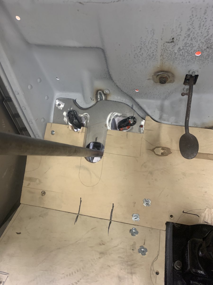

  5. heyitsnate
    Joined: Apr 8, 2004
    Posts: 1,774
    heyitsnate

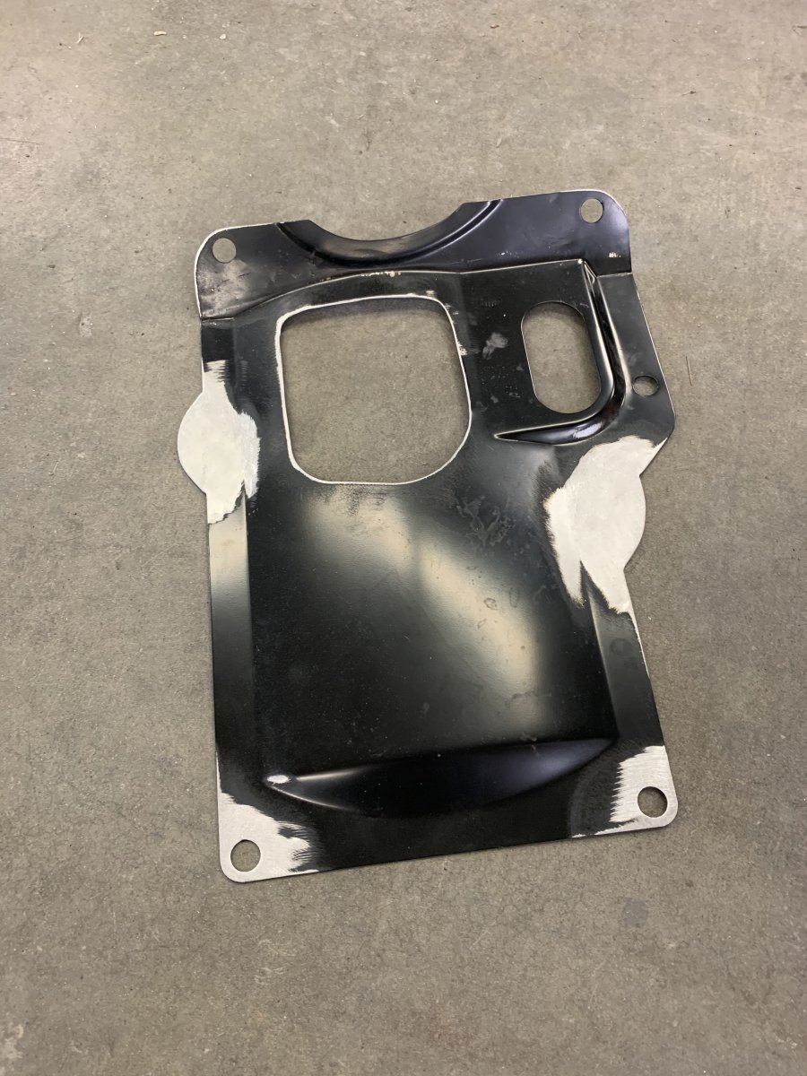

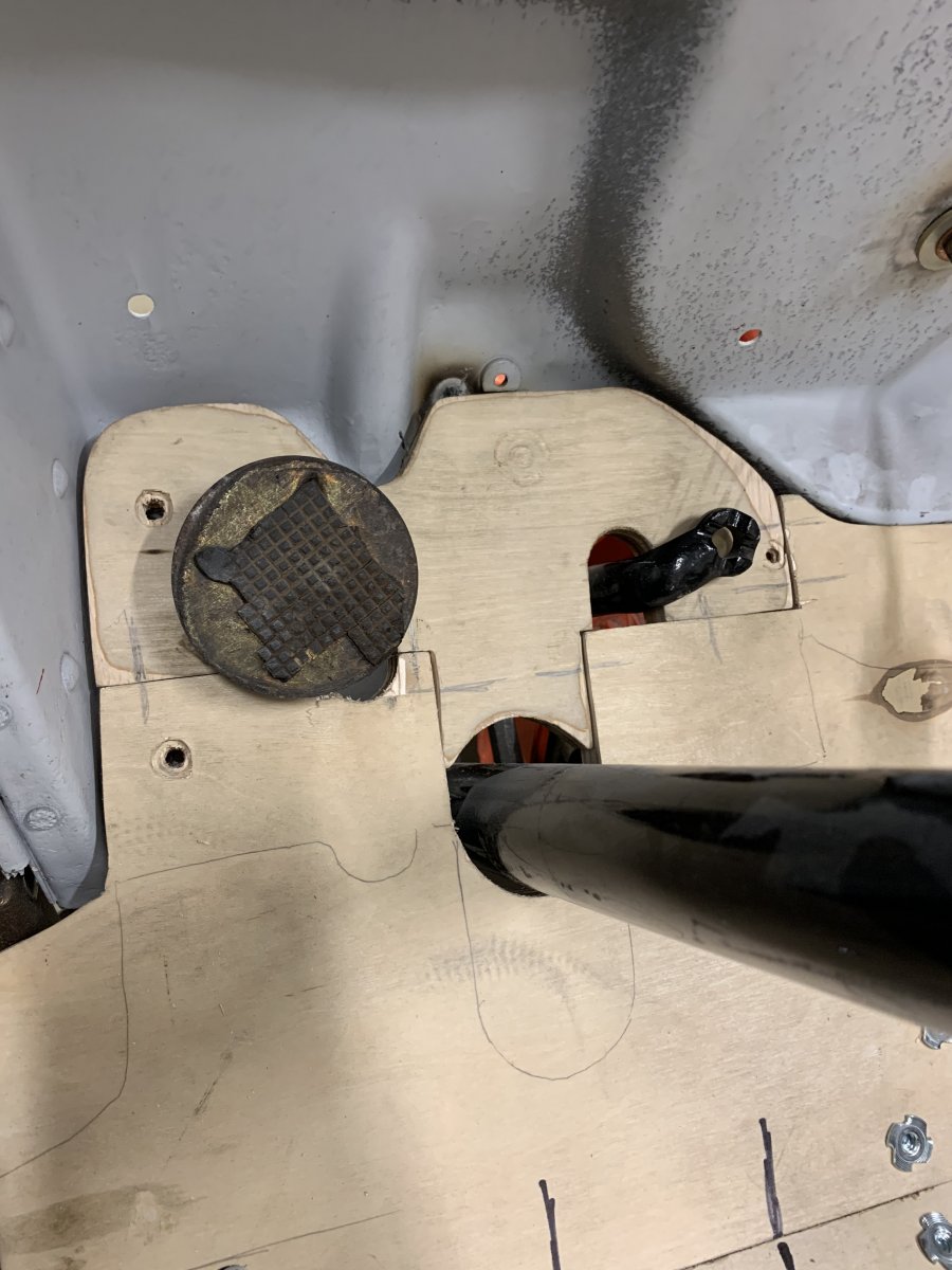

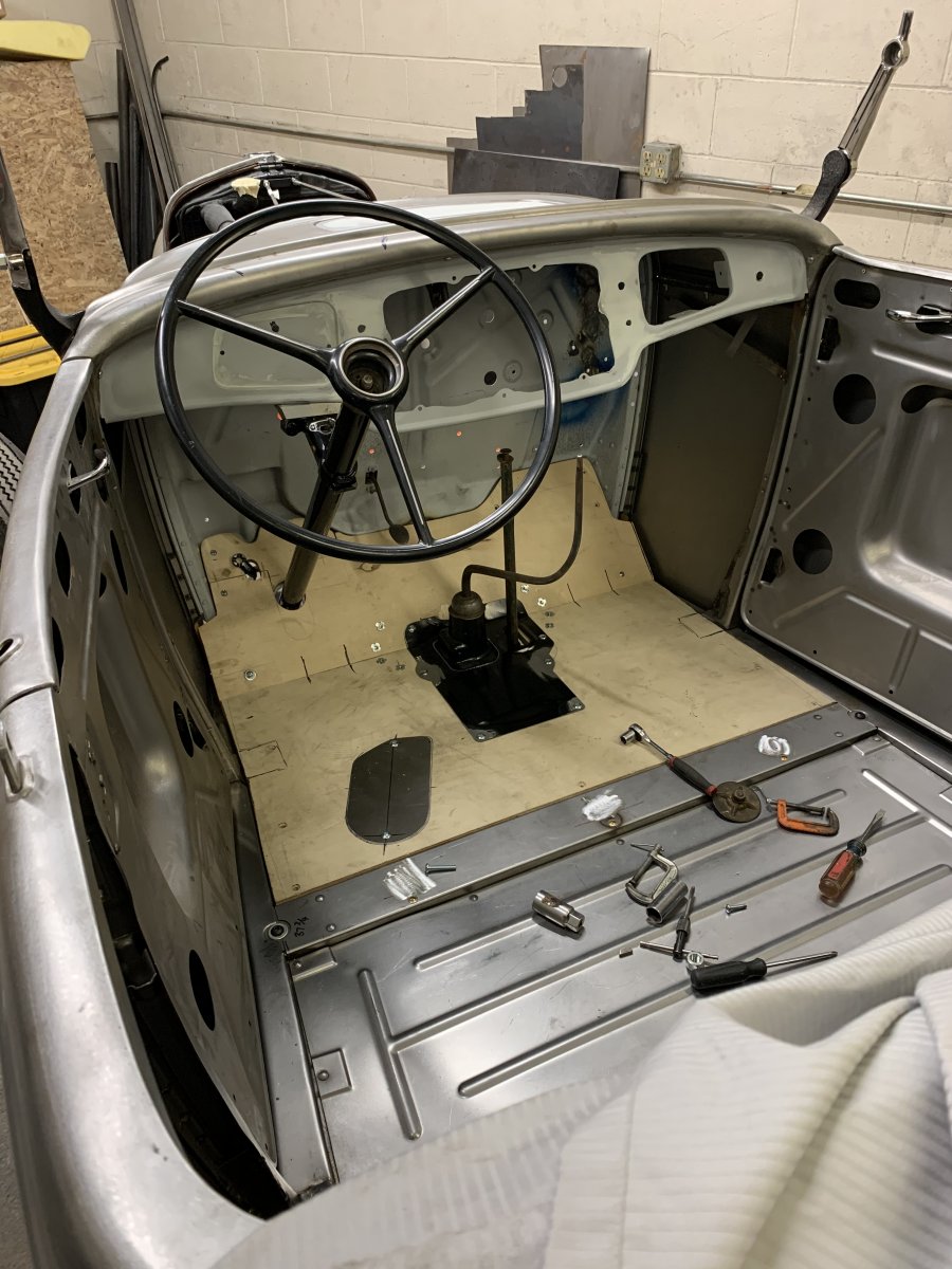

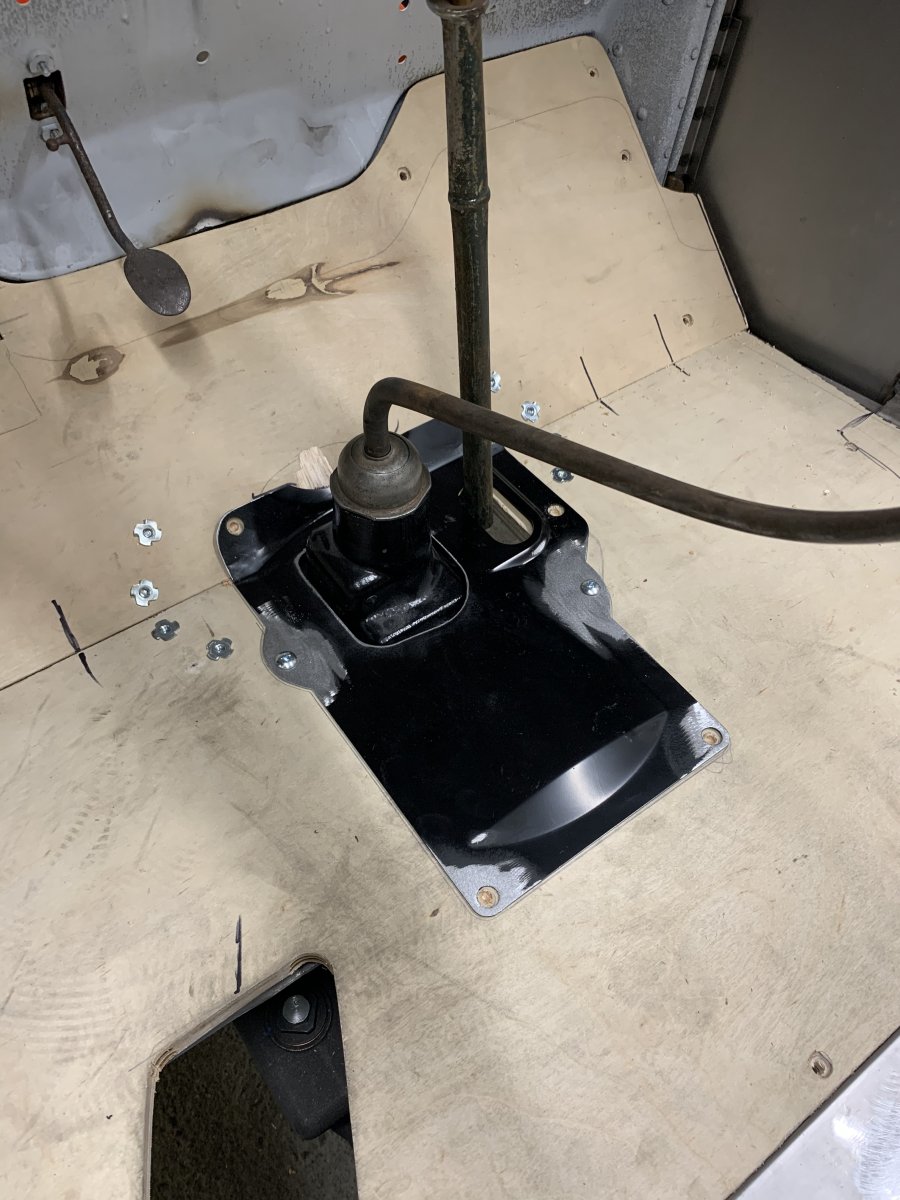

    I’ve barely had time to get to the shop lately, but I have been doing tiny jobs here and there on the dash. That will come back around later. I FINALLY got around to making the floor brackets and doing my trans cover. I still need to do the pedal bumper/tie in plate (if anyone has any ideas how I’d love to hear it) but looking forward to being done with the floors. I also welded the original seat holes up . D8CE4528-862D-41DA-AAE8-4187CEB9BB4B.jpeg E619E177-C0B1-4F37-9D4A-8D5F2BD91AF6.jpeg 5DDA9C3C-3564-406C-9CBD-B68F1669EBC7.jpeg D42AF42D-C6DC-4B3C-9F6C-C2A12DCD99D9.jpeg 11731648-8822-4871-A146-CB7D4E207069.jpeg

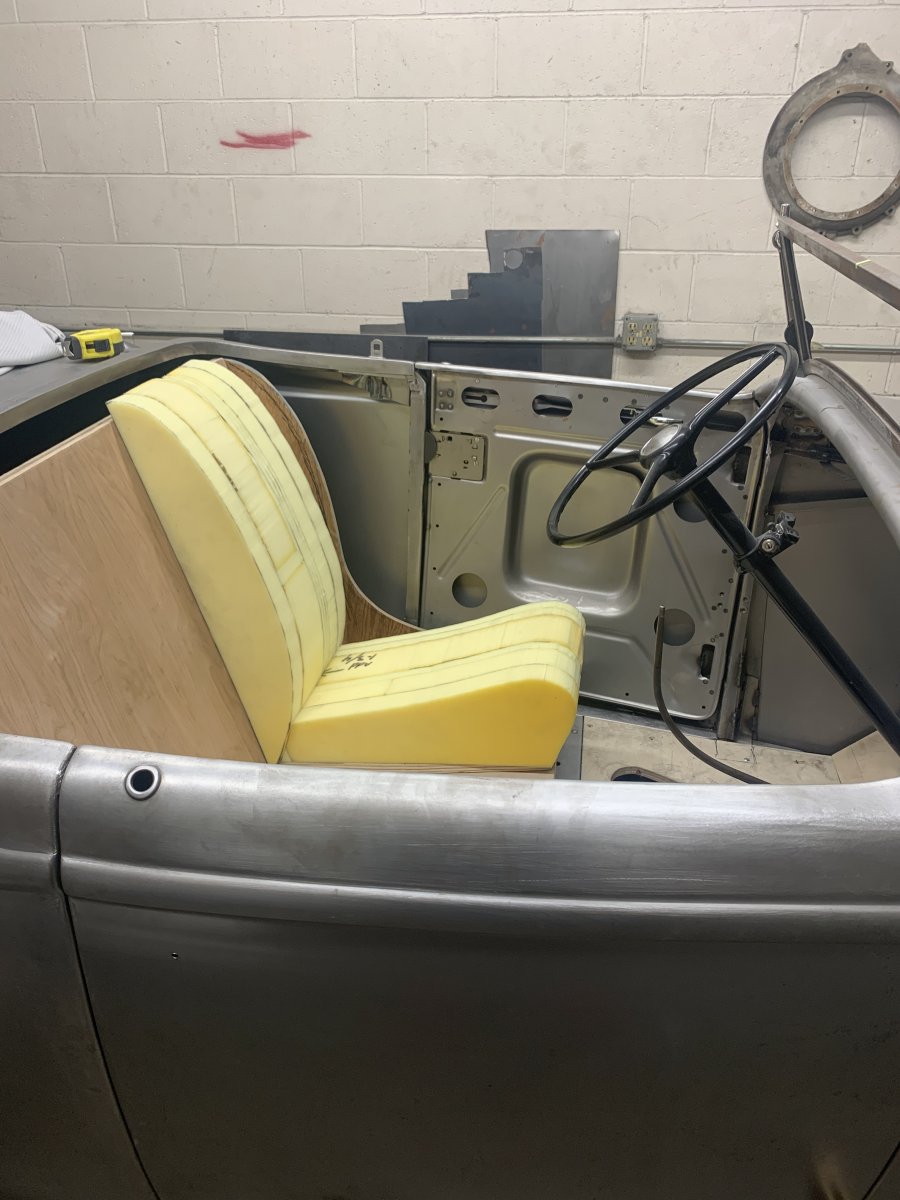

    heyitsnate

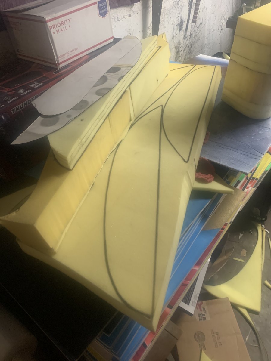

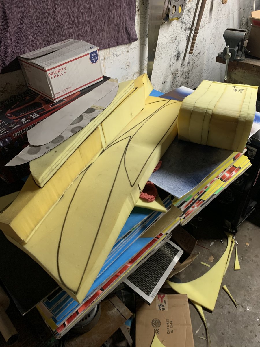

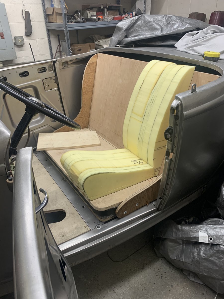

    I was having a hard time getting my seat cushions done so I figured I could just make a pattern from s****s to bring to my seat dude. I got some vintage upholstery books that have awesome info about seat geometry, pleat widths and lots of other useful info about 1930s cars . 4BDBABE0-E0D1-4FCE-B084-C36056B8C52C.jpeg 27AD1434-66AF-4E70-9C47-08032ADBF18B.jpeg 8EDDD113-D346-4DBA-829A-D8781E43C452.jpeg 9B87ADDF-6861-44BC-A371-BE4362117DE2.jpeg

    Looks like you'll have good lumbar support, that's what's missing on the Glide seat in my '32.
    Nice job on all the work!

    i didn't see it, but to cut foam like that i use an electric turkey carving knife...

    I used a vertical bandsaw but the carving knife works well too , especially in corners .

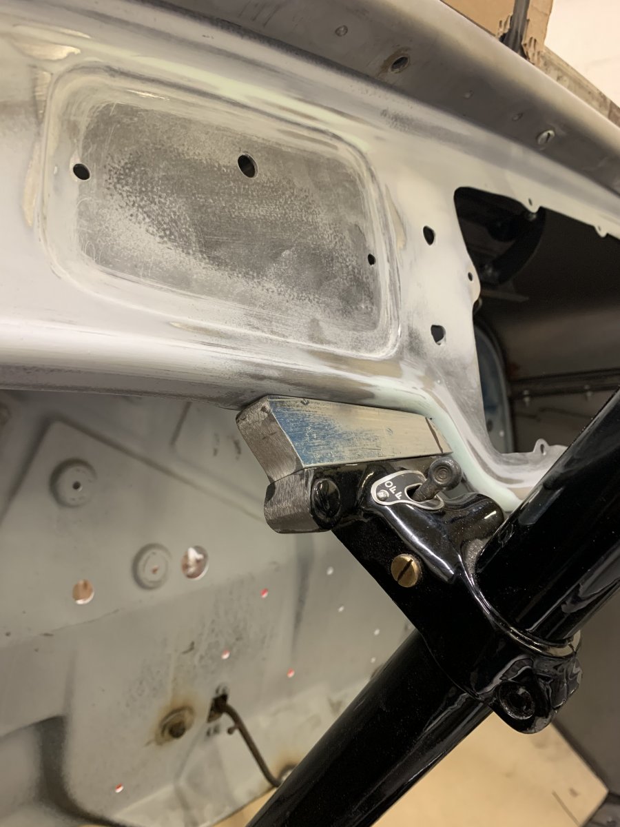

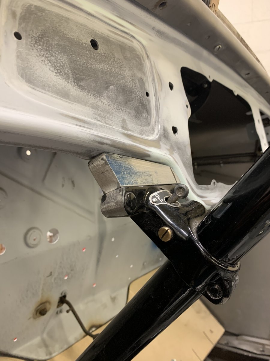

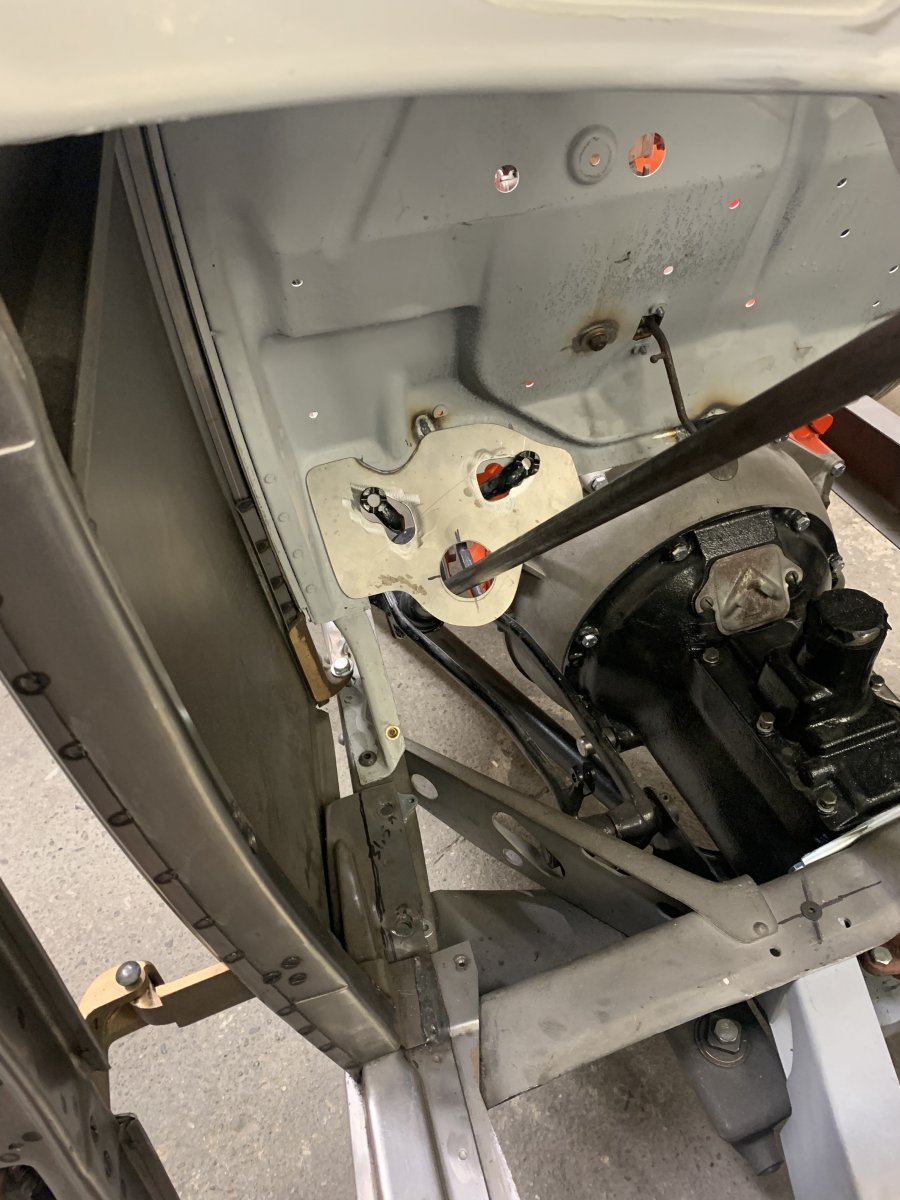

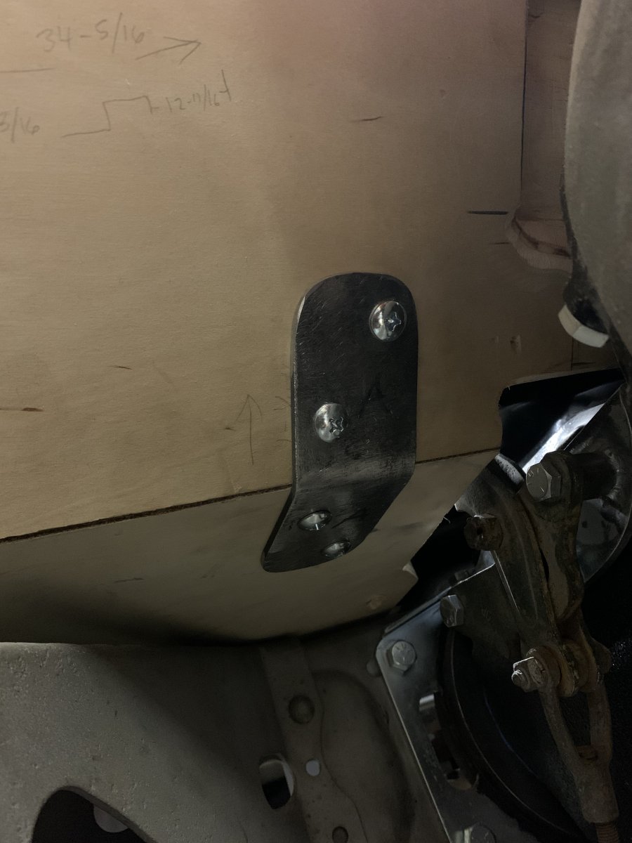

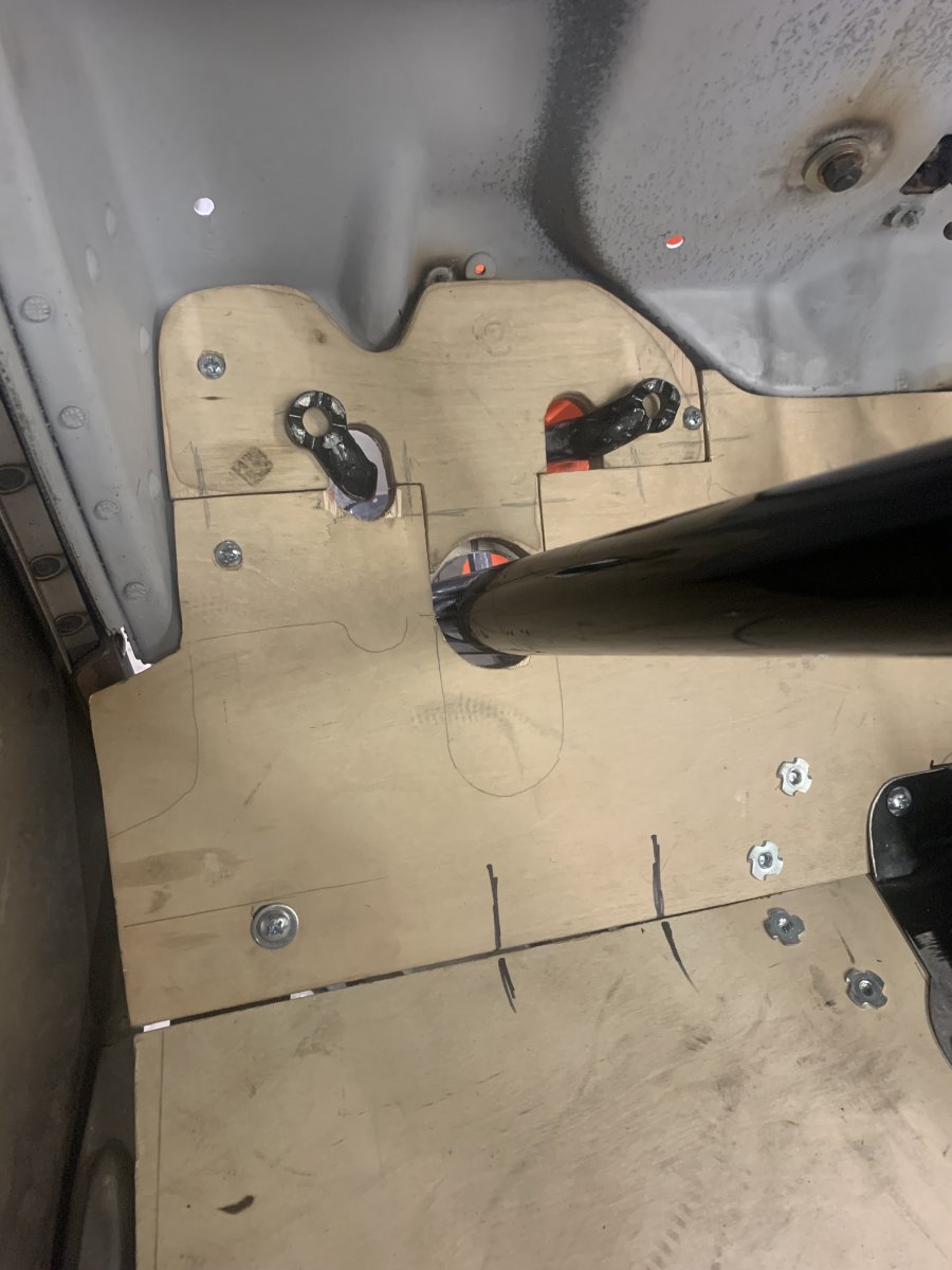

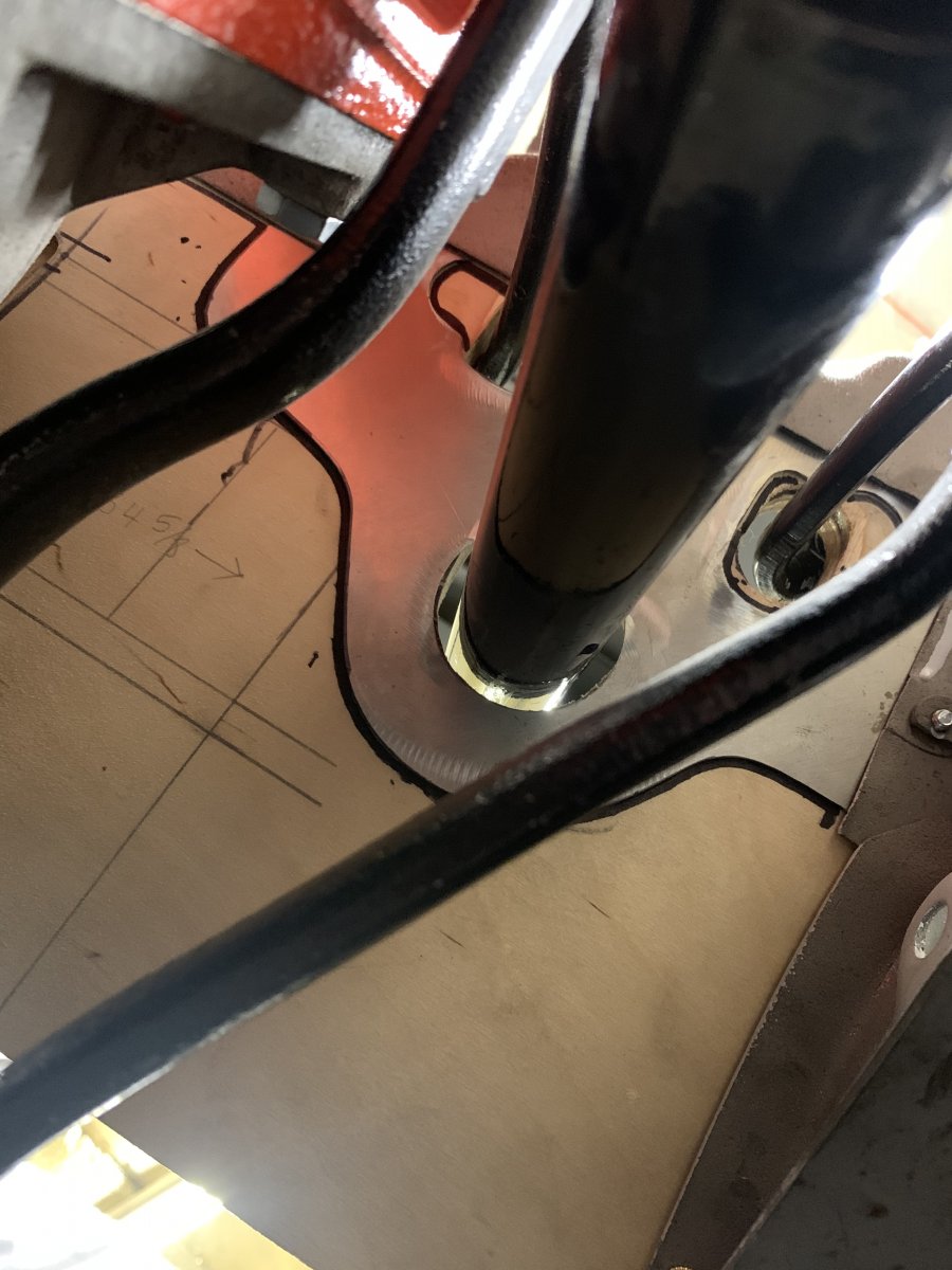

    I made a plate for the bottom of the floor that will sandwich some rubber and help keep fumes and BS out of my car , glad to be done with the floors ( except a few finishing details ) 27EF935E-0882-48BD-B31D-BD514A941D0C.jpeg 8B9B668A-E0C9-47ED-A43E-56D74558ADFB.jpeg 1A0FD50F-2C27-4FA7-BD94-B65FBBB7DEE5.jpeg 372C1895-4EE9-4F86-A52E-9ADC61BEA203.jpeg

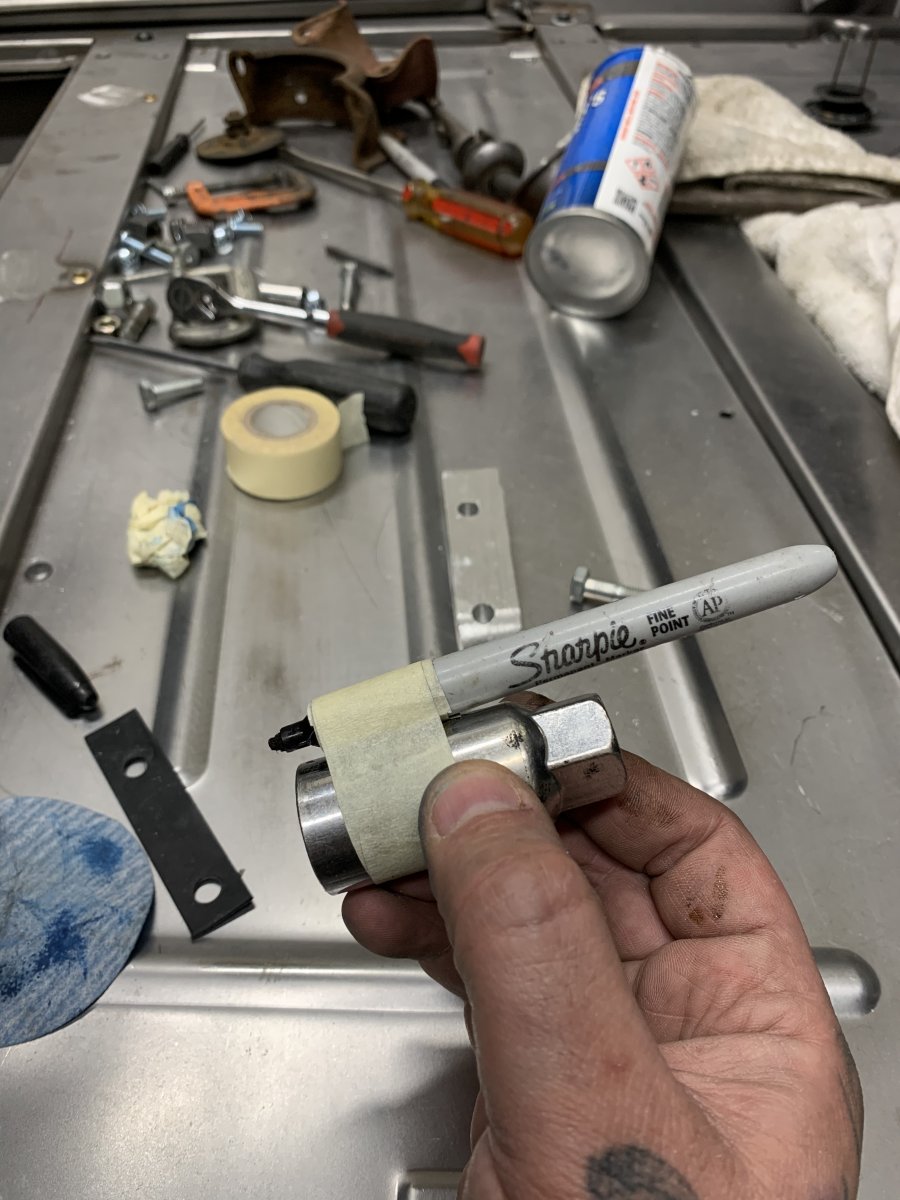

  15. heyitsnate
    Joined: Apr 8, 2004
    Posts: 1,774
    heyitsnate

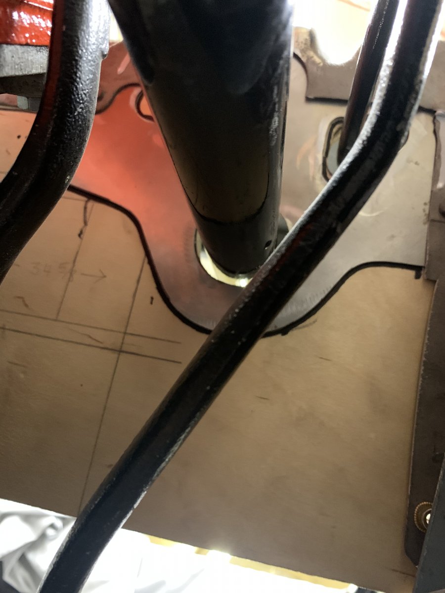

    2ECC1D10-58C6-49D7-B301-0B4CB9299DAC.jpeg 83984653-E07D-4C7B-8849-E682DF5735B7.jpeg EB51D136-5D9C-45D3-8FB5-25A21B4682AE.jpeg D02FBA47-8597-47A0-B2CD-6C7259DAEA33.jpeg 4377ADD4-3CF3-4AEA-8E36-B93A58E83AD0.jpeg 3E3ADA37-F5DF-4CFD-91AF-23632C0AC8E6.jpeg 44ABCD29-E80C-4FB6-9F1E-7130C405D90E.jpeg Once the plate was made , i route red the shape of it into the wood so when it’s got the rubber mounted the floor stays flat. Once I did all that I figured I’d macke a trim piece for my column at the floor which also would strengthen the floor pieces . I made a quick tool to find the column center. Also I’ve been busy Block sanding my dash getting ready to paint it. Along the way I wasn’t happy with the column drop extension so I made another. Lots of little jobs happening

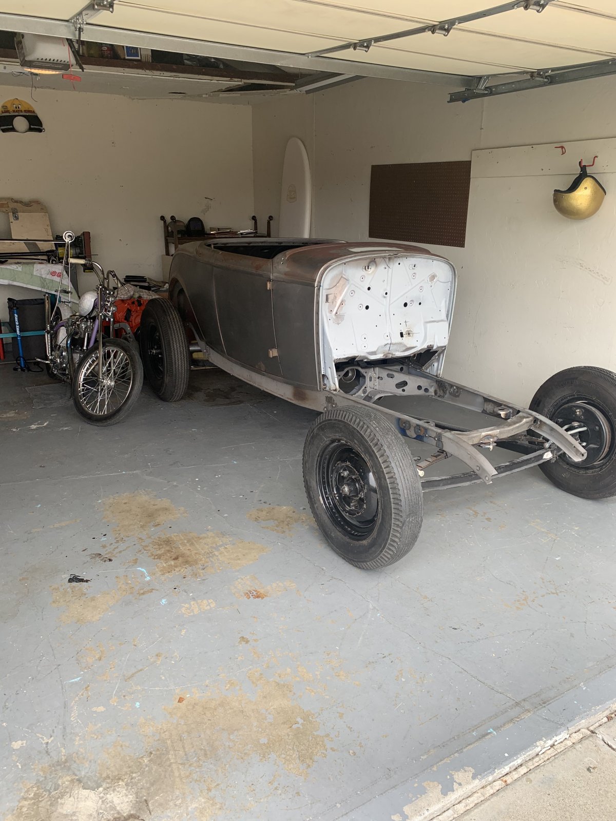

    Well not much has happened since the last update. I moved to Oceanside California , now I’m in a race to beat the rust! Before I left though I got my windshield frame back from chrome plating.

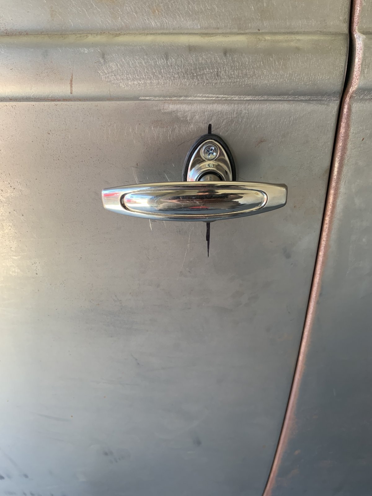

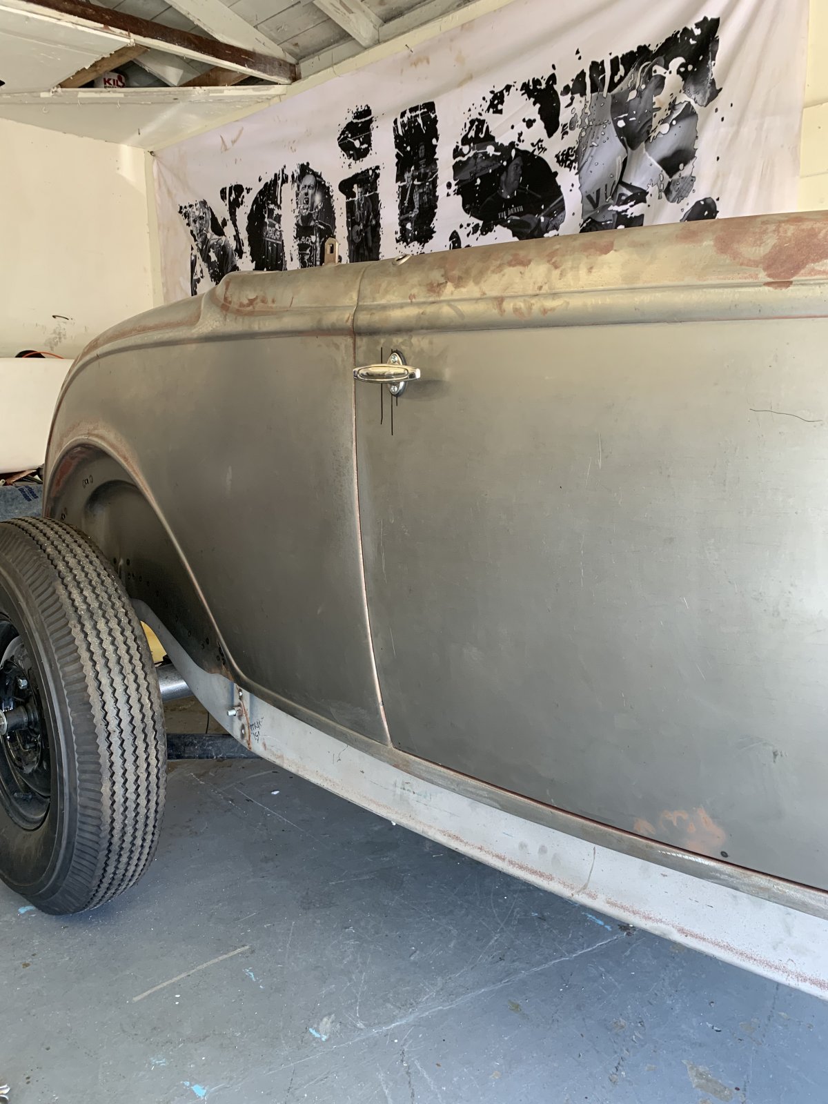

    Started taking the car apart to get it at least put in primer. . Then I installed the outer door handles. Wasn’t too difficult, I’d already made the pilot holes. 9D0EFC4C-F89F-4EF2-891C-54737C778130.jpeg 767B87F4-9992-4E90-ACDB-8A46B02D5FCE.jpeg 6397E831-69E6-4048-ABE9-D33FA51EA369.jpeg 2A45C6FB-A6B8-4537-B070-56F174B8EBB9.jpeg 98992CFF-2F80-481E-A632-B3CE1BBEAE6B.jpeg A7B97359-D334-44B7-88F9-B27F912E32B9.jpeg

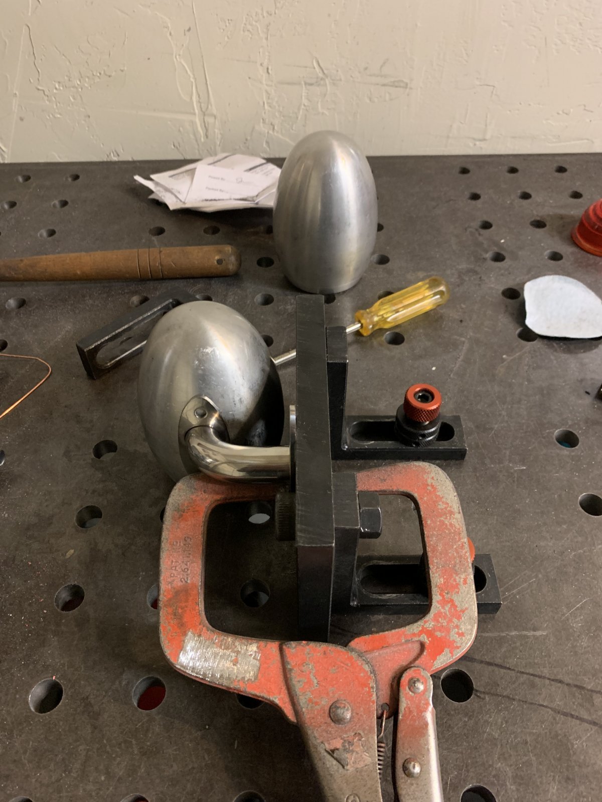

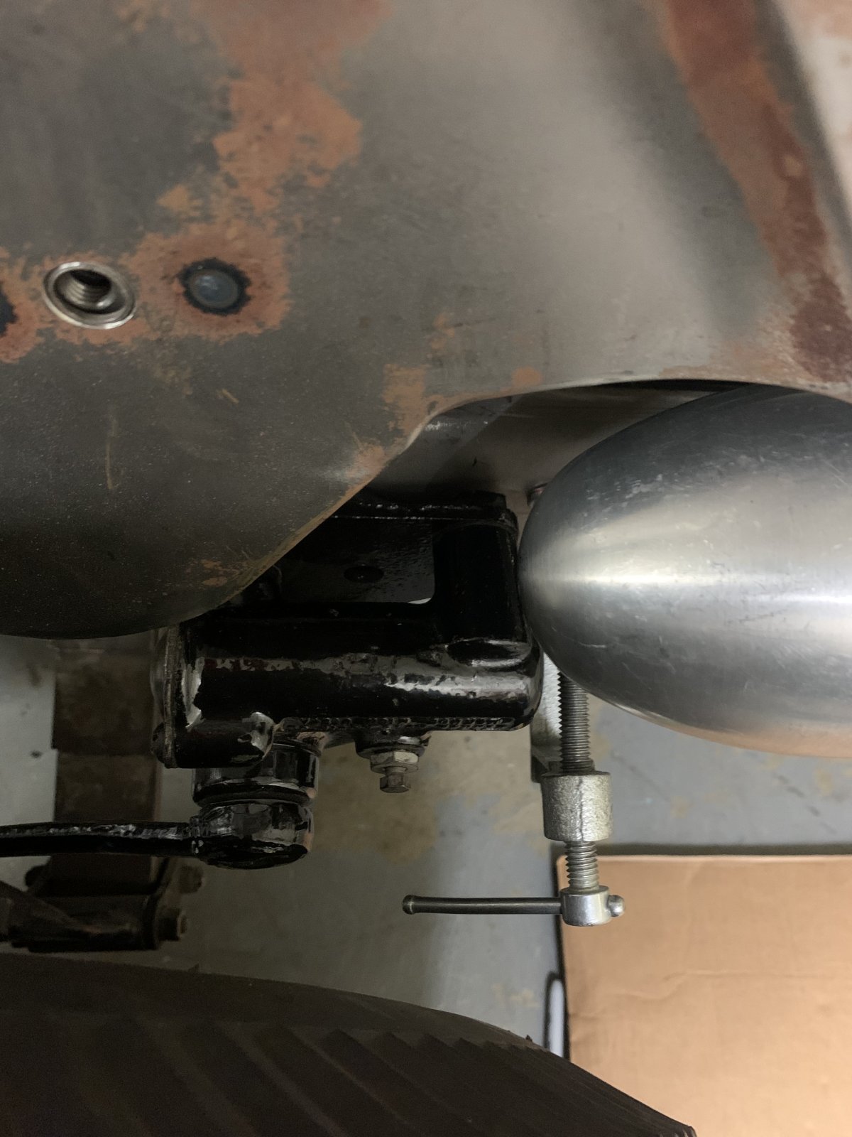

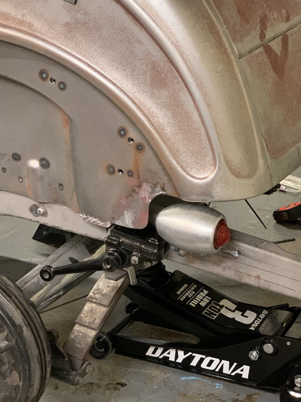

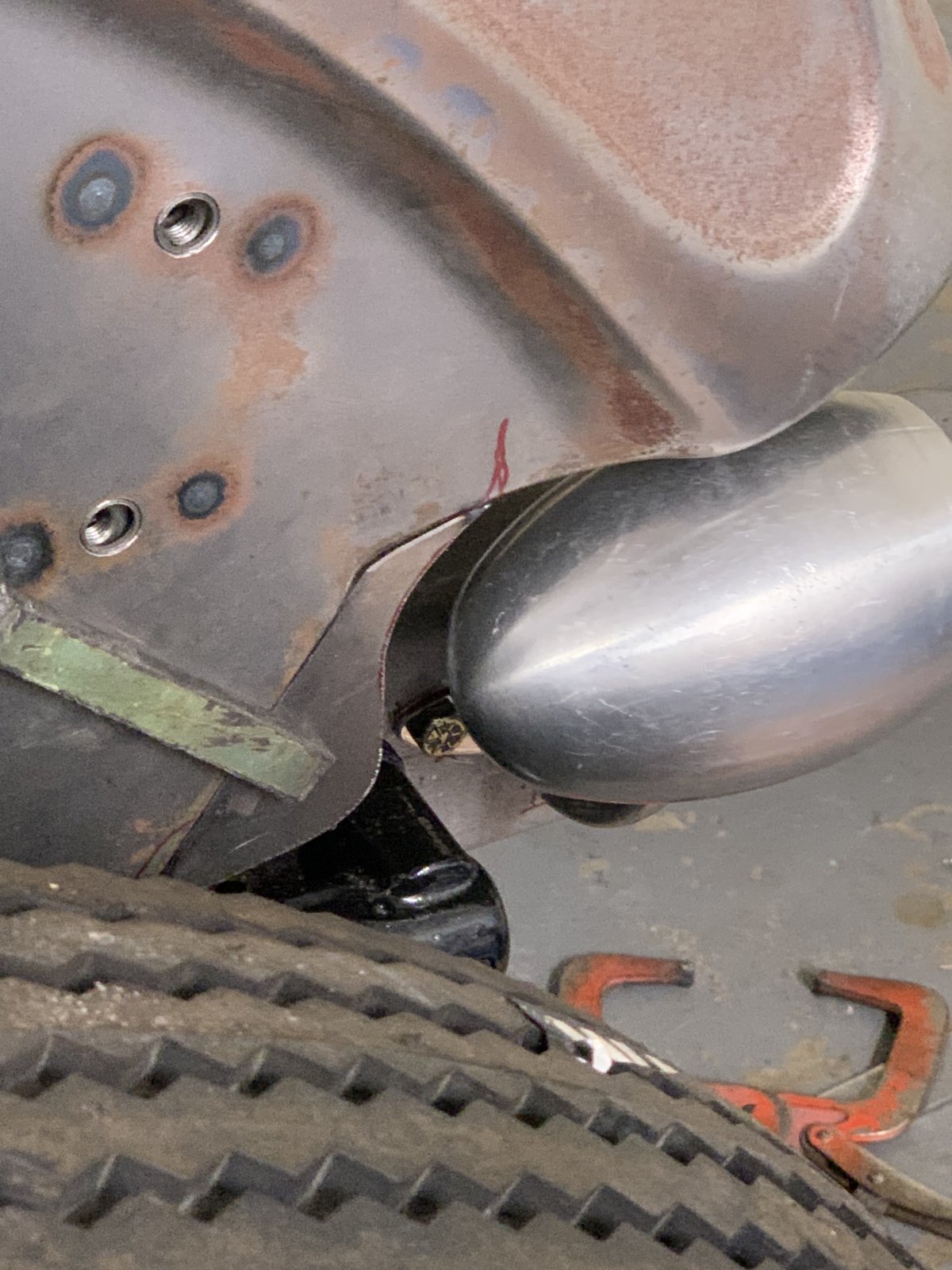

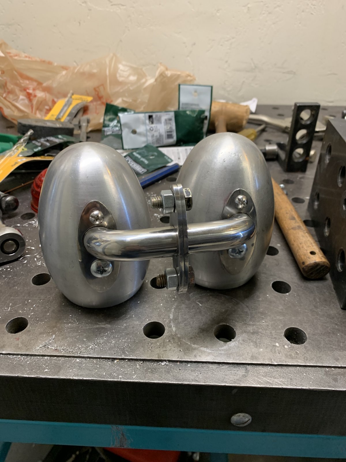

  30. heyitsnate
    Joined: Apr 8, 2004
    Posts: 1,774
    heyitsnate

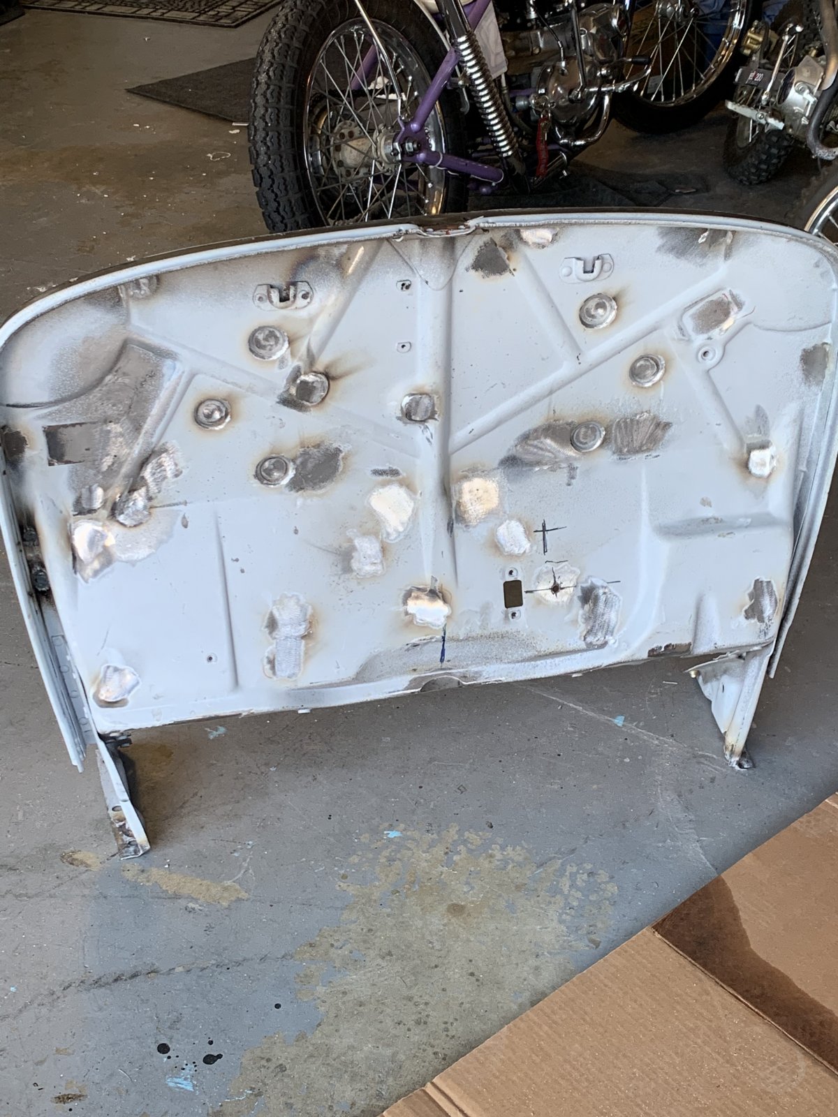

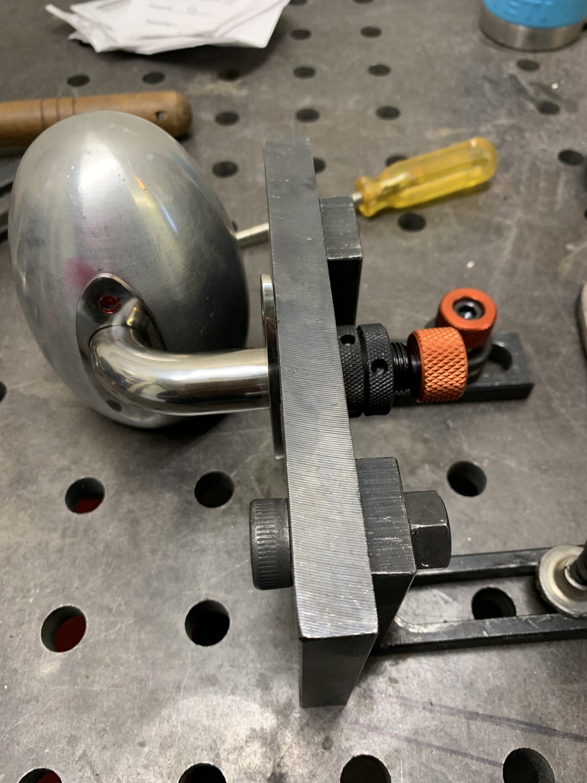

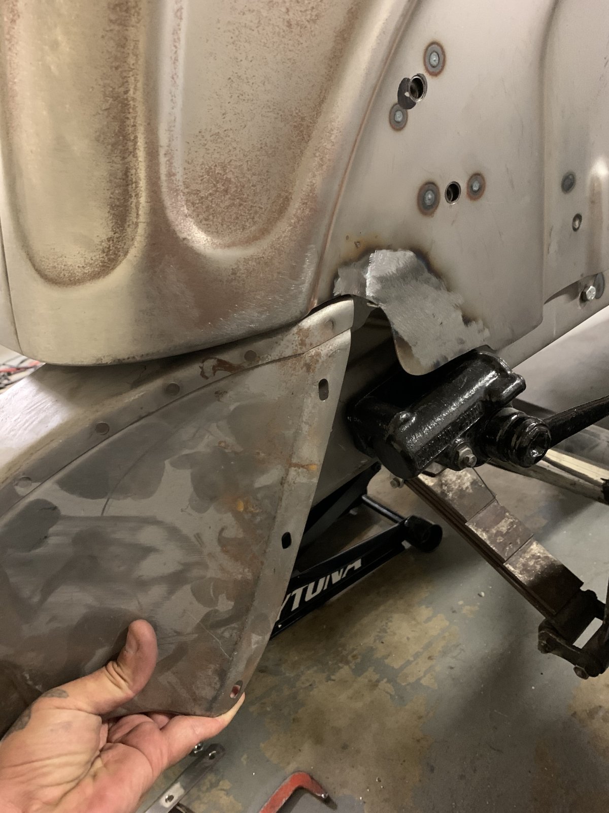

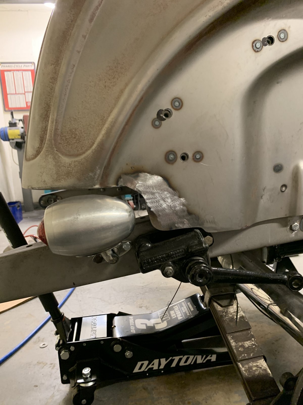

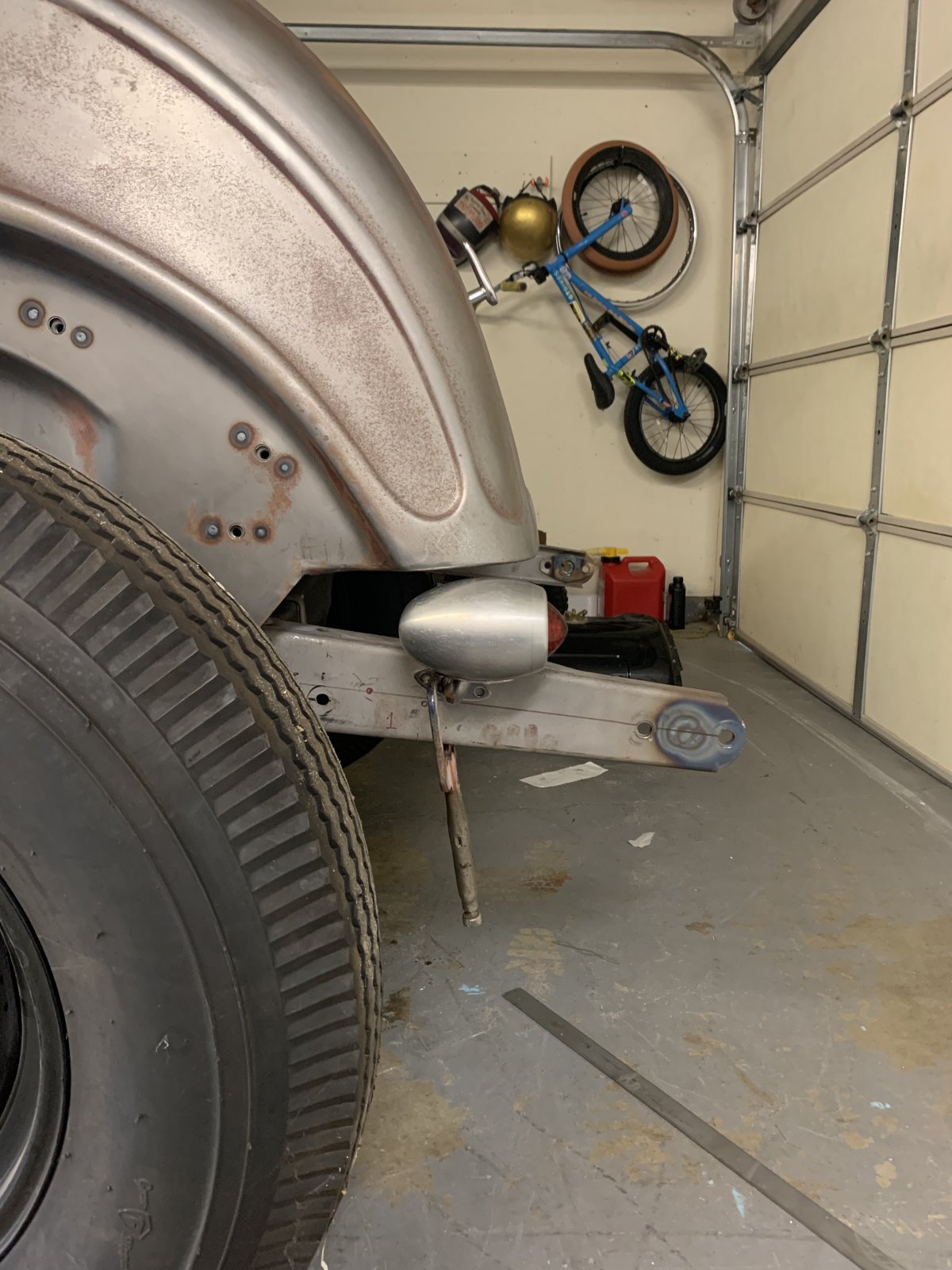

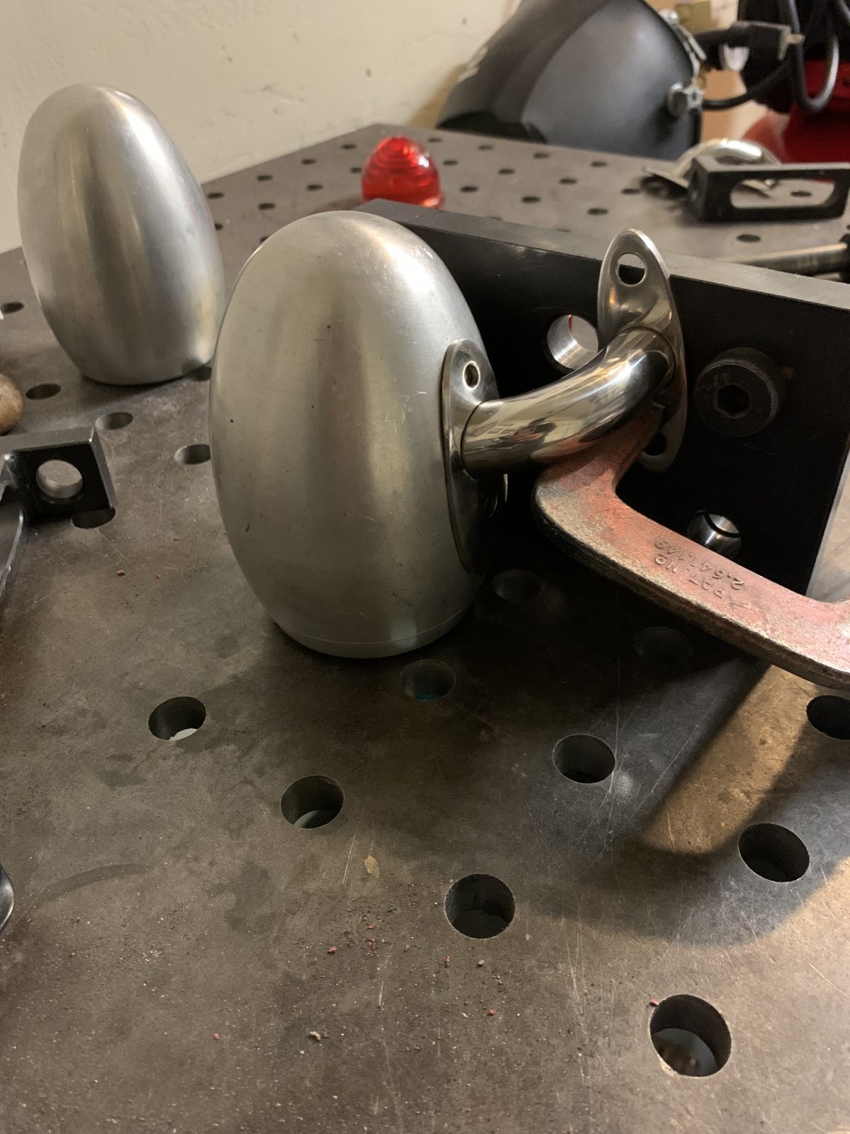

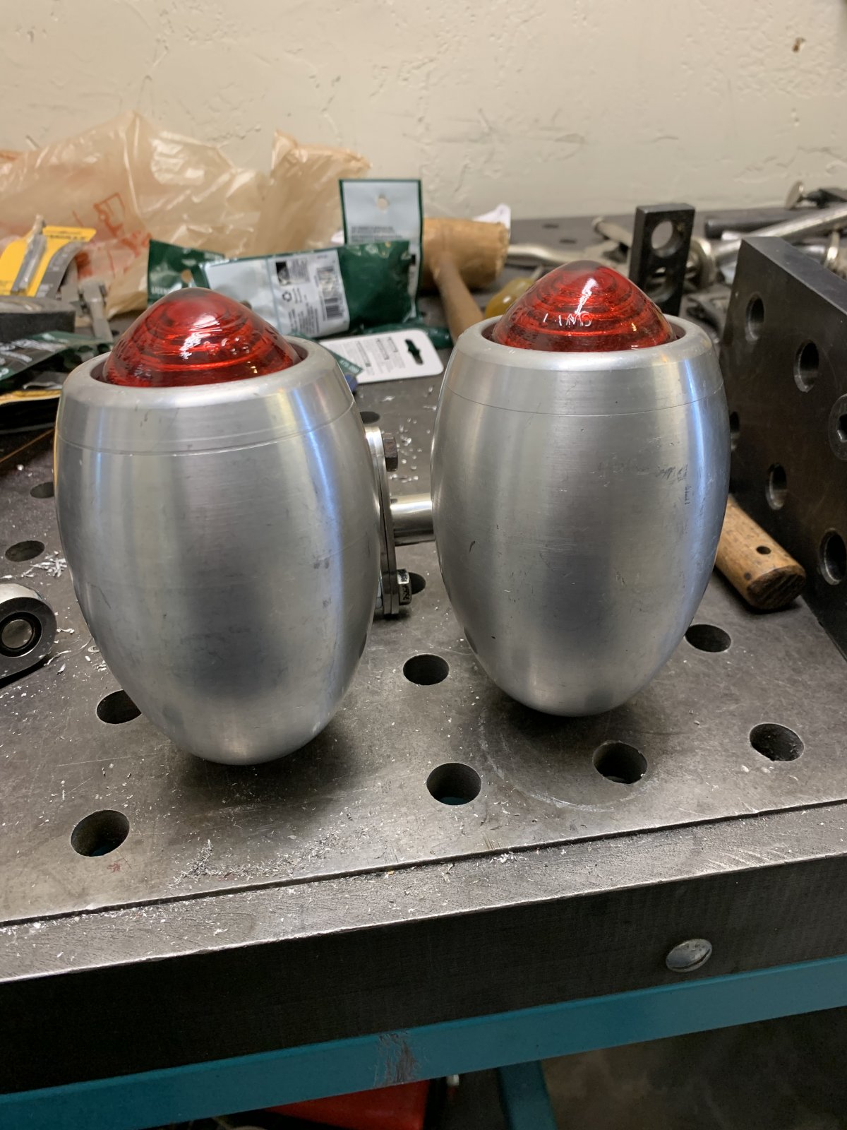

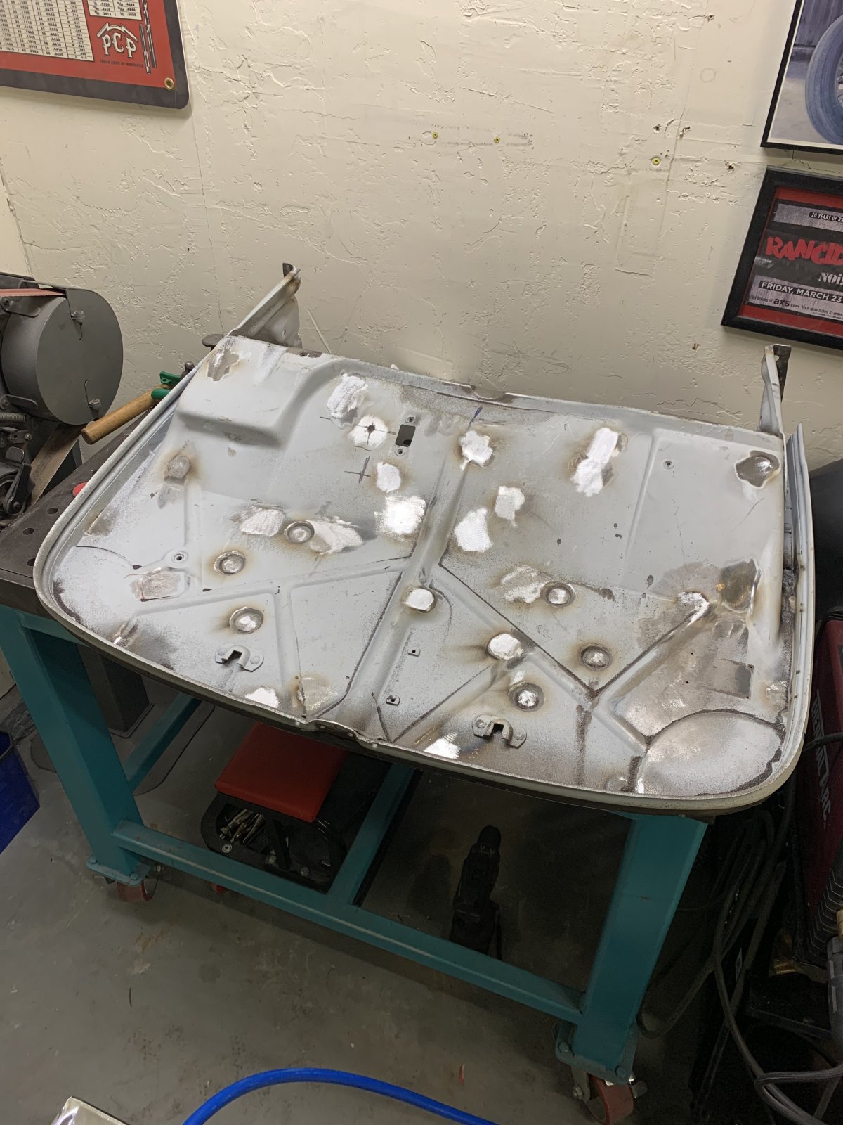

    770A5B65-B2F5-4886-BF38-A37D78C2F50B.jpeg F5A969F8-949F-45A6-8BD9-7E32019F6A7F.jpeg 77064E17-6C3C-4623-8F4E-E141C3F7B74F.jpeg FD627E32-1902-4A5C-9917-9A2D74CF4E31.jpeg B1AD68BC-ADA3-44E6-AB86-CF18327DB90E.jpeg 7A89FA5D-D2A6-4C31-A7B3-4C1890BE74EB.jpeg 868B336E-4E88-406E-A1E0-E1E1CD78D536.jpeg 902B5264-A3D7-4133-BF9A-C262B3AEFDE5.jpeg 053678E9-2B9D-4F0B-BD97-38F2EF348FD1.jpeg F35C11EB-8DCE-44ED-88B3-A019E6577502.jpeg 4D8BBBDD-B6CF-4B90-B7A4-1E88FE89818C.jpeg 5F7948EE-BBFD-40A1-833A-602DA0B6C496.jpeg 29FEC91D-5E8D-46B2-A4E2-165E7A9D5379.jpeg Filled a million holes in the firewall, then addressed the taillights. Marshall Woolery made these rad mini E+j taillights. I made some filler panels and got them all set up. Follow along.
