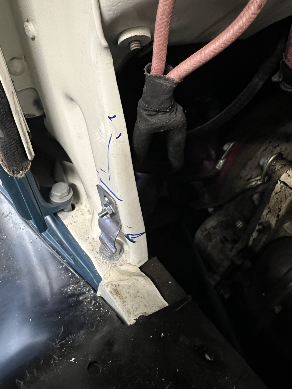

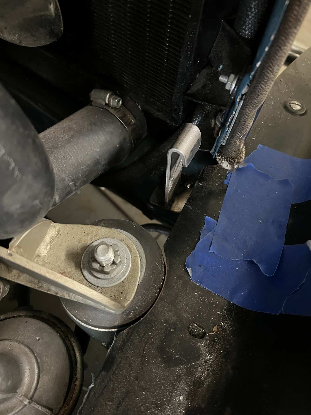

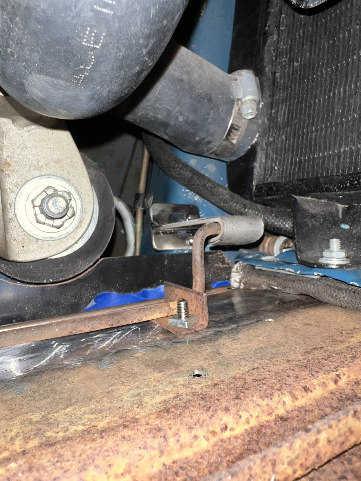

    Would you show the brackets you built to allow the '32 chevy hood latch to operate. Thanks so much for the build thread!

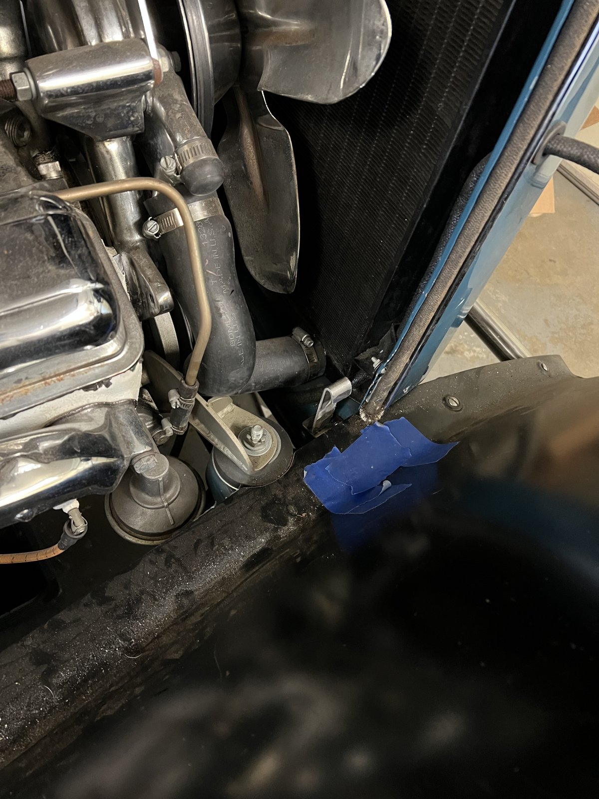

    you can kinda see em. I put my phone flashlight on the engine facing down and used the holes in the side to reach through and set them up . The front ones bolt to the crossmember with 10/24 screws. I tapped the crossmember. The rear ones I bent up from sheet metal

    Great, thank you. Simple and effective.

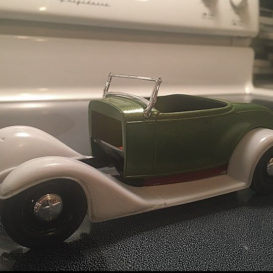

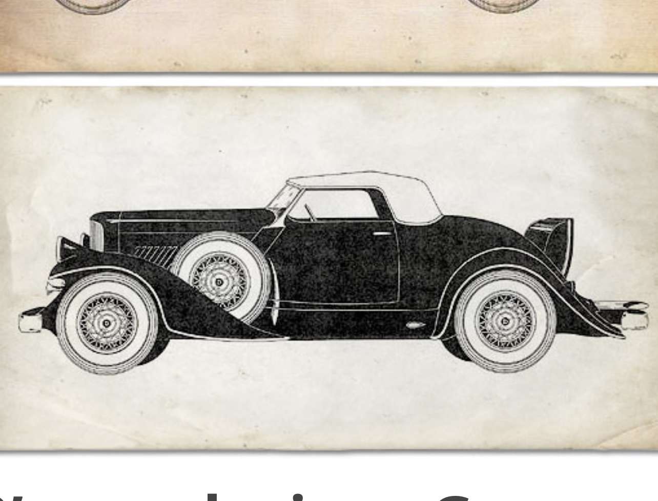

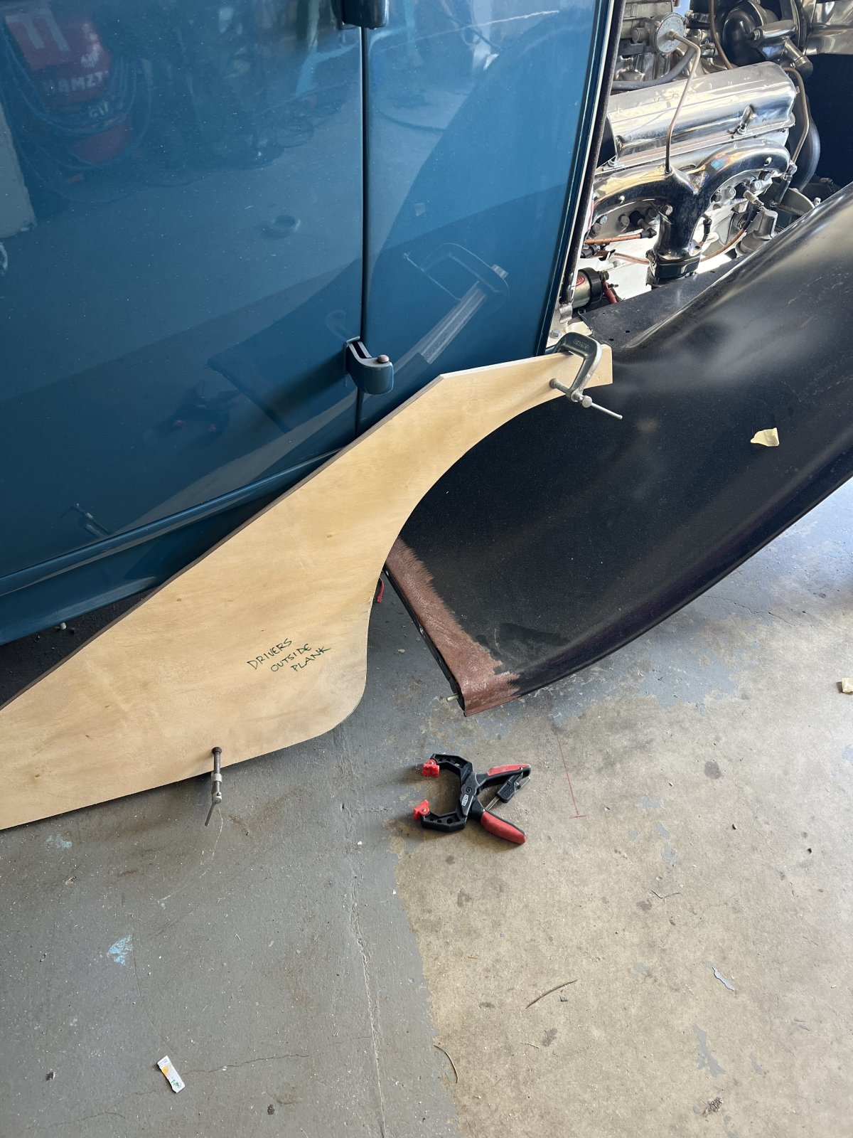

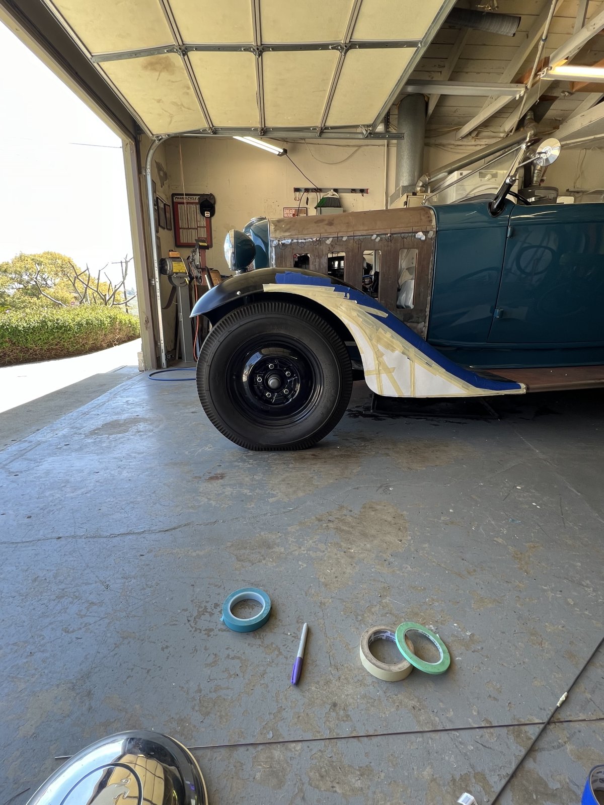

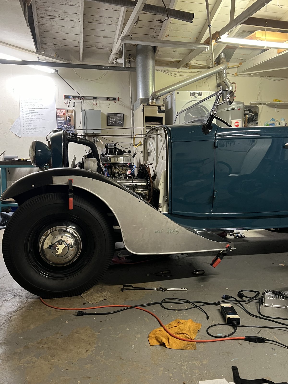

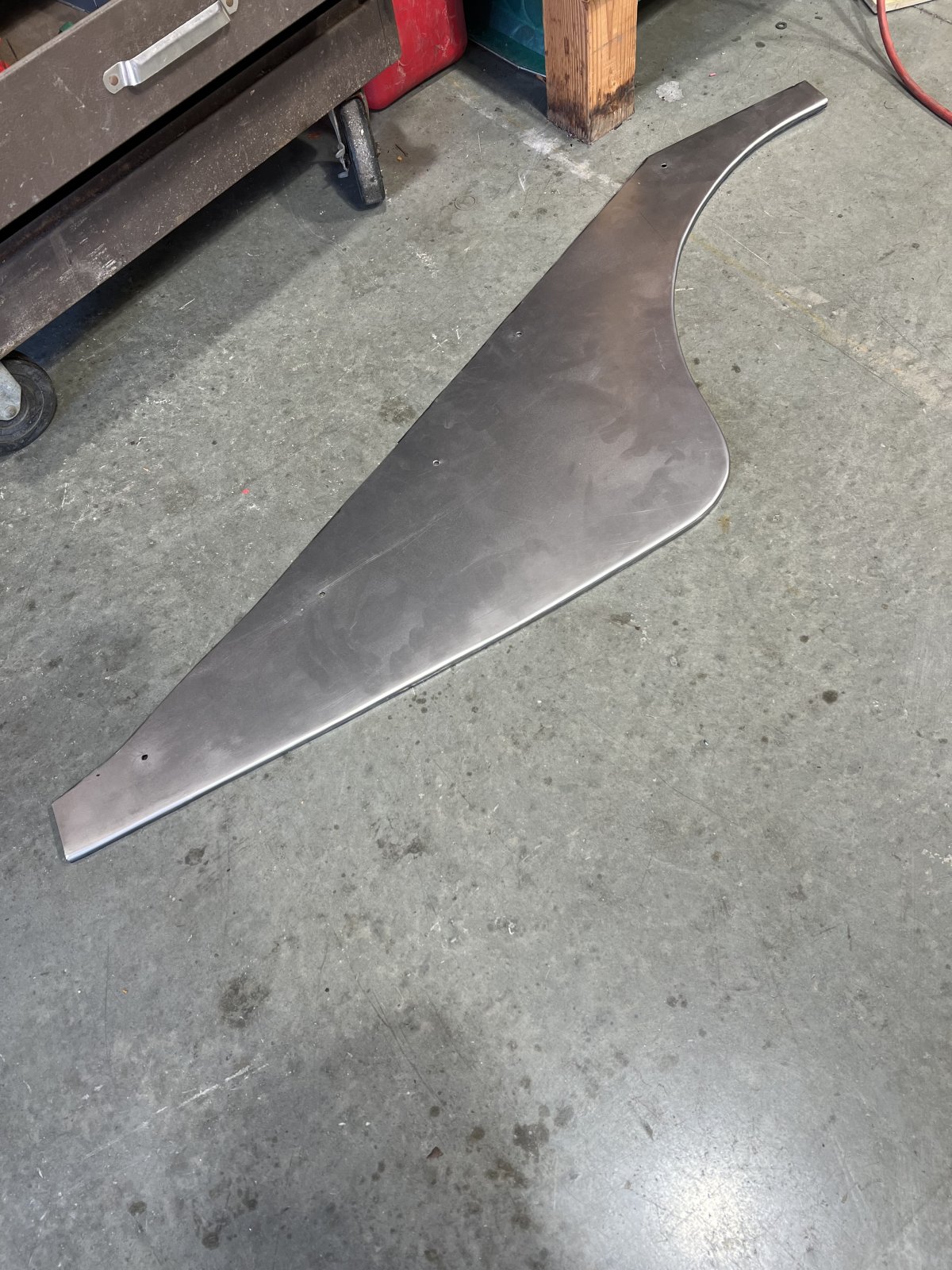

    IMG_1351.jpeg 7DABE4DB-F217-4969-B323-8DC592CFE3DC.jpeg IMG_4681.jpeg IMG_0613.jpeg IMG_0612.jpeg This next bit I made once, and didn’t come out perfect so I started over from scratch. I’ll just post the one . Imagine me doing all that before though haha. I love the old prewar cars Kurtis and Duvall did with the skirted front fenders so that’s what I’m setting out to do
    rob-redm likes this.
  17. heyitsnate
    Joined: Apr 8, 2004
    Posts: 1,774
    heyitsnate

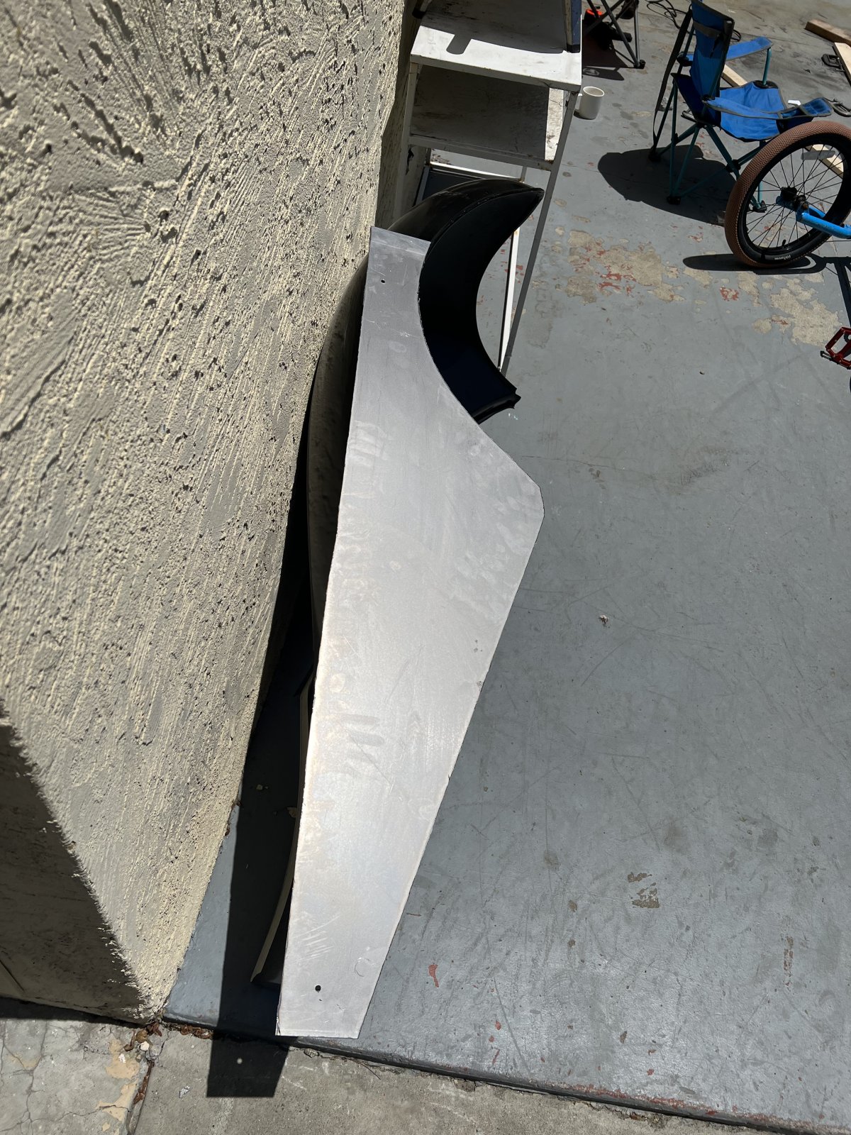

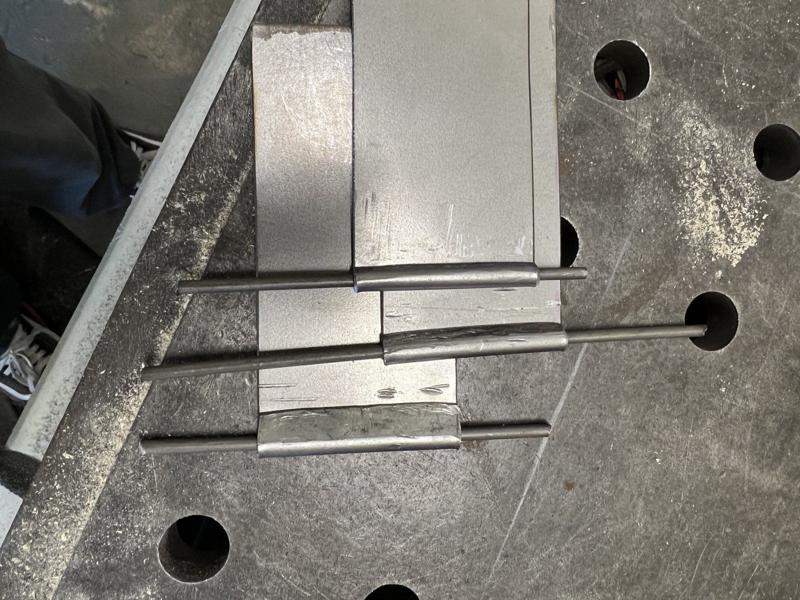

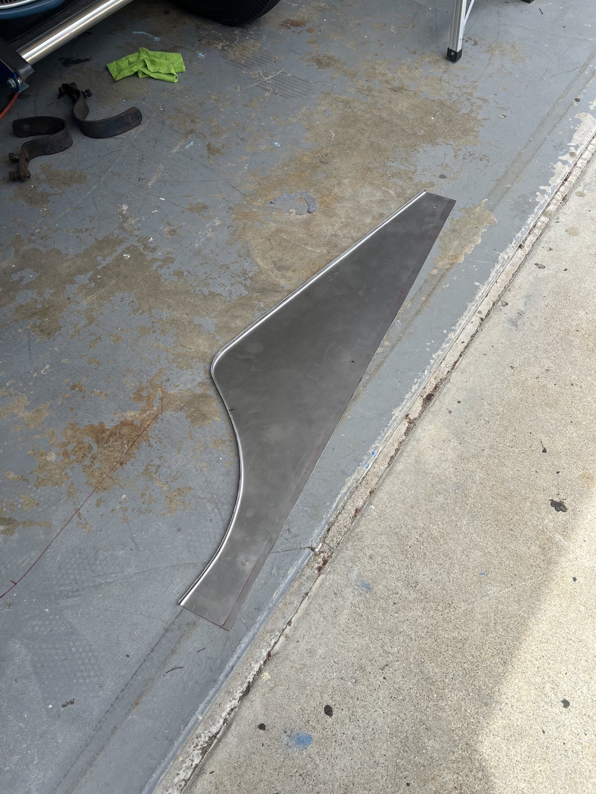

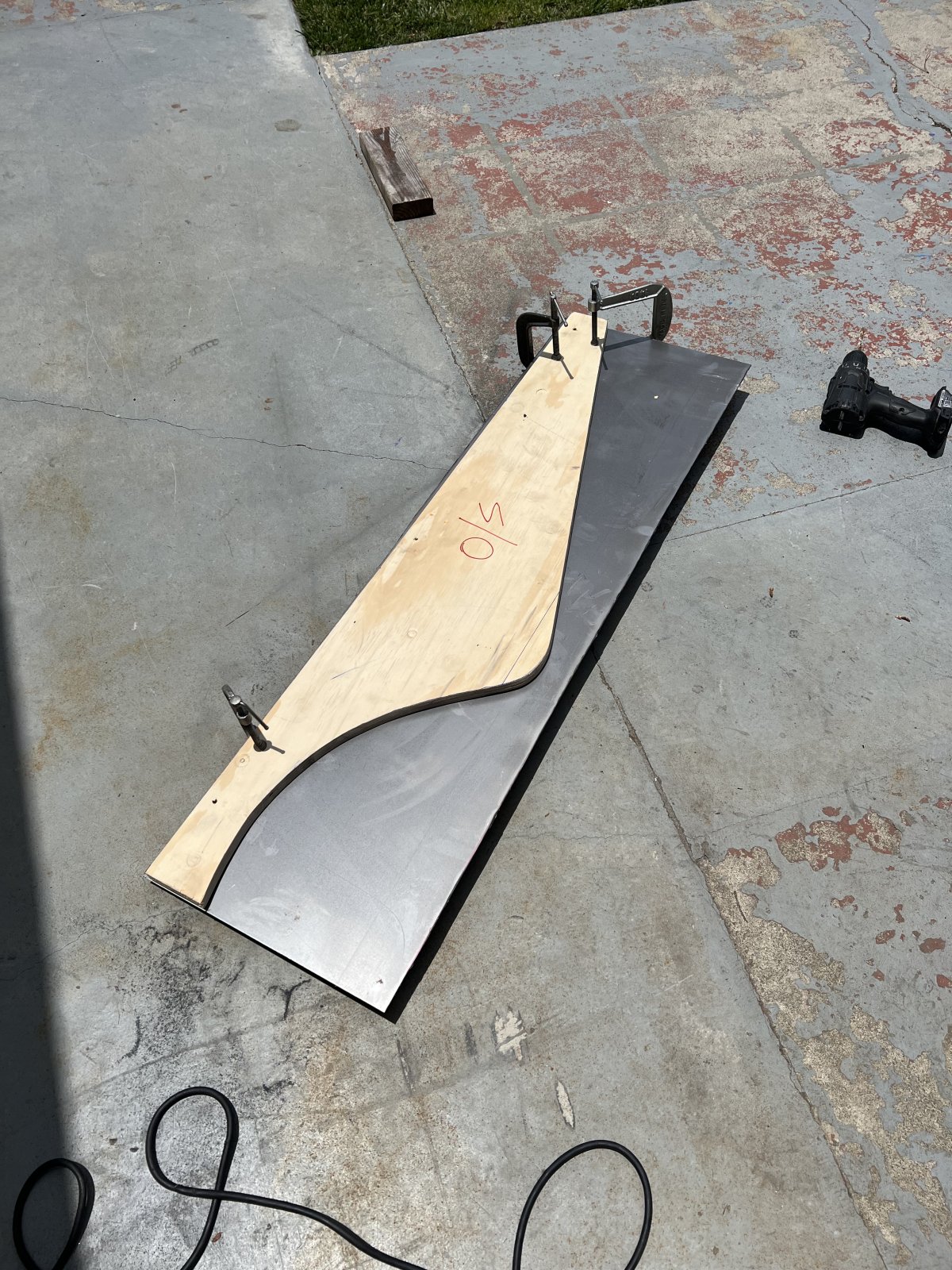

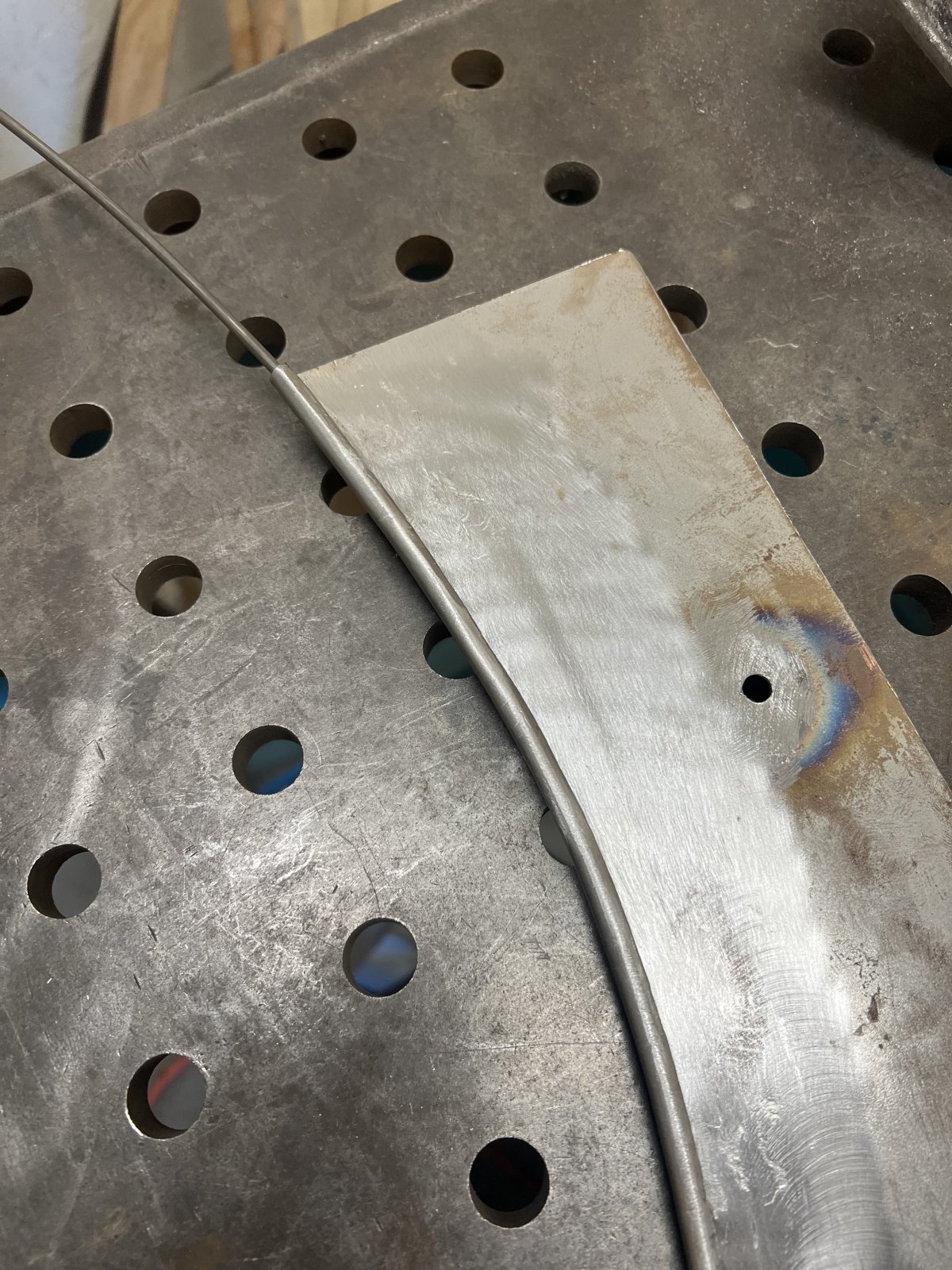

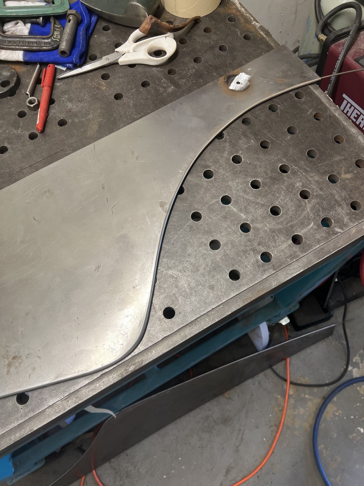

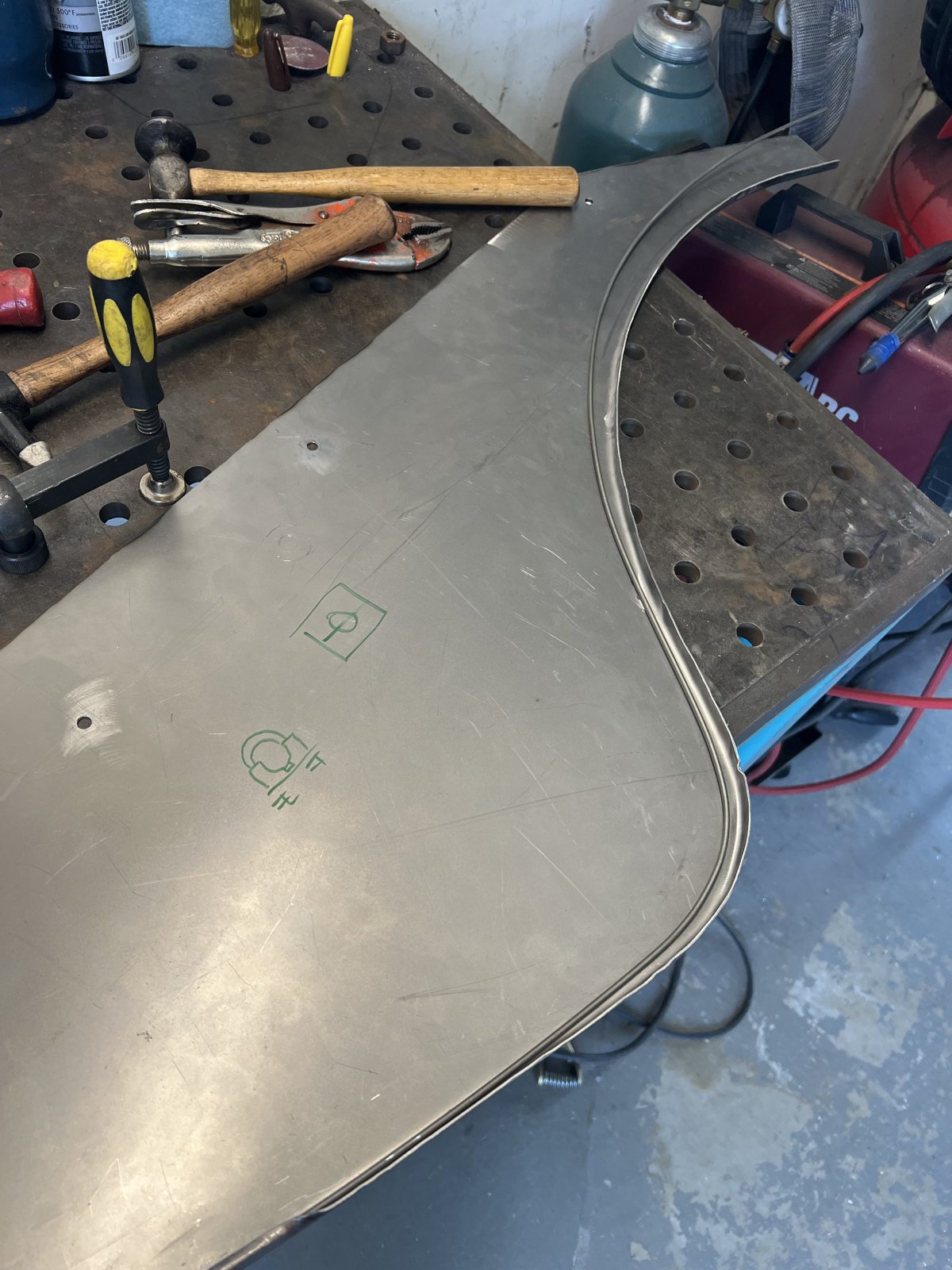

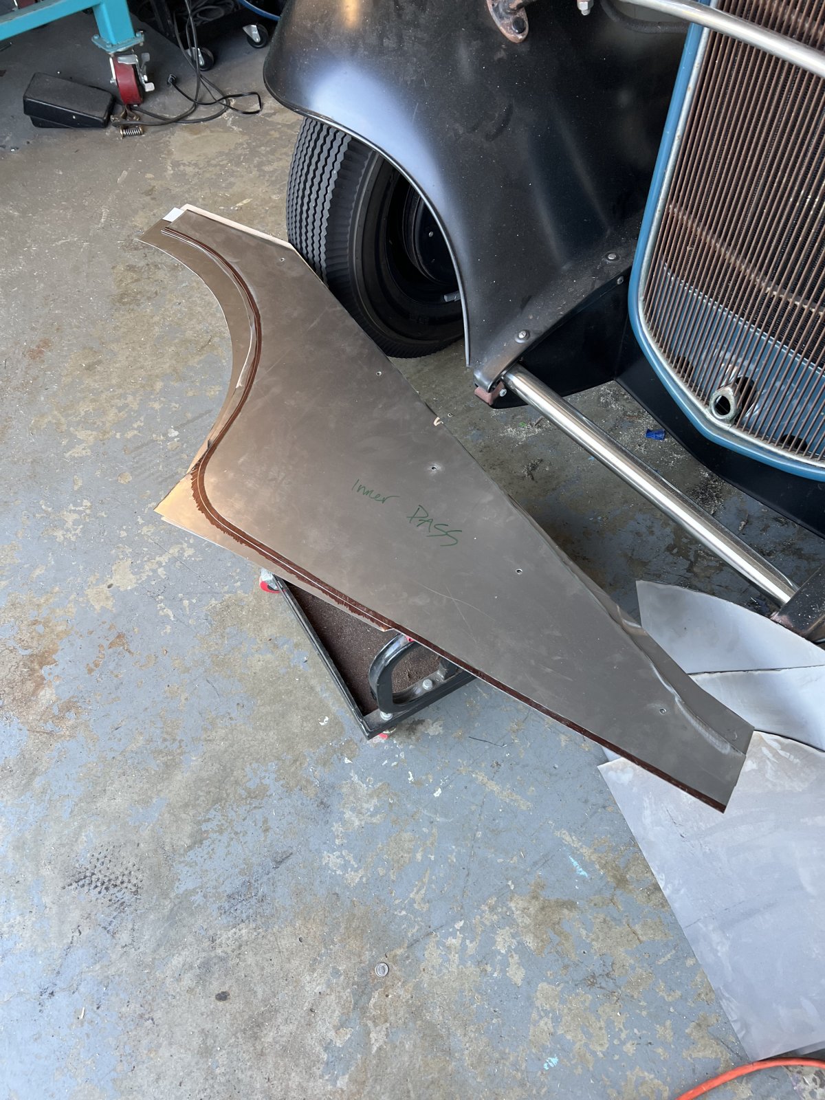

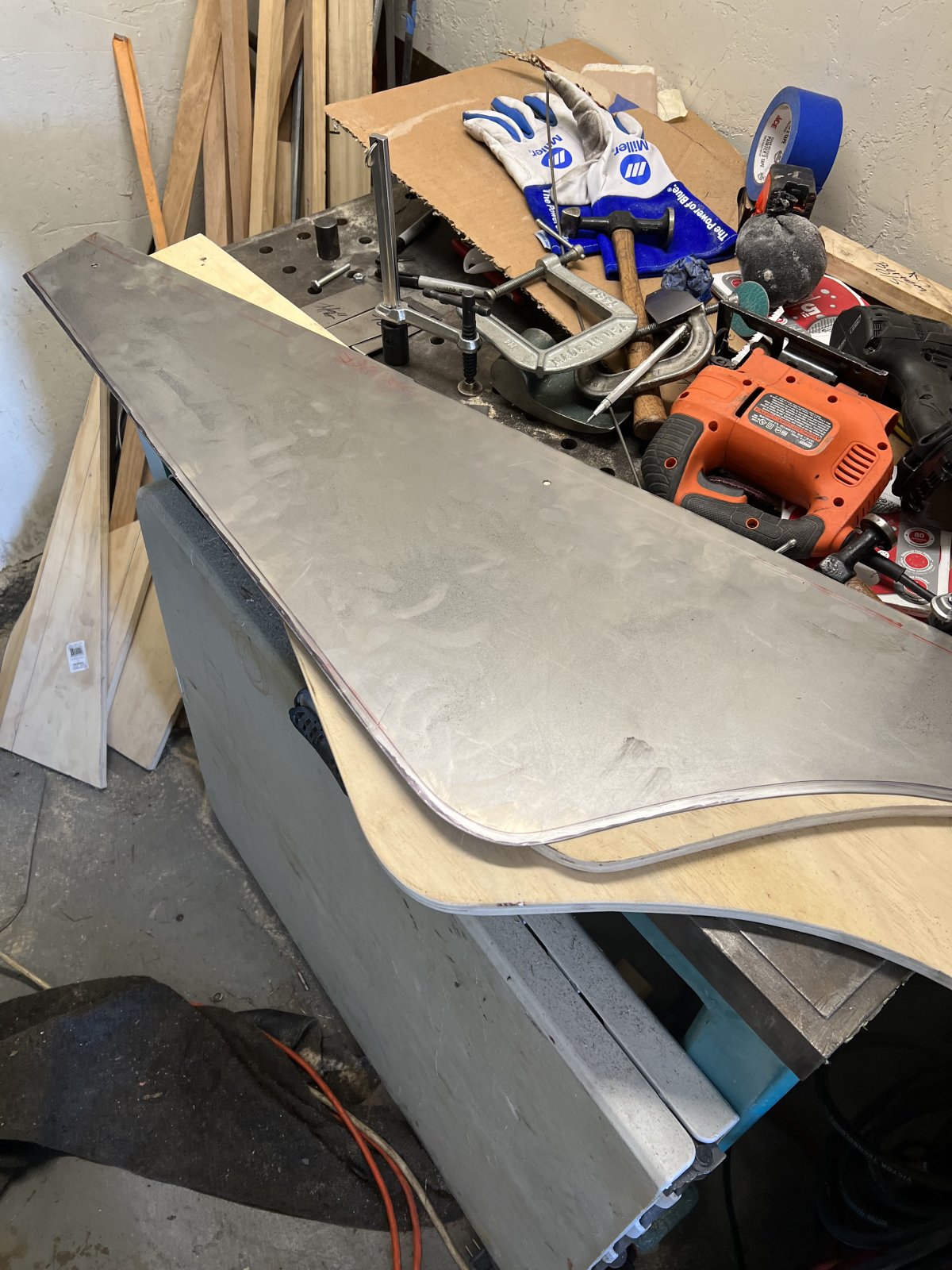

    As you can see above I made a model and Jason killlpack made one too a long time ago. Now we get into the real work . Pretty straightforward. These are the first ones and some wire edge tests also. I had the dies but no roller so circle city hot rods put the bead in for me after I wire edged it. The next series is me . I didn’t get the template right so I ended up redoing everything . IMG_4925.jpeg IMG_4928.jpeg IMG_4935.jpeg IMG_4937.jpeg IMG_4952.jpeg IMG_5007.jpeg IMG_5009.jpeg

    And now you’re all up to date. The next thing is t******* shaping and welding these in , then things are coming apart for paint . At that point the engine is getting replaced. This one is ok but it smokes and leaks a lot.

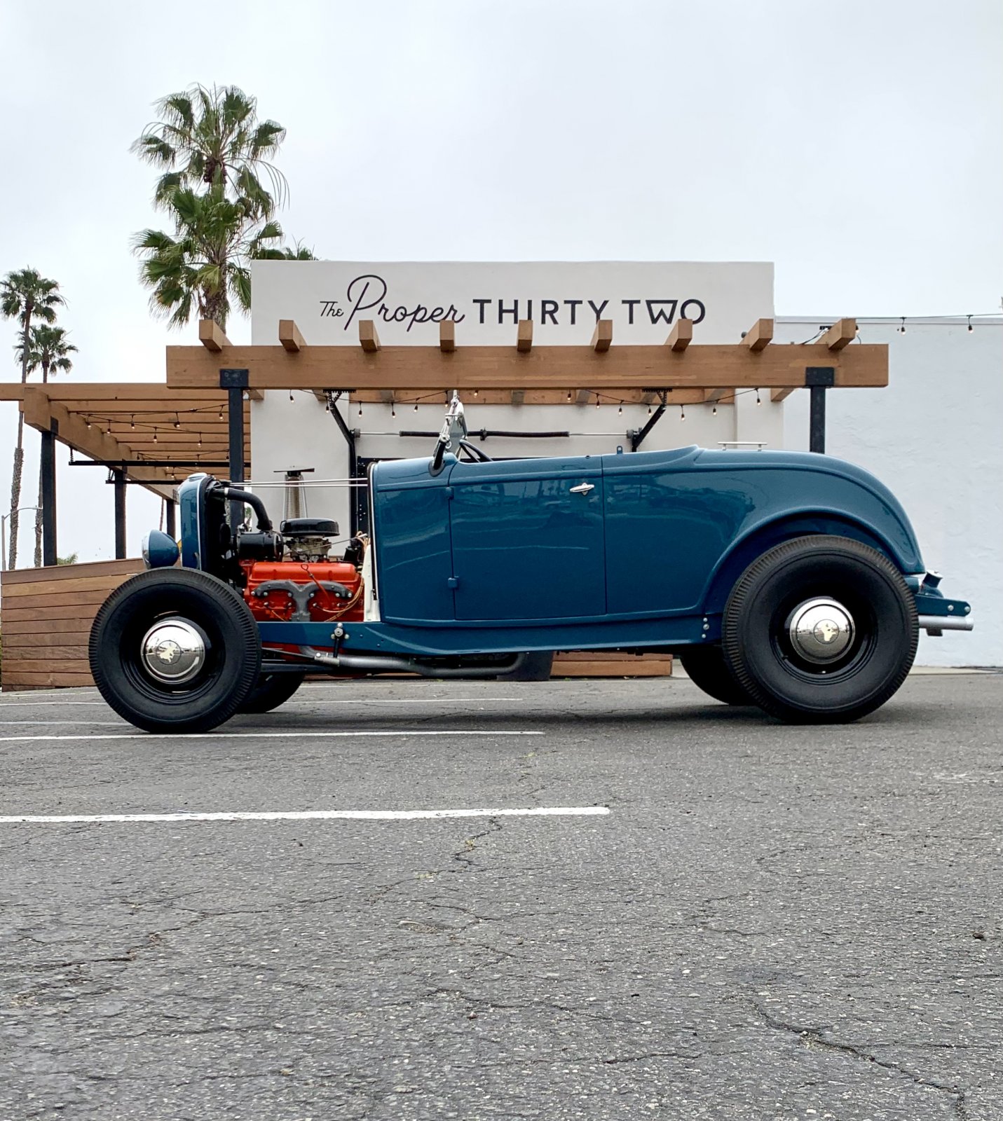

    When I first saw this photo, I thought wow that's it! That's the pinnacle.
    Then I saw this & I couldn't imagine that it could look any better, but now you've shown us the skirted front fenders the stock ones look plain & as if something is missing. Well done, I wish I could get to see this car in person.

  25. heyitsnate
    Joined: Apr 8, 2004
    Posts: 1,774
    heyitsnate
    thanks!
    I hammered the edge on a wood form, then you kinda clamp the wire with vice grips as you go through and hammer it over. If your bend height is 5/16” it covers a 1/8” wire nicely . Then there’s a die with a gap for the wire and you just bead roll that ****er.
    brEad and loudbang like this.
  26. heyitsnate
    Joined: Apr 8, 2004
    Posts: 1,774
    heyitsnate
    Thank you! I was worried it would look weird or it wouldn’t come out as cool as I thought it could
    Outback likes this.
