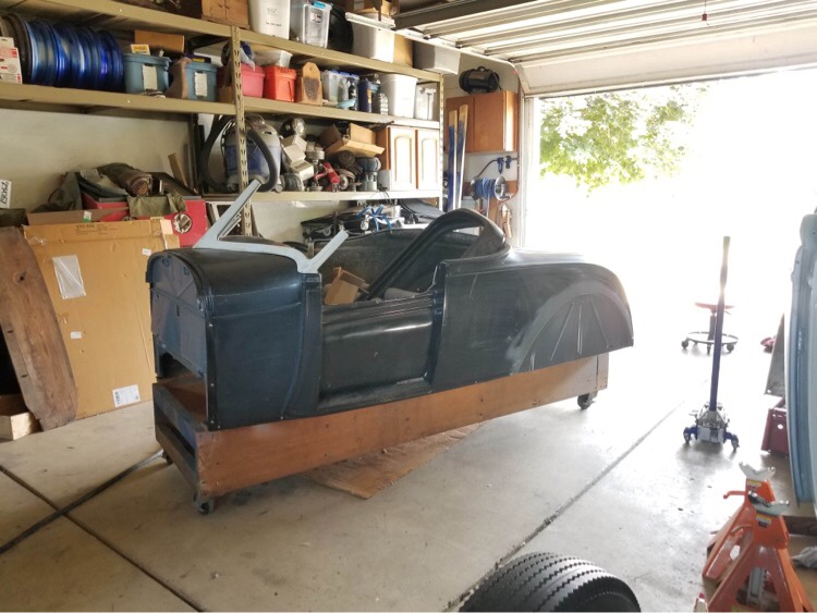

    So, here's the plan (for now): The '52 DeSoto Hemi, pulled out of the wagon I bought in January and have almost finished. The engine was rebuilt, the PO could never get it started (he claimed) after having it back together and back in the car. The points were set wrong, I got it running as soon as I got it home. Anyway, it's fresh, there were a few receipts for parts and machine work in the car, the engine obviously has all new gaskets, the carb appears to be rebuilt, as do the starter, distributor (dual points, that's what he messed up) generator, all fresh and detailed. It'll need an adaptor for (probably) a 700R4 trans, the Fluid Drive and goofy semi-auto are going away.
    The body has a steel firewall and fender wells, floor bonded in, needs doors hung and deck lid mounted. Never finished, never used. Has a wood buck made for a Hallock style windshield, a friend manages a foundry here, so I may have a couple cast to sell and help recoup the cost. I'll build a '32 frame, dropped drilled axle and bones, and use Wilson Welding brakes and Buick drums, in a nod to the '34. I see it black for now with red interior and some red accents here and there, hood top, no sides.
    So, that's the plan. My wife is on board, it'll keep me busy this winter and out of her hair. For now, I'm just shopping for bits to build the ch***is, and have promised not to start on it before the wagon and '59 T'bird are painted.

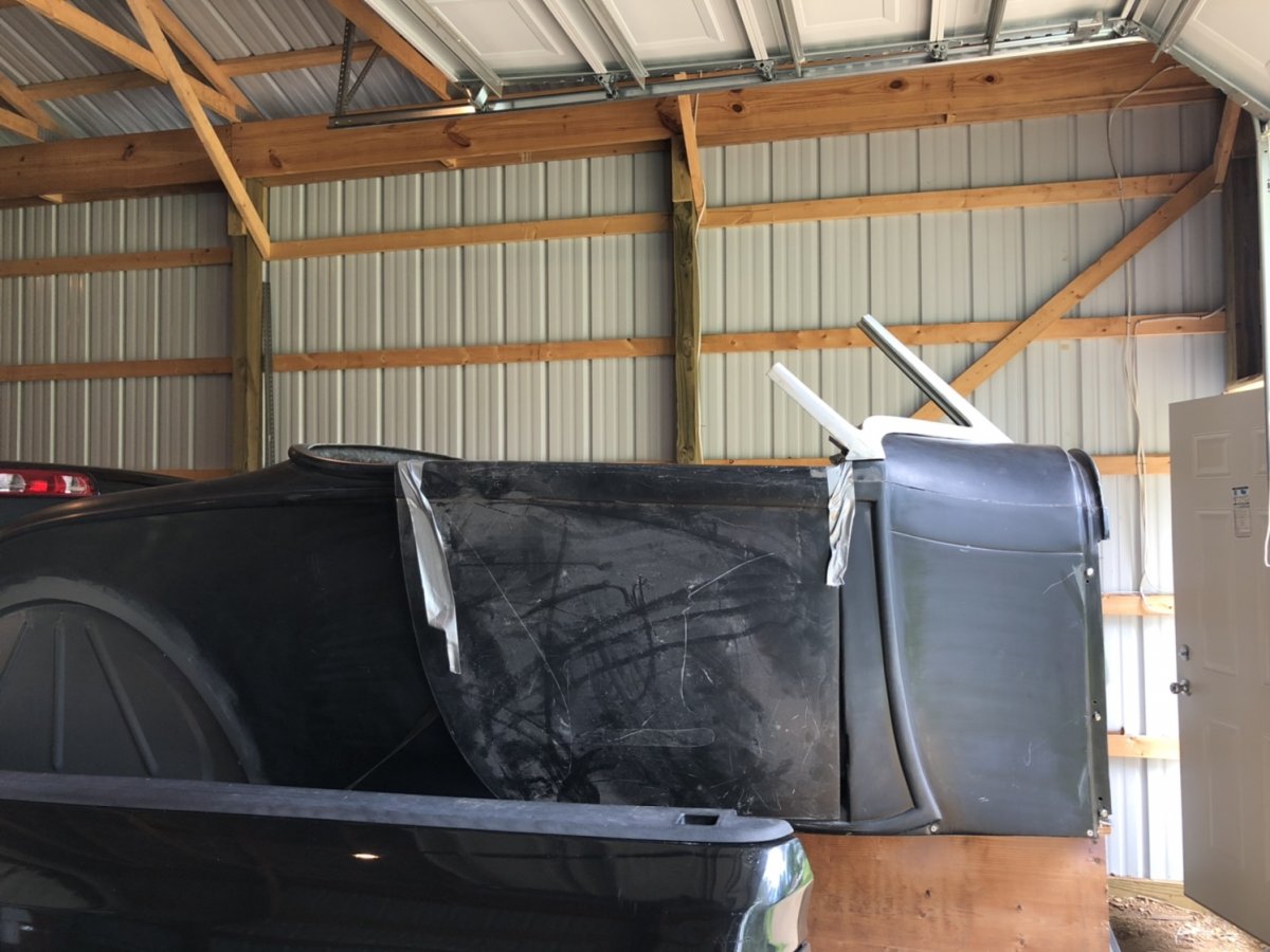

    I don't know what happened with the text, and the photos loaded wonky from my phone (at least in my view of the above post), but the story is that this car was going to built to replicate a well known '50's roadster, with the Hallock style windshield and extended doors, the rear cut line matching the cowl character line. It was on a '32 frame with '40 Ford drivetrain, ended up getting p***ed around and parted out. The windshield buck was built, I'm told by one of the previous owners, by some guys from Johnson Controls in Holland MI, the original car was purple. The windshield buck is amazing, fit's beautifully, and was a feature on the original car. Anyway, that's what history I know. How about that, I end up with a second 'gl*** roadster with some history.

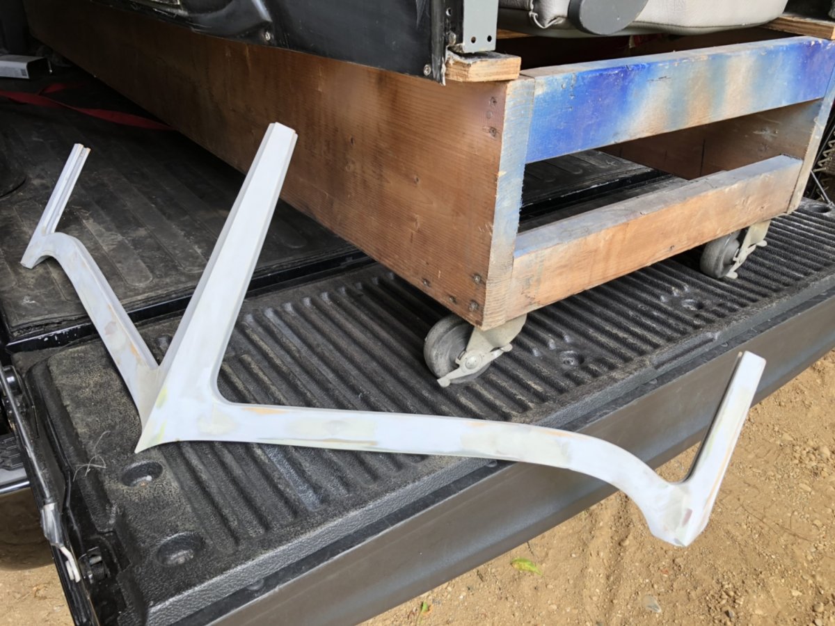

    Went to see my buddy Jay at "Cooper Foundry" to have him ***ess the windshield buck and advise if I could have castings made. Turns out "NO" is the answer. It can't be cast in one piece (economically), and I don't want to cut it up. Wall hanger is the recommended option at this time, so I guess I'll be putting a stock w/s post and stations on it. He wondered if the original plan was to simply use it, which I had wondered, as opposed to a buck for a mold. Since I'm a few owners away from whoever made it, it's a mystery.
