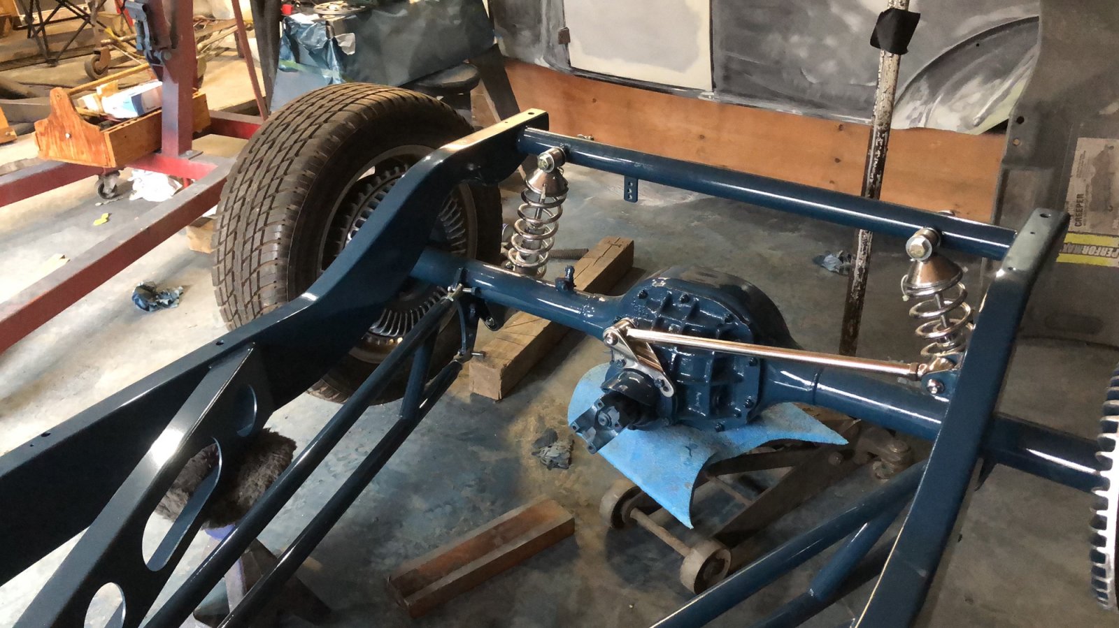

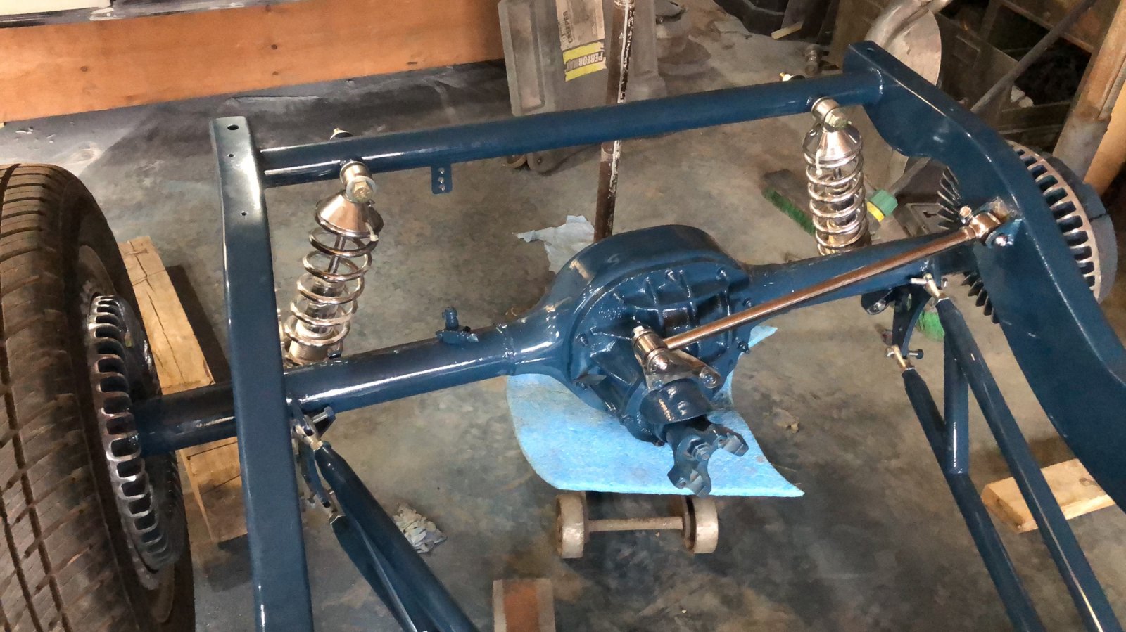

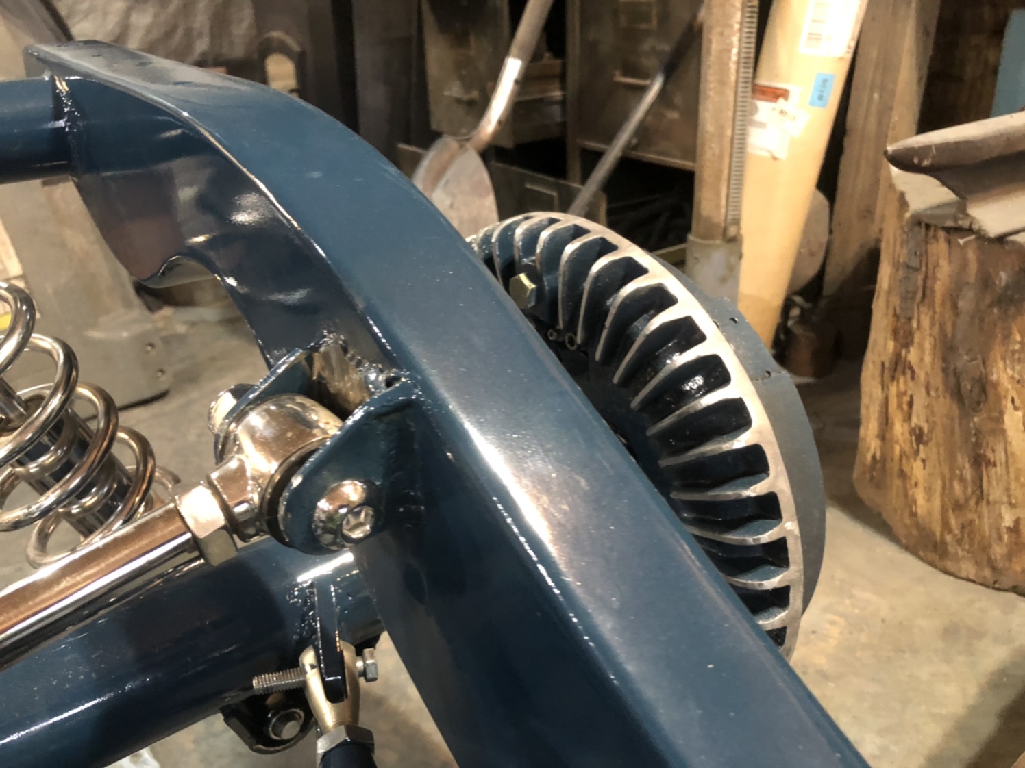

    For some reason, the bar struck the inside of the bracket, which it didn't seem to before disassembly and paint. So, I had to grind some of the bracket away to get some clearance. Yes, I'll brush touch it.

  19. Dick Stevens
    Joined: Aug 7, 2012
    Posts: 4,027
    Dick Stevens
    I wondered about that not being painted, it didn't stack up to your normal quality of work.

    I must have missed that there wasn't enough room for the panhard bar mount in the bracket, but, a little work with a hard disk in the grinder clearances it. I blame Speedway...;-)

    Up on all fours! This makes me happy, although that joy is tempered by discovering I’d gotten 5/8” tie rods instead of 11/16” like the tie rod ends, so I couldn’t mount the steering. Looks like I also need to heat and drop the steering arms a little more, so I’m glad I didn’t paint them. I also discovered that the rear Panhard bar didn’t fit the brackets after paint because I swapped it end for end. The adjustable end eye is fatter than the fixed end, so I ground the frame bracket for clearance for naught.
    Dammit.
    Oh well, I’ll touch that up when I touch up the rear axle housing scratches where it fell off the jack positioning it.
