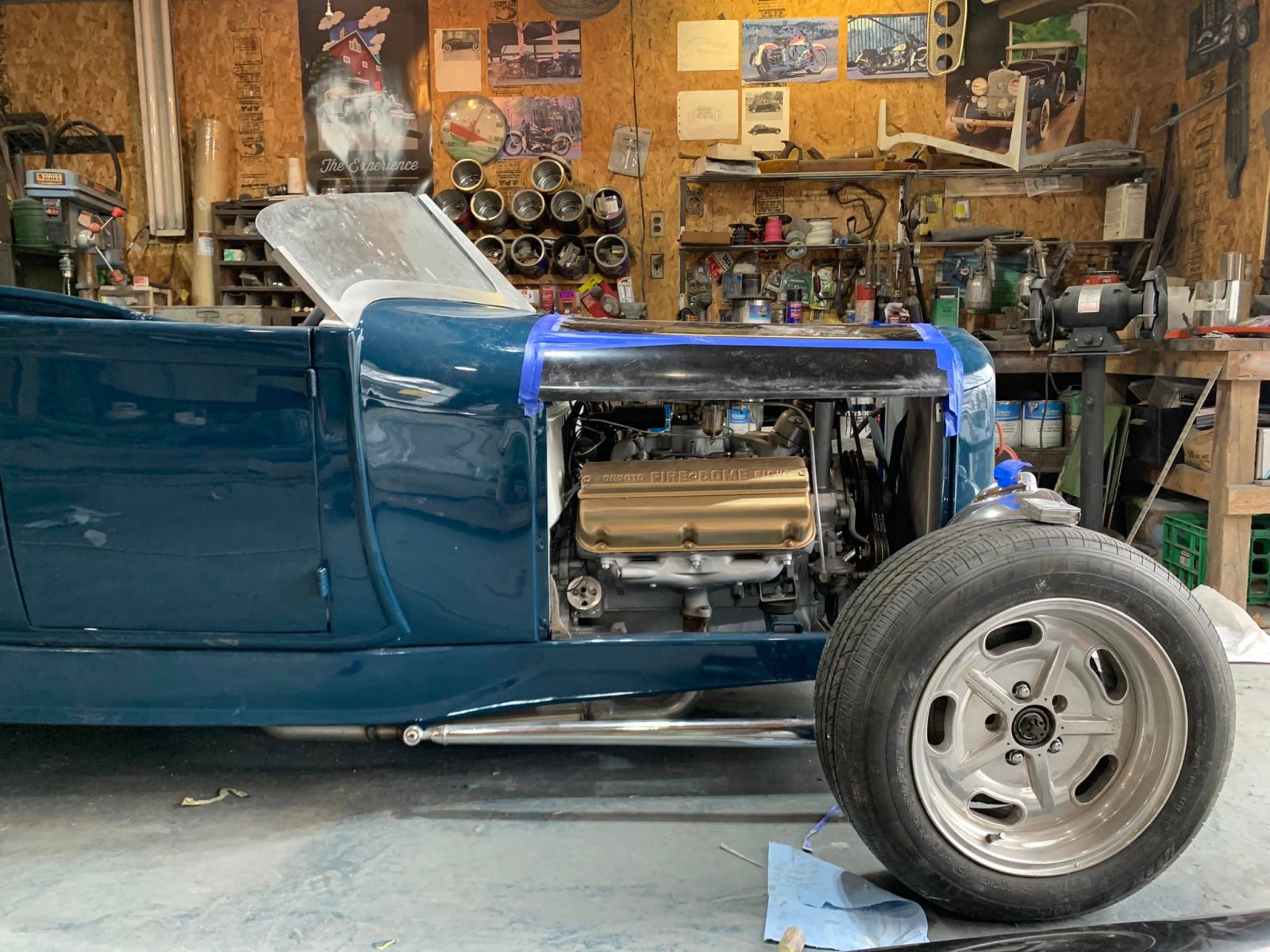

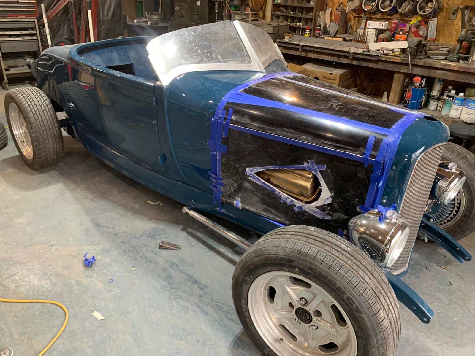

    Uh, well yeah. Cheap 'gl*** '32 hood, cut the top in half and sectioned it to fit, cut down the sides, and hacked a teardrop shape hole to let the Hemi hang out. I'm gonna get an English Wheel from HF and learn how to make speed blisters to cover them heads... D5287E56-1B92-4091-9186-0E16DB157DCC.jpeg FF47D6EA-74A8-4203-A7C5-C460B8684B2D.jpeg 700F98E0-03DC-459E-B5A3-893CFFAC798F.jpeg 58C711B6-B7BB-42D1-AD56-72A35A83A05B.jpeg
  3. 1-SHOT
    Joined: Sep 23, 2014
    Posts: 2,903
    1-SHOT
    from Denton
    Why did you leave the Automatic Transmission Cooler on the motor?

    3 reasons: 1. It's there. 2. The fan would have to trimmed to clear the trans cooler fittings in the radiator. I figure I'll need all the cooling I can get. 3. I kinda like it.

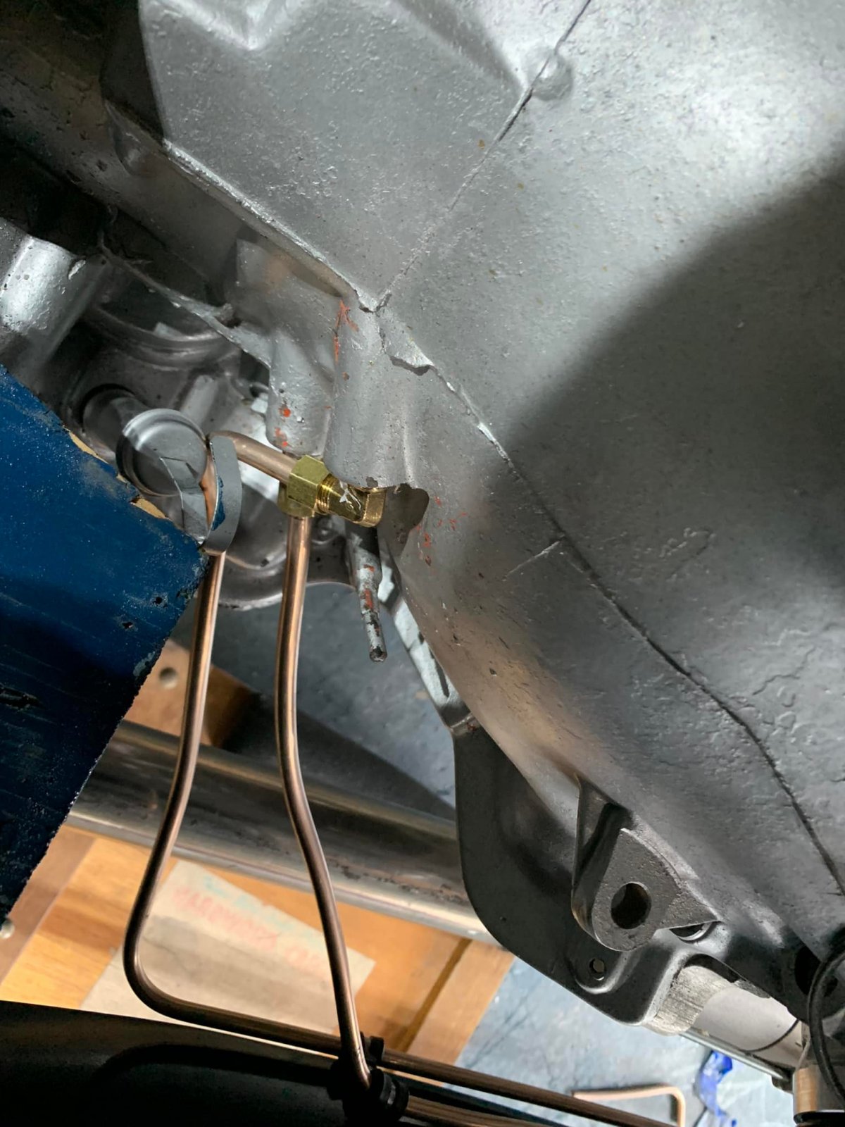

    69EEFC95-1C46-4C18-BBA2-7DDC08D9BC82.jpeg Today's project was twofold: Get transmission lines run to the original cooler on the engine, which I did, and get the brake pedal mounted to the MC bracket and get the plunger in. Success on both counts! The trans lines are hard to photograph, for the amount of time and effort it took it's not really very exciting to photograph, but I feel good being able to check that task off the list.
    The brake pedal was more photogenic, I have a new "Safety Clutch" pad left over from the wagon project, and since I used one as a brake pedal pad in it, thought this one would be appropriate for the roadster. Along with the T6 Texan starter pedal pressed (that's a pun, son) into service as the gas pedal, I don't have plain pedals. Well, maybe one of them is a plane pedal (that's another joke, son), but like 'em.

    Oh, about the that hood... The thing is at least 5/16" thick, the sides are so rigid they won't lay against the slightly curved cowl. This bothered me, even just mocked up and held on with shipping tape, so I cut a couple reliefs in the back edge which lets it lay flat. Or lay curved. Some Dzus fasteners would hold it all together, so I think I'll try my hand a forming some blisters with pink foam and duct tape, which is how I made the rolled rear pan. Enough filler and Feather-Fill and it'd look fine... A5AC33C0-5F1B-4D80-A957-A2F627048CDC.jpeg

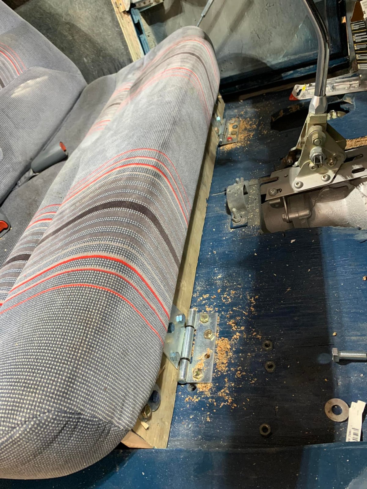

    I didn't get it running or the brakes bled, but I DID get the mystery seat from a buddy and got it mounted. I used some hinges so it flips forward and I have a gate latch to secure it. It'll work with some finessing of the latch, so I'm happy. The upholstery of course is awful (it's from some mini-van), but it'll be easy to recover and make look appropriate. 6CEAAFD8-4171-450B-842F-E5CDC803B771.jpeg 8050AE66-B092-48FE-9038-C295151B725E.jpeg 1E7680F8-9BC8-491B-A7A5-9009538A97C5.jpeg EAD9CE95-78B7-4828-B126-C11DFDC0BE62.jpeg 4307FED4-43C1-4943-94C9-A2FAE283CBE6.jpeg

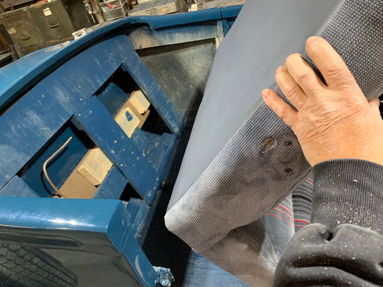

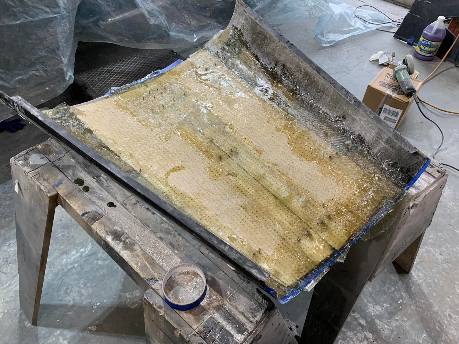

    Ok, enough debating with myself. I'm going to glue the 'gl*** hood top together, paint it, get some leather straps, buckles and Miller springs and run just the hood top. Then, when I have some time, make an aluminum top and sides later. I've gotta get something done or it'll never get done.
    The s****s of aluminum are to hold it together while I 'gl*** up the backside to stick it all together, then I'll flip it over, take them off, and 'gl*** up the topside. It's like glueing a model car together. 46ADC625-D568-4CDE-B7CE-BB396758A8D5.jpeg 4EB71514-42D1-4AE1-87C3-1E3DDE66F227.jpeg 118C61E8-D590-46EB-B804-3F88180E0C76.jpeg

    I never seen perforated mat before

    Neither have I. The panels are extremely thick and heavy. Side panels are the same perforated mat, and are at least 5/16" thick. It's not my first choice of materials, I want to build an aluminum hood for it, but I can use these in the interim.

    We use to have Woven Rover it looked like a blanket woven out of 3/8 cord like yow would use in a chopper gun. I have used a lot of both.

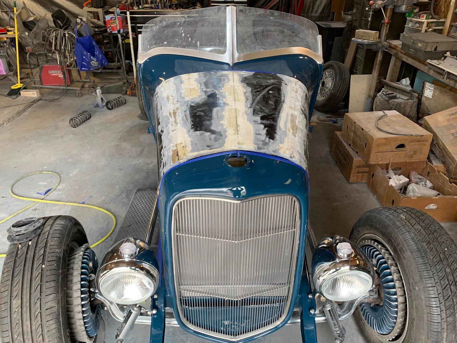

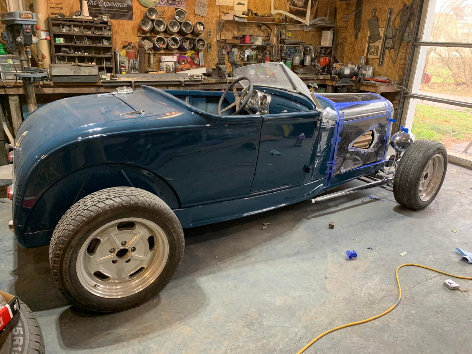

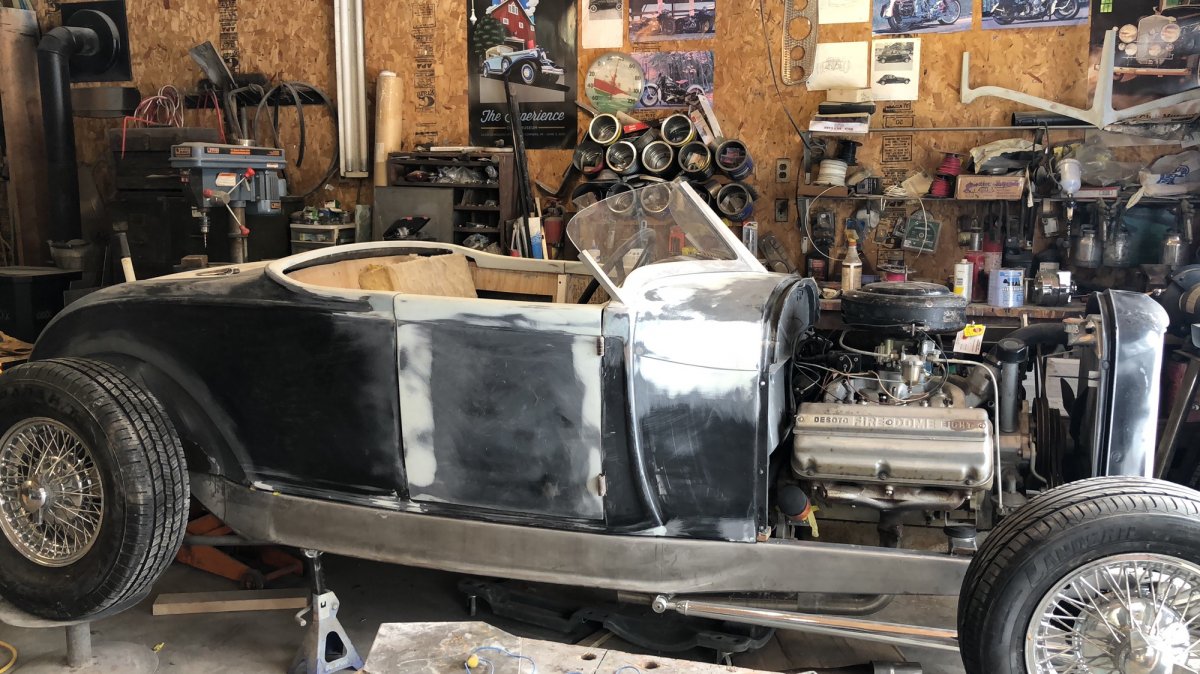

    It's not pretty, yet, but the '32 hood top is now a '29 with '32 grill shell hood top. I stood back and took a look, the first that hit me was that it's time to clean the shop up. The second realization I had was that I should have noticed yesterday when I couldn't find my impact driver, buffer, wool bonnets and polishing compound when I wanted to polish the little camper. 0DC26A03-B40D-42CA-908F-E0BCBBEE8E85.jpeg DFA94DEF-74DB-43CA-A0D6-7C2A997AB3CD.jpeg

    They tried rubbing nylon stockings on your arms to remover the fibergl*** dust. That stuff gets EVERYWHERE

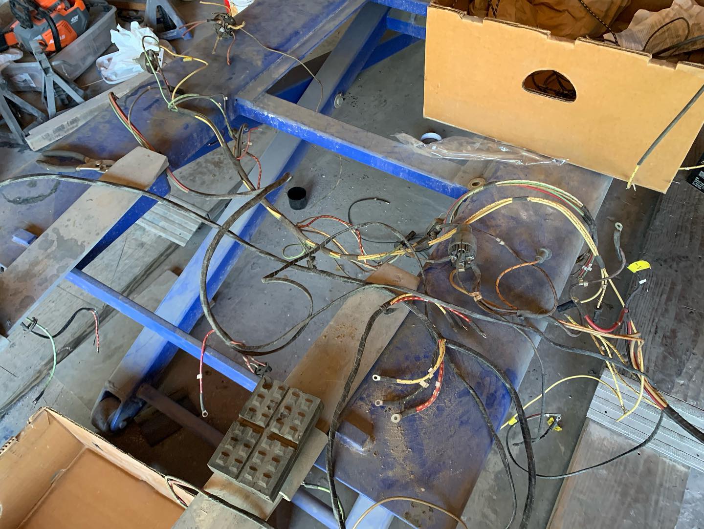

    F228CFC0-8845-43E3-BF06-2D40DACA22B7.jpeg 708EBED0-4D2E-490B-9B48-7CB02081323C.jpeg The DeSoto wagon came with a new, never installed Rhode Island Wiring harness. There's some stuff I won't need or use, but I should be able to weed it out enough to use. I thought it'd look appropriate, and while some of it is wrapped in plastic from RI, it's all linen wrapped wire, in the right colors, and most of the wrapped harness won't be visible anyway.
    I haven't gotten much done, what with summer fun and travel, and working on the other cars. The Diamond T got a new transmission after 10 years of towing and abuse, and I've been picking away at the finishing details of the DeSoto.

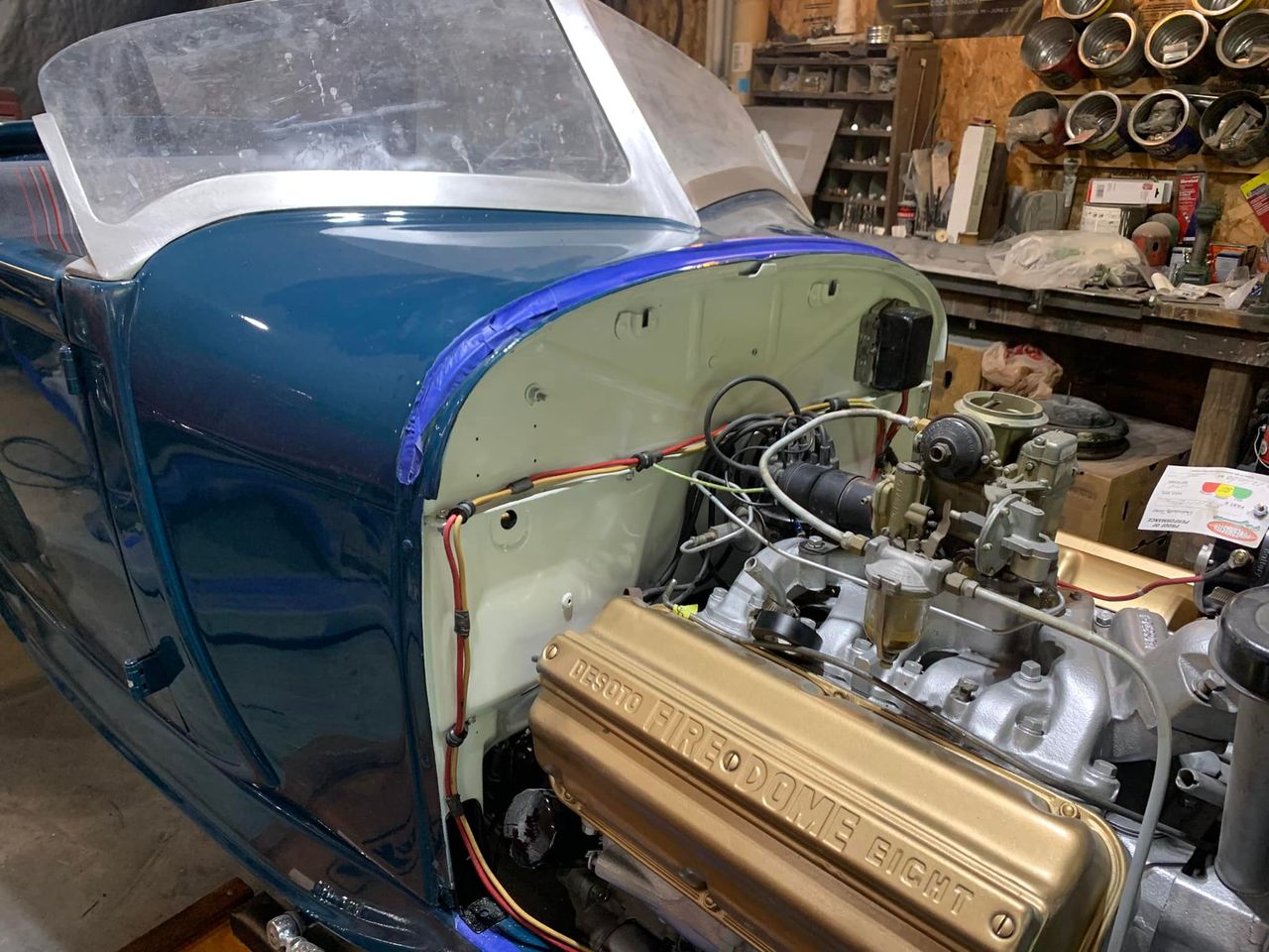

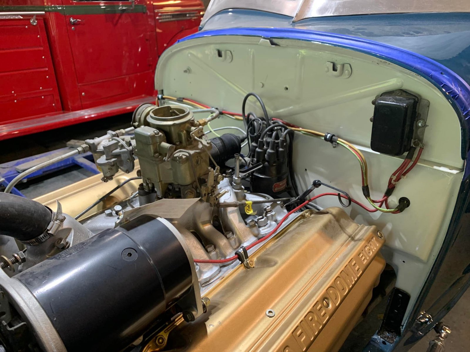

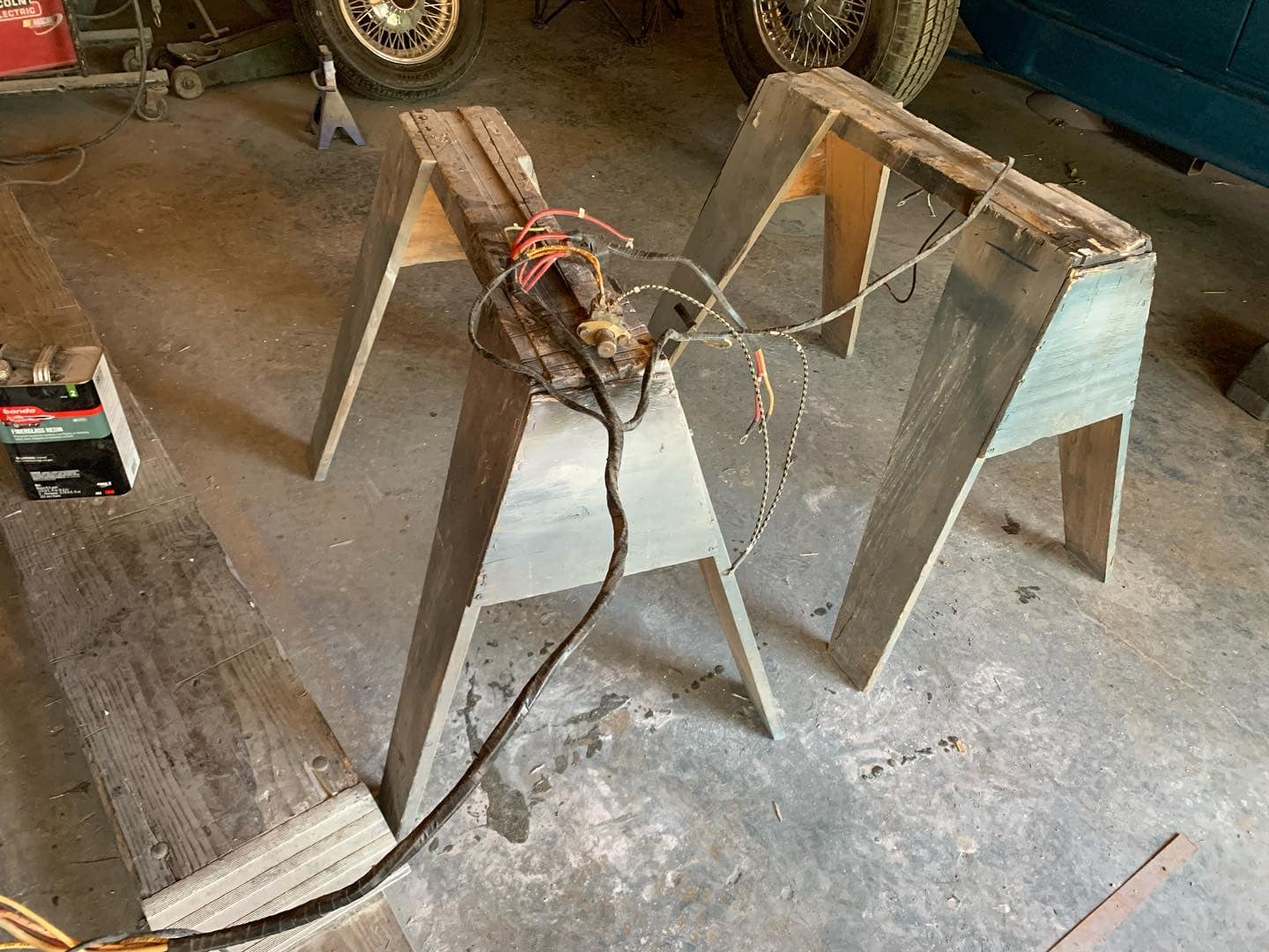

    This is the first chance I've had to work on the roadster since we got back the middle of April! I sorted through and weeded out the original, reproduction (I think it's Rhode Island Wire) harness that came with the '52 DeSoto, and started wiring the roadster. It's going good, although I discovered I don't have an original headlight switch. Went to NAPA, they didn't have any, neither did O'Rielley's or Auto-Zone. So, I ordered a generic one from Summit. I can pull wires to the front and rear, all linen wrapped, for headlights, park/turn, taillights, (what happened, why is the font italics now?) and wire the switch in the dash when I get it. I'll use the original wiper switch for the heater, it's two speed, so it's progress.
    I'm using the NOS voltage regulator as a junction block only, I have a one wire alternator.
