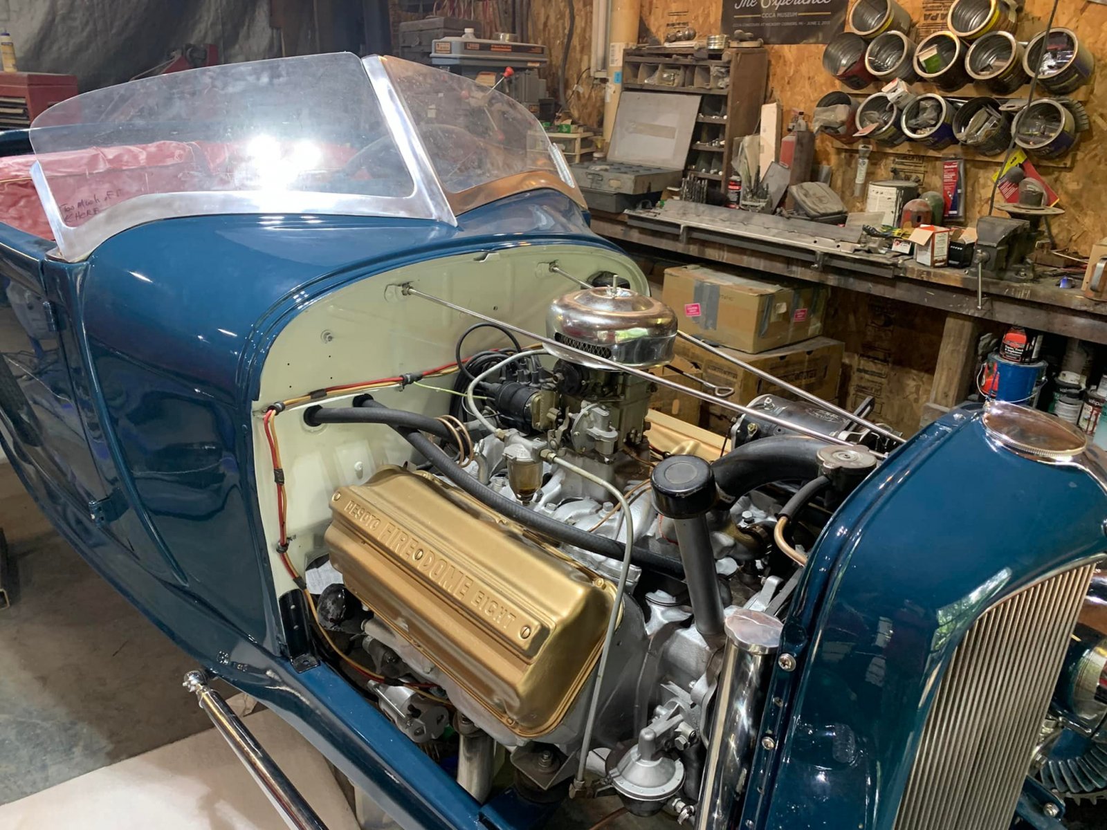

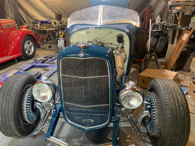

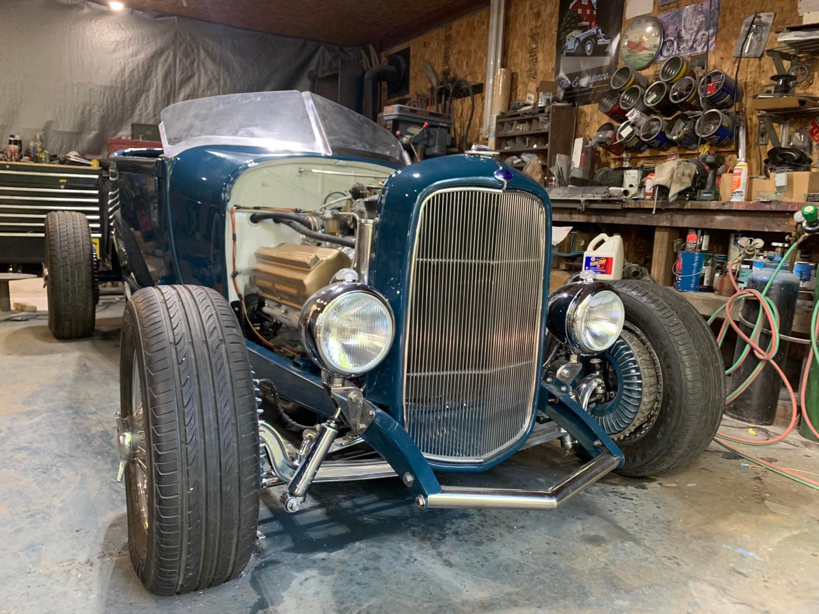

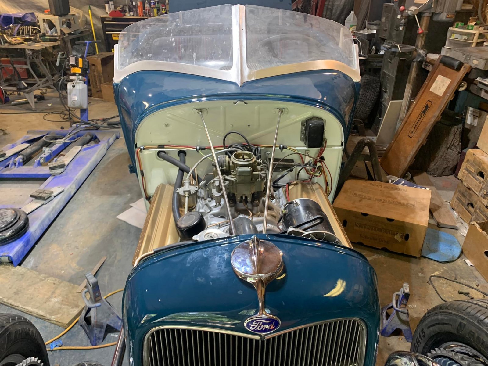

    Christmas in July! Radiator support rods in polished stainless, and a beautiful '32 radiator cap and bezel arrived, and of course I got them unboxed and on the car. I like how the radiator cap and it's bezel compliment the peak on the windshield. It looks great.
    In other news, the overflow tank is ****oned down, and I took care of the awkward terminal strips and wires on the radiator shell I tucked in a little better. I made gas tank retainer clips from conduit clamps and some little bits of rubber fuel line. The tank sets on a wood riser on the wood floor, resting on the tank lip. It looks tidy, although I'm now thinking that straps made of polished stainless might look nice on the painted tank, and be a little more secure in the event of a collision. 3E936D70-C41C-4D07-9773-C6274D5F6CC8.jpeg D2C5C412-EB77-4863-B619-22AB2C61D820.jpeg EE1EA44D-F93D-4AA7-9D87-1C865DF5171A.jpeg 2B0A7CB4-E64B-41FA-8E74-8A80F787CD0F.jpeg

    ^^^^^For a minute there I thought it was hovering!, the stands sorta blend in. Nice work by the way.

    Haha, they do, don't they? I made those things at least 45 years ago, they've been pretty handy.

    Why does the front of your car look like Marty Feldman?

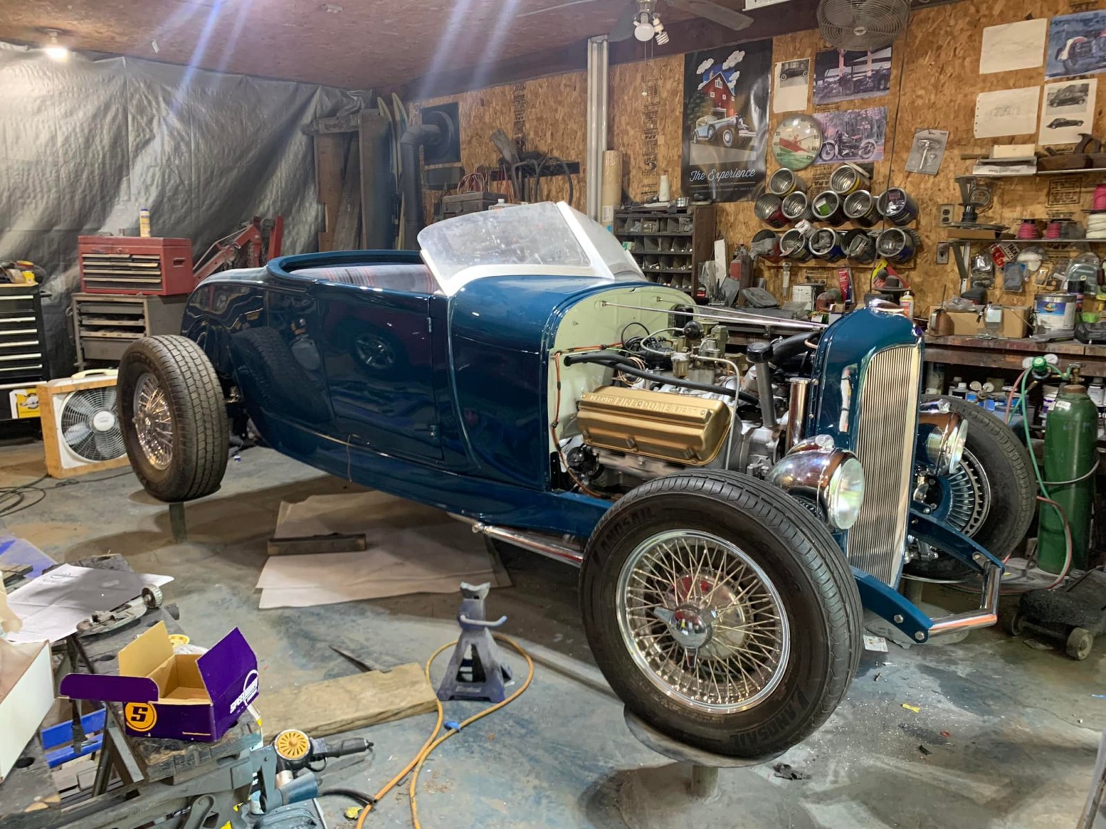

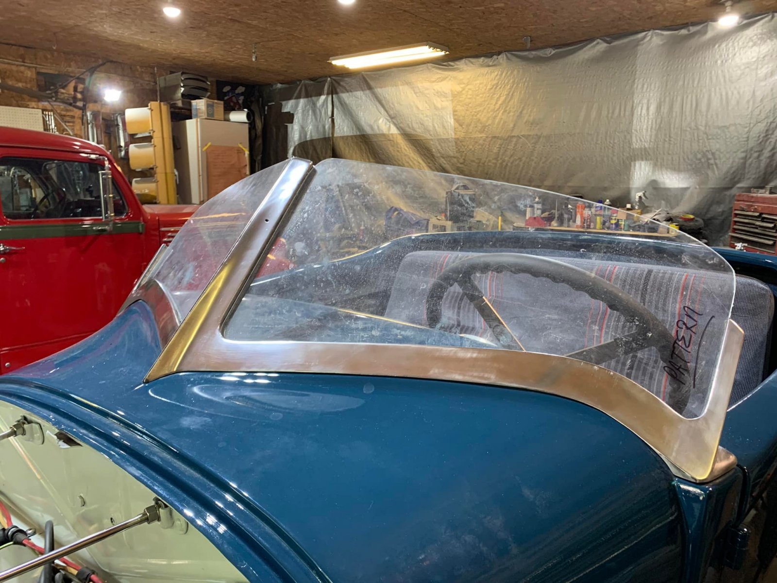

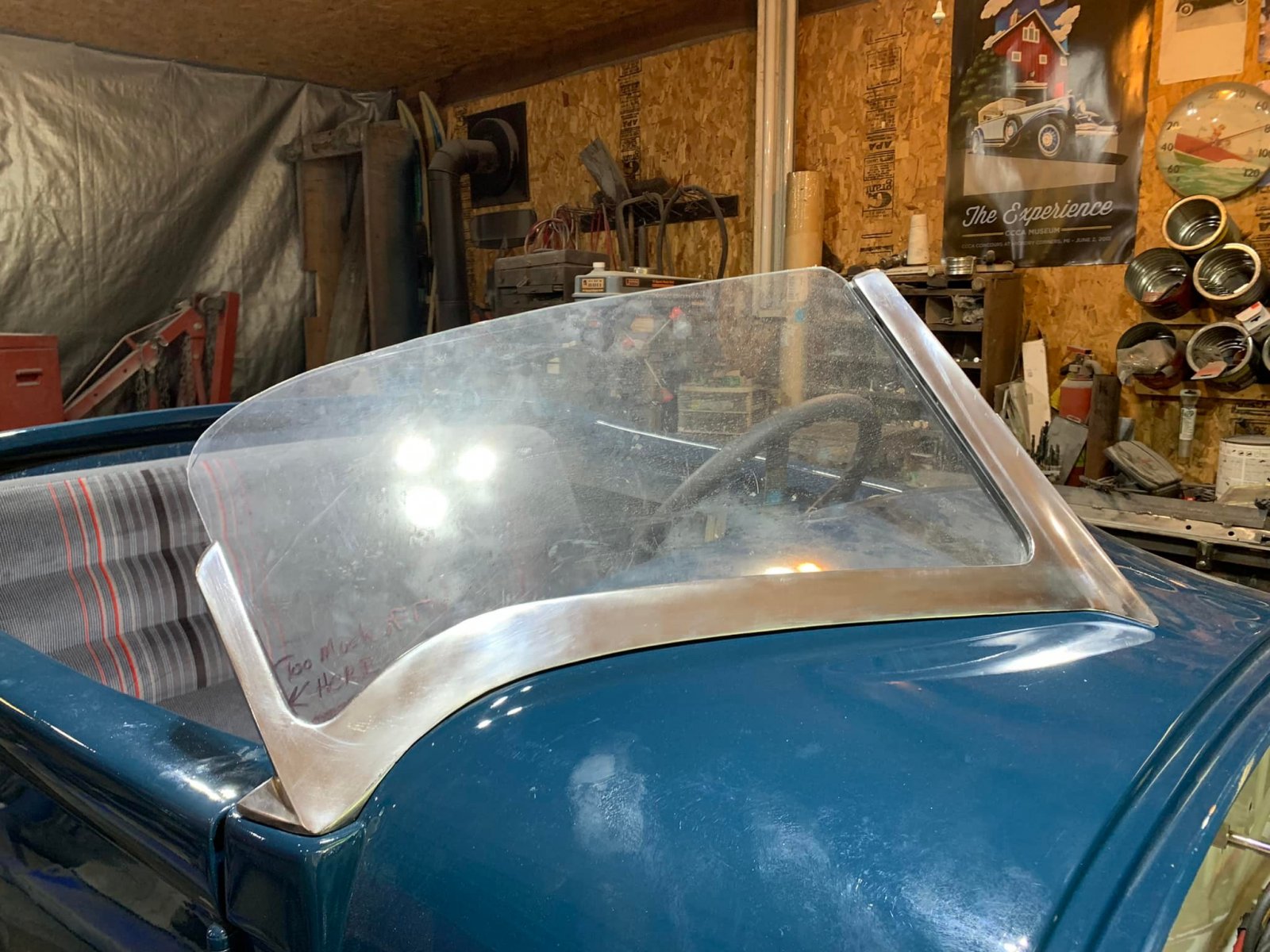

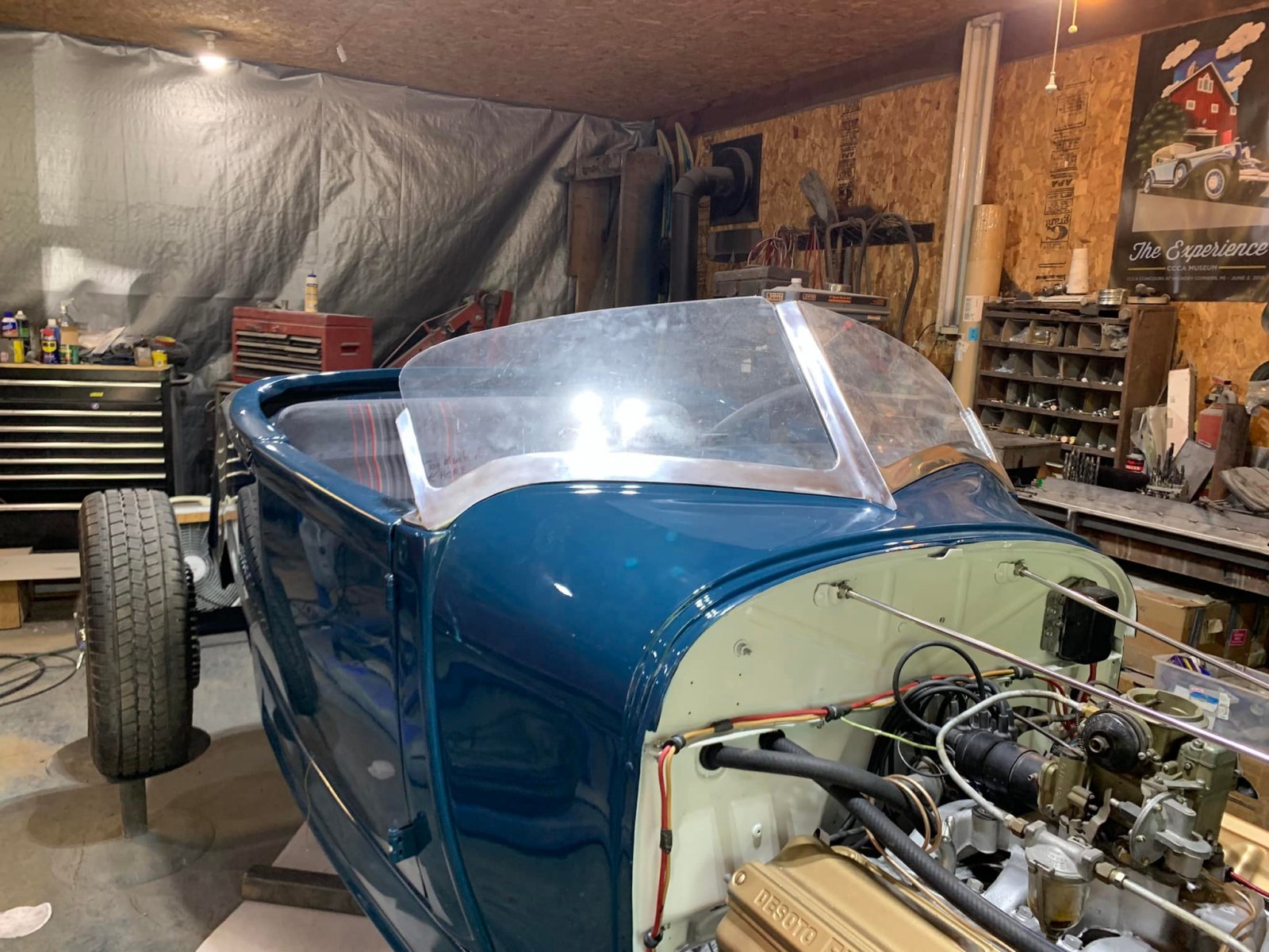

    I polished the windshield frame this morning. Now I can get gl*** cut and get the thing mounted, which means I have to drill holes in the cowl to bolt it in. Which means I'll probably drill holes in the wrong place... C71E9BBD-0996-4DFB-9780-C8E9D4BD8210.jpeg 73B87A05-EE07-434D-82CB-A1F28B3CD994.jpeg 4065A929-213A-4F28-9B9C-10936DB89DB7.jpeg

    I would have thought you would have drilled them before you painted it.
    Stogy likes this.
  8. flynbrian48
    Joined: Mar 10, 2008
    Posts: 8,730
    flynbrian48
    One would think, wouldn't one? :p On the plus side, there's a reveal on the cowl that I had to make to meet the w/s frame, the mounting studs in the frame will go through that, so, unless I'm REALLY off, a wrong one will be covered by the frame and the little gasket between body and w/s frame.

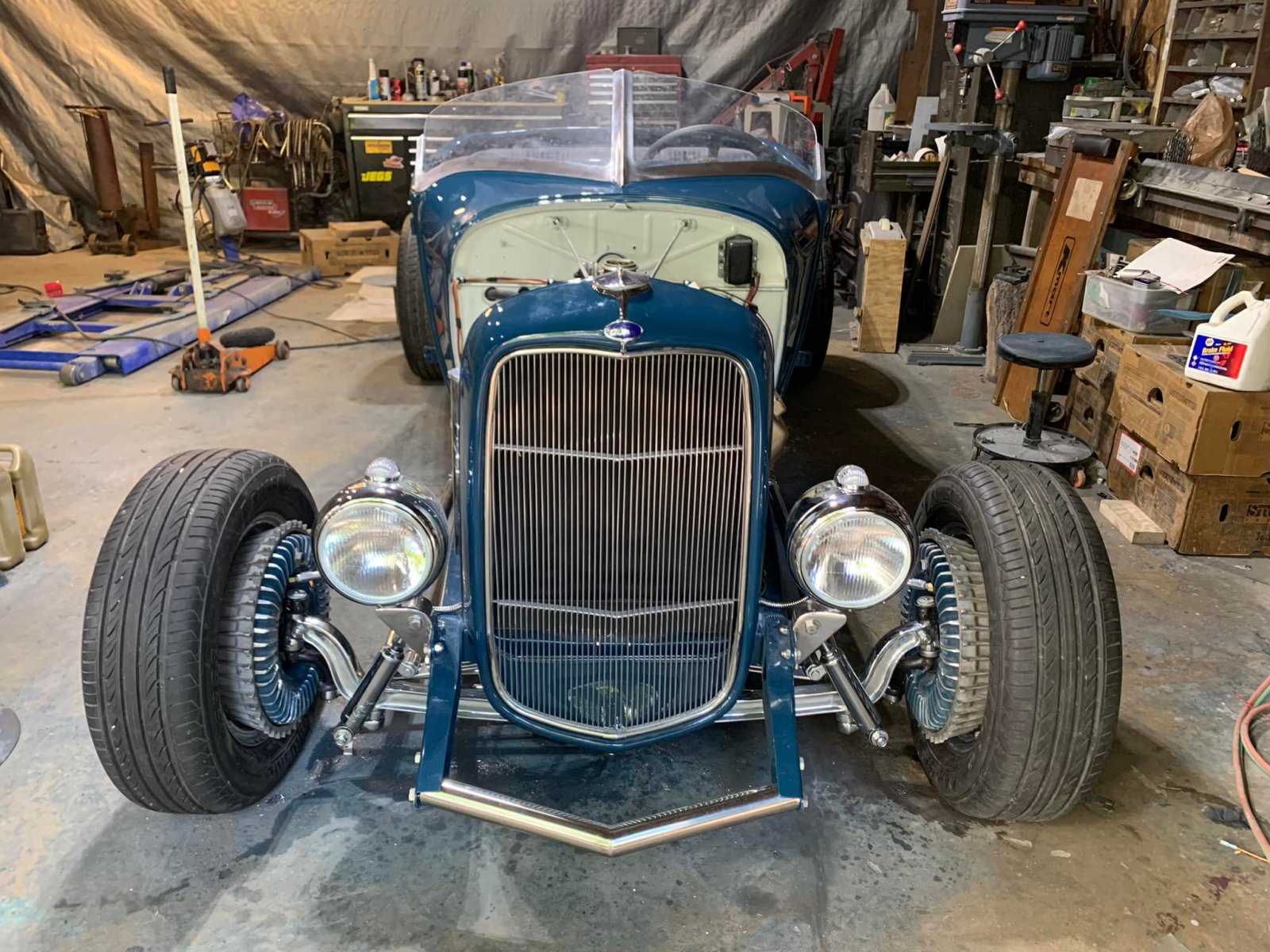

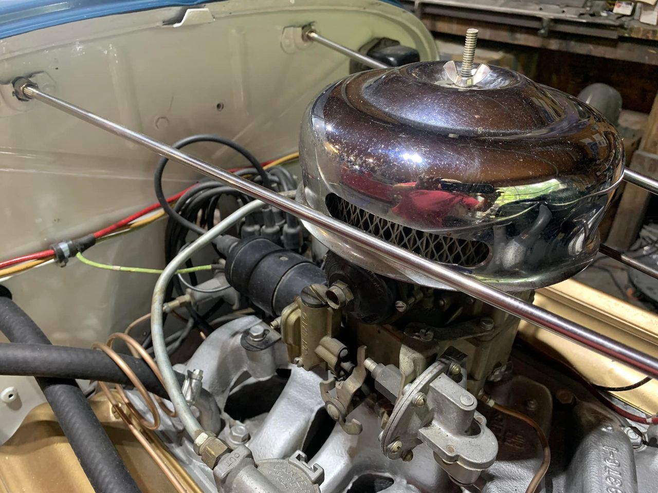

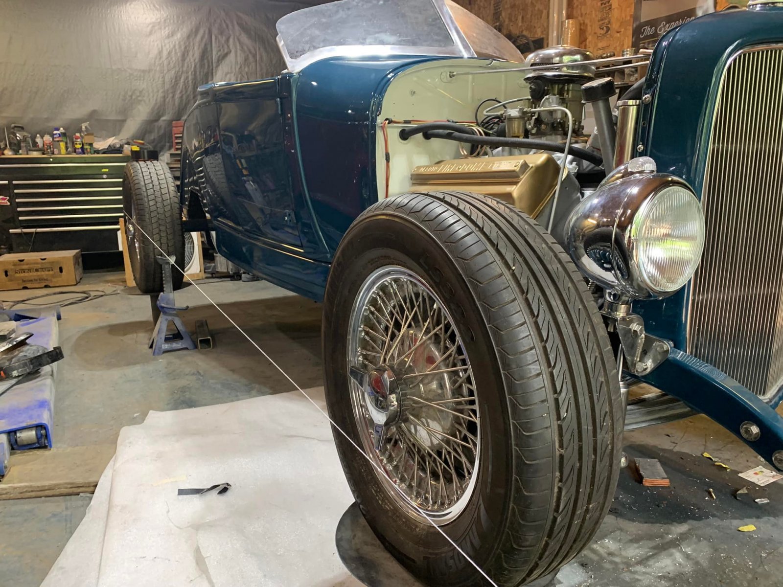

    Lots done today! Front end alignment done, and the front and rear axles squared to the frame and each other. They were about 1/4" out from each other. I gave it 3/16" toe, and clocked the wheel where I want it. Still can't see the gauges through it, a 3 spoke wheel would have been better for that, but oh well. I got the air cleaner finished, decided to use the small chrome one I bought last summer at a swap meet that looks like a Snellings and Hellings, still had to make some relief holes to clear the radiator support rods, but it looks really cool. 2030A99A-C448-4821-A9D7-B9B8D7DD3C06.jpeg 7805CF89-6529-4365-B91D-D09EA82937DC.jpeg 29526E1B-57CE-4F20-B5EC-AA7AD05E280D.jpeg 1D92FE60-5AF2-4749-BAAB-AAC753C53EA9.jpeg

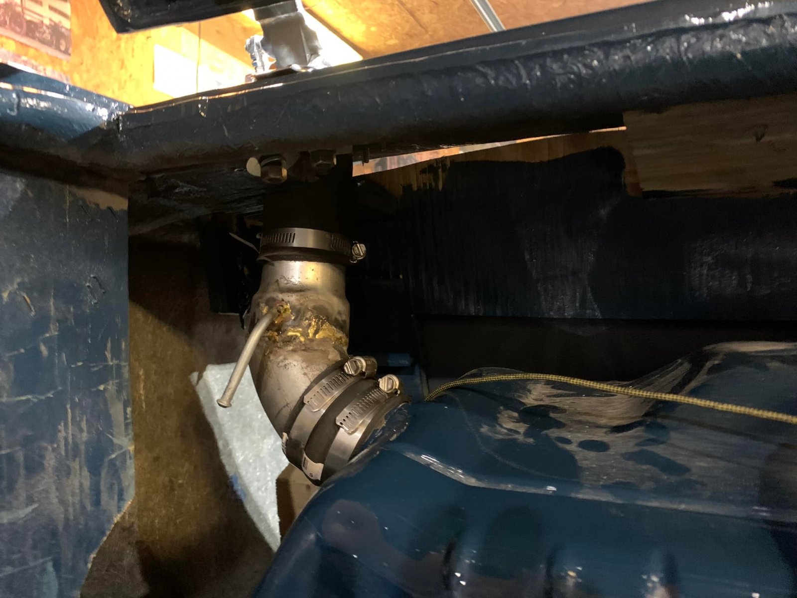

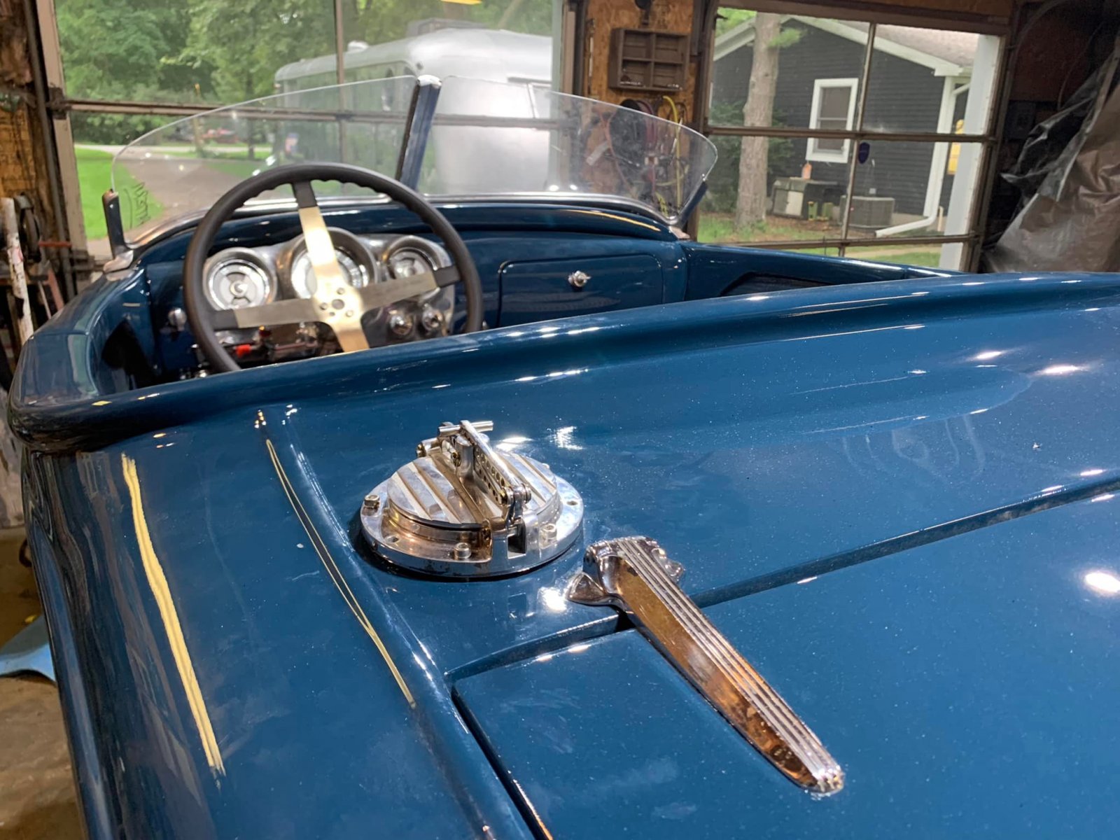

    I FINALLY got the fuel filler hose made and connected the tank to the Crafty B gas cap. I ended up having to braze the filler pipe pieces together, I had to **** them together after t******* each to get the angle right. It's made from a s**** of exhaust tubing bend I had and 2" to 2 1/2" adaptor. The rubber hose has a wire reinforcement which made it very difficult to clamp onto the tank neck, as it was a little less than 2 1/2" OD, but I got it. I'd thought I'd get the brakes bled, but this, and correcting the mount for the coolant recovery tank (the fan would have hit it the way I had it) took all afternoon.

    I realized when I set it on there that the bracing for the body (3/4" plywood), installed after the cap was initially mounted, covers the holes for mounting bolts. So I've got to get some bolts long enough to go through the plywood and be able to access them from inside the trunk.

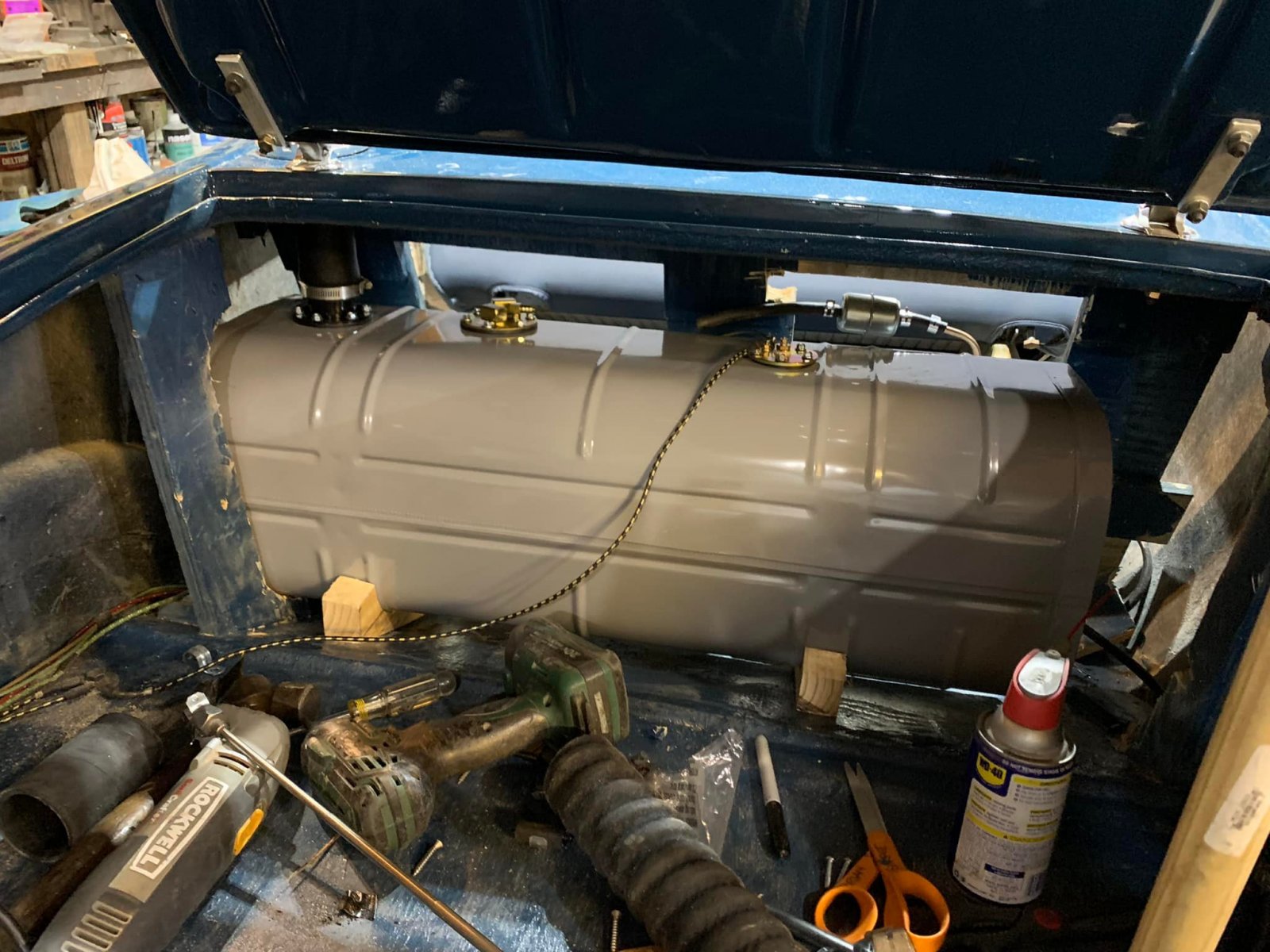

    Todays project was to muck out the shop, put away tools and parts I've left laying around since late April when we got back from Florida and I started working on the roadster again, so I could walk around the shop without tripping over stuff. I did pretty good at that, but stopped before I got to the benches to work on the car again. I got the brakes bled, which was easy once I tightened all the fitting up so there were no more leaks, finished up a few loose ends and greased the ch***is. 50/50 coolant in the radiator, everything good to go. Then I dumped what little gas I had, maybe two gallons, in the tank and tried to fire it up. Fires instantly on a little gas squirted the carb, but never picked up any fuel from the tank. I took the line off at the fuel pump and could blow through it with no "bubbles", and couldn't siphon any from the tank, so I think it just needs more in it.
    I can't blow back towards the fuel pump from the in line filter just ahead of the tank, and can't siphon any there either. Tomorrow I'll get some more fuel and we should have smoke and noise. 006A5225-A72D-4042-BAFD-1A64684632F6.jpeg 2AFDA15D-AD2F-4E20-99C7-A26A9AD33C61.jpeg 2A0F4F8A-391B-402D-8EEF-585FDAAFA76A.jpeg 78A73C44-541E-498E-8227-540056483BC1.jpeg

    The fuel tank turns out to have a pinhole in the bottom, as the bottom of the tank got wet after overnight with gas in it. The distributor rotor fit was VERY sloppy on the shaft (how didn't I notice that?) which probably explain why it ran so erratically and poorly. So, new tank on the way from Tanks Inc., and a Pertronix ignition system. Both should be be here tomorrow so I think I'll make Relix.

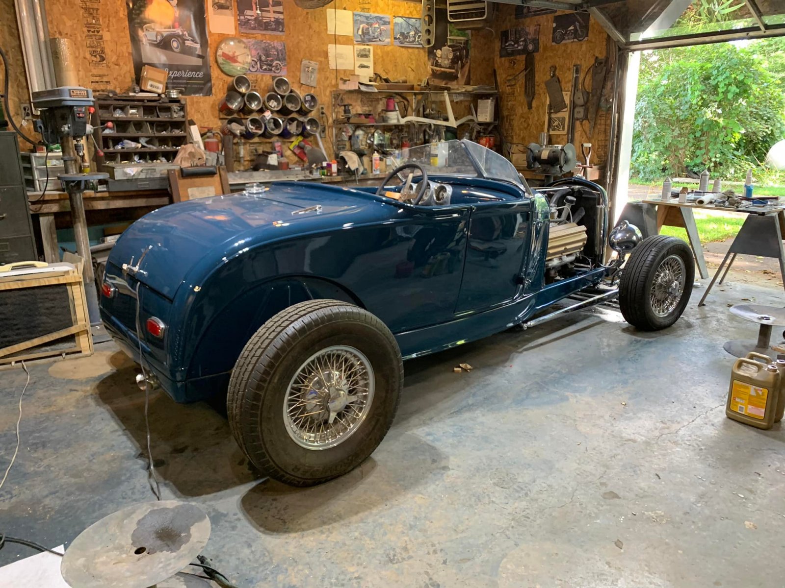

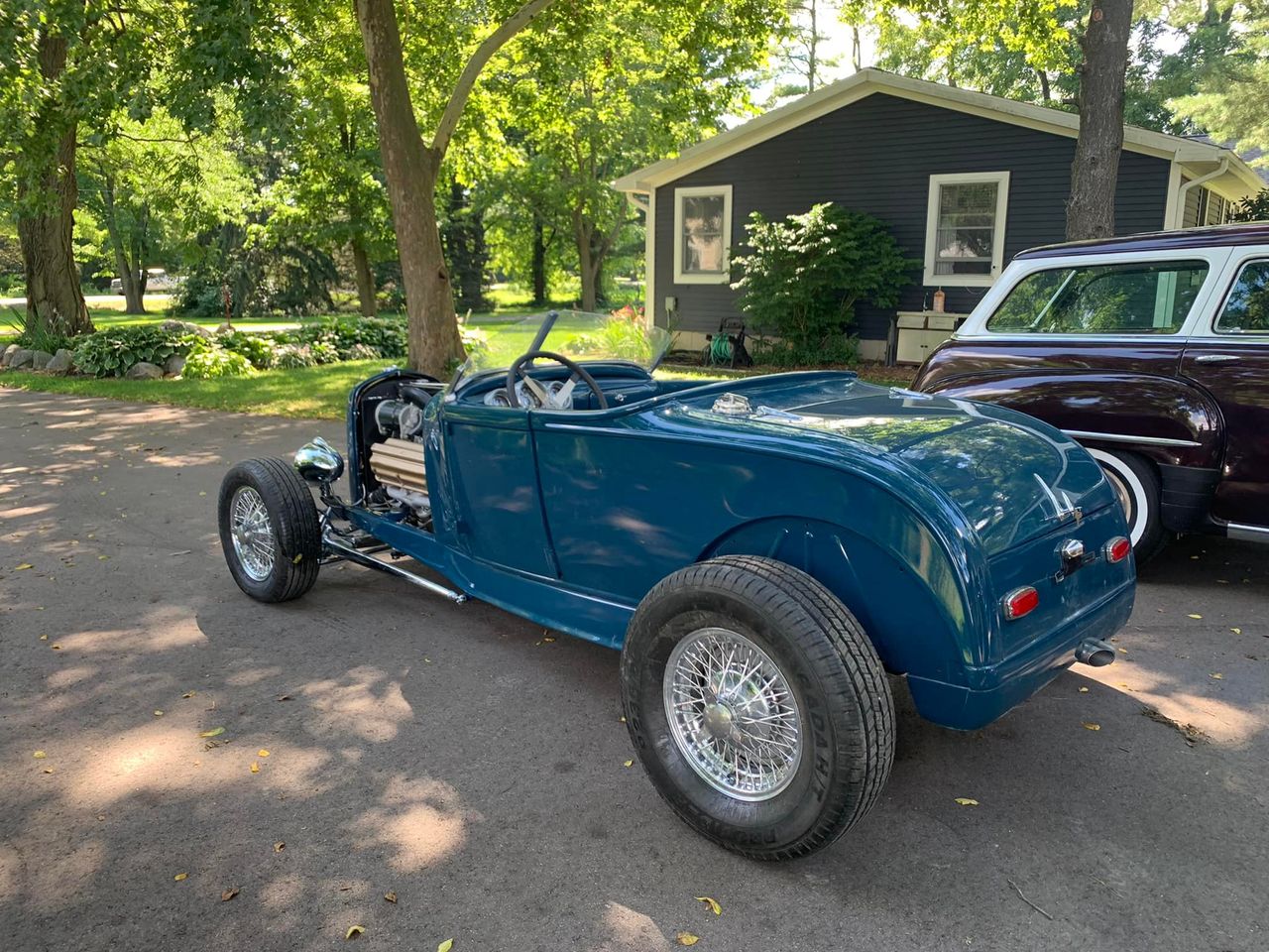

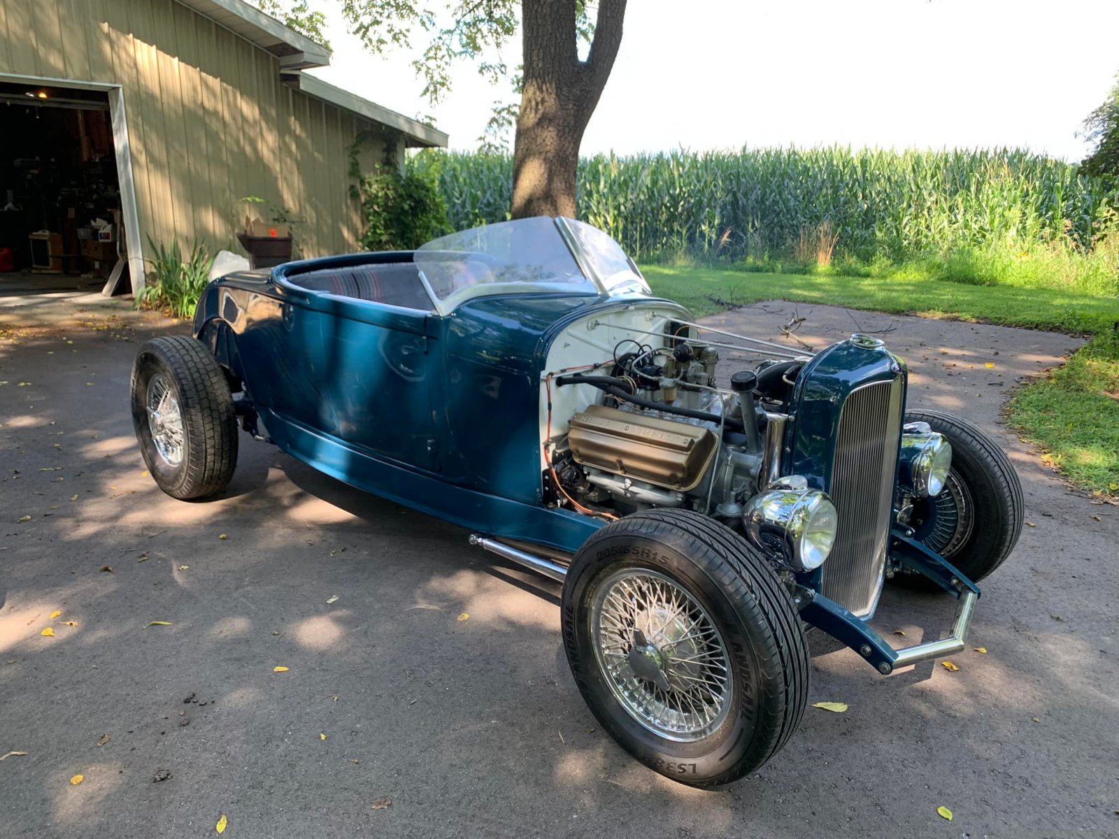

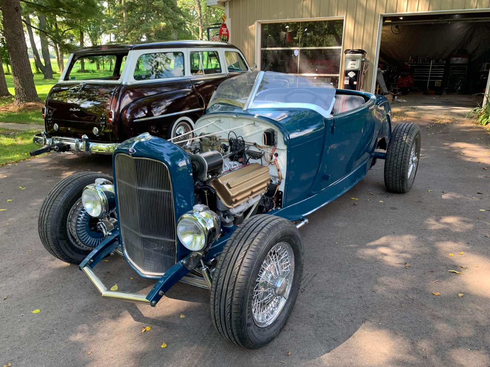

    Here it is, in repose. I changed the oil, topped off the trans fluid, it moves under it's own power, starts instantly and sounds great with the 2 1/2" straight pipes. I'm happy. E0ADD343-239A-468E-9209-929498C1D618.jpeg 12878FA1-2800-4290-8FBE-C99AE27B555A.jpeg 7CE6B0C8-0589-4BD1-8000-EFE199EFFBF5.jpeg E12F16F8-2379-4D4C-9D6C-1AB442E41357.jpeg

    Hope to meet you! We have good friends who just bought a place in Rives Junction, the meat market there is great!

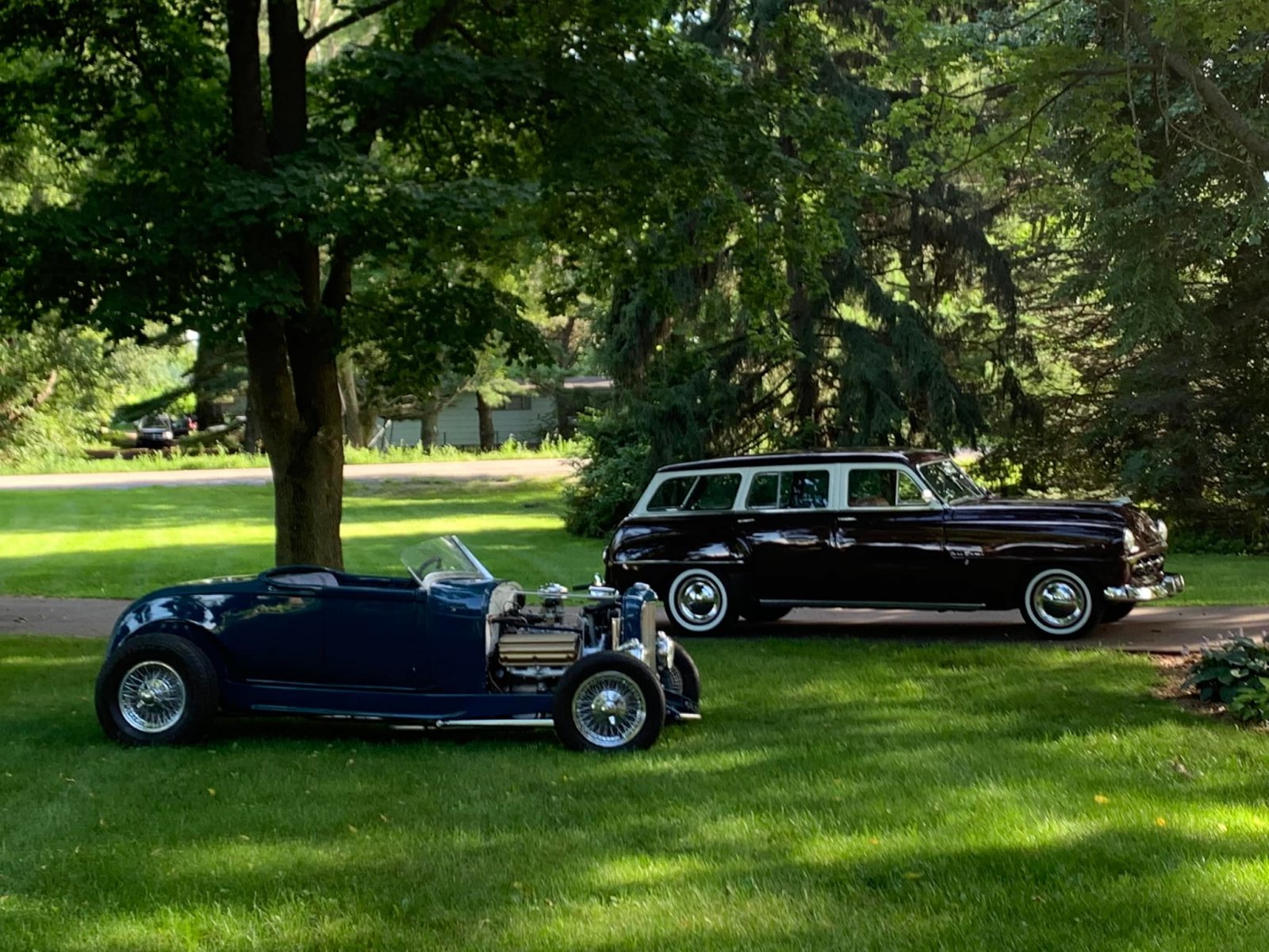

    Congratulations Brian it looks and sounds awesome...you certainly are a motivated Hamber and have a great eye for detail and quality. Have a whole lot of fun with it...;)
    winduptoy and flynbrian48 like this.
  26. Stogy
    Joined: Feb 10, 2007
    Posts: 27,218
    Stogy
    Oh and nice race track...:D
    I liked the old coupe in the distance...next project?

    You know, I’m almost embarr***ed to admit this but I did not care for the color or car in the shop. But out in the wild that thing knocks my socks off. One hell of a job.
