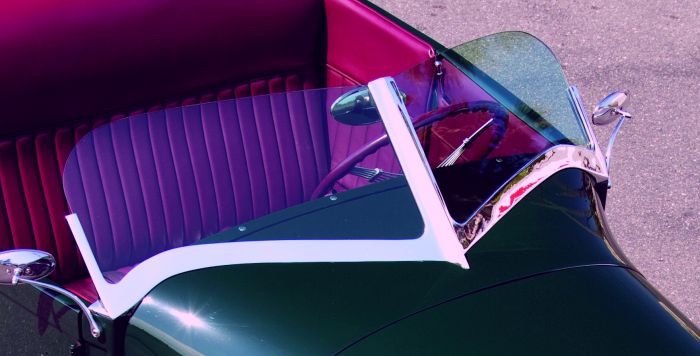

  11. Bandit Billy
    Joined: Sep 16, 2014
    Posts: 15,061
    Bandit Billy
    You're just like Chip Foose! But I like your builds better.

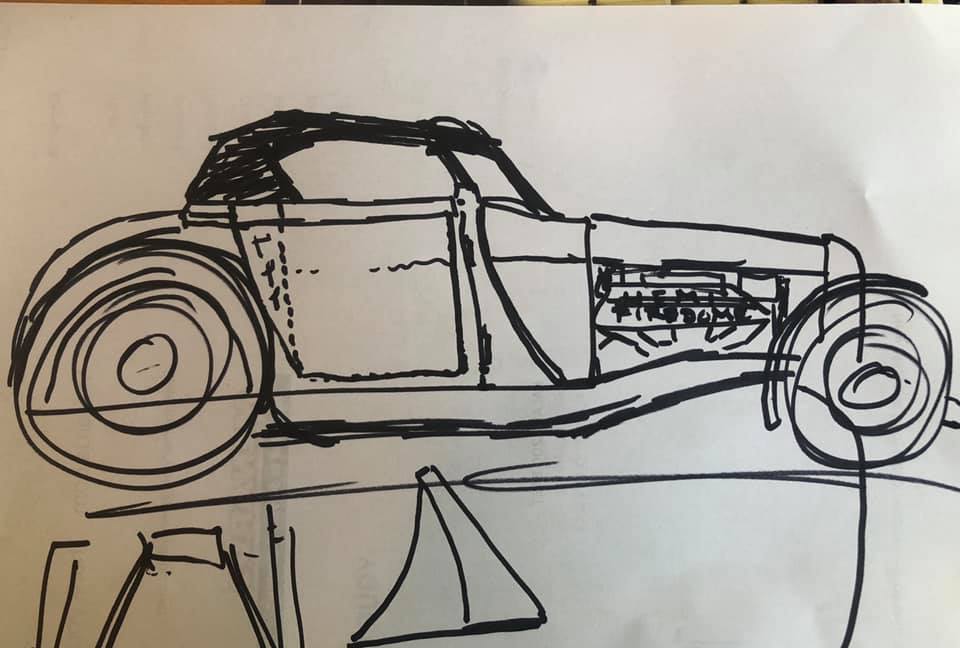

  12. flynbrian48
    Joined: Mar 10, 2008
    Posts: 8,632
    flynbrian48
    I'm just like Chip Foose, but have no artistic abilities whatsoever!! Like Chip, I did use a Sharpie to draw that sketch, which my wife liked well enough to put on the fridge door right alongside our grandson Milo's (he's 5) art, so, it must be pretty good.:p

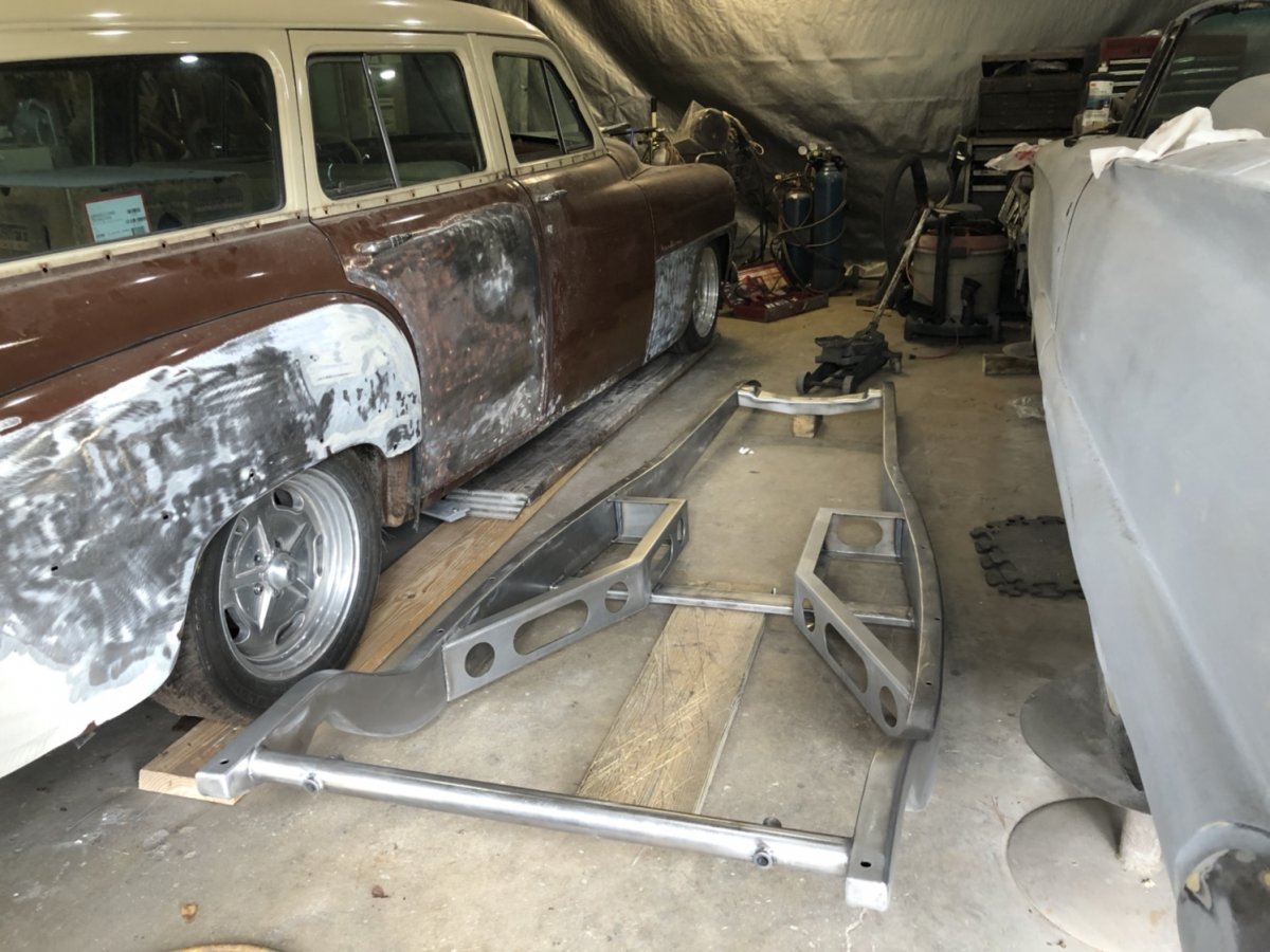

  15. flynbrian48
    Posts: 8,632
    flynbrian48
    No photo because I don't have it yet, but I'm having my buddy Dave Grey build a pinched '32 frame for the car. I priced '32 rails to build my own, even considered making one from rectangular tubing, and decided if I want to get it done in my lifetime the very small difference in cost outweighed spending months building a chassis that looked like I'd build my own chassis. With age comes wisdom.
    Anyway, he builds them pinched for the '28-29 cowl, a little kick in front to get them down, all the crossmembers in, frame spread at the rear to line up with the wheel wells, and bobbed rear horns. I'm gonna use coil-overs at the rear, and the Ford 9" I have. In front I'll keep it simple and use a dropped axle, and another set of the Wilson Welding aluminum backing plates and Buick drums like I had on the '34.

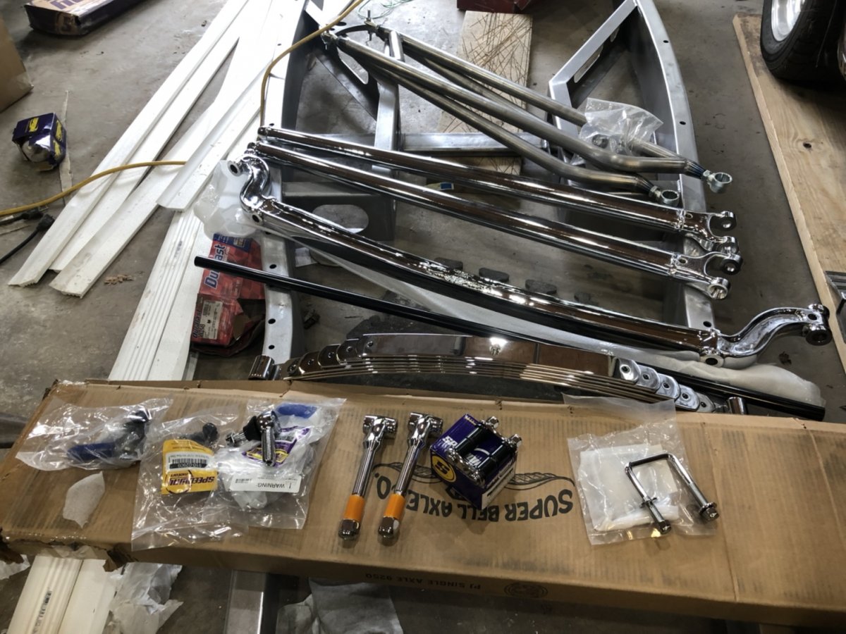

    In better news, I ordered a bunch of shiny stuff for the roadster. Chrome "Superbell" axle, spring, and bones along with chrome perches and other hardware. The split bones I found on eBay, the sellers description was "...chrome is not flawless...", but the photos looked nice, and I don't build flawless cars anyway. I originally was going to get raw steel stuff and paint everything, and I thought a drilled axle and bones would be cool, but it seems everybody in the country must be building hot rods, forged axles are "...on backorder..." everywhere, but fancy chrome ones (more $$) are available. Cheap, no name cast ones are out there, but I don't want to buy crap just to save a couple hundred bucks.

  23. flynbrian48
    Posts: 8,632
    flynbrian48

    flynbrian48
    It was like Santa came early today. A bunch of beautiful shiny chrome, and a trunk lid that fits!
