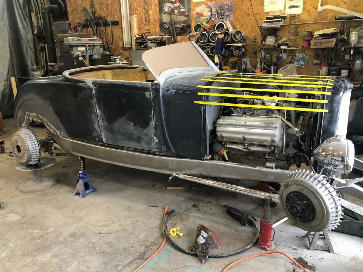

    Both doors now hung. I've had some nay-sayers point out that Model A doors are supposed to overland shouldn't be flush fit because "...Henry didn't build them that way...", the frames are too 131642187_10225390684816715_1463392560772126448_n.jpg flexible, , the door hinges and body character lines break up the "smooth" body lines, so why bother, and, one guy grudgingly admitted, "...it's your build, carry on." Well, I like it.
    It's come a long way from a bare, un-braced fibergl*** body. It's not on an original frame. I've always like a '29 on Deuce rails, and I've always thought hot rods with early Hemi engines were pretty freak'n cool. I'm looking forward to hearing that baby Hemi talking through straight pipes, and snuggling down in some tooled leather upholstery behind that tiny windscreen.
    I say, "Well hung Sir." Onwards.

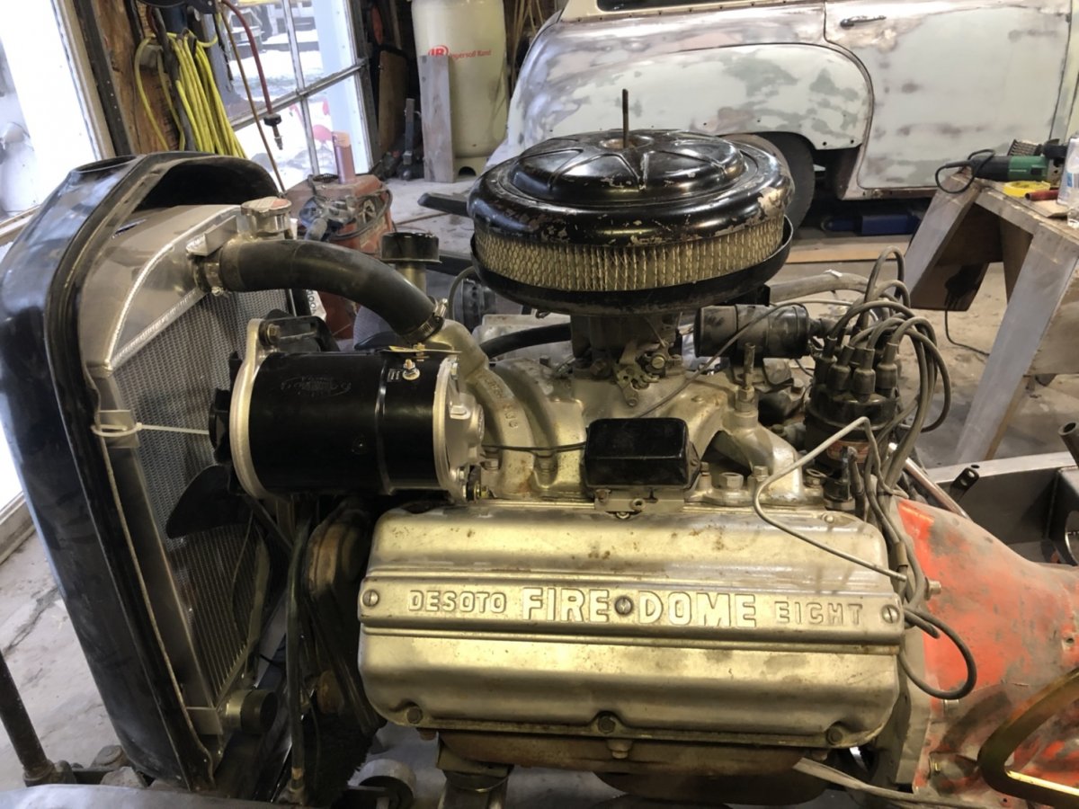

  3. One of the pics showed the same style rim on the roadster as the DeSoto. Or, were they just "borrowed"?

    Borrowed. I have just one set of wheels with tires on 'em for rollers, in a 5 on 4 1/2" and that's them. The roadster will probably end up with 5 on 5 1/2", which I have 2 sets of 15" steel wheels for. The originals from the DeSoto (the wagons and Imperials used that bolt pattern), and a set of '56 Continental wheels. The wagon will end up with the Salt Flats, and some 15" dual pattern steelies I pickup up, so I can change up the look. The steel wheels will get wide white radials for the wagon, blackwalls for the roadster.

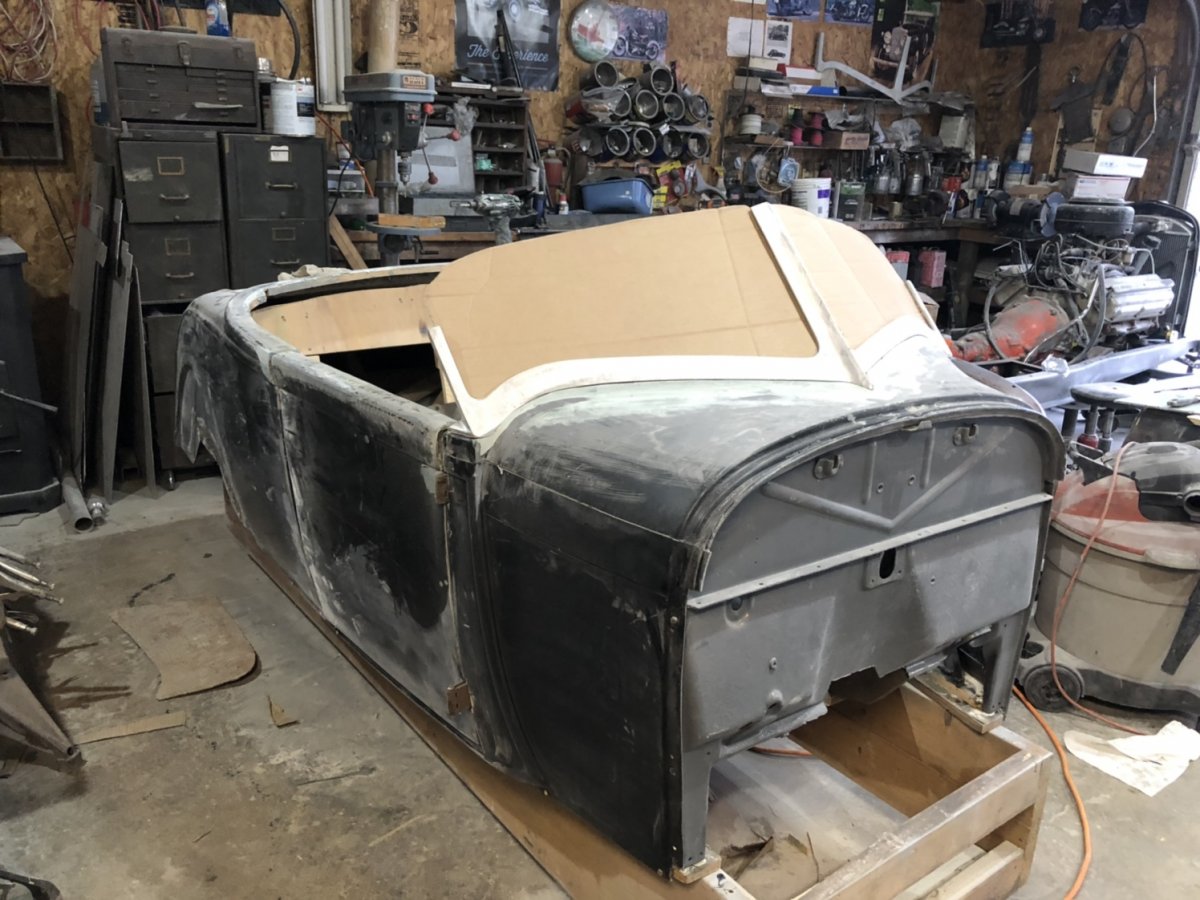

    Today's exciting progress: Making cowl/door post bracing from an angle iron packing crate. Yes, the 5" snowblower for my little tractor came shipped in a 1 1/4" angle iron crate bolted to a pallet. Being "thrifty", of course I cut it up, thinking 40 feet of angle iron might just come in handy some day.
    Today was the day. I cut some up and made this brace. There one up the door post, screwed and 'gl***ed to it, one on the floor sill, also screwed and gl***ed, a diagonal brace, and a little nub up the firewall foot, that'll be mirrored on the other, outside, of the firewall like the "foot" on a '32 cowl, that'll be body to frame mount.
    Once the right side is done, another piece of the stuff will go between the door posts behind the dash, and the windshield mounting tabs, down in the cowl post, will be bolted to uprights on the post brace.

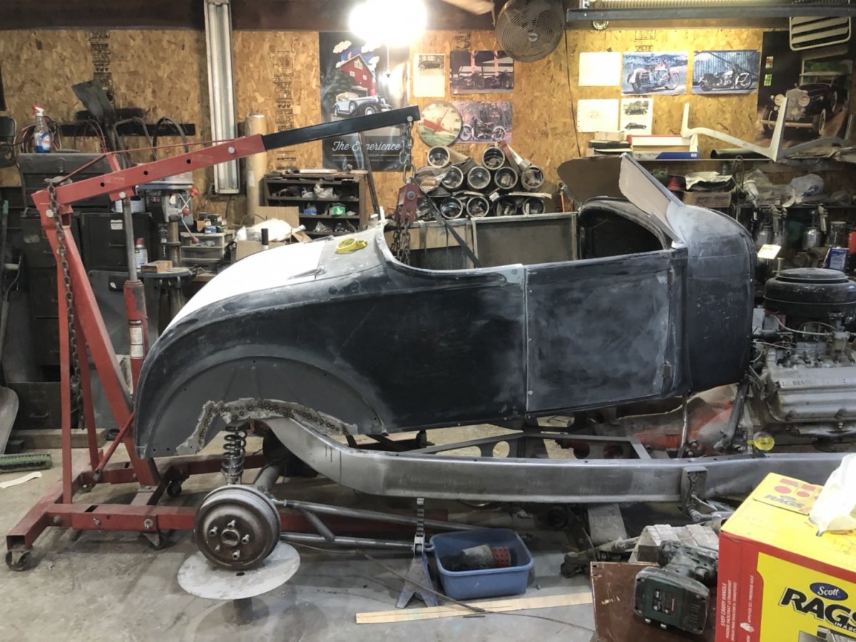

    IMG_2489.JPG IMG_2490.JPG IMG_2493.JPG IMG_2496.JPG IMG_2494.JPG IMG_2495.JPG
    Body back on its cradle. Located position on the radius rods, looks like just above the frame reveal with 6 degrees of castor.

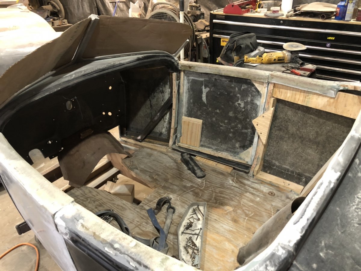

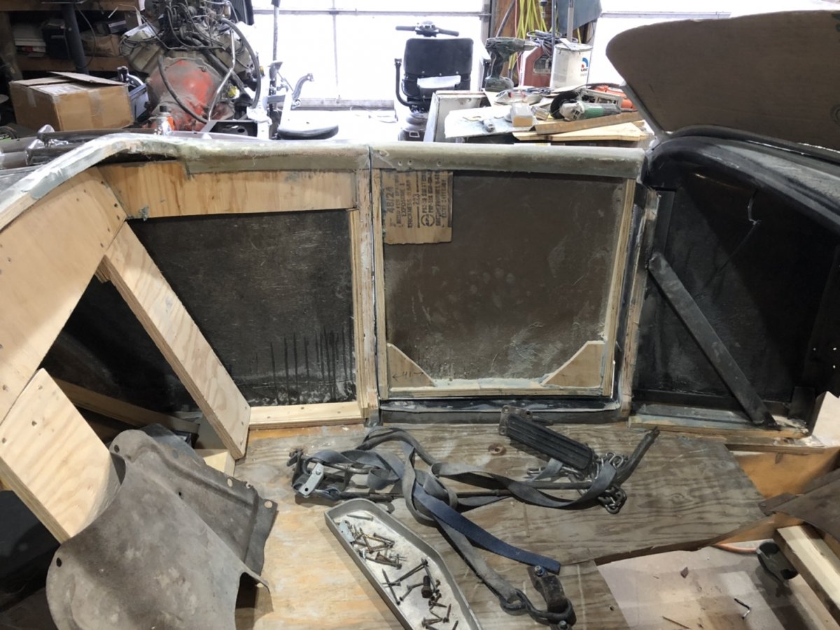

    Something I was concerned about was how to finish the top inside a of the doors and body tub. I had the two unused ‘gl*** inner door panels, and I cut strips from them to mold to the doors and quarters. This makes a return that the door cards can slip under, and I put a little bow in the door return pieces to transition into the dash. Sort of like a ‘34 but less pronounced. I like it.

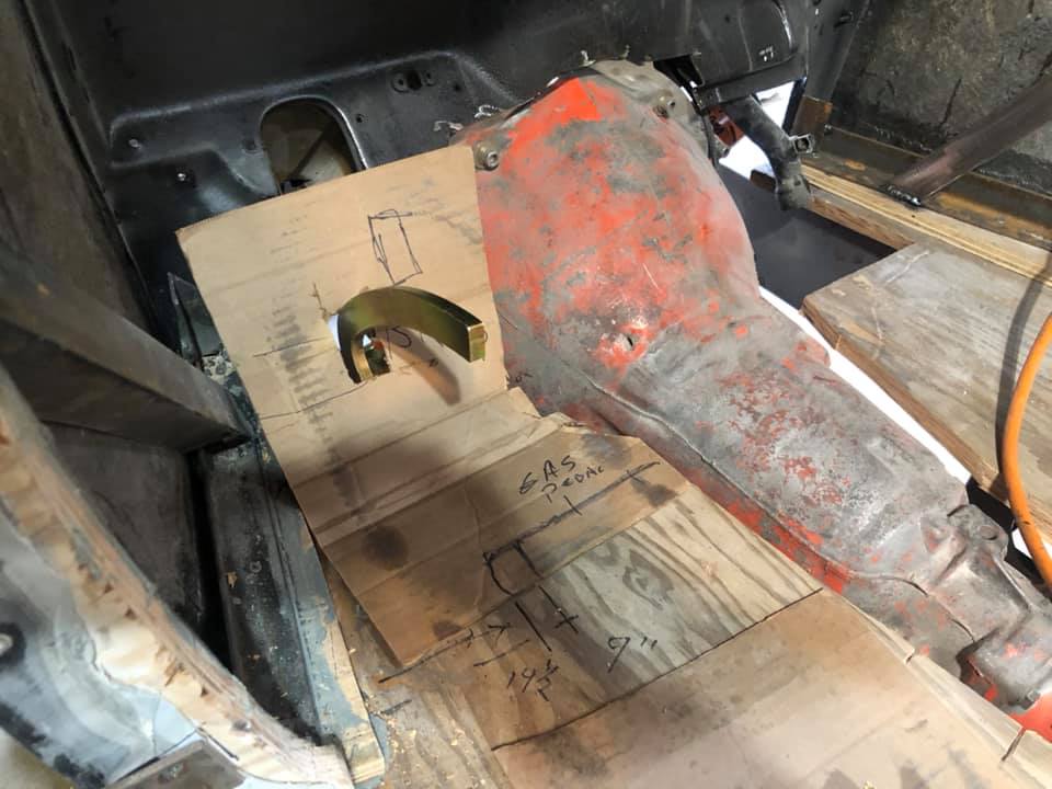

    The body bracing is done, aside from some turnbuckles in the doors to tuck the bottom corners in. I’ve got big orders coming from Summit and Speedway for the rest of the ch***is parts and exhaust, so I’m ready for New Year and a couple new cars!

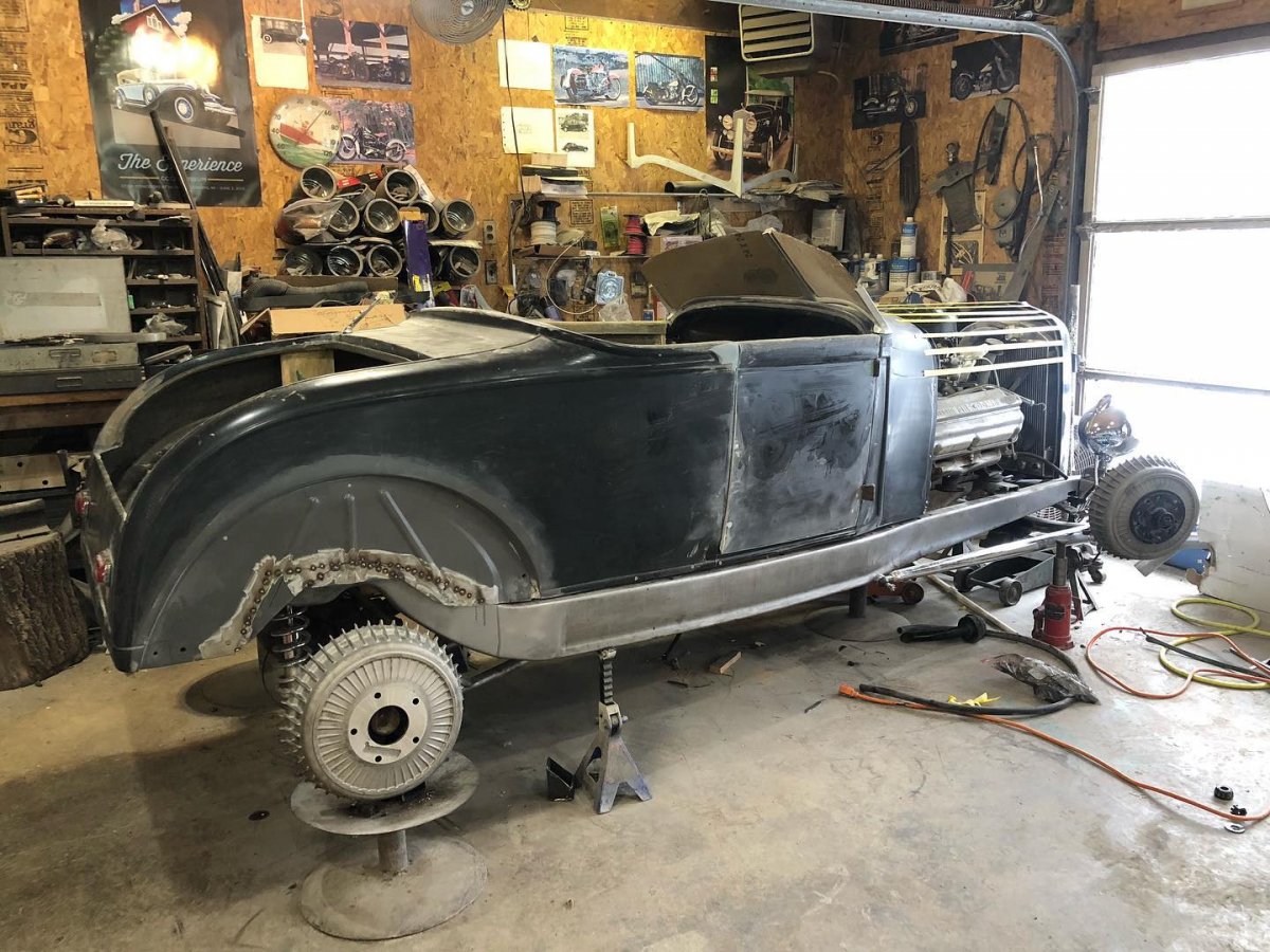

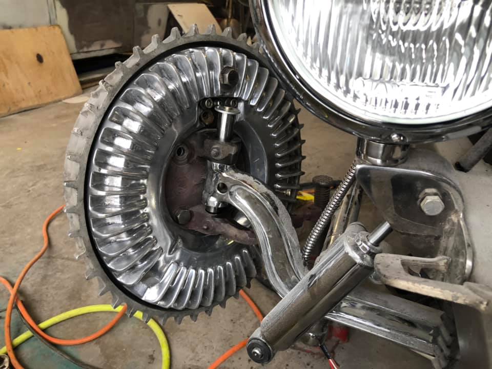

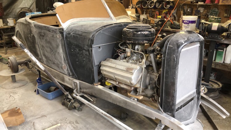

    Got a bit done on the roadster today. I knocked the tacked in engine mounts off, made new ones and raised them 3/4”, as the engine was set too low. I took a brake drum off and got started putting the Wilson Welding backing plates on. They’re machined for a Ford rear, but the holes aren’t drilled, so I have to lay that out and drill them to mount them. Looks like they’ll work with the new Buick drums from Speedway just fine.

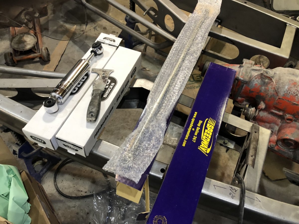

    Santa came!

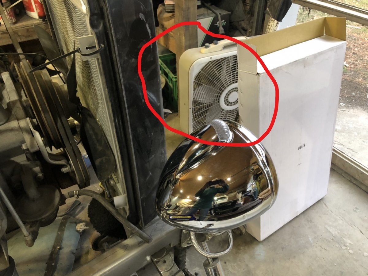

  19. loudbang
    Posts: 40,347
    I see Santa brought you a new fan ................are you sure that will fit between the engine and radiator? :rolleyes:

    It’s the extension cord I’m worried about...

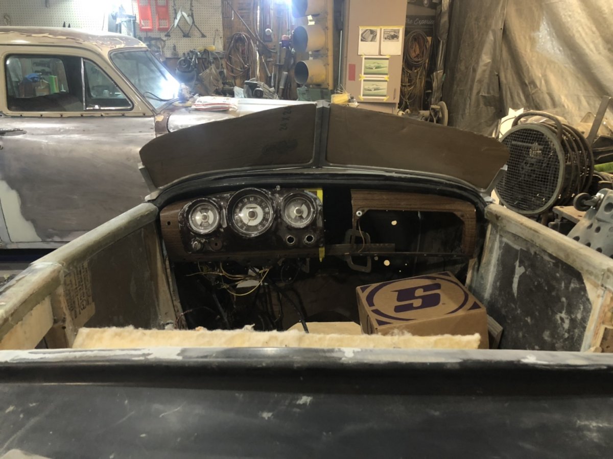

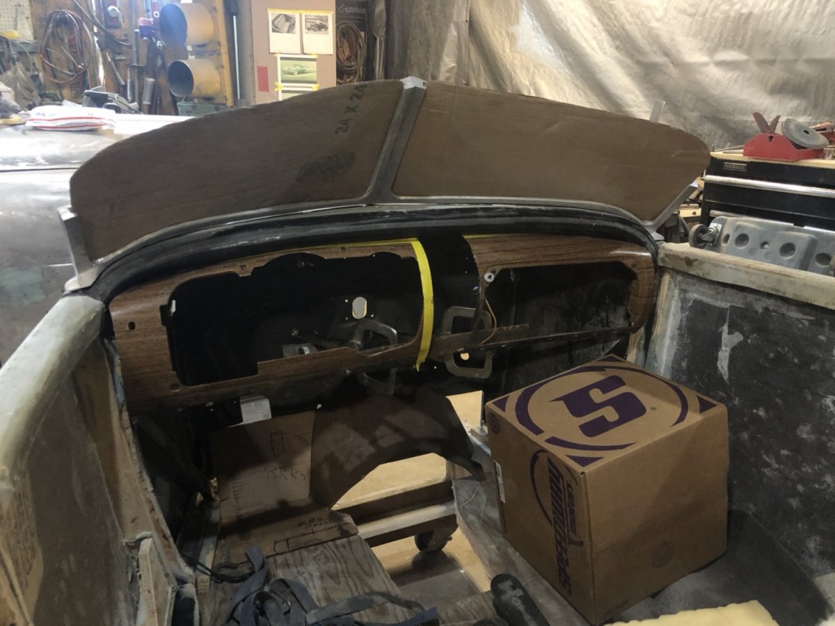

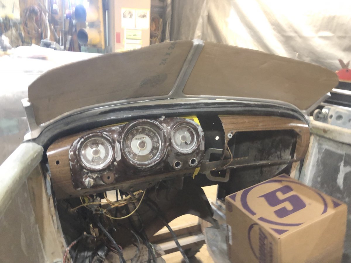

    DeSoto dash mock up. This looks better than I imagined.

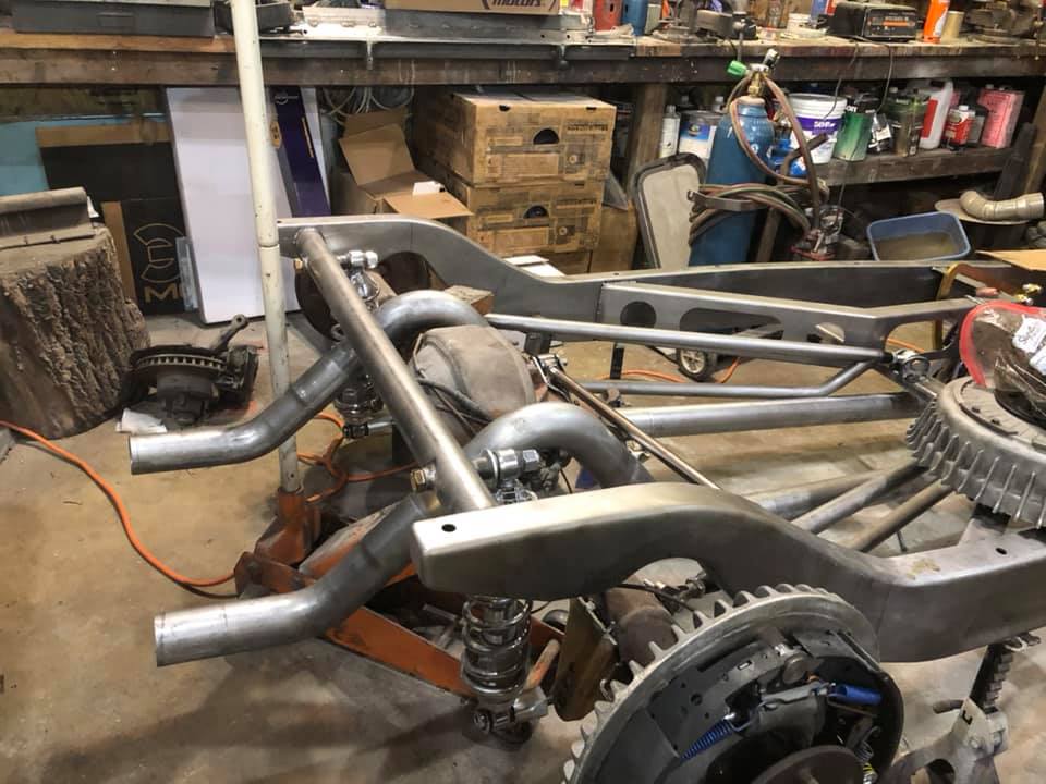

    I spent a few minutes today playing with greasy exhaust pipe, I think I have a plan. I'd wanted to run the exhaust up in the frame, but on the left side the master cylinder, brake pedal and 2 1/2" exhaust want to try to occupy the same space. So, I'll drop them below the frame and run 'em there. It's tight over the rear axle and it's Panhard bar, but there's room. I have mufflers, but I think we'll just go with straight pipes initially, and see how it sounds. The '34 sounded great with full length straight pipes, this little Hemi should too. E33A4790-28FB-4F85-949A-E203A4453356.jpeg F08143D6-7B7F-4BE3-944B-AA7E1E3EACC5.jpeg

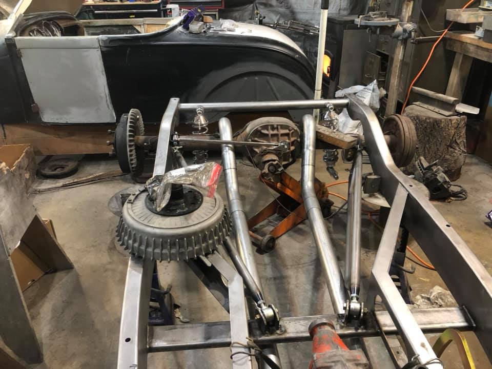

    I may be seeing things from the wrong angle but it looks like you have the brake shoes on backwards. I always put the short (lining) shoe on the front on Ford brakes that are self energizing. Am I seeing the pictures wrong? Anyway, am really liking your post. We are building a 32 roadster as a group that will be donated and auctioned / sold with the proceeds going to charity. This will be our third build that we have done this but the first time we have bought a body and cut the doors and braced everything. We are using a Y-Block because I donated one, it's all on the cheap. It's much harder than it looks! Keep on and make it yours and ignore the background noise.

    You are absolutely correct. Only put that one on the right side because the ch***is is so close to my bench and drill press it's awkward to get around it on the left. Good eye! Never fear, I got the other brake set up today (shipping delay), and when I get the backing plate drilled to mount on the axle flange, they'll be on the correct side.

    Well, I got busy and put the roadster body back on the frame, to check my master cylinder and pedal placement (after a VERY frustrating week with the DeSoto brakes, resulting in ditching pretty much the entire system and starting over), and, HUZZAH! It's in the right place! I mocked up a seat, a steering column, and everything fits and the little ****pit will be pretty comfortable.
    I also put one of the (barely used) Wilson Welding backing plates, which turned out to be polished, and a drum. It looks SO good, I'll have to polish the other front one and the drums. The rears probably not, but we'll see how it goes. 7970B1D7-6F96-402F-AEF2-A07423651008.jpeg CA60146D-C5B7-43DF-BDDE-D7A9B52682B4.jpeg 70C12169-EE17-4664-BC51-20F7545A6AA1.jpeg C2F2A73A-FED5-4D8F-9BDE-E74B49D7501F.jpeg
