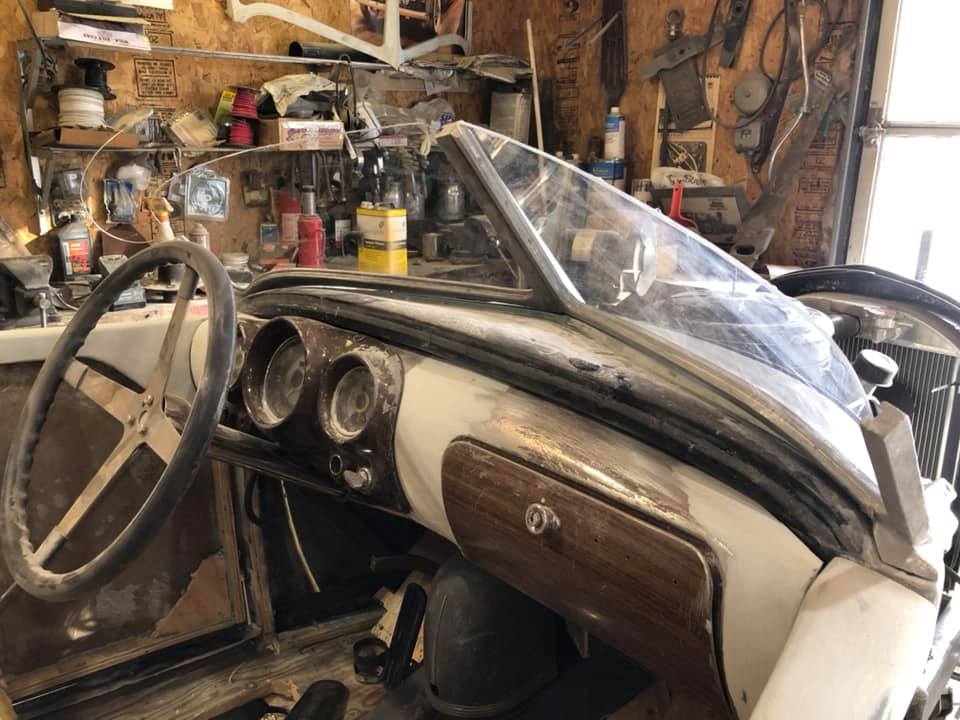

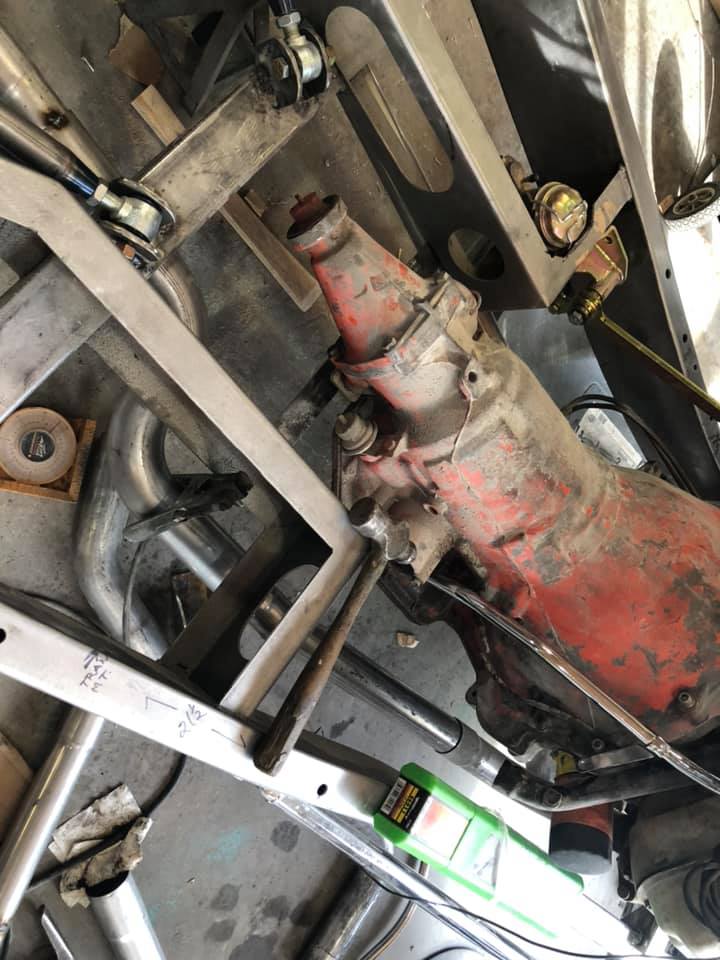

    I got tired of looking at the top of the transmission from the cockpit, and started making a trans tunnel. The top is a piece of the extra 'glass deck lid that came with the car (but didn't fit). I need to get a shifter now and mount that, then I can cut a hole for that and 'glass the whole she-bang to the floor and firewall. It's ugly now, but it'll look fine all 'glassed in and a little finish work. I can't see the need to have it removable, so it won't be. 078E5D59-69B4-41F6-A0B8-DD52B85AA046.jpeg 5EBA9AF8-9A3C-47C9-B369-CF553A01BDF7.jpeg A6EC5B36-AD29-464D-9BAD-B030A7FEE80F.jpeg

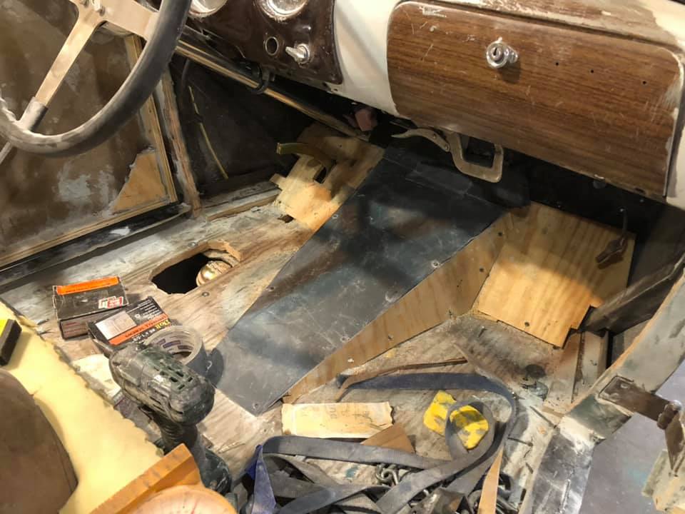

    I fixed the left hand “Chicken Foot” I’d cut off at the frame kick, and made some quickie cardboard door panels to see if my upholstery idea is workable.
    Yes it is.

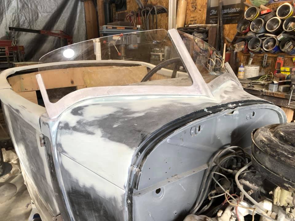

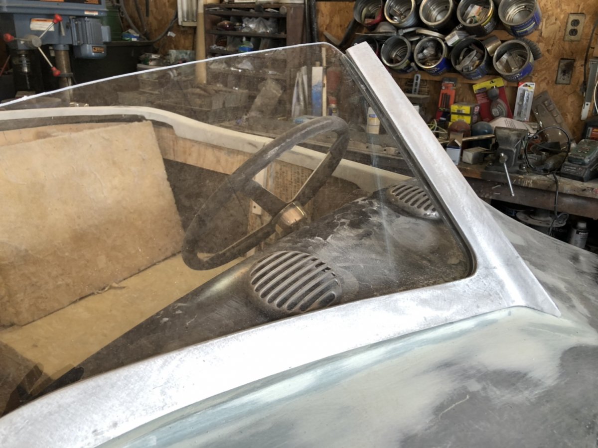

    It's cold. Outside, and since I have a marginally big enough pellet stove for heat, it's also cold in the shop. So, for something to do, I cut some scraps of acrylic and made proper templates for the windshield(s). It looks better in the shop mocked up with these in, if nothing else. F00CF9F1-51A1-4E65-82C2-C2BD641255CF.jpeg 8650E484-0E97-4677-BDCB-CB7A154AAE3C.jpeg

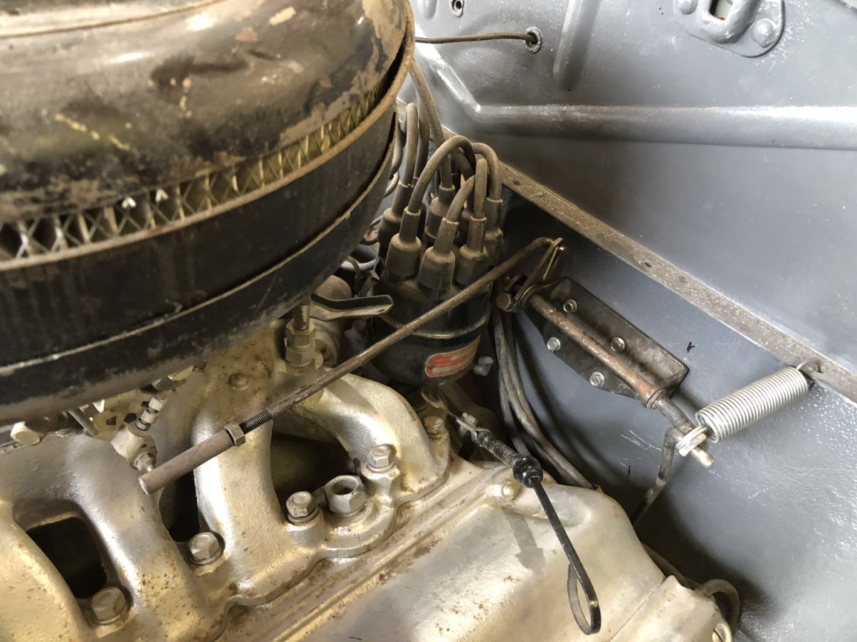

    Today project, make throttle linkage for the roadster. I used the cool aircraft starter pedal, just slips over the DeSoto pedal, hook to the DeSoto bell crank on the firewall with a homemade linkage rod.

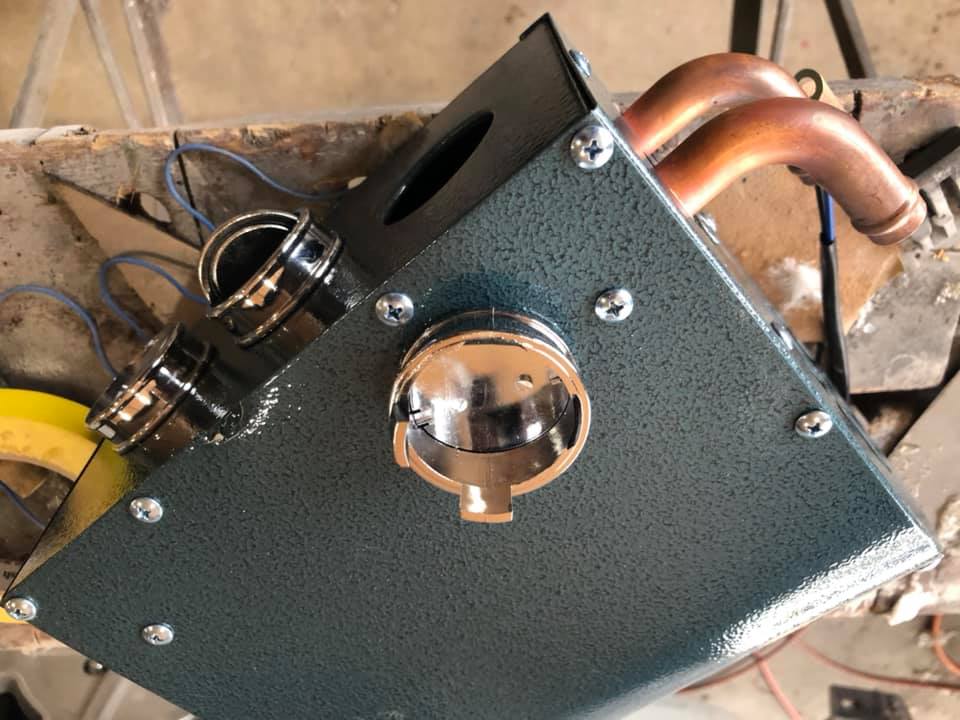

    I bought an under dash heater, will use thes ‘36 horn grills for defroster vents, and run another hose (it has 3 ports) into the Southwind housing for floor heat.

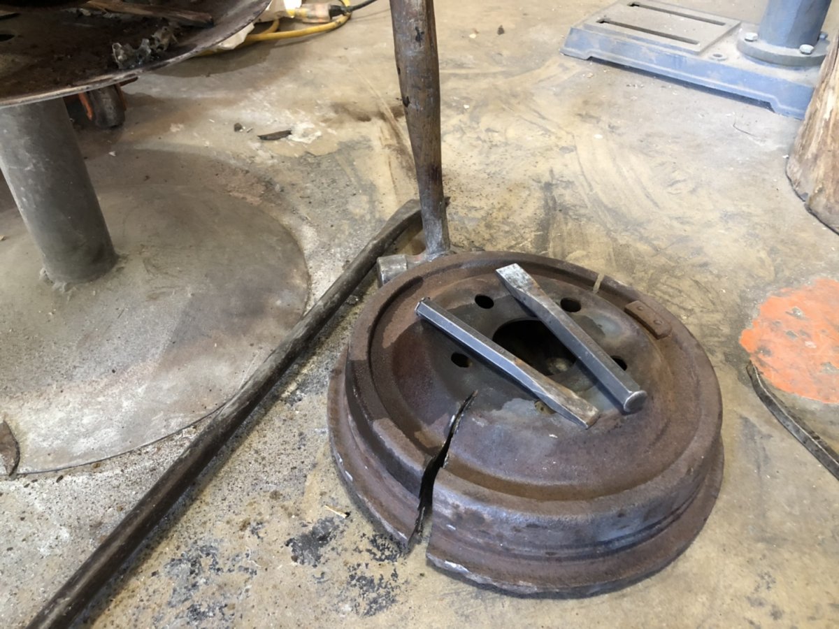

    The left brake drum needed a little encouragement to come off...

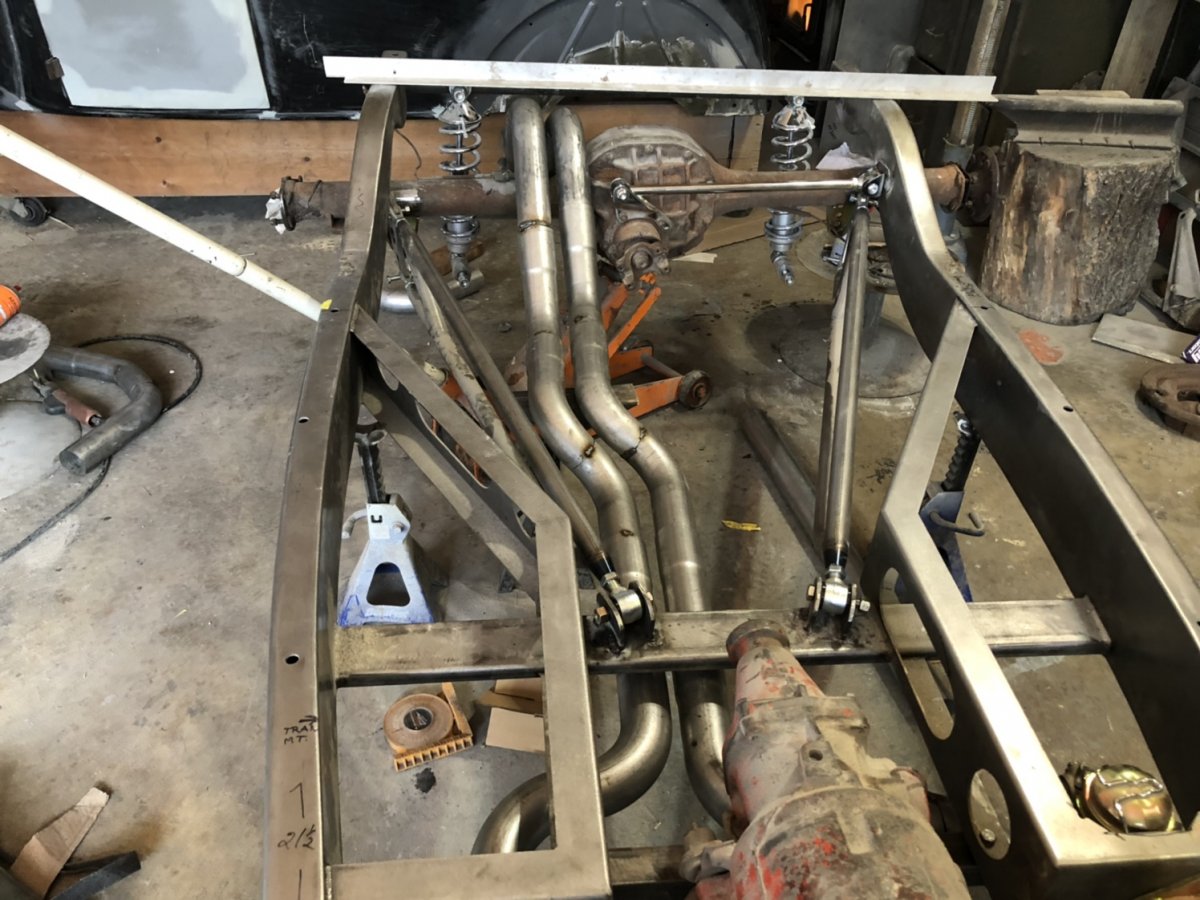

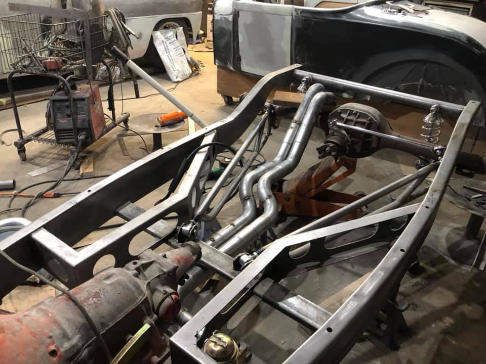

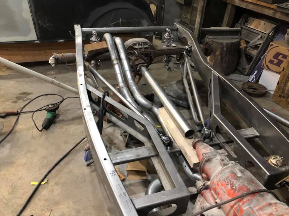

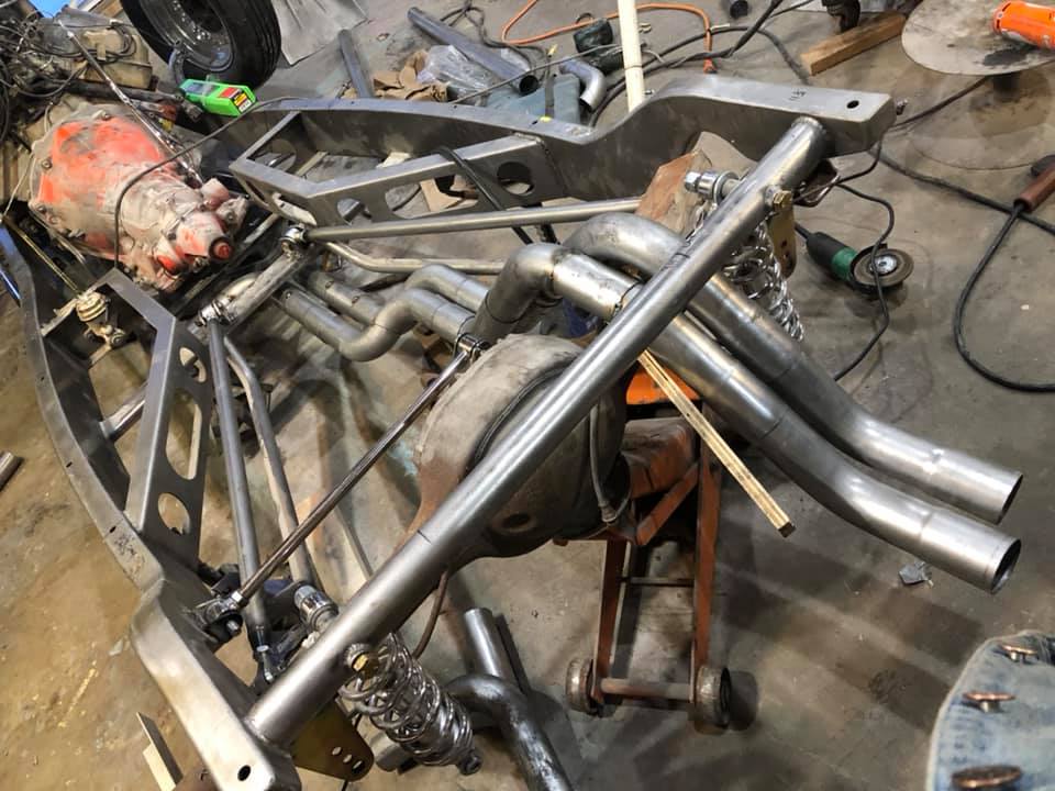

    I pulled the body from the chassis yesterday. Had to pull one of the radius rod mount tabs and adjust that, got the Panhard bar bracket tacked on, then spent a lot of time staring at the shrinking space for 2 1/2” exhaust tubing.

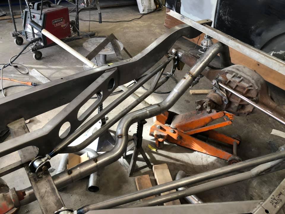

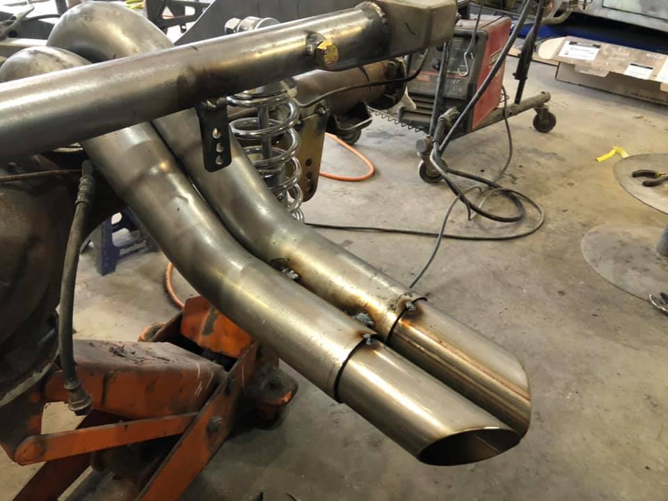

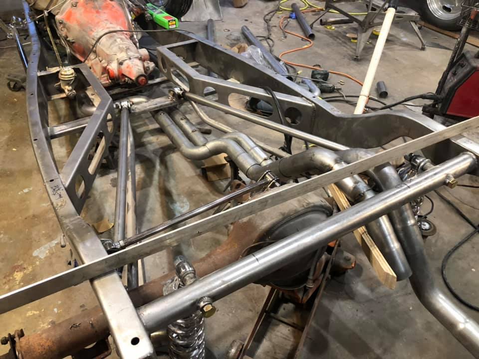

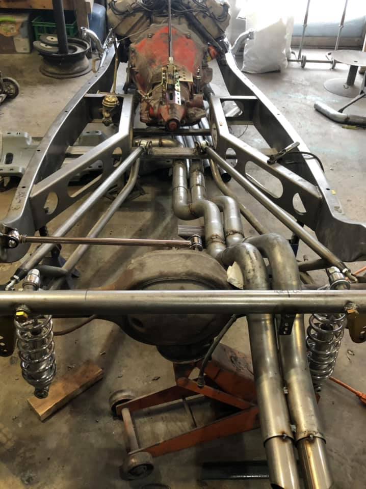

    Today was exhaust day for the roadster. I'd intended to run the pipes on each side, but, there was NO WAY to get 2 1/2" pipe over the Panhard bar and rear axle without hitting the floor. So, I kicked the left side pipe over to the passenger side and ran it tight alongside that one. I like them tucked tight together on one side or the other, looks sort of European to me, so, it's all good.

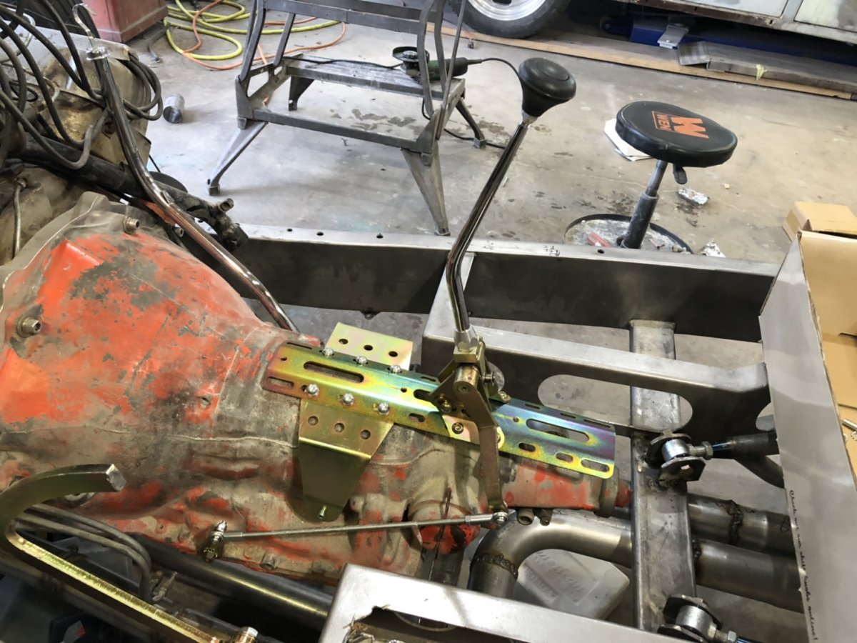

    The "High Quality Shifter" came, and, it looks OK for the price. The heater came damaged, one of the outlets had the mounting tangs broken off and were inside the housing, but since I'm using defroster tubing to duct them to the defroster and the Southwind housing, I'll just epoxy it to the box. That'll be less hassle than sending it back. The fan actually moves a LOT of air, and the 3 speed switch works great and will fit in the opening in the Southwind housing as well. Bonus.
    It's gonna go together pretty fast now.

    Well, that’s a wrap. Now to pull it out and finish welding the joints that have to welded, and try not to weld the ones that don’t. Wish me luck...

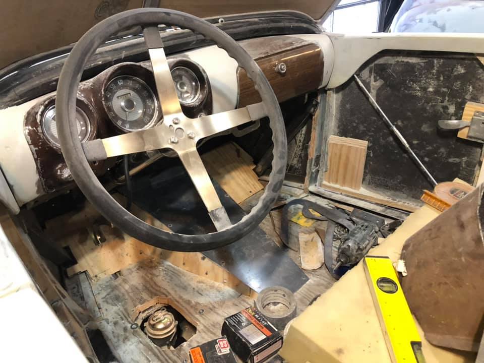

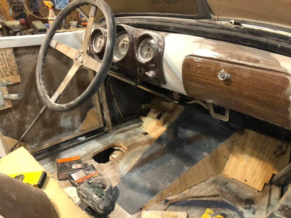

    I like the dash, the vents and the windshield. Keep it up. You have probably already posted, but what is that dash out of?

    This. ‘52 DeSoto that the Hemi came from. This dash was an extra that came with the car. The wagon got a significantly larger Hemi...

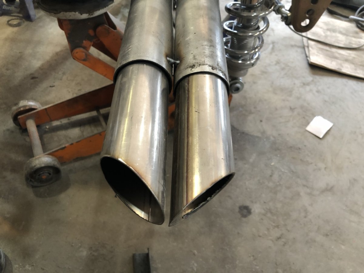

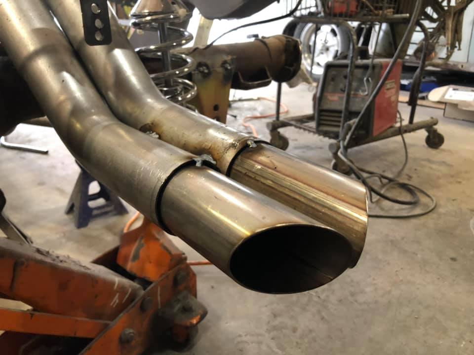

    That shifter is “High Quality “, it says so right on the box. It works, the price was right, so I like it fine. I REALLY am happy with the exhaust, it looks fantastic. I’m thinking of doing the exhaust tips like a Duesenberg, dual 45’s. The windshield is a rip-off of an Auburn, so, it’s appropriate.

    I've come to appreciate that one of my most useful skills is the ability to cut welds without wrecking whatever I've welded on in the wrong place. The Panhard bar at the rear was too low, and slightly out of line with the rear axle, because I was trying to route the exhaust pipe over it. That didn't work, so, I fixed it.
    It's all about the "do-over".

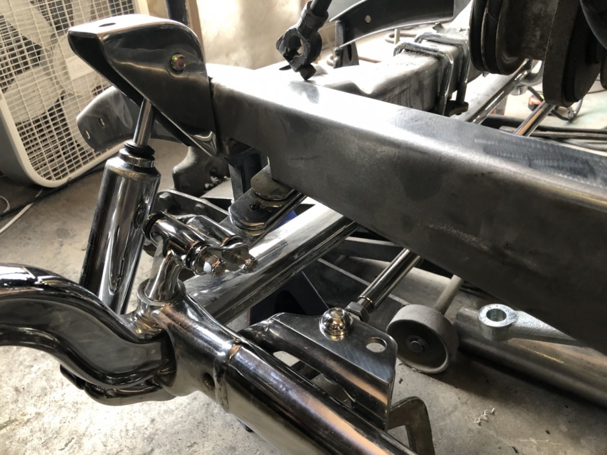

    At the museum, I looked at a couple of the Duesenbergs there, went home and finessed my Duesy inspired exhaust tips. I ordered 4 hangers from Speedway with those silicone insulators in them, made some brackets on the chassis to hang the pipes from, and just sat on a stool for a few minutes and admired my work.

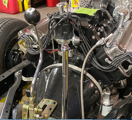

    I'm irritated. I don't care for the cheesy, cheap looking, piece of crap knob on the cheesy, cheap shifter. What I want is something cheesy that's my taste, like, an old 8 ball. Which, for $15, the cheesy shifter company retailer, "Johnny Law Motors" has. Problem is, they don't have the little detent release button. So, I called them. Got some young guy who knows NOTHING about the products, but, he listened while I told him what I wanted. He came back with this shopping list, the shift knob, 14.95. The adaptor to put the knob on the lever so the whole knob acts as the detent release (which I get), $29.95. A set of adaptors, to use ONE to put the knob on the main adaptor, and ANOTHER set of adaptors, to put the adaptor, with it's adaptor to the knob, on the lever. Total, $95. For a $15 shift knob. I'll get an 8 ball, drill and tap it, cut the detent rod down so it's always pushed in, and forgo $80 worth of adaptors. 2234371F-6871-4CF7-BCE1-CA18D5B632FB.jpeg
  26. Bandit Billy
    Joined: Sep 16, 2014
    Posts: 15,050
    Bandit Billy
    I have the 8 ball shift knob that came on my LoKar shifter you can have. It has the button, not sure if it will work though.
    loudbang and Stogy like this.

    And it's used to staring at a Desoto
    fauj, mcsfabrication, brEad and 6 others like this.
  28. At first glance Billy, it looked like the park brake handle was the distributor!
    fauj, Nostrebor, Bandit Billy and 4 others like this.
  29. Bandit Billy
    Posts: 15,050
    Bandit Billy
    Weird, I was packing up the 8 ball last night and must have been speaking out-loud when I muttered "will this work on Brian's roadster?" This was the response. So I think we are good to go. On it's way B!
    brando1956, Stogy, charleyw and 5 others like this.
