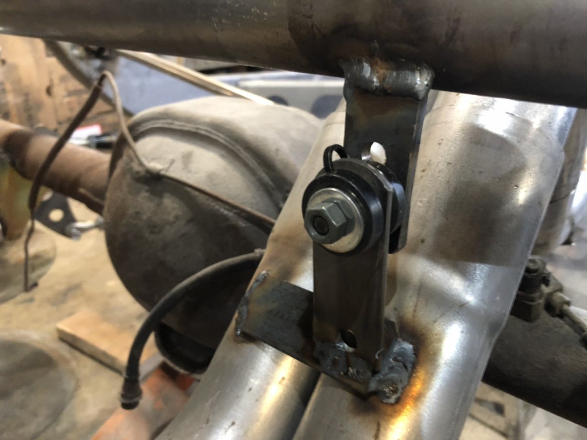

    I got these little hangers from Speedway. I think they’re pretty slick.

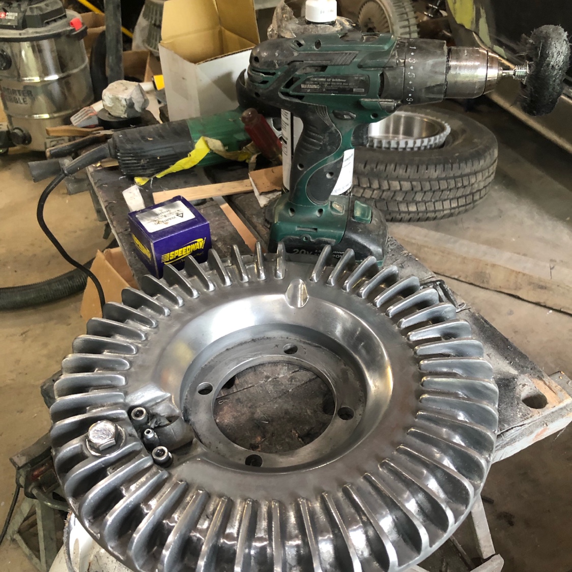

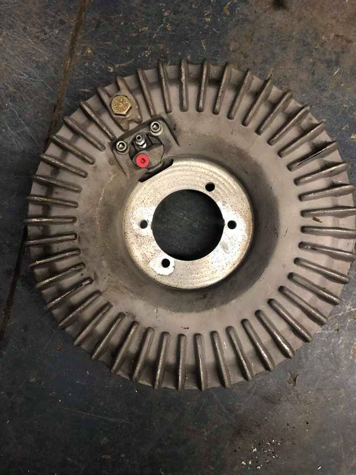

  2. flynbrian48
    Joined: Mar 10, 2008
    Posts: 8,637
    flynbrian48
    314887D6-CC5F-4D0D-8276-27116DC4DB73.jpeg It's nice when you have a buddy that can fix your stupid mistakes. My pal Jake TIG'd the errant holes I'd managed to lay out wrong (hey, I got one right) on the never used Wilson Welding backing plate for the 8" Ford rear under the roadster. Now, my dilemma: Blast these and polish the edges? Polish the whole plate, or paint them and polish the edges? Then, what to do with the Buick drums? I have one of 4 of the backing plates which is polished, and it's BEAUTIFUL, but I don't want to polish the other 3. Maybe just the other front one? Deicions, decisions...

    I thought so, too but they don't hold up. Pretty soon, you have metal to metal and no noise and vibration insulation. I had to change them out on my Plymouth. YMMV.

    The little insulators failed? I wondered about the longevity. Of course I chose them as opposed to the rubber strap kind that clamp on with a regular muffler clamp because they looked a little cleaner. I'll rethink these, and figure a way to do the strap kind.

    I'm pretty sure @Blue One had problems with those too and in his thread he found a solution to the problem.

    My first thought was some bronze bushings from the hardware store...

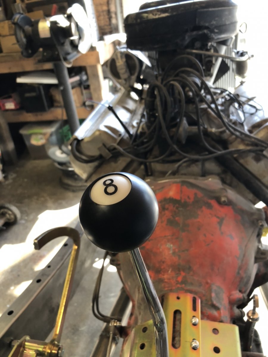

    Many thanks Bandit Billy! It’s perfect!
  11. We never had an issue with those hangers. Used them on a dozen cars or so.

    I retrofitted back to the rubber straps. The polymer inserts literally cold flowed and distorted to the point that all you had was metal on metal. When I went over a bump, the exhaust pipe would make a "clunk" sound. That was my experience.

  13. Bandit Billy
    Joined: Sep 16, 2014
    Posts: 15,123
    Bandit Billy
    Now you really are behind the 8 ball. :cool: Glad to contribute, keep at it!

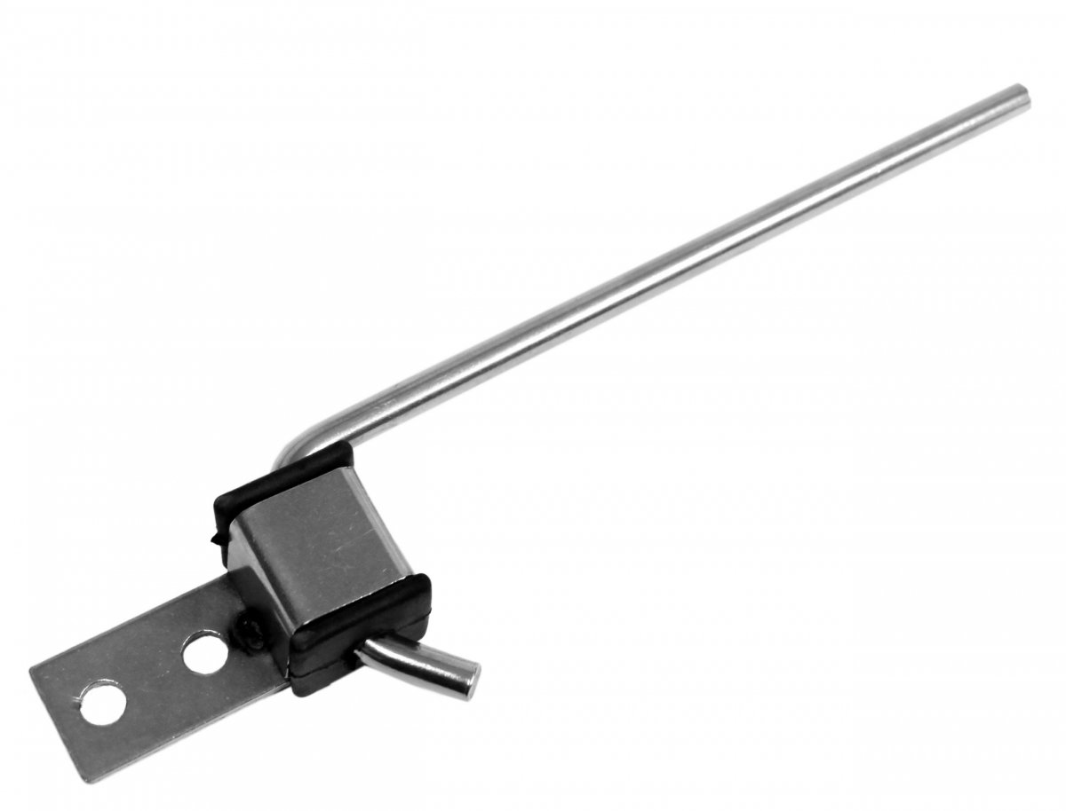

    Actually, I used this type.

    I used similar, modern hangers like that for the exhaust I built for the DeSoto, but I really want to keep these very simple ones under the roadster. I think I'll see how they work, perhaps a fender washer on rather than a standard washer against the insulator will help longevity. Honestly, it's not like this car is going to get 10,000 miles a year on it, so for now I'll keep 'em.

    Those insulators work best and will last if used horizontally.

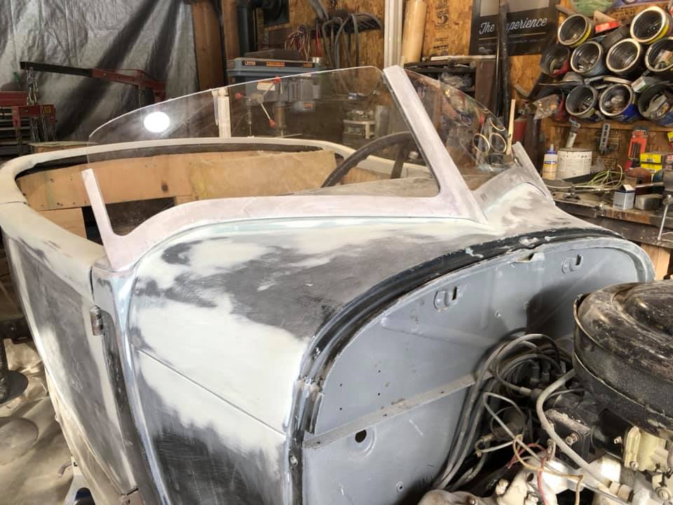

    The guy doing the upholstery came down the other to put the headliner in the DeSoto wagon (long story, but that's for another thread, on another day), looked at the roadster and said, "You haven't got much done on that have ya?"
    Seriously? I guess all I've done in the past two months is finish the bodywork on the DeSoto, paint it, polish it, get (most of) the trim back on, spend a week in Florida, a week in New Orleans, then another trip to Florida, and get wheels and tires on it, and ready for him to get the upholstery in, which he hasn't finished either.

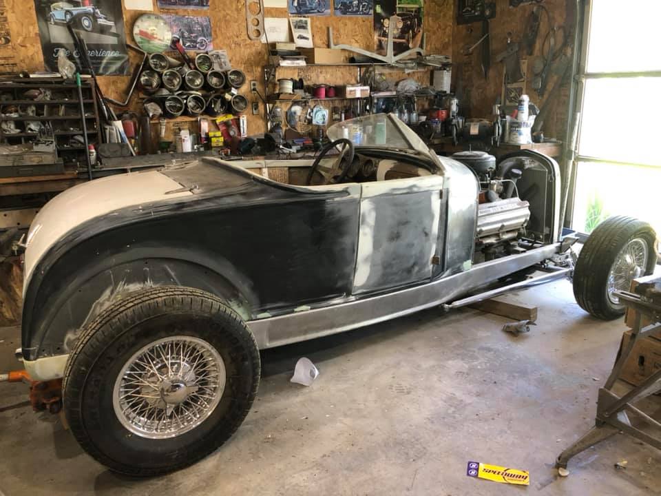

    Nevertheless, I felt sort of like a slacker, so this morning I mocked up the car and have it setting on the suspension, which makes it LOOK like a car and moved the boxes of parts away from it so I could see it, even though it's parts piled up it LOOKs like a car. I took a step back, and, damn, it looks REALLY good. Stance and ride height are, to me, perfect.
    So now, filled with inspiration and having the roadster duct taped together, I can finish the wagon. As soon as Mr. "I'm taking 5 months to do your interior" gets his part done... F3D47DD5-1236-4547-89F6-CD5A36A39F34.jpeg 88795D4B-0145-42A5-B6BC-EB1478D7CA27.jpeg

    Maybe a little down in back...
    I’m at a standstill with both projects. I managed to polish one of the front backing plates, and quickly decided the rear ones can get painted. My buddy is going to mill a flat in the rear backing plates(marked with a Sharpie) that’ll fit them with no other work to the 8” rear.
