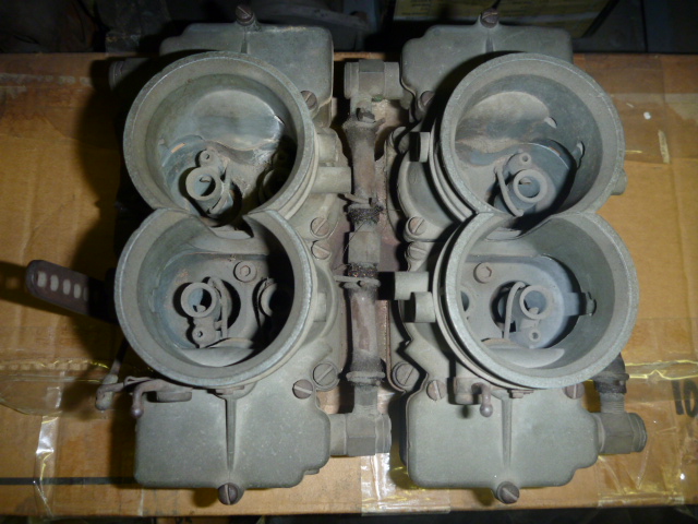

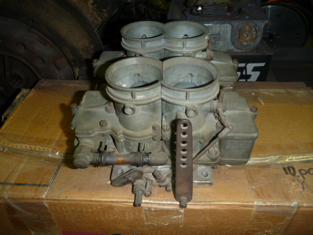

    It's 8/31/12. After puzzling over it a while, I figured I'd post it up here. Maybe one of you guys have a clue as to it's origins. If anybody knows, it's gonna be someone on here!
    Navarro 8-barrel Stromberg 48 carb !!
    Talk about innovation! We all know the great Barney Navarro was a genius when it came to making flathead motors go faster, and this is yet another example of why. Talk about thinking outside the box.
    We honestly don’t know a lot (anything!) about this carburetor. But we are told it was built in 1948 using four back-to-back Stromberg 48s siamesed together with a common machined alloy base plate (it’s got no cast iron bases). Check out the extra/relocated arms on the accelerator pump fulcrum levers, sticking right up in the air. By linking them together across the top of the carb, the left hand pump rods can transmit the pump action to the right hand venturis. Looks like he made some super-long throttle shafts to join four barrels together in line, with one controlled by the pedal and the other (maybe a secondary?) with a torsion spring wrapped around the end of the shaft. And what about that fuel system! Looks like all the inlets are linked, and what are those pipes on the centre drain plugs underneath?!
    This one-off piece came via Don Ferguson to the collection of Australian ‘friend of Stromberg’, Graeme Raper and is currently with our buddy Max Musgrove for full restoration with new Stromberg service parts. At the moment we only have these pics to go on, but we’ll be reporting back as this baby gets more attention. Anybody got any more input for us? Please?!

    Sure it hasn't been Photoshopped?
    It sure is an awesome idea and looks bitchin'. I bet it'd flow some big numbers
  7. Flipper
    Joined: May 10, 2003
    Posts: 3,426
    Flipper
    from Kentucky
    Does the common baseplate turn it into a "single carburator"?
    I'm guessing it was done to get around some sanctioning body's rule.

    Does the 6 bolt base pattern match up to a gmc blower ?
    jimmy six likes this.
  12. Abomination
    Joined: Oct 5, 2006
    Posts: 6,772
    Abomination
    I wondered that, too...

    I swear i have seen this on a 471 in one of my OLD mags!
  16. I was thinking 4/71 as well. Pattern is too square for a 6/71.
    I'm thinking it had to be a solution to fitting 4 carbs on top of the blower inlet.
  17. I was thinking 4/71 as well. Pattern is too square for a 6/71.

    Old post but, any more info on this setup? Wondering what the advantage of siamesing the carbs is? 2 strombergs face to face have roughly the same foot print as a 371 opening, so I cant see it being for that reason. The one piece base plate probably allowed the top line of the carbs to be lower, since you wouldnt have a adapter. Also may have simplified the linkage.
