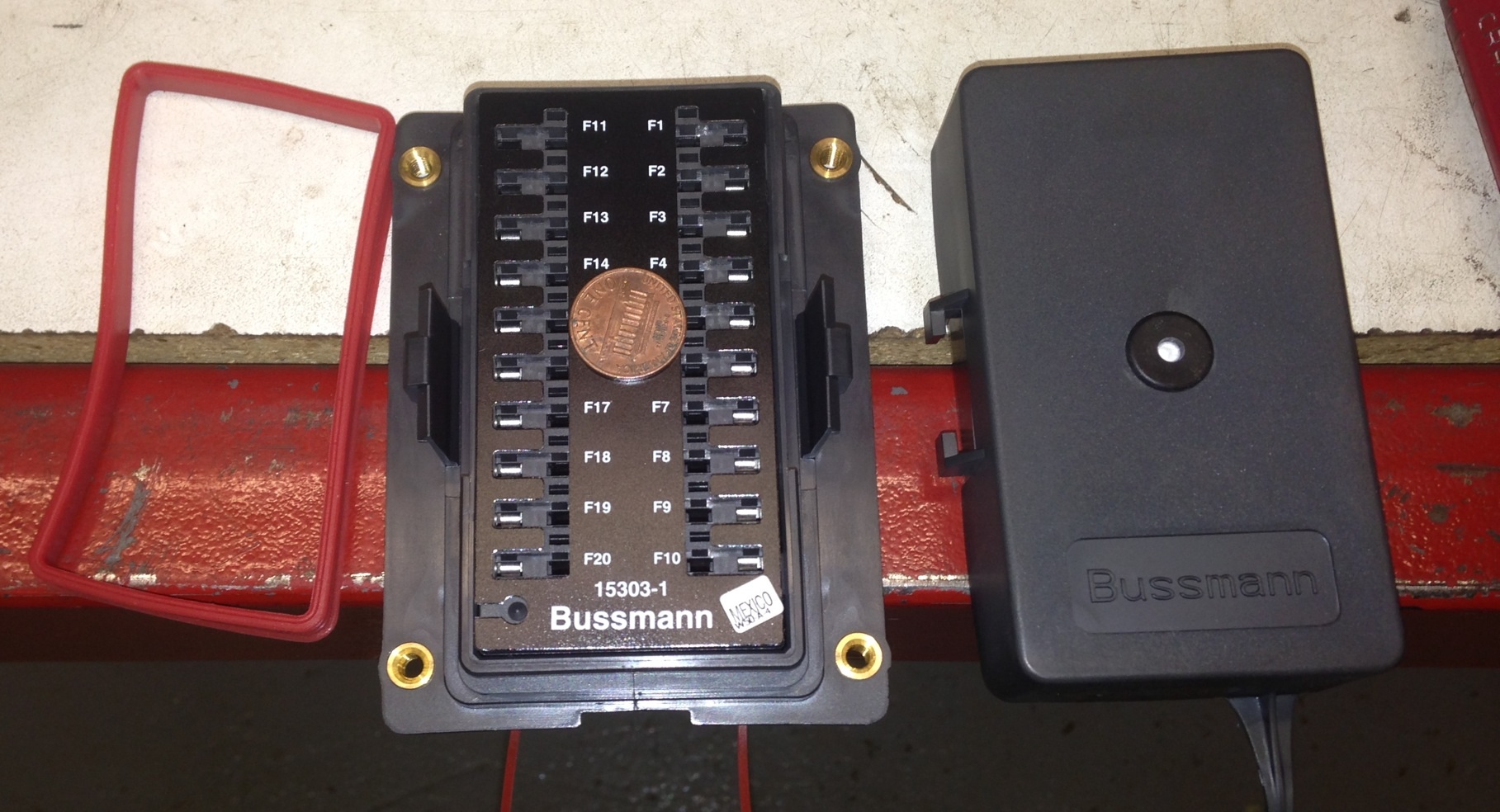

  1. I know most guys like a kit, so this isn't for you.
    But I found this little guy at terminal supply. It's weatherproof if you need it in such a place. It's 20 circuits and split so you can have 10 on the ignition switch and 10 on the battery. Little over an inch thick. image.jpg

    Could we get a full link or address ? And part number. Looks cool.

    That just might be the ticket for some,when I was scrounging junk yards for fuse panels this would have been much better,and it's sealed from the elements. HRP

    What does it look like with a pile of wire connceted to it?

    pretty slick. where do the wires attach? behind the panel?

  20. If you're asking about the cheapy one, GC kid has your answer covered.
    If your asking about the one I posted yes the wires come thru the back. There's a locking type connector the pushes thru the box and locks in place. It's a specialty crimp with a rubber plug that seals it up from the back.
  21. Well Bob, there would be 2 heavy gauge feed wires in and then max 20 wires out. Perhaps one may want to double up a few of those so there could be a few more than 20.
    A group of 20 wires is somewhere between the size of that penny up to the size of a quarter depending on the size of the wires. How neatly or how messy they come off of that is dependent on your personal level of OCD.

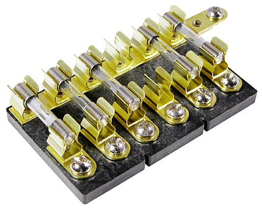

    hnstray, Radio Shack has those. Does anyone know of a nice switched/unswitched fuse panel for AGC fuses?

    You could use any of the ones shown as switched or constant power. Just depends where you pull your feed power from. Either from the switch or or constant power. Only reason I don't like the Buss unit to much is the spade connections. I would rather have a screw that holds more solid.
  29. Sounds to me like Manyolcars is looking for a split panel not 2 seperate panels. And last time I looked AGC fuses were glass. So nothing pictured here takes the glass fuses and the only one panel that is split is the one that started this thread in post #1.
    Check that link for terminal supply above and look at the glass fuse section. They have some, & some common fed but none split.
