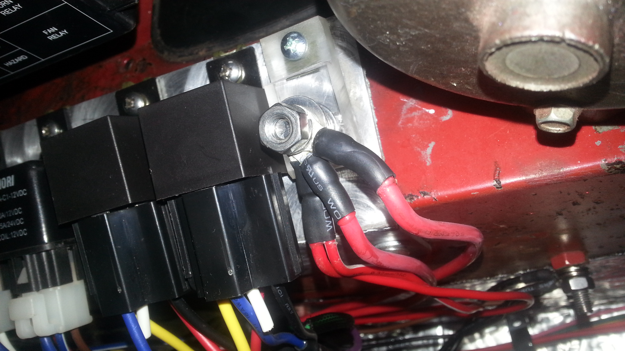

    IMG_0041.JPG I've used these in the past to avoid stacking all the wires on the starter like some of the kits want you to do. http://www.qualitydist.net/buss-bp-jb3816-2.html
    (and don't worry, that copper line was nowhere near that close once cluster was back in)

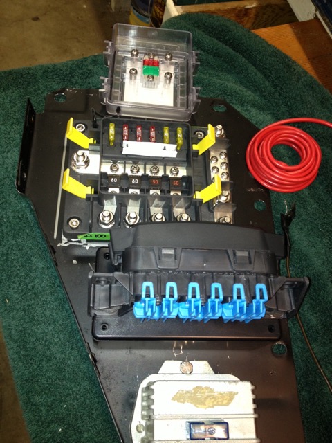

    I've used the Safety Hub 150 from blue sea systems.
    Nice and neat with coast guard approval (perfect for an Amphicar).
    6 atc type fuses and 4 screw in.

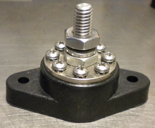

    $20, free shipping. 12voltguy.com
