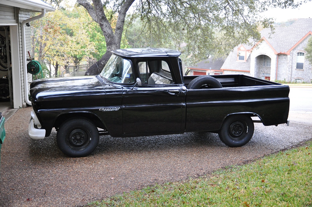

    I recently purchased a '60 C10 - neat story, I bought it from the 2nd owner here in town (he's 85!). I have successfully gone through everything and replaced many parts, wires, tires, etc., and I'm just about ready to head down and get a safety inspection, but I'm having carb problems.....
    The truck sounds like its starving for fuel. I installed a rebuild kit and a new choke cable a few weeks ago and that cleared up several issues. I adjusted the floats per spec. It was majorly hesitating, and I couldn't see any fuel squirting in from the accelerator pump. I took the carb apart again today and found that the "leathers" on the little pump had rolled up and were binding. I swapped out the accelerator pump and it squirts nicely now as it should.
    However, even though the truck accelerates better now, it's still hissing/sucking loudly and has trouble accelerating smoothly. I also replaced the fuel pump, filter, and lines today (thinking maybe it just wasn't getting enough pressure), but the problem still persists.
    When I had the fuel lines off, gas was flowing freely from the tank, so I know there's nothing slowing fuel down from the tank to the fuel pump.
    One adjustment I don't know how to make, is the air screw (not sure wha the technical term is) at the base of the carburetor. I basically screwed it in until the engine started to die out, and then backed it off a bit. I that right?
    Could it be an intake manifold leak? What's a good way to test for this? Spray a little carb cleaner on the manifold seals and listen for a change in the idle?
    What else could it be?
    One other question - how do I time this engine? There are no marks on the harmonic balancer, or a timing marker/pointer that I can see? The owner's manual references using the flywheel, but I can't see how I would access the flywheel from engine bay?
    I loosened the distributor hold down bolt and thought I'd just play with the timing by ear, but a) there's so much play (from the vacuum advance movement), and b) I couldn't get the distributor to turn beyond the play of the vacuum advance.....
    It's a really neat little truck, and in pretty great shape! 52,000 original miles, no rust to speak of. The original owner only used it to launch his boat and go to the garden center. The old fella I bought it from babied it, gave it a new paint job in '83, but stopped driving it about 15-20 years ago, so lots of stuff was rotten......
