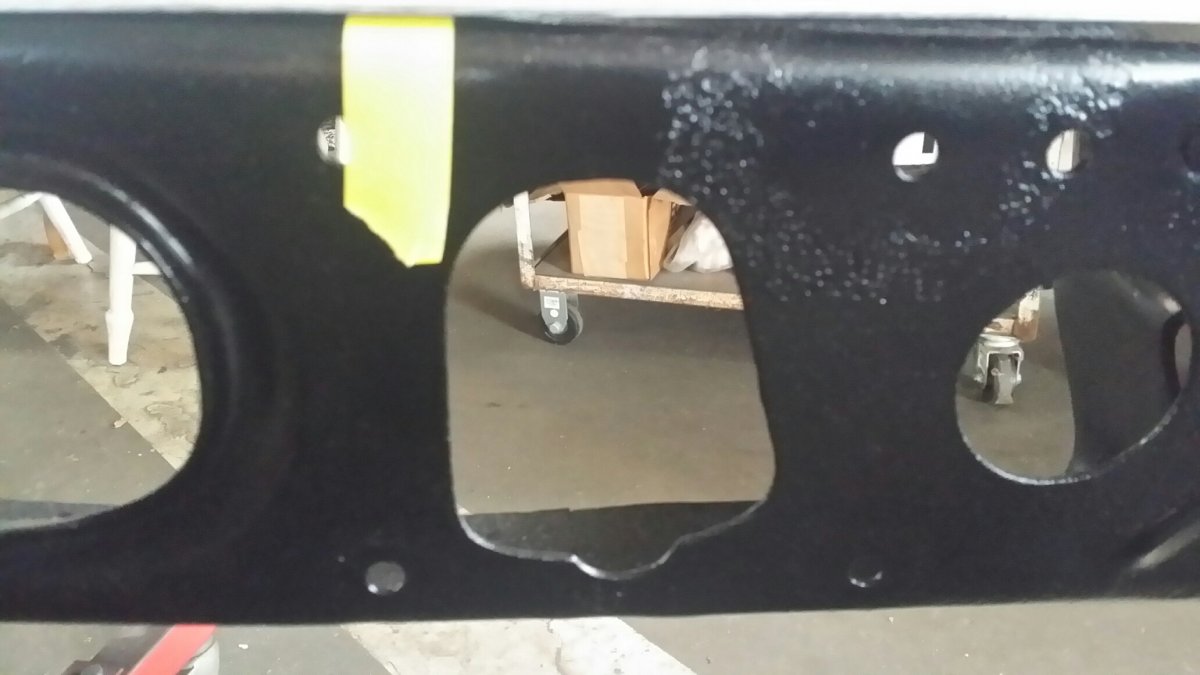

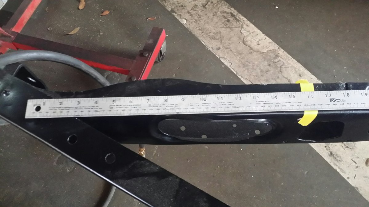

  7. AngleDrive
    Joined: Mar 9, 2006
    Posts: 1,167
    AngleDrive
    from Florida
    15 5/8ths from center of rivet 20190204_101904_resized.jpg 20190204_101922_resized.jpg 20190204_101934_resized.jpg

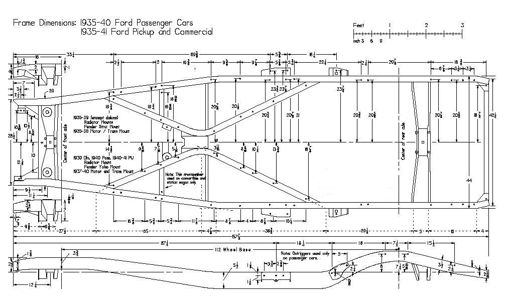

  9. chubbie
    Joined: Jan 14, 2009
    Posts: 2,361
    chubbie
    Thanks angle! Larry I have a bunch of measurements ….
