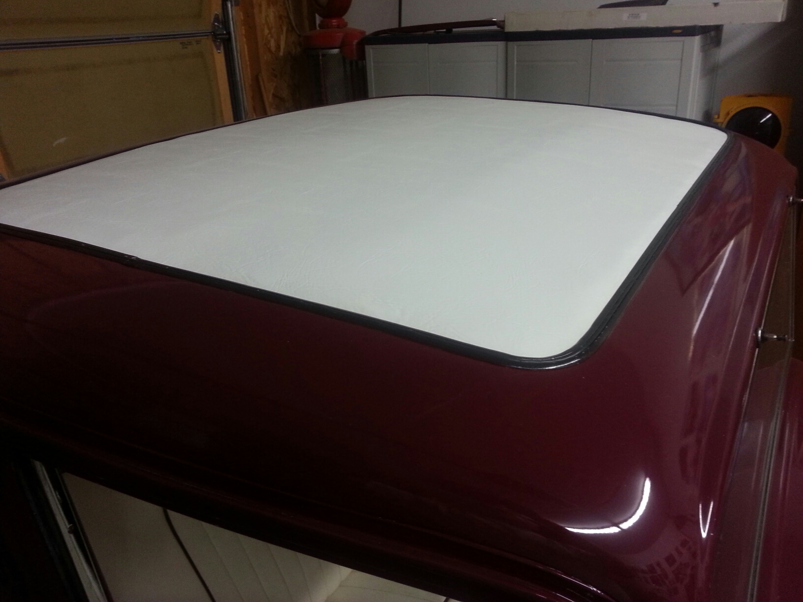

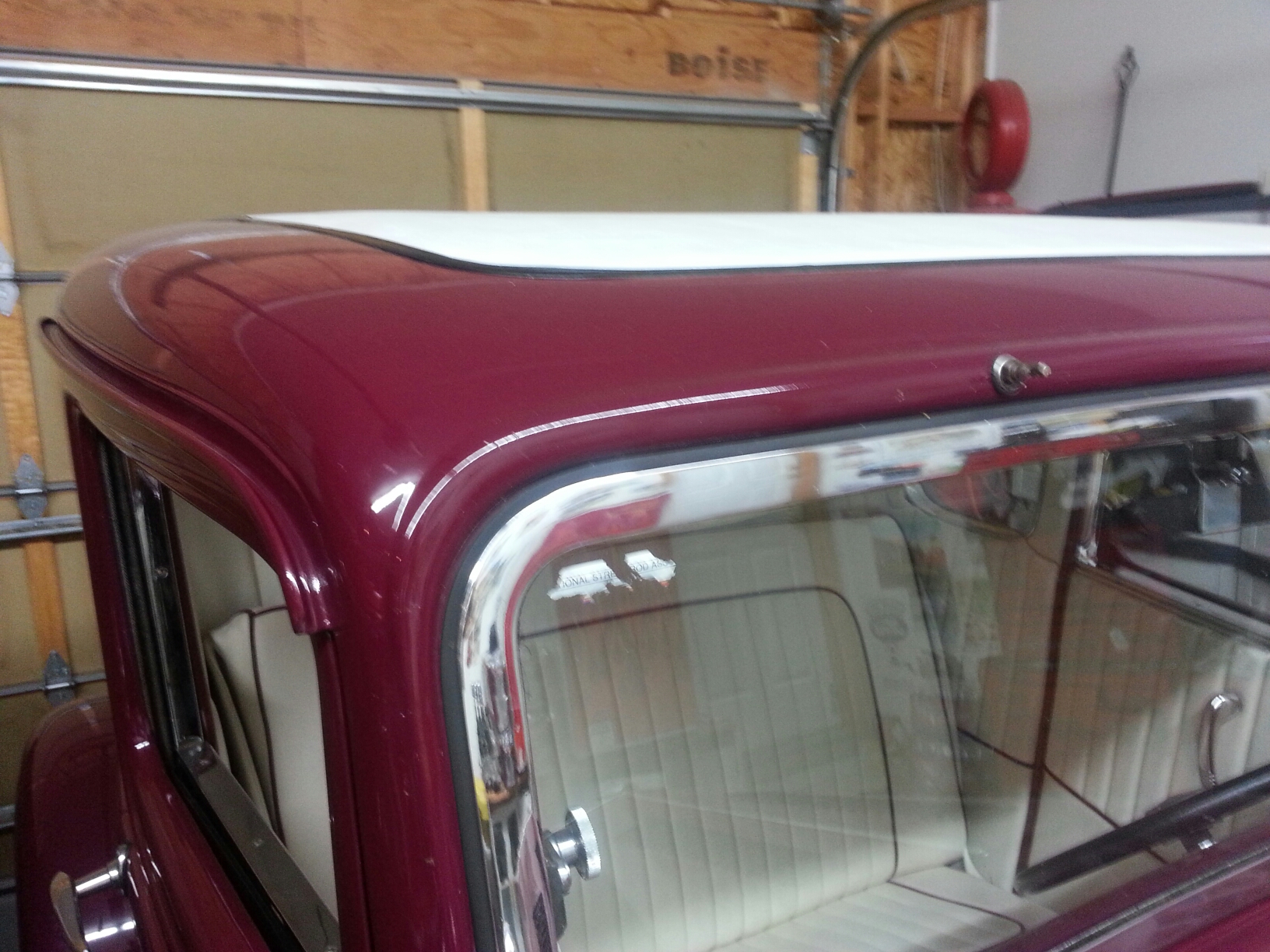

    Contact Jerry at 636 240 8712 HE has it and its already shaped to fit. I have some original but it needs a little work and I wanted a top in right away so I used his. I love it. Everybody so far thought it was original until I told them what it was. I installed it by my self. Not a great pic but 20140820_194829.jpeg

    20140820_195245.jpeg It comes as a kit . Its already bent to fit just small adjustments are necessary . It comes with screws instead of tacks and the rubber trim insert also has instructions . The screws are much better than tacks. The aluminum trim its self is in two pieces a front and rear that needs to be cut where they meet. It was not as hard as I thought it would be I did it by self with a little help from my wife in the stretching department. I'll try to get some better pics tomorrow. I have it tore apart so its had to get some good light back there. I had a hard time finding it but I found it on the HAMB before they changed the site around. I cant find it now. I got the # Off the shiping label The guy lives in MO. It was kind of expensive but well worth it. I would do it again
