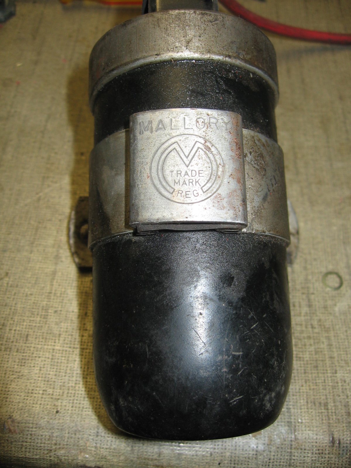

    If it's the car in your avatar, I'd run an old "flattop" Mallory and a "Best" coil.
  10. LuckyOC
    Joined: Jul 14, 2024
    Posts: 7
    LuckyOC
    Yes it’s the car in my avatar. Is that an old dual point dizzy you’re referring to? What about a new Mallory unilite?
  11. tubman
    Joined: May 16, 2007
    Posts: 8,299
    tubman
    I think the distributor should fit the period of the car. It's pretty small, but your avatar looks like an older style rod (mainly the 283, dual quads, "wide whites"). As such, it deserves an old style distributor, and a Mallory "flattop" sure fits that description. They are still not that hard to find or an SBC and surprisingly, parts aren't that bad. They also work very well; I have them on flatheads, a couple of early hemi's, and an Olds "Rocket". A Mallory ""The BEST Coil I Ever Made" rounds out the "look". A "Unilite" isn't even close in style, plus, I've heard they can be unreliable.

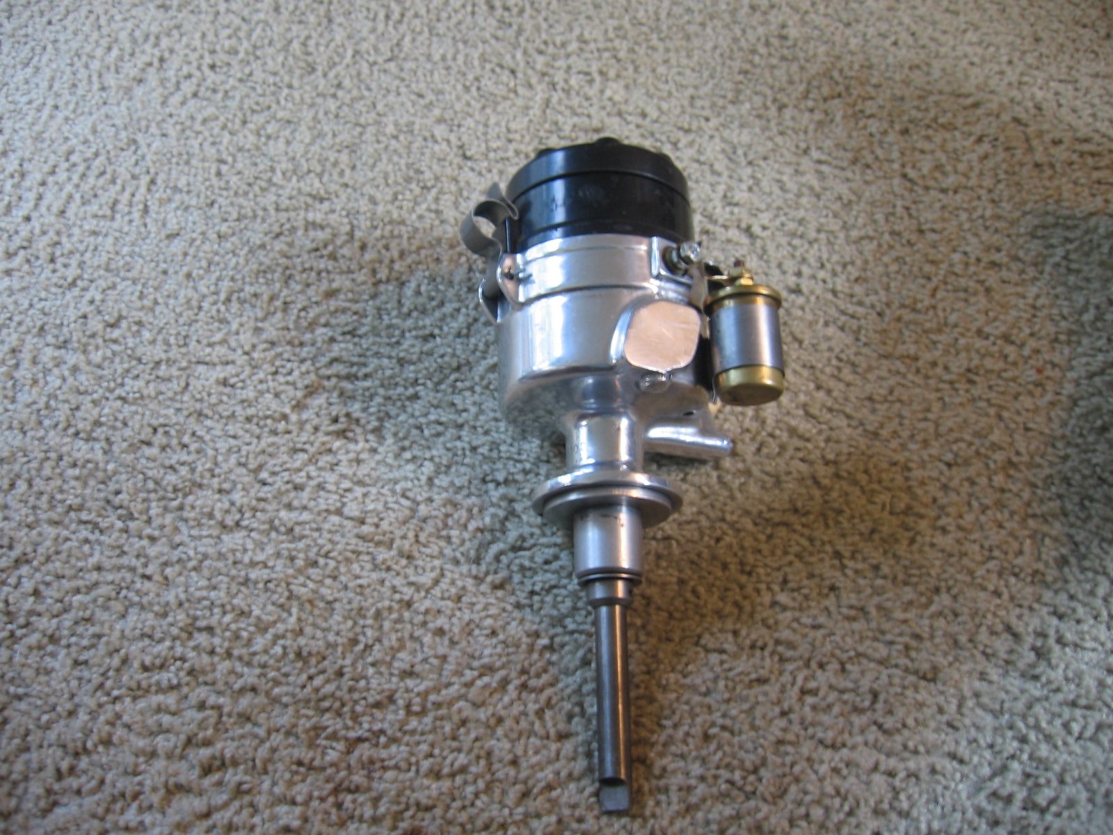

    I have an Nos 57 - 62 dual point distributor if your interested
  17. tubman
    Posts: 8,299
    tubman
    This would be a good choice.
  18. lumpy 63
    Joined: Aug 2, 2010
    Posts: 3,387
    lumpy 63
    20240715_194856.jpg 20240715_194828.jpg Not real proud of it, if it helps a brother all the better

    What are you wanting for it?
