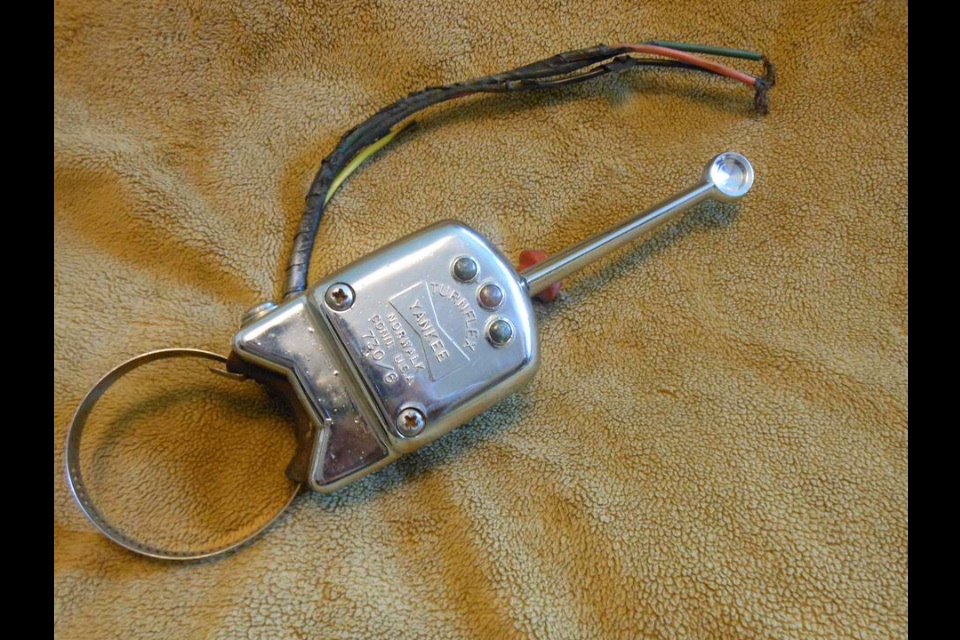

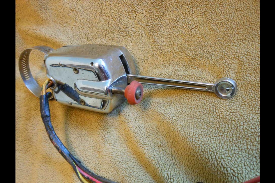

    Vintage switches like that, guide signal stat for example, are for sale on fleabay and the classifieds here all the time. They were built when things were built to last. Lots of them look really cool and the schematics for a lot of them are online.
    I stopped ordering most catalog stuff 4-5 years ago because 9 times out of 10 there was something I just wasn't happy with.
    I assume you're talking about replacing the green bulb at the end of the stalk? You may get lucky and find something with the same thread and diameter in a different color but like was said already, you'll just have to search.
    Here's one on the fleabay right now. $20 buy it now, just like the one you bought. IMO, looks better too. Fix a few wires and you have a nice switch.

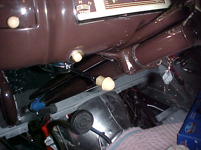

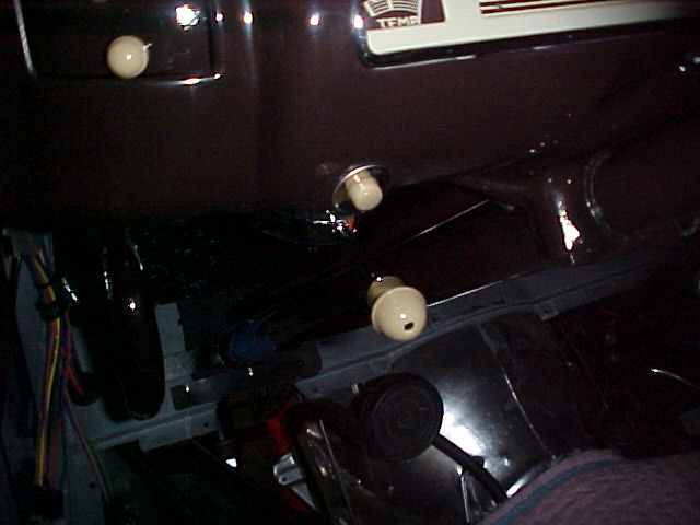

    I use that type on 40 fords and hollow out the end of a 40 dash knob(maroon for dlx and tan for std) so it fits over the end of the green lense then drill a small hole in the end so only a green dot shows and paint the portion behind the knob--just finished and installed one today-looks like it belongs there.

    here's a pic I think if I did it right
