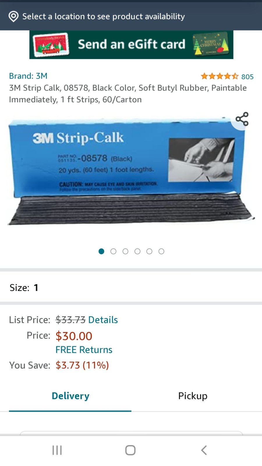

    A buddy I reached out to is calling it Dum Dum Putty, and saying it isn’t as sticky as the butyl so it comes apart easier when you need to service stuff.
    X-cpe, VANDENPLAS and SS327 like this.
  4. The 3 M is not like we had in the factory back in 64. 3 m changed their Chalk a few years back. This is not the same now. Ours came form Mortel. Best ever stuff.

  7. I’m the late 90s at the Chevy dealer I worked at we used 3M strip caulk. Worked just as well as the old stuff. You needed it to seal up any GM acc/heater box under the dash.
    lewk likes this.

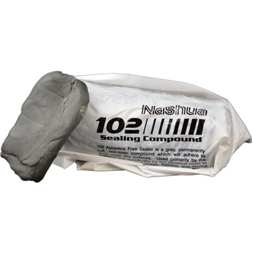

    Have always used Duct Seal. Does everything you specified.....play dough like, stays pliable, reusable and gray. 8 bucks for a 1 lb. stick on Amazon. Electric line departments have used it for years.
    lewk likes this.

    There it is. I guess this dum dum is headed for Home Depot. Thanks for the help guys!

    The 3M strip caulk is black, but it's good stuff and it doesn't get hard. It's available at most auto parts stores.
    SS327 and lewk like this.
