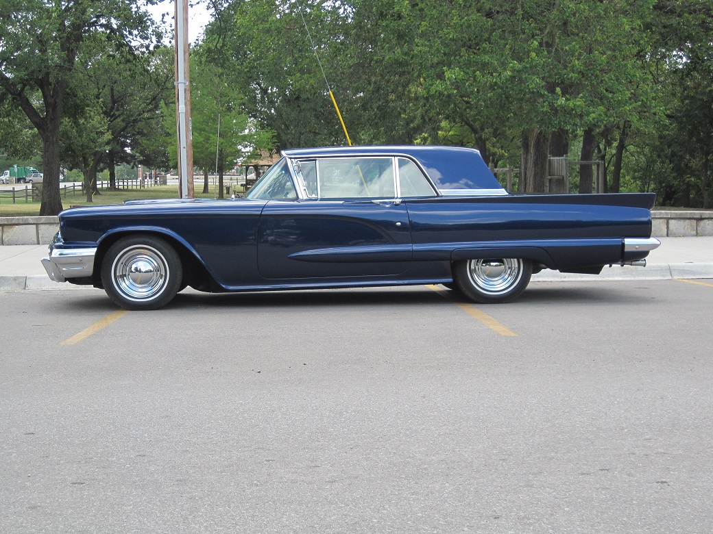

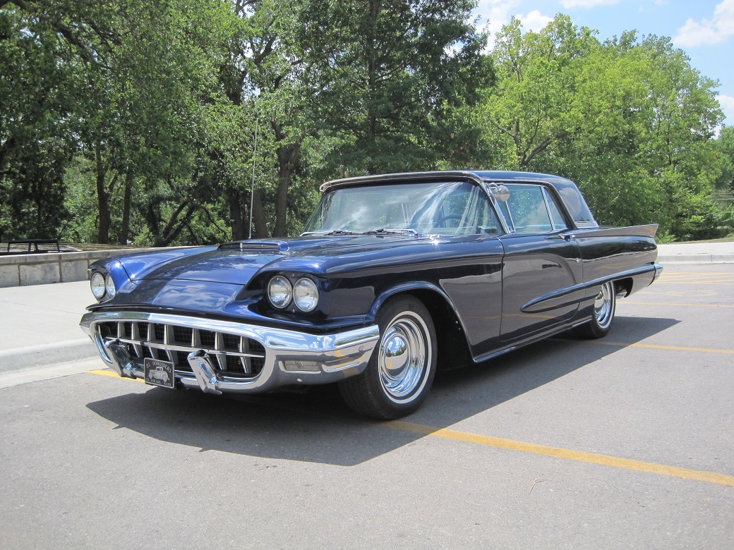

    Had a 60 Thunderbird, sold it about a year ago and had 14 x 7" chrome wheels with narrow whites on it when I wanted the custom look. Also had a set of Torque Thrusts 15 x 7 " on the front and 15 x 8 1/2" on the rear when I wanted to change the look. The 15 x 8 1/2" were tight but didn't rub, Had to jack it all the way up and let the rear end hang as far down as the shocks would reach to mount them.

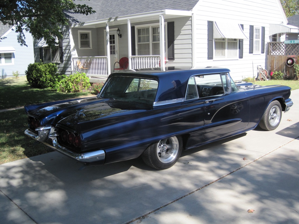

    First off that was a good looking bird. Do you remember what the back spacing was on the 15s? And on another note what was your grill out of?

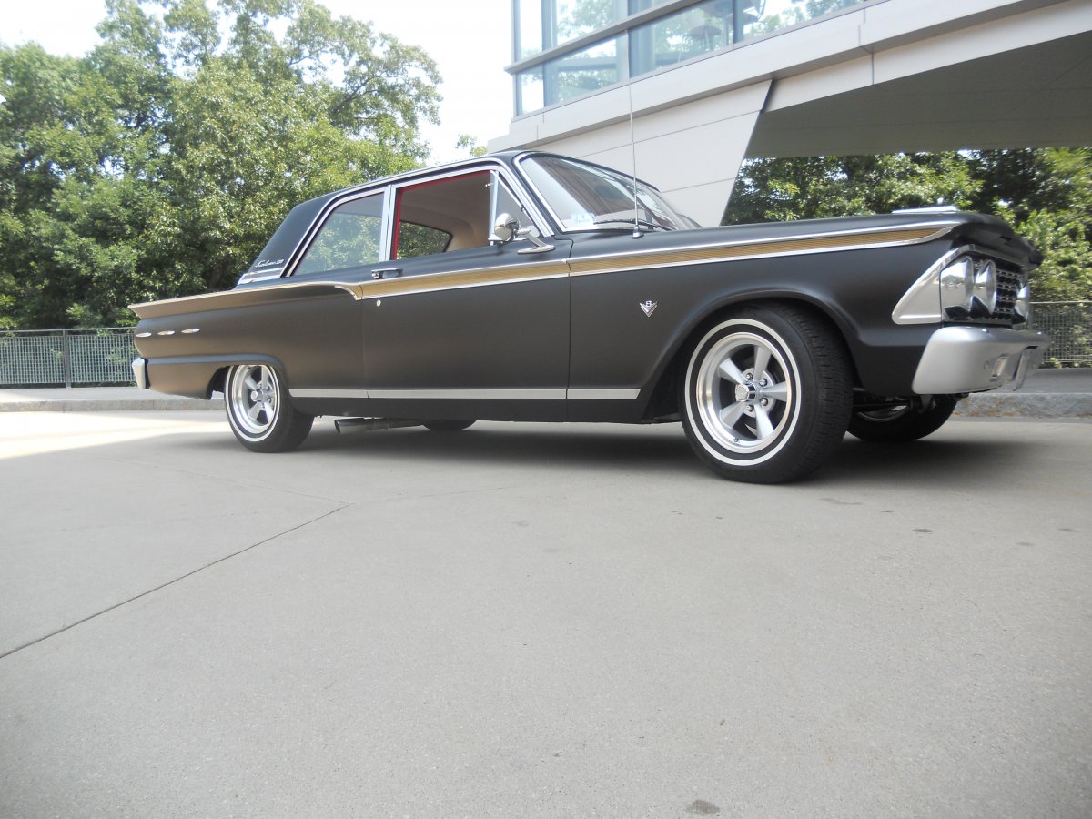

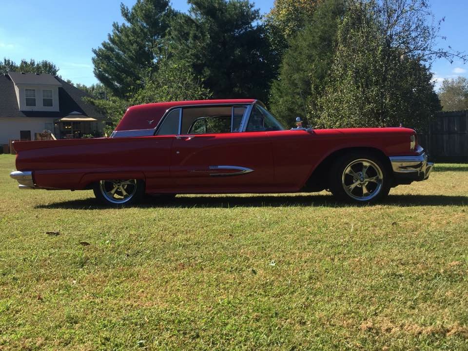

    I like the look of my '62 Fairlane. Ridler 675s.
