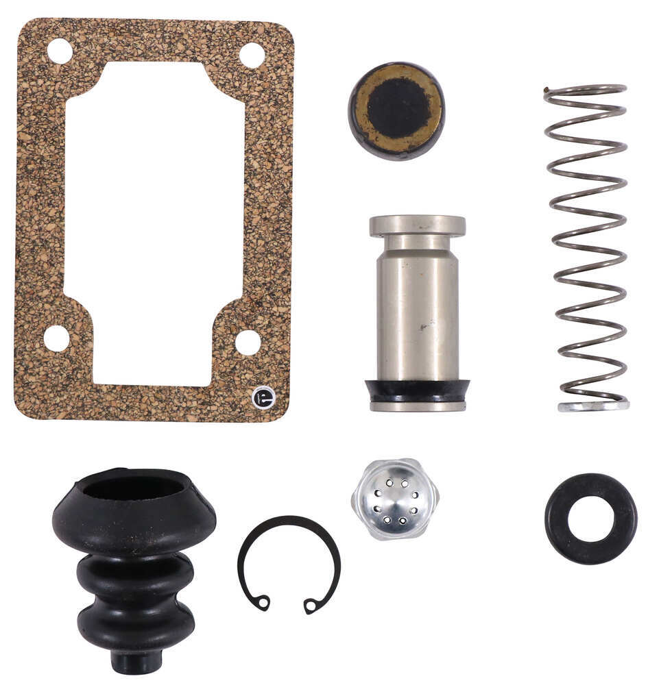

    Very helpful. I'm looking at an image of a rebuild kit for my master cylinder and I do see the hexagon-shaped metal part you mentioned, so it does have a residual valve set up. To be certain, are you suggesting removing only the rubber flap, or the entire metal hexagonal piece with the rubber flap? I'd like as much info going in as possible because the MC was a real chore to install and I'm hoping not to do it too many times. ;) 48 Cadi MC kit.png

    You would remove the entire piece and put it all back together. And then you could add a in line 10PSI residual valve for the rear brakes if you need them. I personally did this on my 64 El Camino After I added disc brakes. The calipers would hang up.So I removed the residual valve and everything was great. I later converted to a dual chamber and power brakes.
