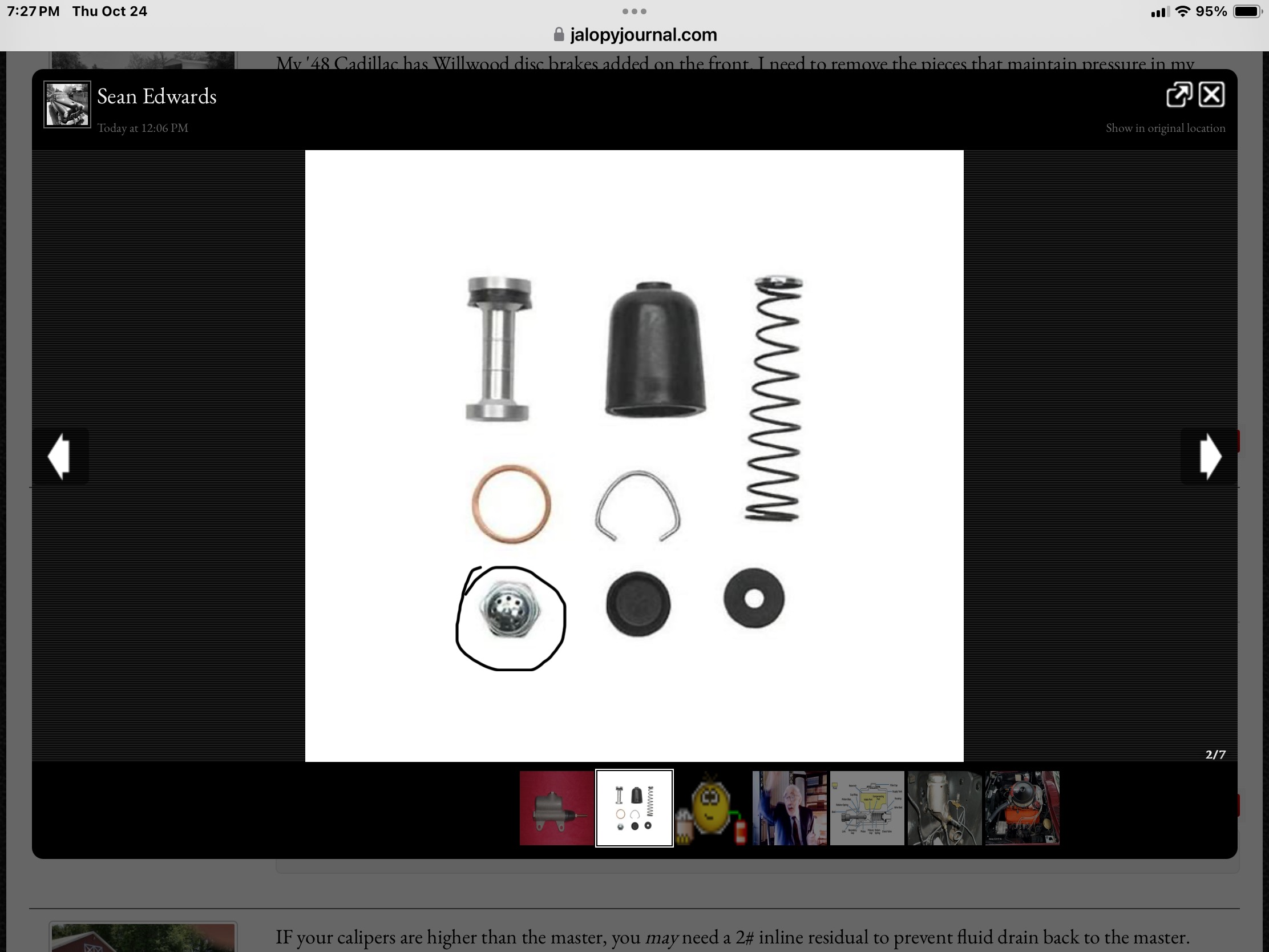

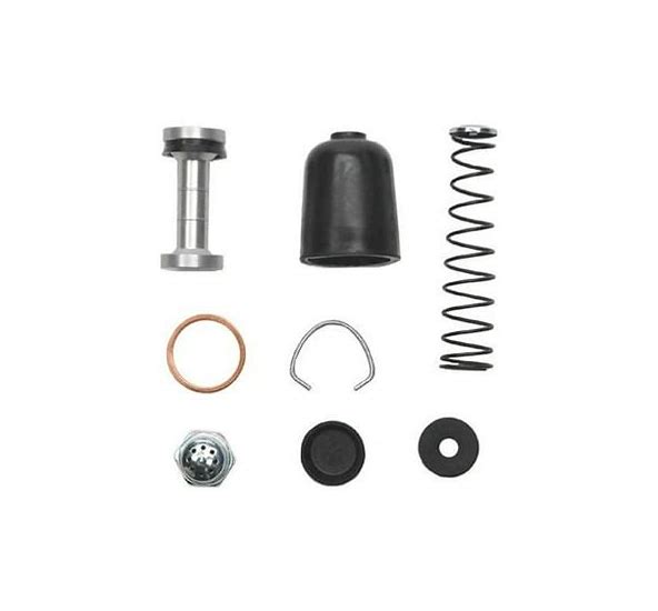

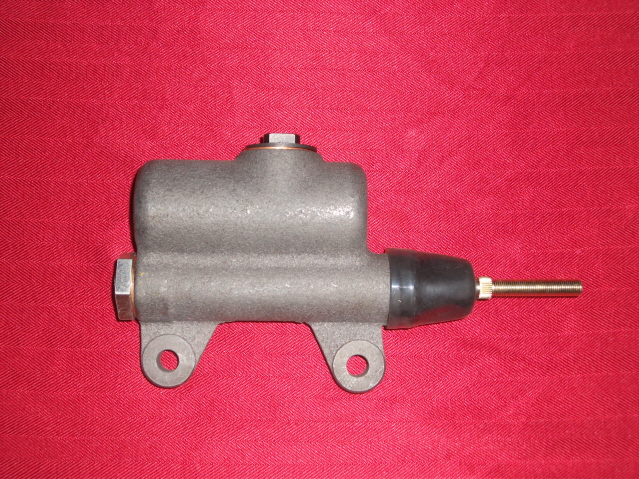

    My '48 Cadillac has Willwood disc brakes added on the front. I need to remove the pieces that maintain pressure in my brake lines within my new stock reproduction master cylinder and wanted to get advice on exactly which parts to remove. Attached are pictures of my single outlet MC, and a rebuild kit for it. To disable the residual valve. would I remove the rubber piece on the backside of the hexagonal metal piece only....or do I remove the rubber piece and the hexagonal metal piece. Anything else I should know? Any advice is appreciated.

    The hex metal piece is the valve, the rubber washer just seals it to the housing. I remove both of them.

    IF your calipers are higher than the master, you may need a 2# inline residual to prevent fluid drain back to the master.
    I would install a 10# inline residual to the rear drum brakes, taking place of the internal valve you are removing.

    Yes, great idea and thank you. I'm planning on getting a 10 psi inline valve and installing it to maintain that needed pressure to the rear wheel cylinders.

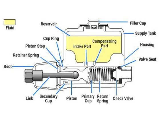

    To answer your question just pop the innards out of the check valve. You need the shell of it in there to keep the spring centered. 5596c489-8b3a-48aa-a1f2-595c5269a509.jpg

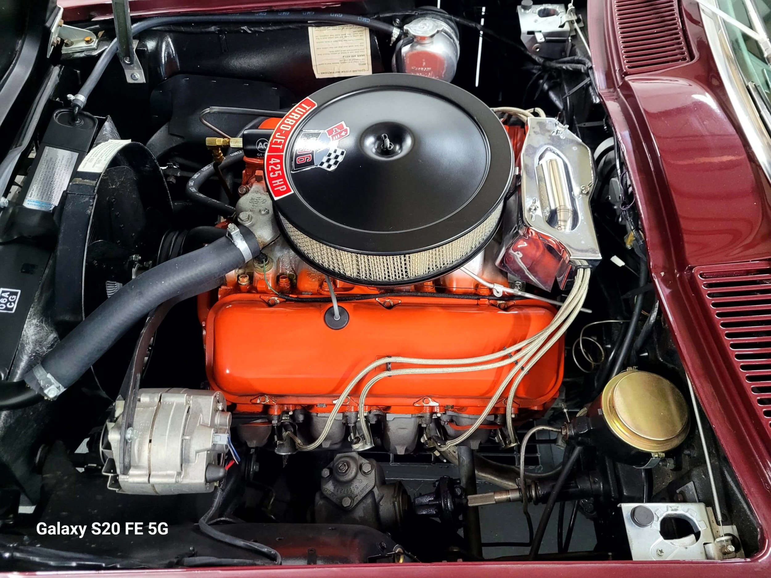

    67 was the first year that US cars had to have a dual MC. Discs were around before that. With single pot masters. The reservoir was pretty large, because fluid is needed to fill the calipers as the pads wear.
    Mustang, Disc/Drum:
    Corvette, 4 wheel Disc:

    IMG_7675.jpeg I just pulled the rubber out of the little hex valve and put the hex back in. Stops on a dime.
