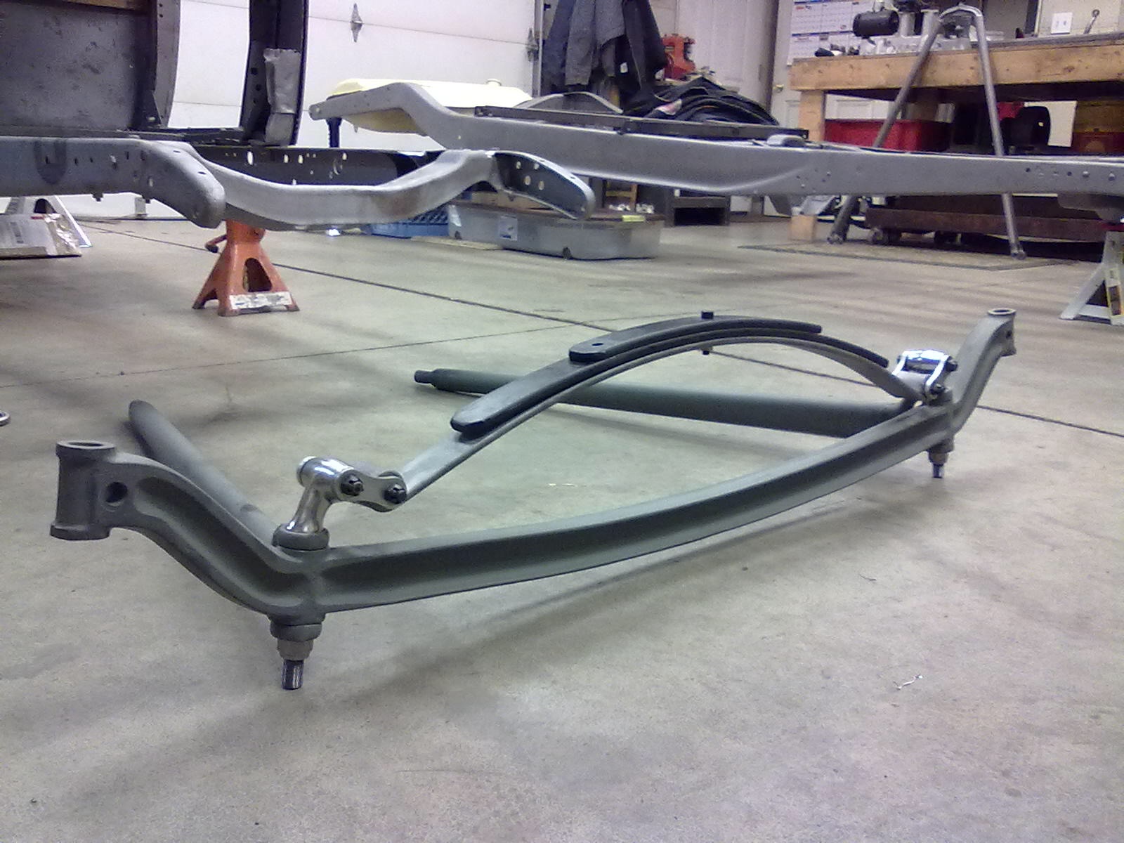

    Why not get or have a real ford axle dropped? 37-41 spindles, drums, hubs and juice brakes will get you 5 on 5 1/2 bolt pattern. Use real ford stuff, it just looks better and will be way less cash.
    Here's a pic of my 3" drop Model A axle, split Model A bones, new reversed eye spring and I've got less than $500 into it.
