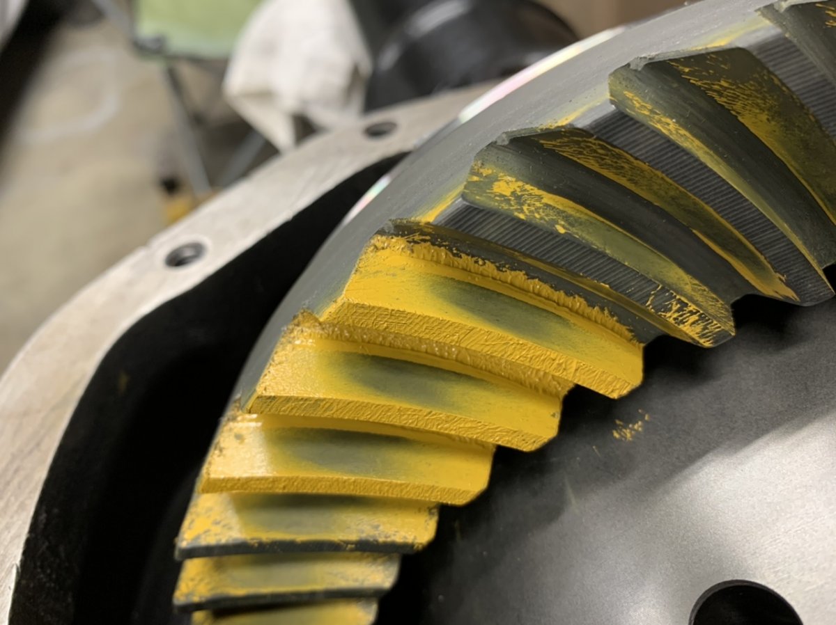

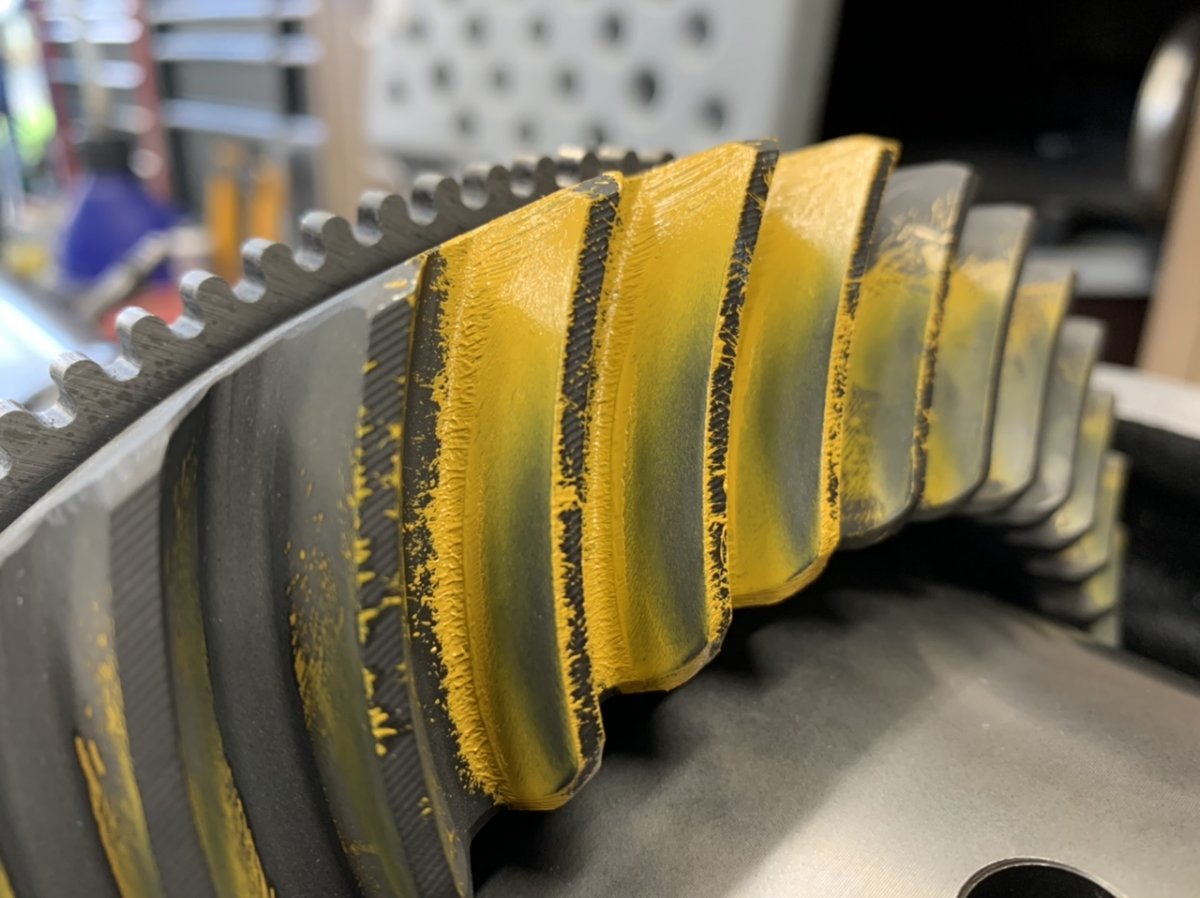

    I’m tackling my first ring and pinion setup, and finally got to running my first pattern; of course, they don’t come out all pretty and perfect like they do in the manuals, do they? My first impression of these is that the pattern sits high on the tooth, but I’m glad I took these photos because after looking at them a few hundred times, I’m kind of seeing that there is just barely a thin bead of yellow across the top of the gear tooth.
    Is this pattern what is consider “floating”? Is it good enough? Does pinion height affect backlash the same way that adjusting the carrier does? Thinking that this was maybe a touch high, and a touch towards heel on the drive side and toe on the coast side, I tried to move the ring gear 0.003” closer and ran out of backlash, so this is my best pattern with backlash in spec. Should I try to raise the pinion a couple thousandths?
    Thanks HAMB!

    I’ve seen worse!

    I always try to get the pattern looking about right by adjusting the pinion to center distance (the mesh) before finally worrying to get the backlash in spec. the backlash just reflects the depth of tooth engagement and won't have much effect on the pattern. I would try moving the pinion out a few thousanths on yours and see what the pattern looks like then -the drive and coast/overrun prints don't usually move at the same rate when you make a small change to the mesh setting.

  4. I had a pinion depth spec on this gear set; Dana doesn’t publish a “spec”, but rather a +/- of “nominal”, which this is set based on the shim pack that came out of the axle (it was obvious that no one had ever been into it). That’s why I went straight to backlash, and then ran my first pattern.
    I appreciate your point about the “drive/coast patterns not changing much when you make small changes to mesh”, but what about backlash? If I raise the pinion a couple thou, will backlash decrease? I ask, because the corresponding change I would have to make to the carrier shim would probably push the drive pattern further to the heel, based on my limited understanding of these concepts. I’m inclined to try it, just for the education, but I’m wondering if it will have any benefit...

    First of all that pinion needs to go in, to get the pattern towards the toe flank of the tooth, pinion depth is the primary means of pattern adjustment, backlash will move it along the pitch line of the tooth. Set backlash last. Do not worry about the coast side, get the drive side nice and let the coast fall where ever it ends up.
    That being said I wouldn’t be too afraid to run it like that, it’s not terrible that’s for sure.

    Yes, move the pinion towards the center of the ring gear, the pattern should move in towards the toe or inside of the ring gear and towards the flank or down into the “valley” of the tooth. You don’t need to go much, maybe 0.005” to start with, set backlash run a pattern, repeat as necessary.

    I’d move the pinion in .005-.007 to bring the drive side towards the toe of the gear. The coast side should go the opposite and move more to the middle. It’s very close. I don’t like the coast pattern. Drive pattern would be ok but you can’t just move one. All my opinion of course. Like another poster said, polished carrier bearings make it way easier.

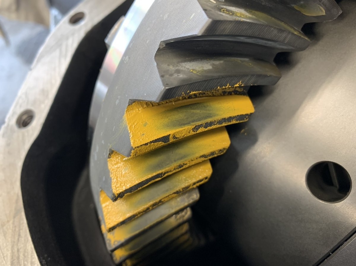

  16. 57 Fargo, I wanted to follow up. This is 0.005” more shim on the pinion, same shim pack on carrier, backlash within spec (smaller side of the spec, and checked in several places). What do you think? Keep going, or is that as good as it’s going to get?
  17. I think I'd let it roll, at this point.

    Me too! But I probably would have used the first one! As hard as those thing are to deal with! Lol , but this is better!

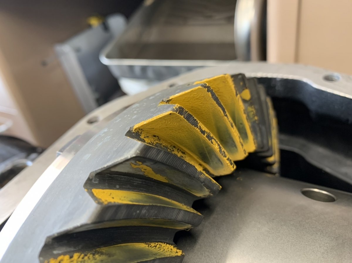

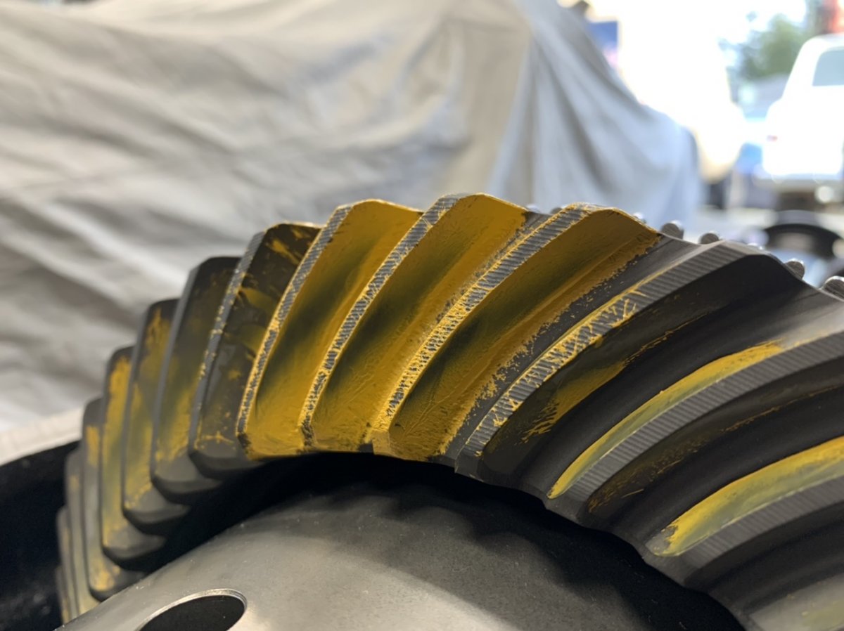

  24. Anybody care to weigh in on this pattern? Another Dana 60 axle, this is the first pattern I have run on this one, with backlash in the middle of the spec, and pinion depth set according to the markings.
    The pattern is high on the tooth and towards the toe, but if I raise the pinion higher, won’t that also push the pattern even further towards the toe?

    Are these new gears or used? You are correct that moving the pinion towards the heel will also move the pattern higher, a toe face pattern, which is what you have, usually says the gear set is no good, there is no way to fix that patterns.

    I think the latest pattern is a different gear set...

  28. This is a brand new Dana/****er ge****t. The little guide they give with the gears says that if it’s toe/face on both the drive and coast side that the fix is decreasing backlash, and I CAN tighten it up a couple thou and still be in spec, but it’s only toe/face on the drive side, so I wasn’t sure if that was going to be the correct move...
    Yes, this IS a different gear set (different axle), Kevin. I just got so much good help last time that I figured I’d post here again.

    Backlash will move the pattern slightly along the pitch line, so from heel to toe, and it’s very little that it will move it, you need to go a long ways, you can play with backlash but I really don’t think you will get a good pattern out of that gear set.
  30. First, thanks for responding. Are you saying that backlash moves the pattern from heel to toe as it decreases? I think I can swap about 0.003” worth of shim from side to side to “increase” the backlash a couple thousandths and still be (barely) in spec, if that will move the pattern in a beneficial direction. I understand that that will be a very small change. I can also raise the pinion a bit if it would be beneficial to move the pattern towards the root, but that may negate the backlash change.
    In your opinion, should I be trying to get “this” pattern as good as I can get it and run it? Or should I be trying to get my money back for the ge****t?
    My understanding is that it’s just impossible to get a great pattern on some gear sets, but that that’s just life, and you can probably still have a properly operating axle. Is this one of those situations, or do I have defective parts?
