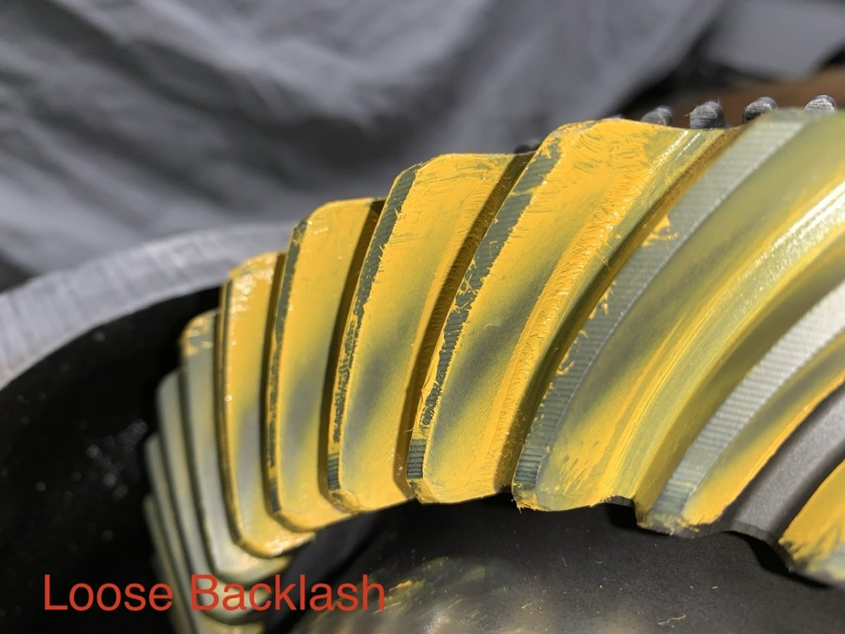

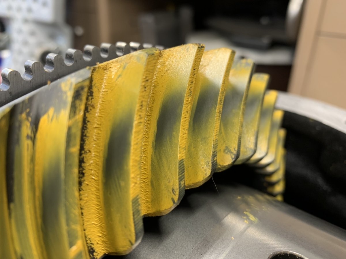

  3. As I’m just learning, I want to put the extra work in to get this thing as close as possible...
    I am using setup bearings, so that makes it a bit easier.
    Boneyard51 likes this.
  4. So, I tried moving the pinion out 0.003” (away from the ring gear), reset backlash, and the pattern was so high on the tooth that it barely registered. I ran backlash all the way down to 0.004” which is the low end of the spec, and it was still terrible. And then I went the other way, moving the pinion in 0.004” (towards the ring gear) more than it was in the first pictures. The pattern moved, predictably, a bit lower on the tooth (root), but also towards the toe.
    It’s really hard to tell, as I’m still such a novice, but it really doesn’t look like it’s running off the face of the tooth anymore, but I think that it IS running off the toe just barely (see the dark spot right on the edge of the toe). Is that any “better”, or am I just chasing my tail. Should I try anything else from here?

    Looks like the pinion needs to move out to me about .003-.005. Put the backlash to .007-.010. That would be my move if I were doing it.

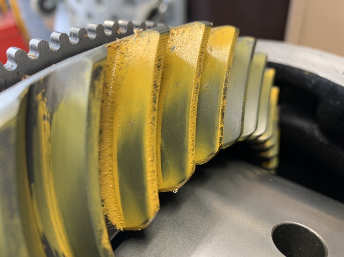

  13. Kevin Ardinger
    Joined: Aug 31, 2019
    Posts: 1,050
    Kevin Ardinger
    Those last pics look good to me

    Like said, both look “ close enough “ . I always try to set my back lash as small as possible, because it will get larger as the bearings wear in. Also I place the pinion as close to ring gear as the pattern will allow because as those bearing wear in the pinion will move slightly away from the ring gear. Just food for though.
    Since you mentioned you are learning about gear patterns, maybe you should acquire a nine inch Ford to play with. You and adjust those both ways in a matter of seconds. Your learning curve will be substantially sharper!

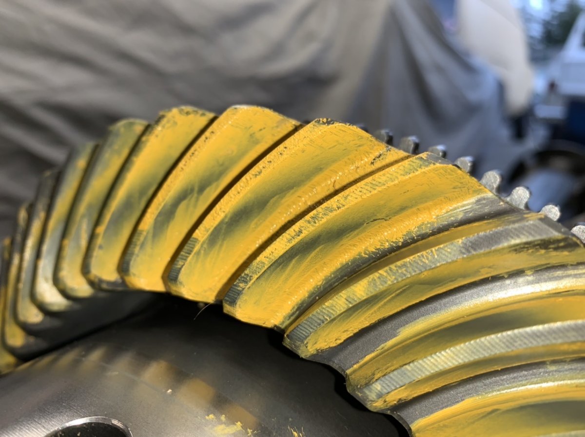

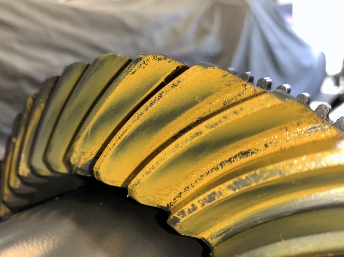

  20. Ok, so, I’m still tinkering on this thing, just in the interest of learning...
    I decided that I need to throw out everything I did yesterday, because I wasn’t putting enough drag on the carrier as I was spinning the gears, and when I started doing that, the patterns changed a LOT.
    After about a half-dozen times in and out, I have the following pair of patterns that I feel are both pretty close. They are both with the same pinion height, and one is with loose backlash, and one is with tight backlash (both ends of the spec). What is driving me nuts is that no matter what I do I can’t seem to get the pattern further down the tooth (face to root). At one point I added another 0.003” shim to the pinion, and it still seemed to ride high on the tooth, but went quite a bit further to the heel.
    So my question is, should I try another thou on the pinion, trying to keep the backlash tight? Or should I just run the looser of these two backlash settings leaving the pinion where it is, and not worry that the pattern is high?
    Oh, and for what it’s worth, I’m pretty sure these are Face-Hobbed gears, versus Face-Milled. The toe side of the tooth IS shorter than than heel side, but only by about 0.010”...that would explain why increasing the pinion height is pushing the pattern towards the heel instead of pulling it towards the toe. Thanks to @Ericnova72 for setting me straight on that.
    Here are the pics!

  21. gimpyshotrods
    Joined: May 20, 2009
    Posts: 24,629
    gimpyshotrods
    Run the backlash tight, double-check the torque on all of the bolts.
    Finish it up and stop worrying. You did good.
