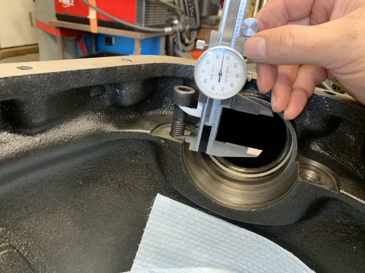

    So, I’ve been slow to post measurements because I actually don’t have an outside micrometer that goes that big to measure my snap gauges (it will be here Sunday). The bearing races do fit snugly in the caps, but they don’t have any interference to speak of, except for some tension right at the parting line. This leads me to believe that maybe the caps have stretched, as is common I guess!? And when you pull the bearing race up into the cap, there’s clearance in the housing, but is that because the housing is worn out, or is that because the cap is stretched and I’m pulling the bearing out of contact with the housing?
    So, when I force the bearing race down into the housing bore with the cap off, I can no longer fit a 0.0015” feeler gauge (my smallest) anywhere around it. If I put the 0.0015” feeler gauge on the housing surface, and press the bearing race down on top of it, it’s very difficult to remove. So, while I don’t have any interference in the housing half of the bore, I also don’t have very much, if any, clearance...that is until you pull the race up into the (most likely) stretched cap.
    This leads me back to the idea of either replacing the caps, or surfacing down the ones I have. What I am struggling with about the folks telling me to replace the housing is that Strange and Mark Williams are recommending these caps for high-horsepower dragstrip cars, but they are only concerned with the diameter of the bore from bottom of housing to top of cap. They don’t say that you need to hone your housing after install. So there’s no way that a housing with those caps installed is going to be exactly concentric, which leads me to believe that the interference fit comes mostly from the top-down direction, and that they might intend the cap itself to provide some of the carrier control in the up and down direction (axle in the car).
    The spec for the bore (according to Strange) is 3.812” +/- 0.002”, and the bearing size is 3.815”. That means that a bore on the big end of the spec would only have 0.001” interference. That said, I’m really eager to get my 3-4” range outside mic, because according to my calipers, one of the set of bearings I have measured 3.8135” And the other measured 3.814”, but 0.001”-0.0015” error with calipers opened that wide is easy to get. Regardless, I can’t imagine I’m that far off if I can get new caps, or whip these ones back into shape, and I can always employ the Permatex for added peace of mind.
    Anyway, I really appreciate all the back and forth, and I appreciate you guys thinking through this with me. Considering that this thing was running and not making noise with this much slop in the carrier AND pinion (bores, caps, or both), and I can conceivably take away all the slop, introduce some interference in at least the top to bottom direction, and back it up with sleeve retainer, I think this thing will probably live a while...and I can look for a housing to replace this one down the road a lot easier when I get my van back on the road.
    Given the new information, and considering all the information, does anybody think that’s a seriously bad idea?

  16. Sooooo...
    I’m a little bit embarr***ed. Remember when I said that the carrier bearing races were supposed to be 3.815” OD!? Yeah, well, they’re actually supposed to be 3.8125”. And the spec for the bore is 3.812” +/- 0.002”. That means that the carrier bearing in a Dana 60 can have up to 0.0015” of clearance and still be in spec.
    I’m still glad I went through this exercise, as I discovered that my caps were stretched in the process, but it seems like my housing is actually right in spec. Looks like @Boneyard51 was exactly right when he said that on the Dana 60 “close counts“.
    After a lot of deliberation, I think I’m going to order the Mark Williams caps and I will try to do***ent the process of installing them. As Bones said, if I screw that’s up, I still have my stock caps to fall back on. I’ll keep you guys posted.

  21. I actually just wrote the darn spec down wrong...haha! So it’s more brain-fart than technical error. Story of my life!
    My new Fowler outside mic is what clued me in to the error. My previous measurements came from a pair of Harbor Freight calipers, and I knew they were going to be off. As I was trying to get a feel for the new mic on my bearing races, and expecting them to be 3.815”, I was definitely questioning the accuracy. When I looked up the actual spec again, it was surprisingly close. I’m still trying to get a feel for reading the tenths scale, but I’m measuring my NTN bearings at 3.8127”, and my Timkens at 3.8128”. The Timkens are definitely bigger than the NTN’s, because I’m repeating those measurements, going back and forth between the two, but I wonder if the 0.0002”-0.0003” variance I’m seeing is error, or if they’re actually a few tenths over-size?
    Either way, my previous statement stands that a housing bore CAN be in spec with at least a thou of clearance on the carrier bearing bore. I’ll try to get some accurate snap gauge measurements now with the caps torqued in place, just to judge how much they stretched. Figure it will be good practice while I’m waiting for parts.

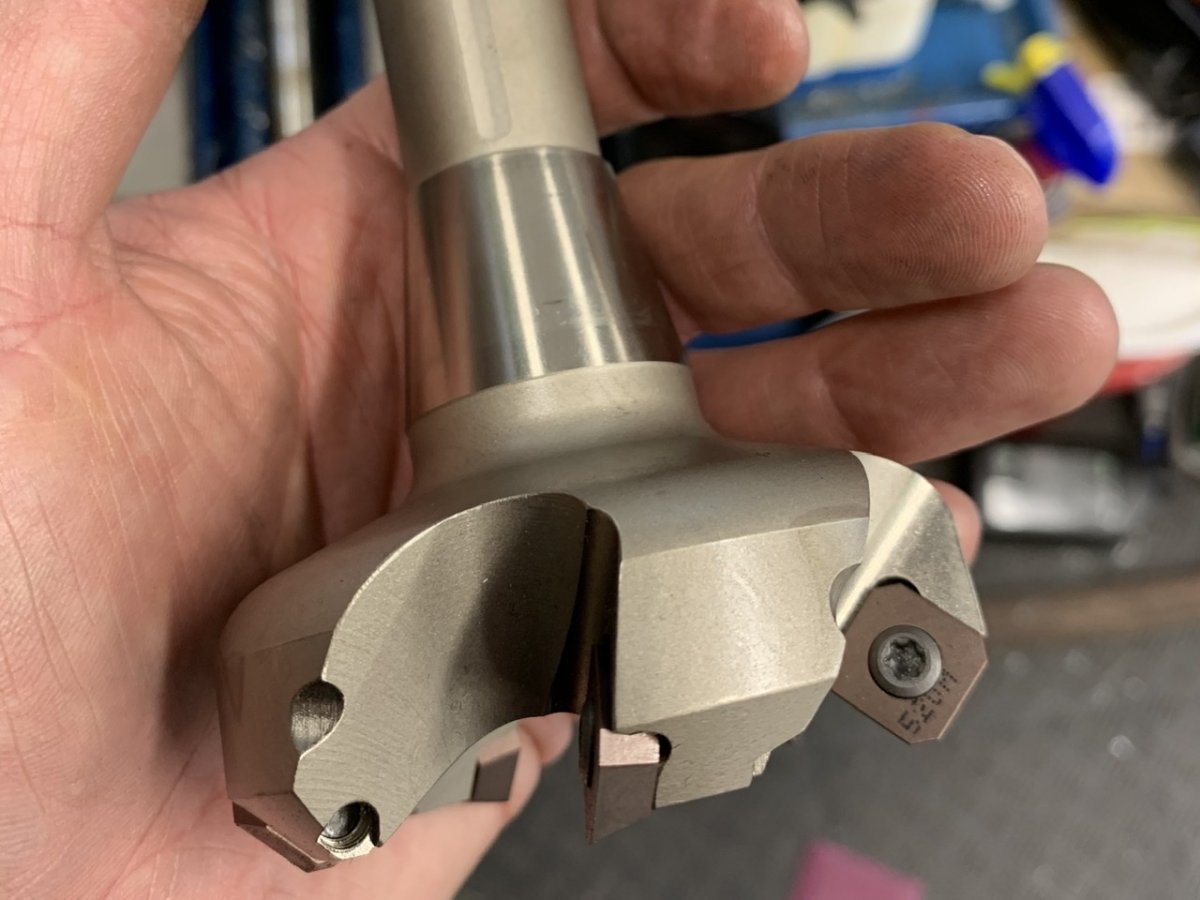

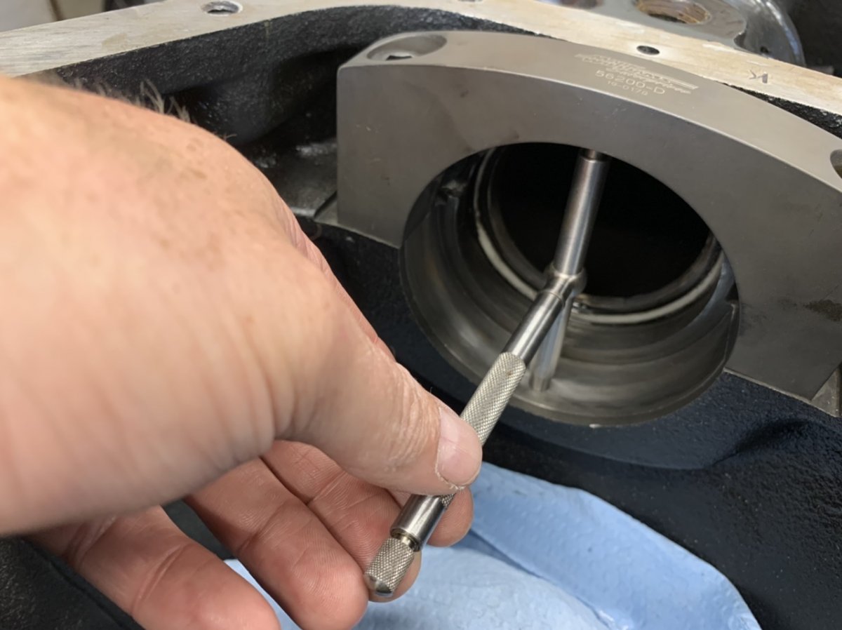

  25. I wanted to revisit this thread so that it may be of some use to anyone who stumbles upon it. After 8 days of waiting, my USPS Priority Mail 3-day package from Mark Williams finally arrived (yay Covid-19). These replacement main caps would definitely be a tricky install without a mill and some decent tooling...I had that stuff and I still managed to screw it up, but I think it’s going to be fine.
    The first step in installing the Mark Williams main caps is to ensure you have adequate threaded depth in the main cap retaining screw holes. It seems that most housings are drilled deep enough, and Mark Williams recommends the use of a bottoming tap (1/2”-13 on the Dana 60) to thread the hole as far as it will go. After tapping, and with the bolts threaded in by hand as far as they’ll go, you need to ensure that you have < 1-7/16” distance from the underside of the bolt head to the cap mating surface.
    At this point you can install the cap, torque to spec (85 lb-ft on the Dana 60), and measure your vertical clearance. I had roughly 0.063” extra material to remove on my caps, and not being super confident in my snap gauge measuring or machining abilities, I decided to remove 0.058” and then recheck my clearance.
    And, now, full of confidence, because repeated measuring agreed that I had removed EXACTLY 0.058”, I chucked up the cap a second time, and took another 0.005”...but somehow I actually took 0.0085”. The spec was +/- 0.002”, and I’m now 0.0015” under the lower limit, but more on that later...
    I did all my milling with a 2-1/2”x45° facemill; I had gone on a tooling buying spree back when I bought my mill, and this was the first time I’d actually used this facemill. I kept my depth of cut at 0.020” or under and my eBay carbide inserts left a beautiful surface finish. I think the reason I went over on my second attempt is because I have always touched off directly on my part, and in an effort to be more precise, I decided I would try touching off on paper. I should have practiced first. I think it’s also possible, maybe, that I didn’t deburr the part carefully enough, and there could have been an extra thou or so hanging me up in between the first and second set of measurements.

    My second cap worked out perfectly. By this point I was becoming very confident with my snap gauges. I measured the clearances on the second cap four times in a row within a ten-thousandth. My mic isn’t even that accurate, so, I was happy with the results. Again, I milled the cap in two steps, touching off on the part instead of on paper this time, and this time it landed exactly on the spec...twice. Then I took another half a thou off on the surface plate just so that the bearing interference would be snug. I bolted everything back together, double checked my backlash (in spec), double checked my pattern (which still looks better than anything I got on my setup bearings), and then I flipped the axle over to take a reading of the rotational resistance.
    My thinking was this; if having an extra 0.0015” of interference was going to deform the bearing race enough to cause an issue, I would be able to “see it” on my dial type inch-pound torque wrench. I had a dead consistent 50 in-lbs of rotational resistance, which is right in spec. Also, I figure that a bearing will wear in couple of thou, so I’m banking on the extra interference being a non-issue. Worst case scenario, I experience accelerated bearing wear, and I have to buy another cap and replace the carrier bearings sooner than I would otherwise need to. In the interest of calling this thing done, I’m going to take that chance. At least there’s not really any chance of it spinning and taking out the expensive parts.
