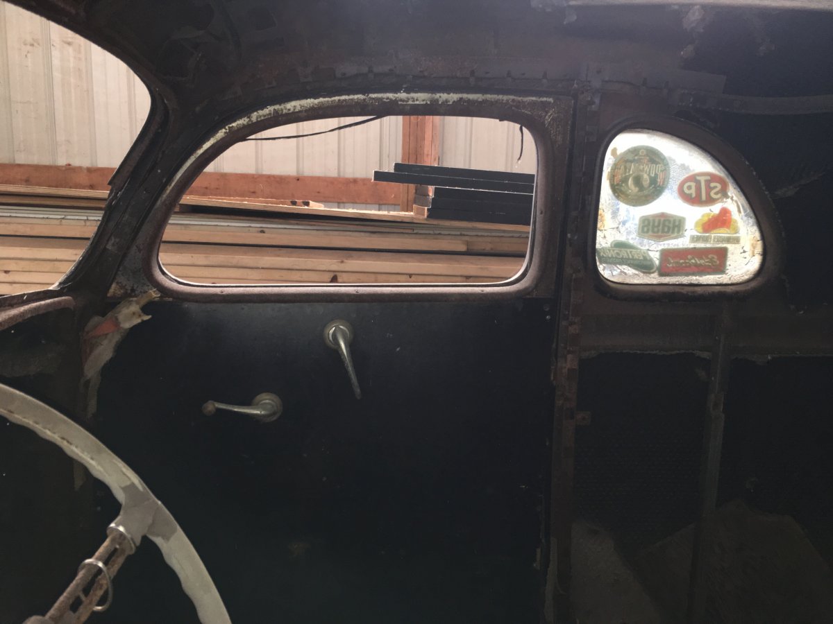

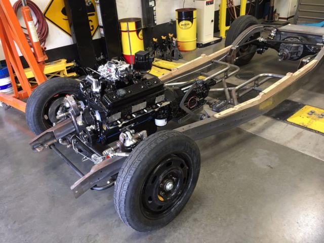

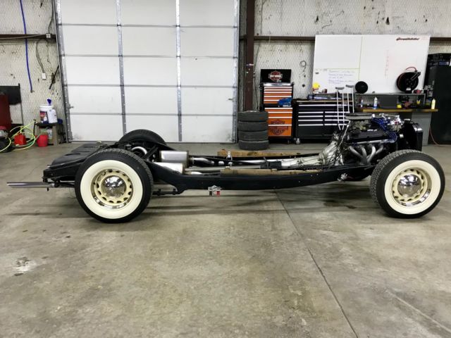

  3. Here’s a couple,
    ‘40 but same frame
    Old one and a new one
    7F9ADC4B-111D-45EA-B0D3-B4AFB16180DE.jpeg D71B8012-1F45-48C8-B555-C8F25BA83E8F.jpeg D181C27B-A4FC-449F-AD4F-68C01492C2E1.jpeg 23C955E9-CA74-49C3-B0A1-2F0EAC2AAEED.jpeg

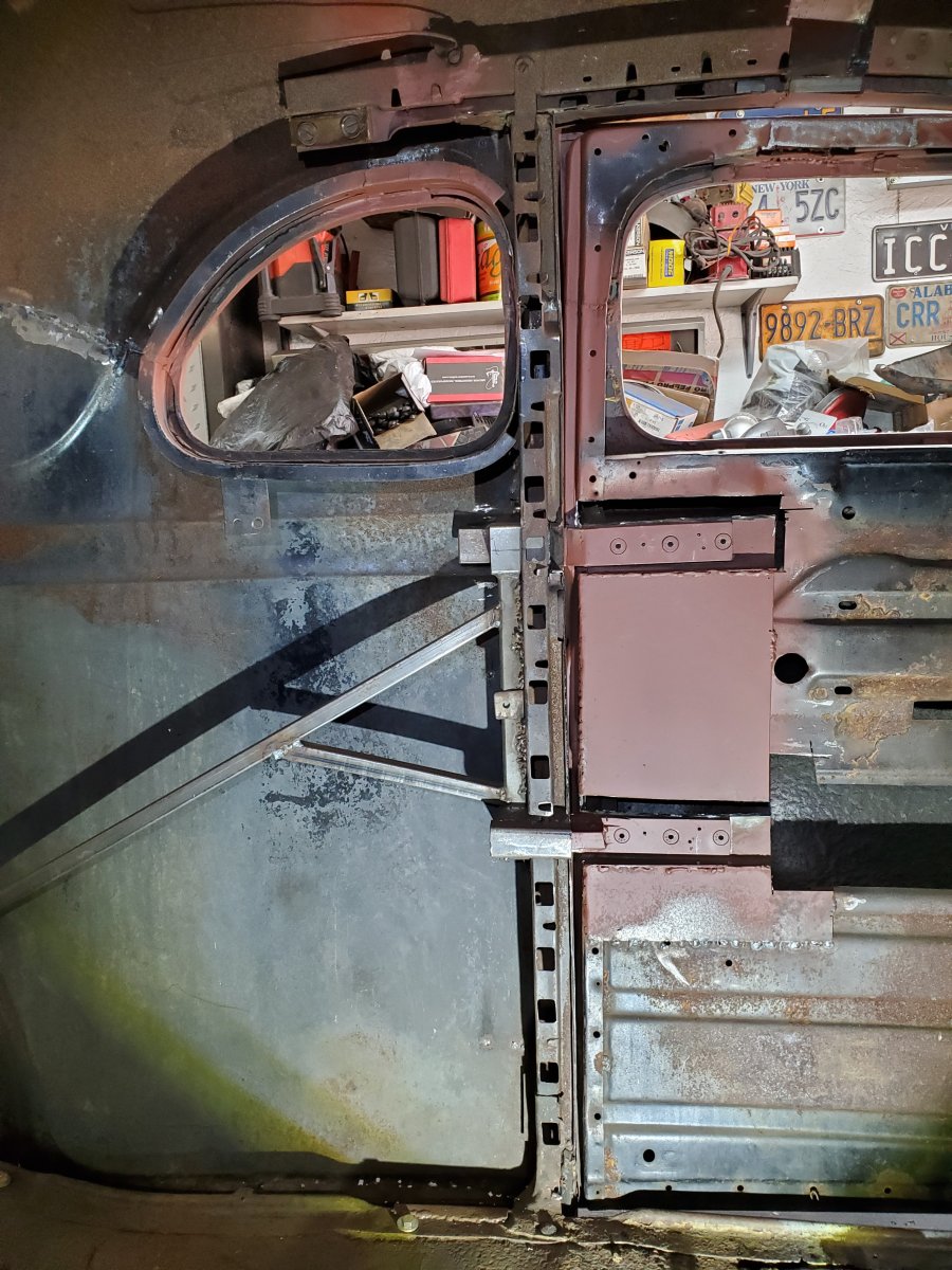

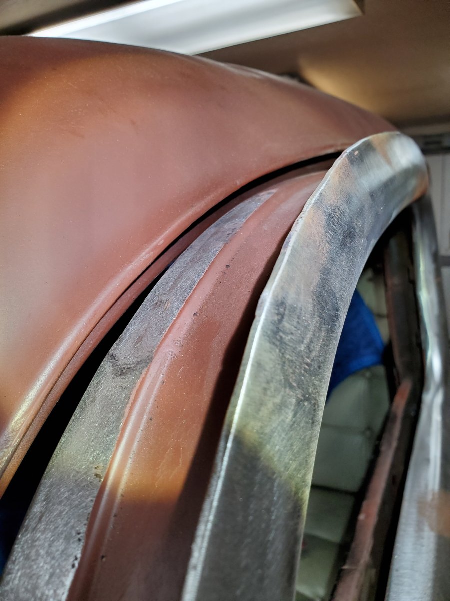

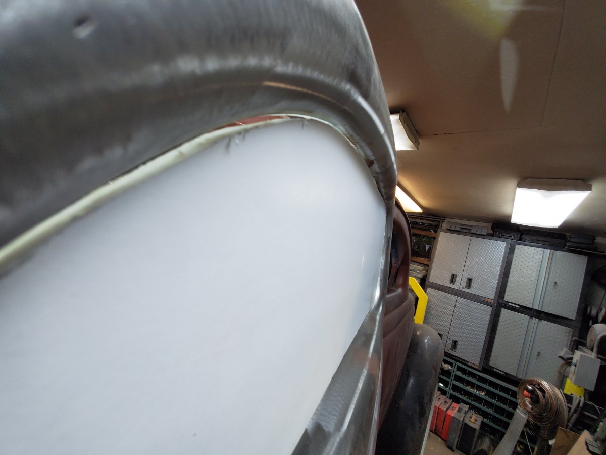

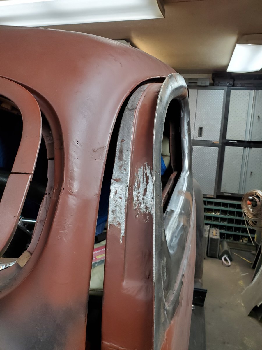

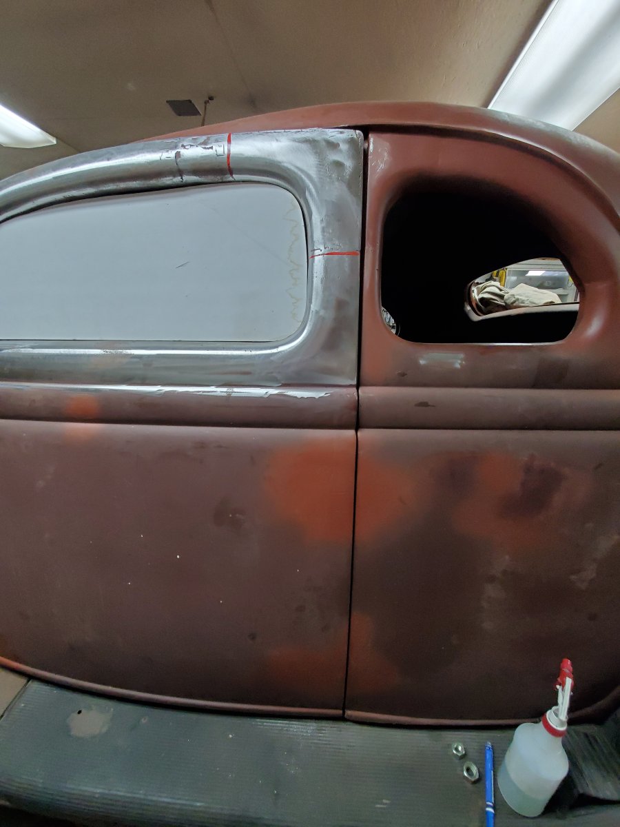

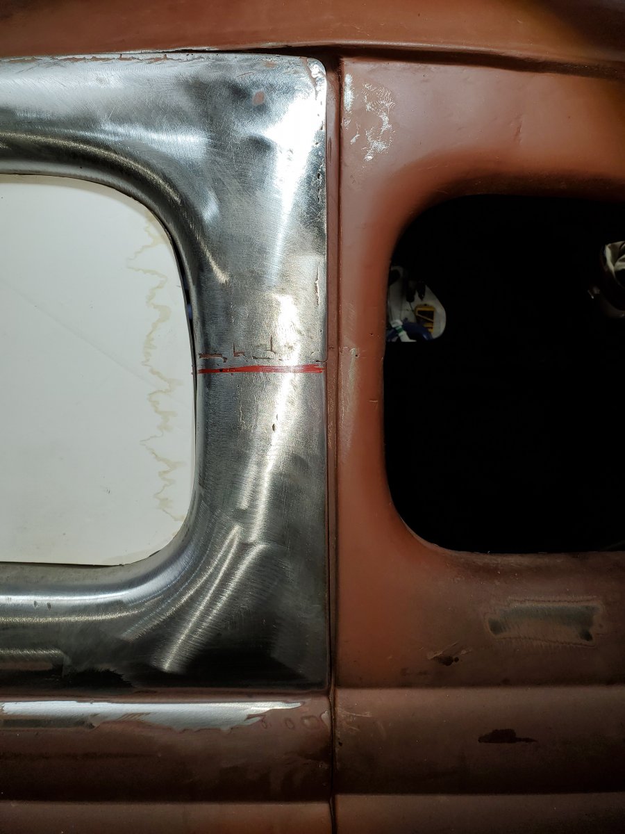

    Today I took the doors off the hinges to see how the door fit the hole untethered. I can get the door in. I get an uneven gap at the B-pillar , wide at the top tapering down to none at the bottom. On the hinges the door hits the roof on the front curve.
    At this point I humbly ask for advice on where to place the shims. Shiming the first two mounts dont make it. I know there's a science to this but I really need fast help in tweaking the body back to how it was. I really dont want to give in to my frustration and start cutting things I didn't have to. If I decide to keep this car I'll look into locating another frame or possible buy a new one. For the now I need to overcome this challenge so I move on to the floors, cowl, quarter and tail panel repairs.

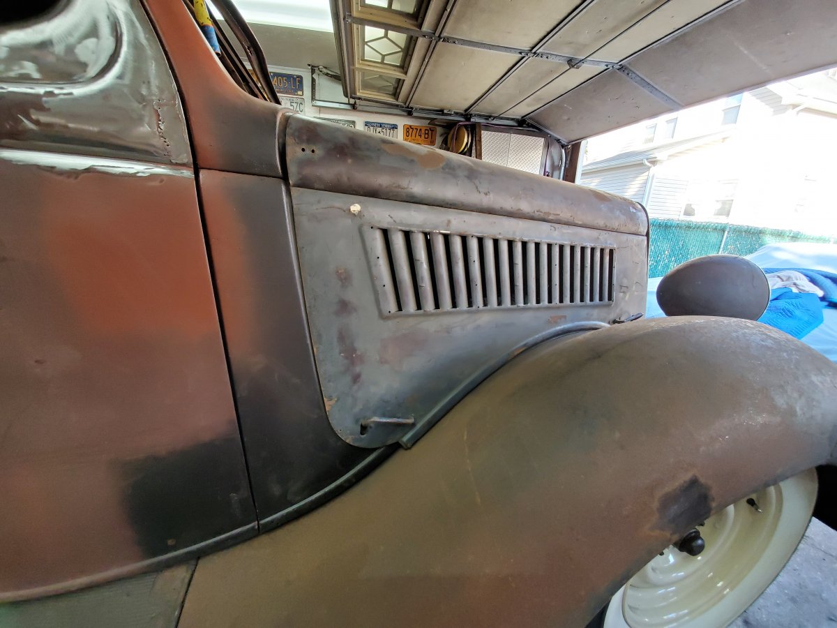

  8. Pictures?? Of this ^^
    If you look at this pic from the other day.
    It’s not a good fit.
    Wide at the top and tight in the curve but we can’t see all of it.

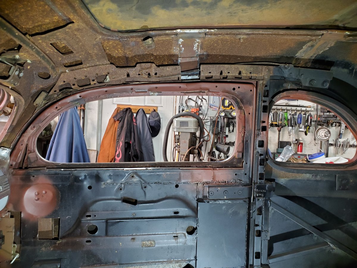

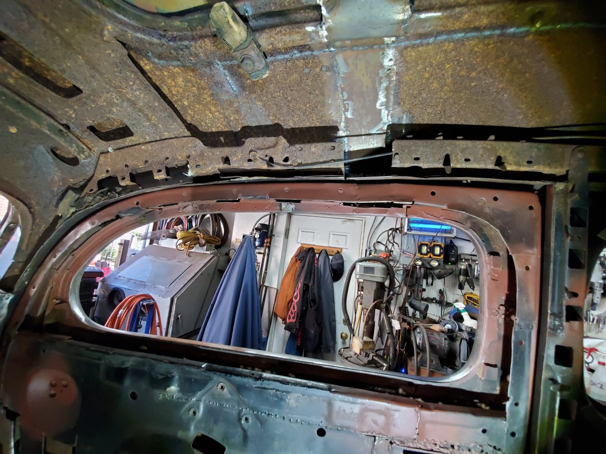

  10. You’re B pillar looks sorta ok but it’s off a bit.
    But the door top needs to come back,,,,
    Looks like they pushed it forward because the roof started curving to fast and too early cause that B pillar is off a little bit.
    Here’s my stock 35,
    You should have the same gaps before and after a chop.
    32SEDAN, 1-SHOT and tb33anda3rd like this.

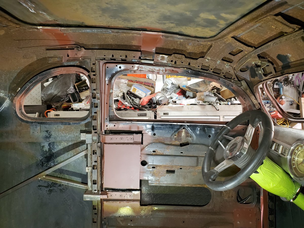

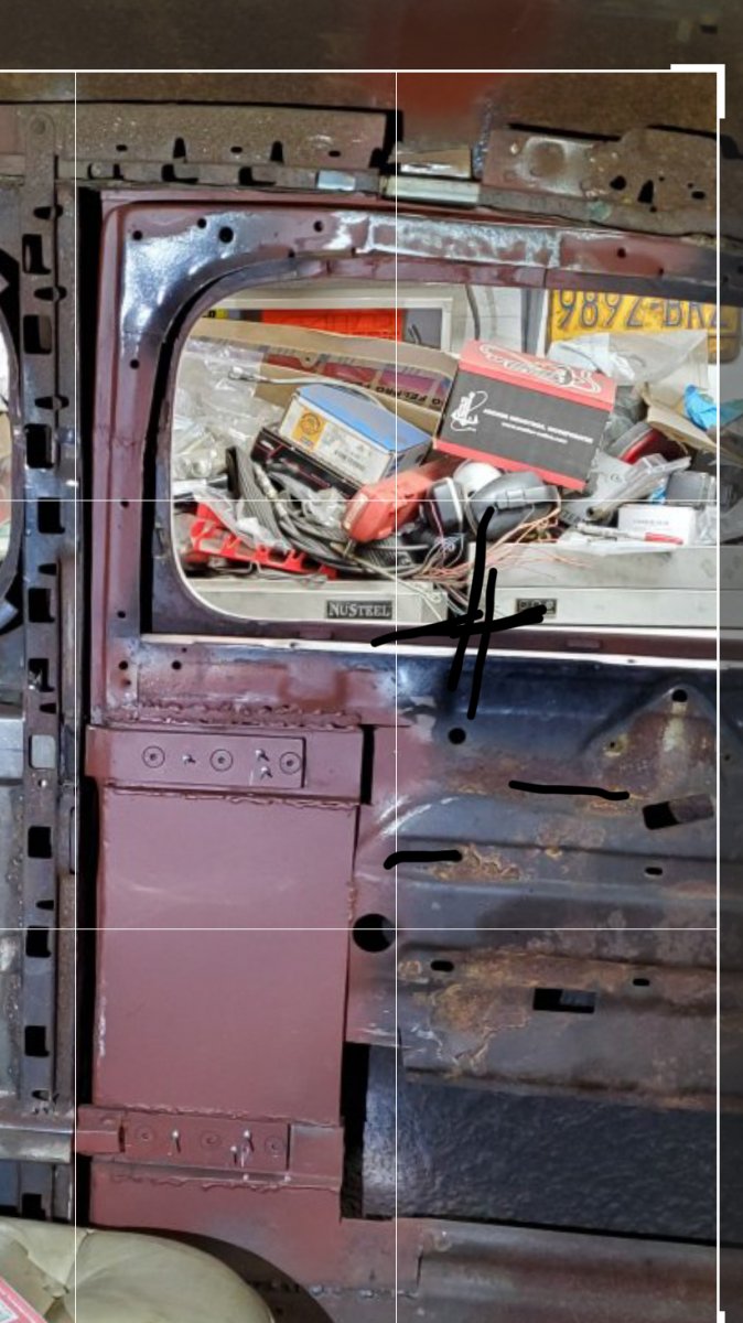

  11. Do it Over
    Joined: Dec 25, 2017
    Posts: 478
    Do it Over
    from NYC, NY

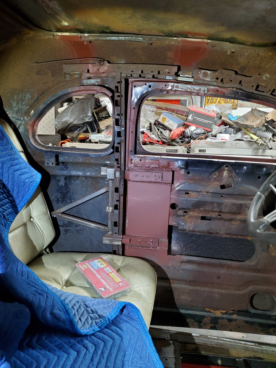

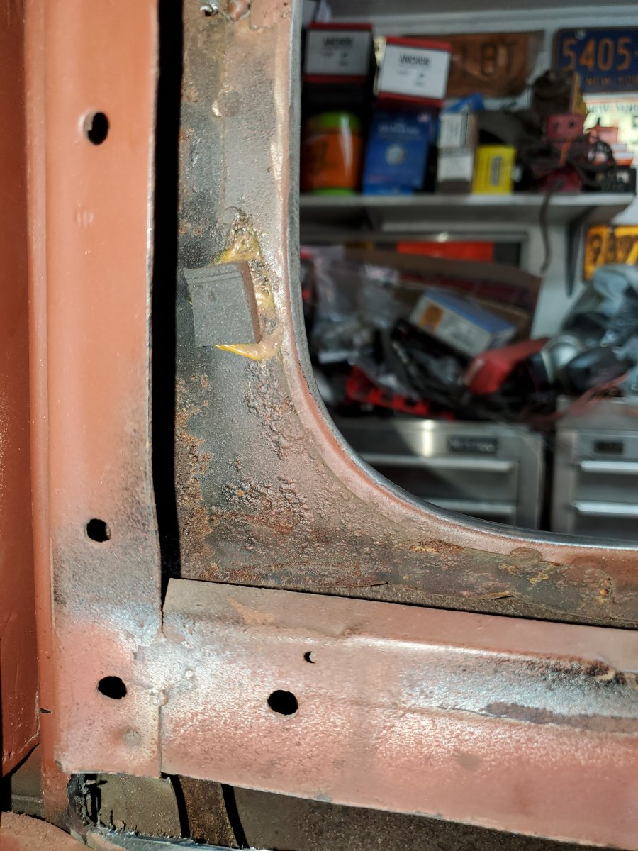

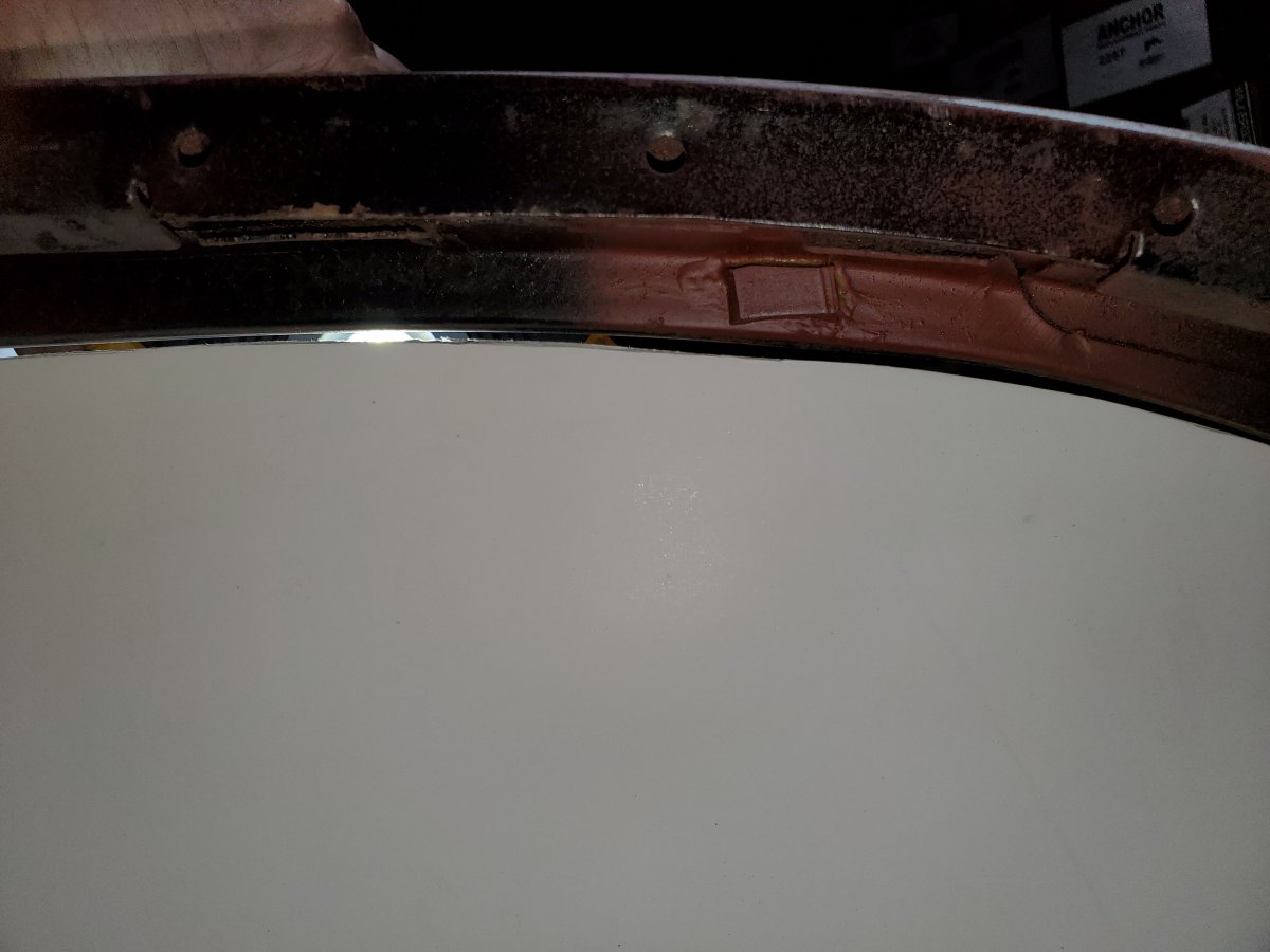

    Some better pics from inside

  13. Do you have a pic of the passenger side inside?
    What shown of the door looks pretty good but most of that is below the chop

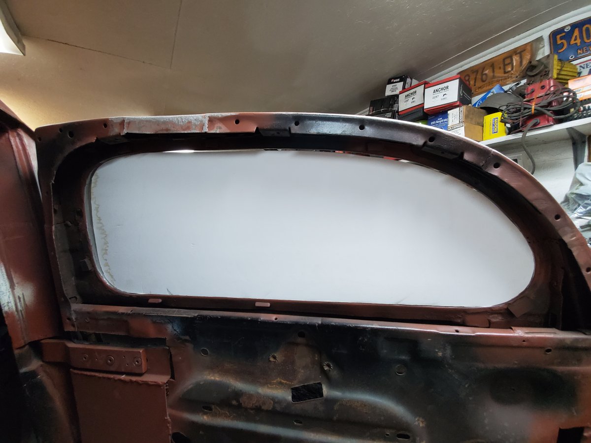

    Here ya go
  15. 043E087C-FDF4-463C-B0A0-2D94936506BF.jpeg 7CCBC663-F2B8-4DF9-9E9E-3A67C3D13B4B.jpeg
    Ok, you see the obvious differences here?
    It’s like 2 different guys worked on each side or they had one side against the wall and then turned the car to do the other.
    Do it Over likes this.

  20. Do it Over
    Posts: 478
    Do it Over
    from NYC, NY

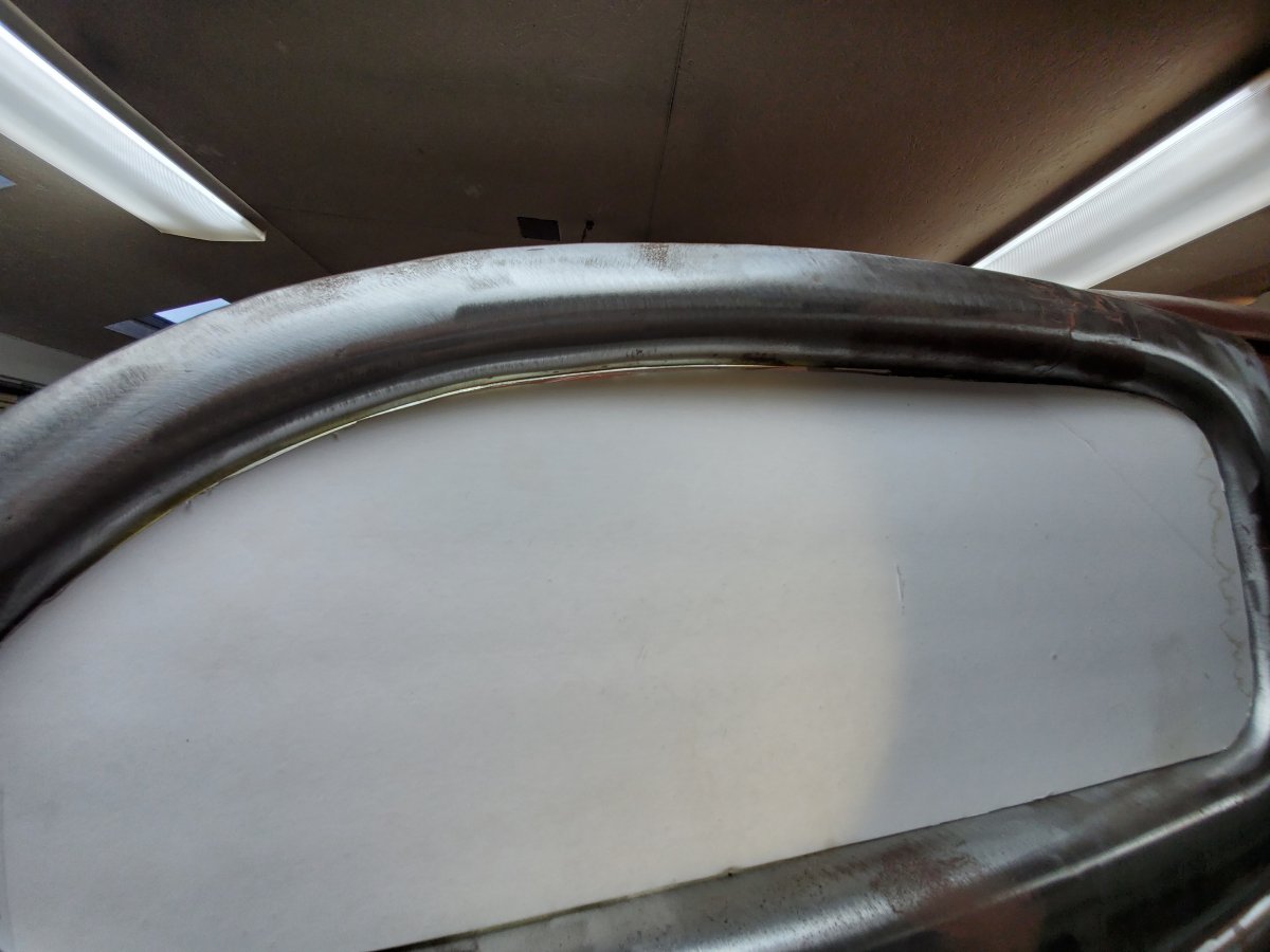

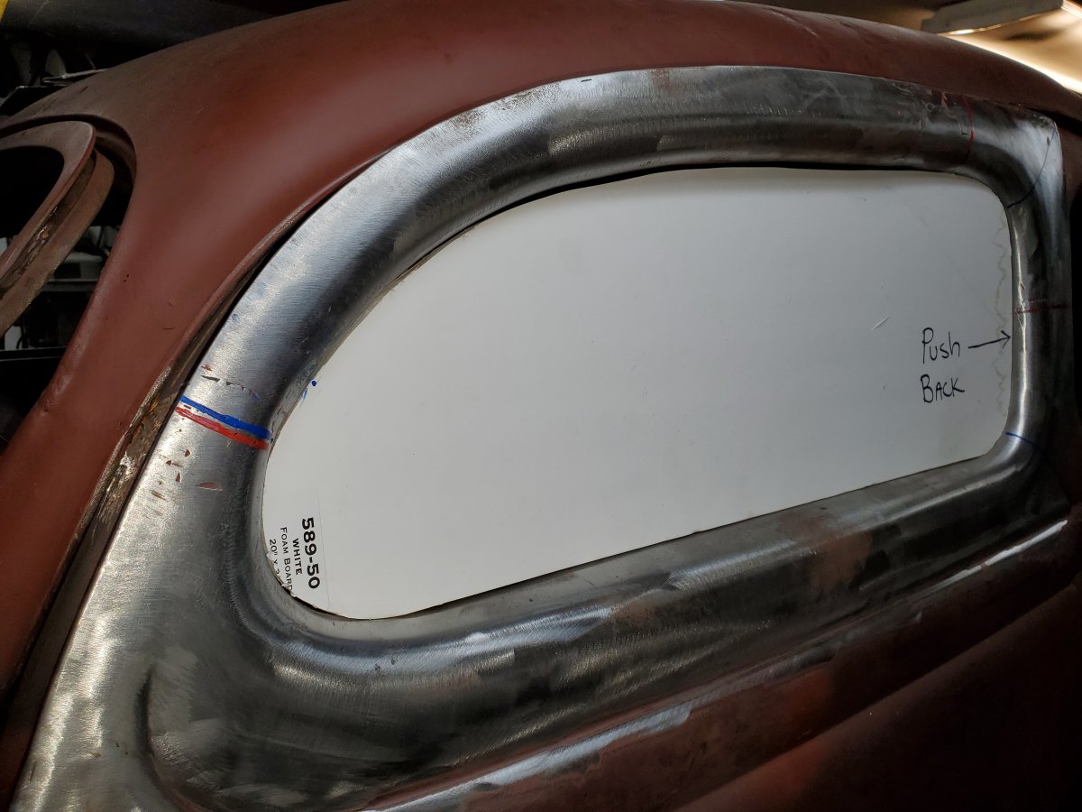

    I made a rought template of the window opening of the good side and wasn't surprised to find the difficult side opening was taller by almost 3/16". My thoughts are that 3/16" wasn't at all noticeable by eye so if I dropped the window frame by 1/4 - 5/16" I dont think it would be that noticeable if at all. Any one who points it out can enjoy a punch in the eye.
    The blue lines are my guess on where I'd cut. I'd push back at the lower B-pillar to align it to the body. Cutting a wedge out of the upper B-pillar should bring the top of the door down to clear the roof. Other cuts as needed to shape. Maybe add some metal.

  23. As far as that door goes,, the easiest thing to correct will be the edge,,, so when you cut it fit the inner structure and the window opening. Come back and add/weld to the edge or subtract/grind it back.
