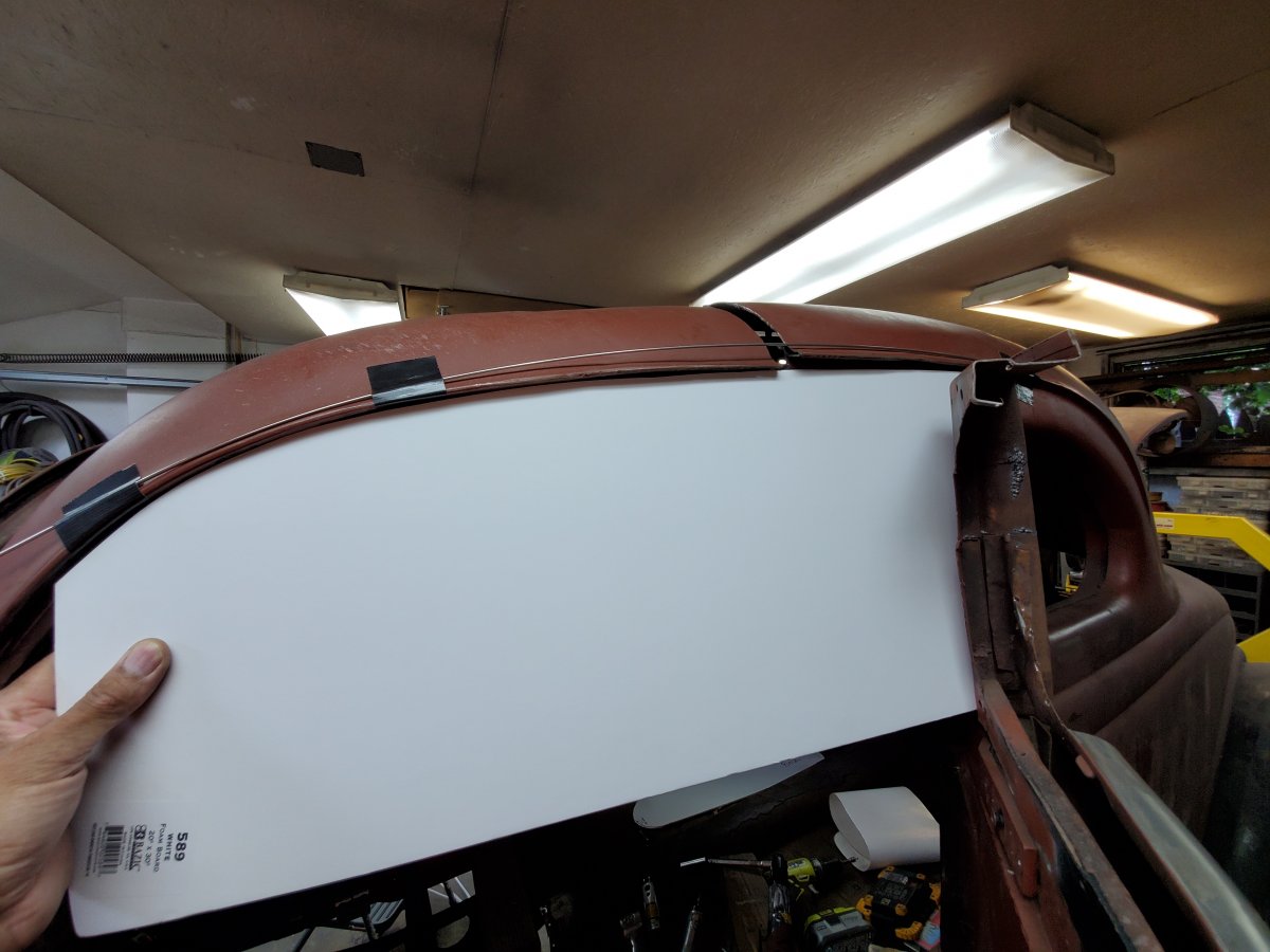

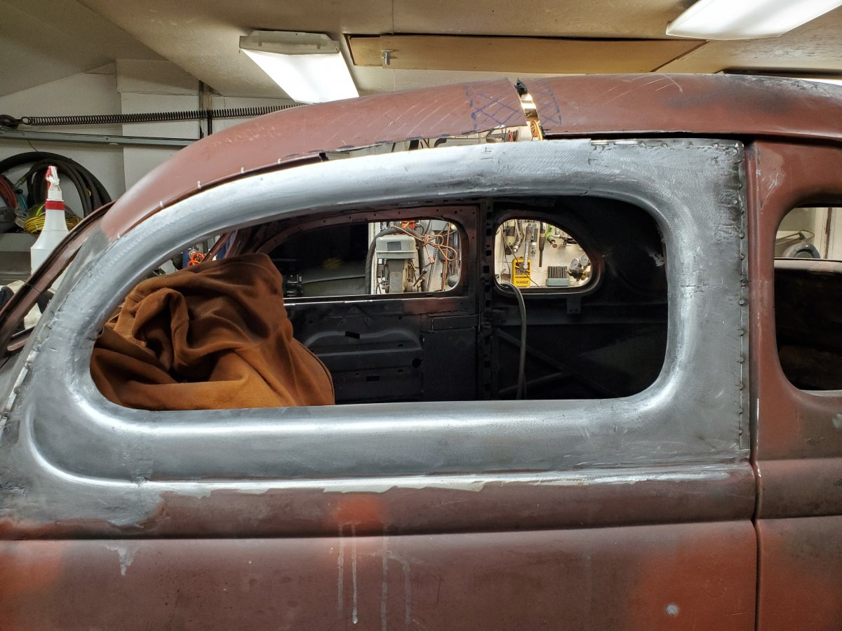

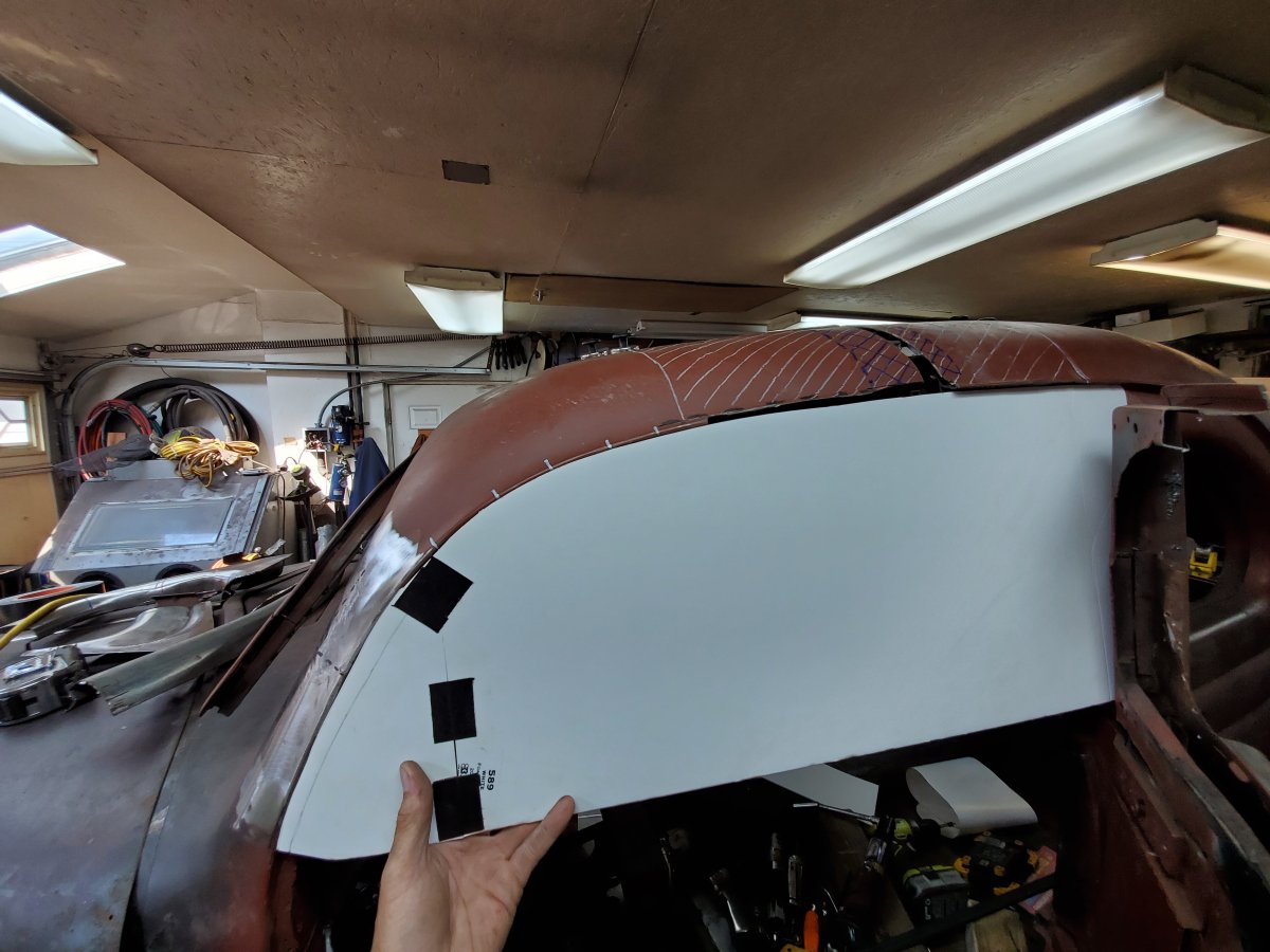

    As I dont want a noticeable mismatch I make a foam board template of the passengers side. This helped me visualize where the metal has to move and how fast. Seems like the front of the roof is what has to move. No need to push the cowl forward as that's where it went when as soon as it was allowed to.

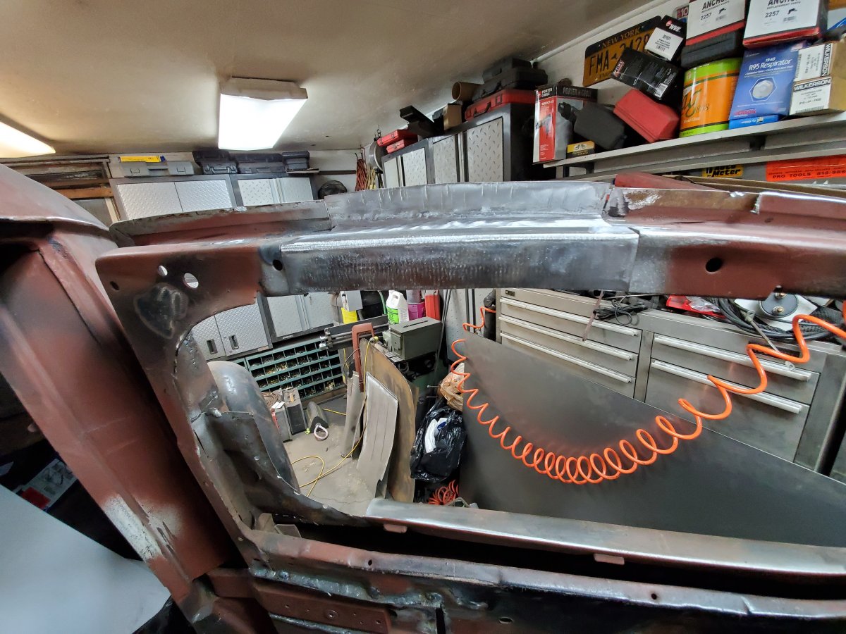

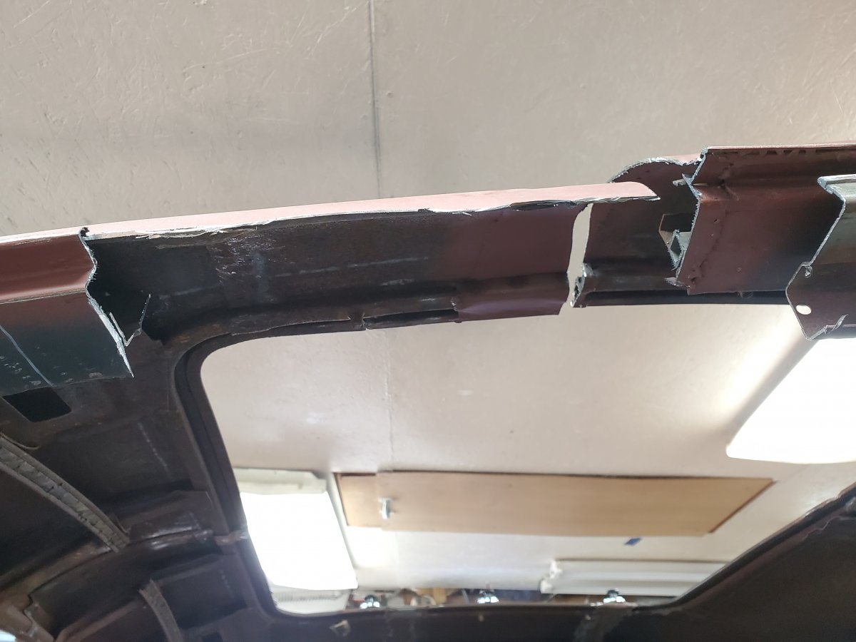

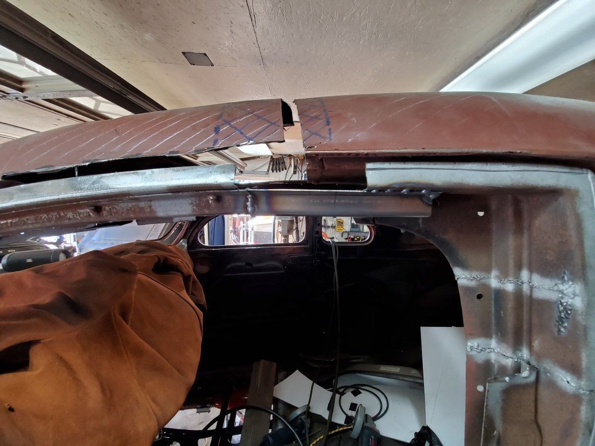

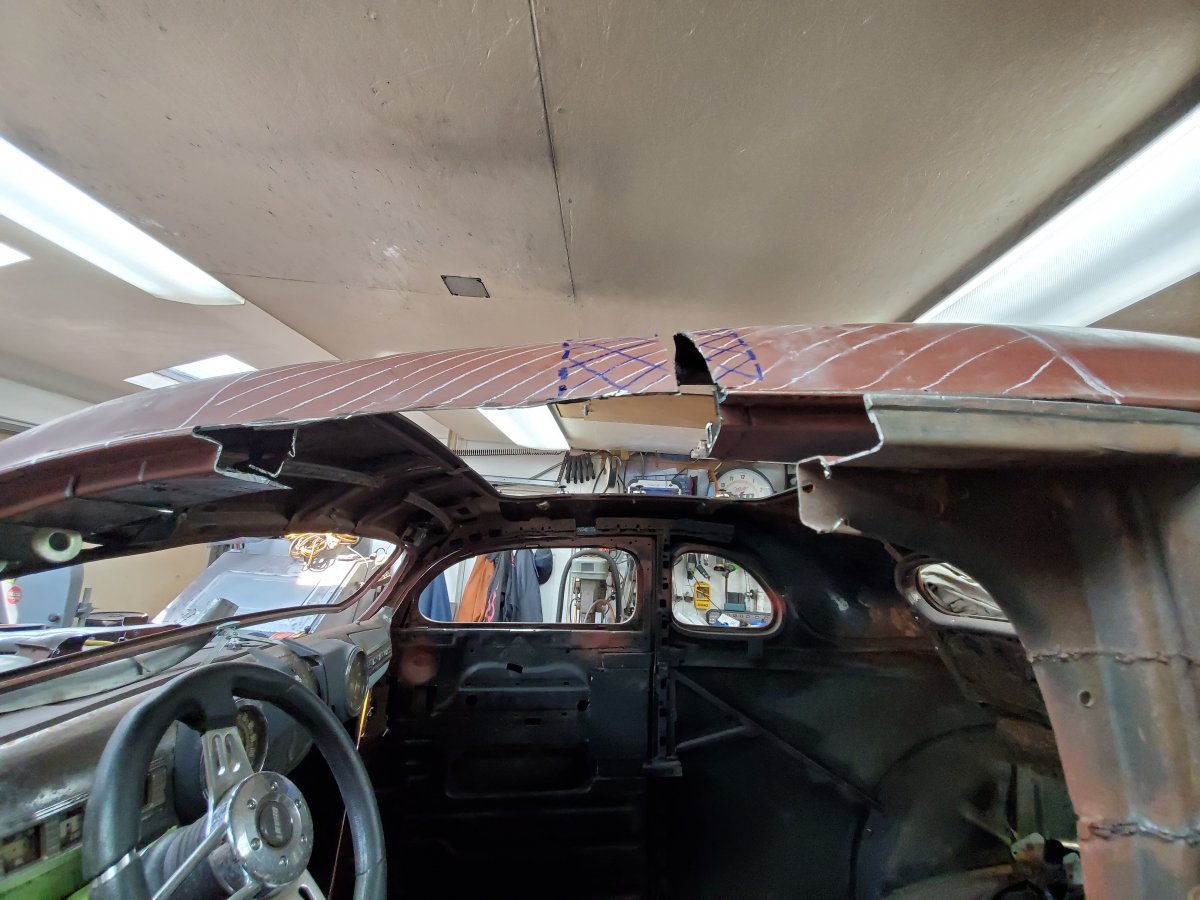

    I think my last idea is the best I think. I would cut the roof skin free at the eyebrow(dashed line) and let the metal go where it wants to go. If it moves up even to the rear section I'll weld in a filler panel in the roof the fabricate the door jamb to fit the roof. I can reshape the jamb by cutting some relief cuts in the bottom then fabricate new metal to fill the gaps. Does anyone have a pic of the cross section of the roof framing/upper door jamb? I'd like to study it to figure out how best to make the bends. I'll practice with paper untill my back is better deciding which bends I can do in the brake and which ones I can tip in the bead roller.

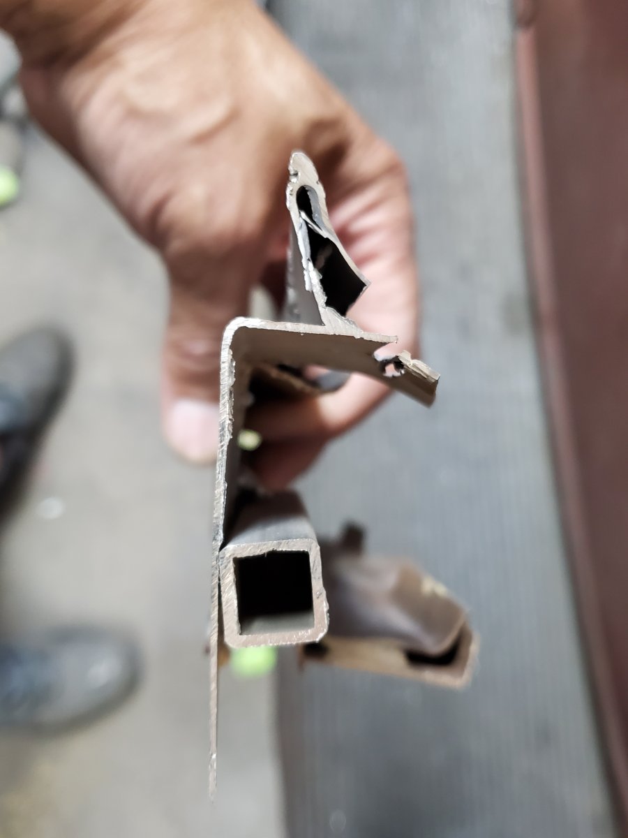

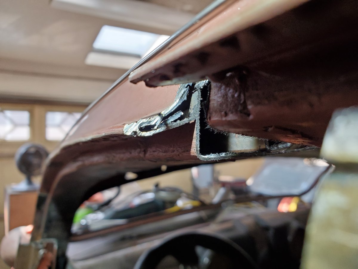

    Looking back at some previous posts and man is that upper door jamb supremely messed up and beyond salvaging.

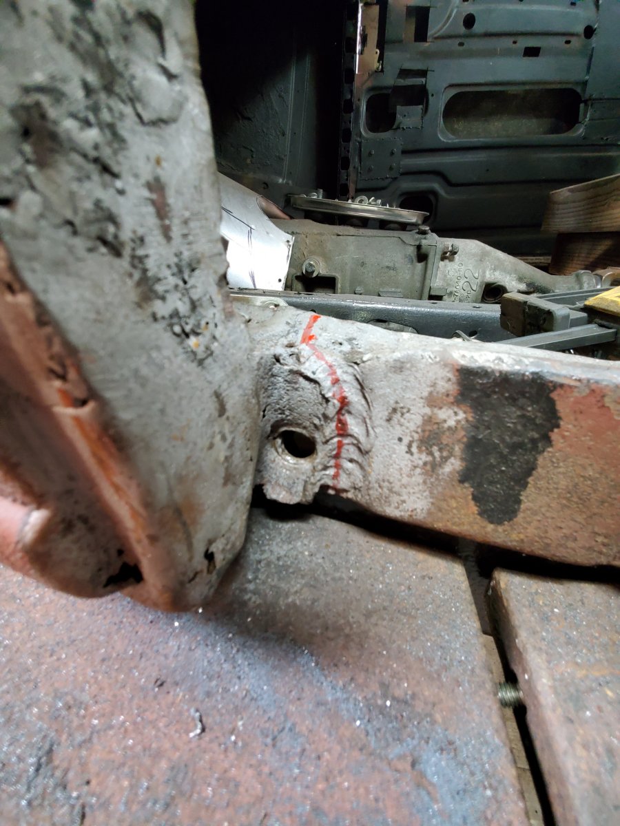

    Noticed this old repair and the bottom of the A-pillar. Thinking of taking out 1/4" out of the rocker to reduce the door gap. I'll be doing repairs in this area anyway. 20190726_130156.jpg 20190726_130215.jpg 20190726_130210.jpg

    Suppose you make another 'big' cut in the roof, somewhere ahead of the really mullered up area, then see if it gives you a smaller area in which to make corrections. It's possible that some of the original shapes are still within but hard to detect based on the current injury. In case I'm not saying what I'm seeing, if you were to remove from the original insert edge the whole side, fit it to the existing cut you made as close as possible, then have a more simple place to fab and fill in so you end up with what you need. No relief cuts, maybe, less piecing in, perhaps? You're there, I'm not, and my hope is that you see in 3D what I might be seeing on a 'puter screen. I'm all about less fab work when you can "get there from here" easier. I'm kinda lazy like that.

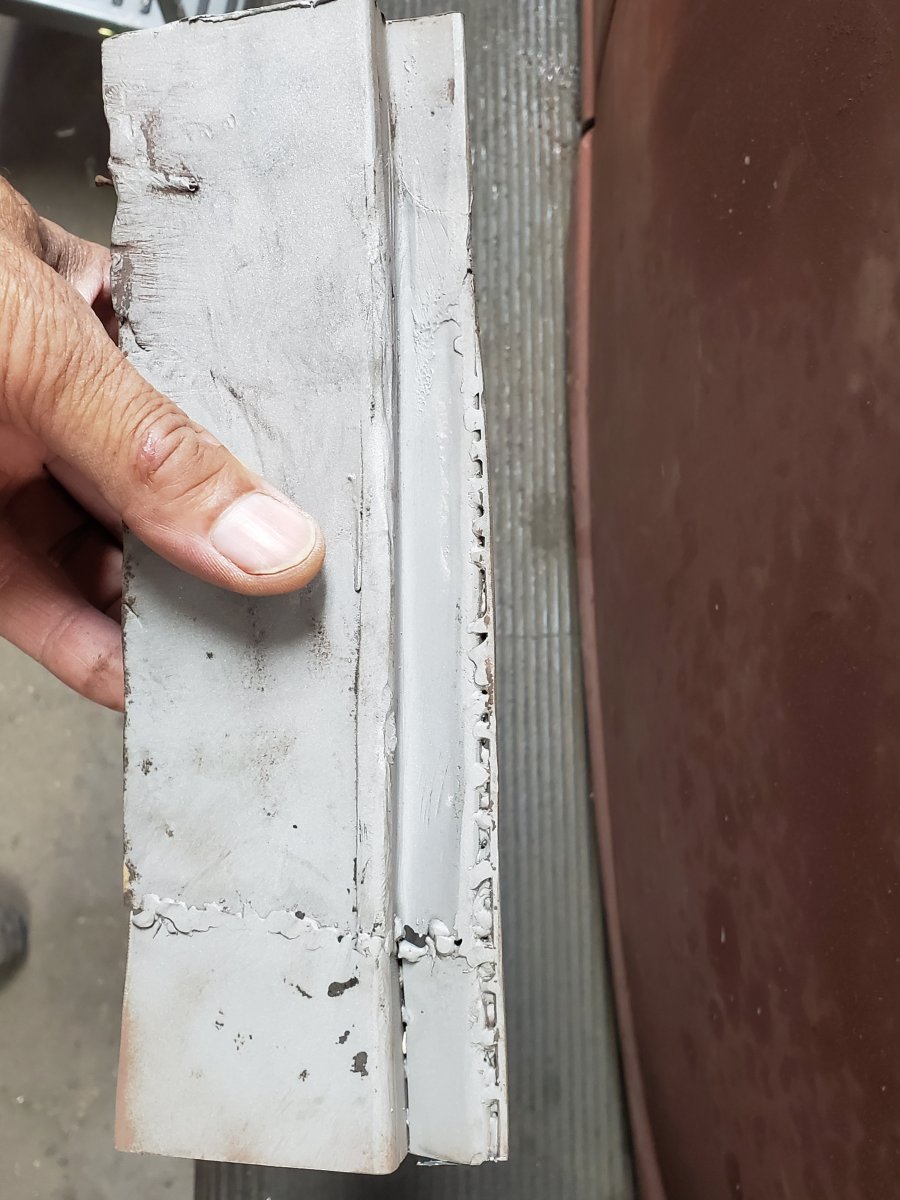

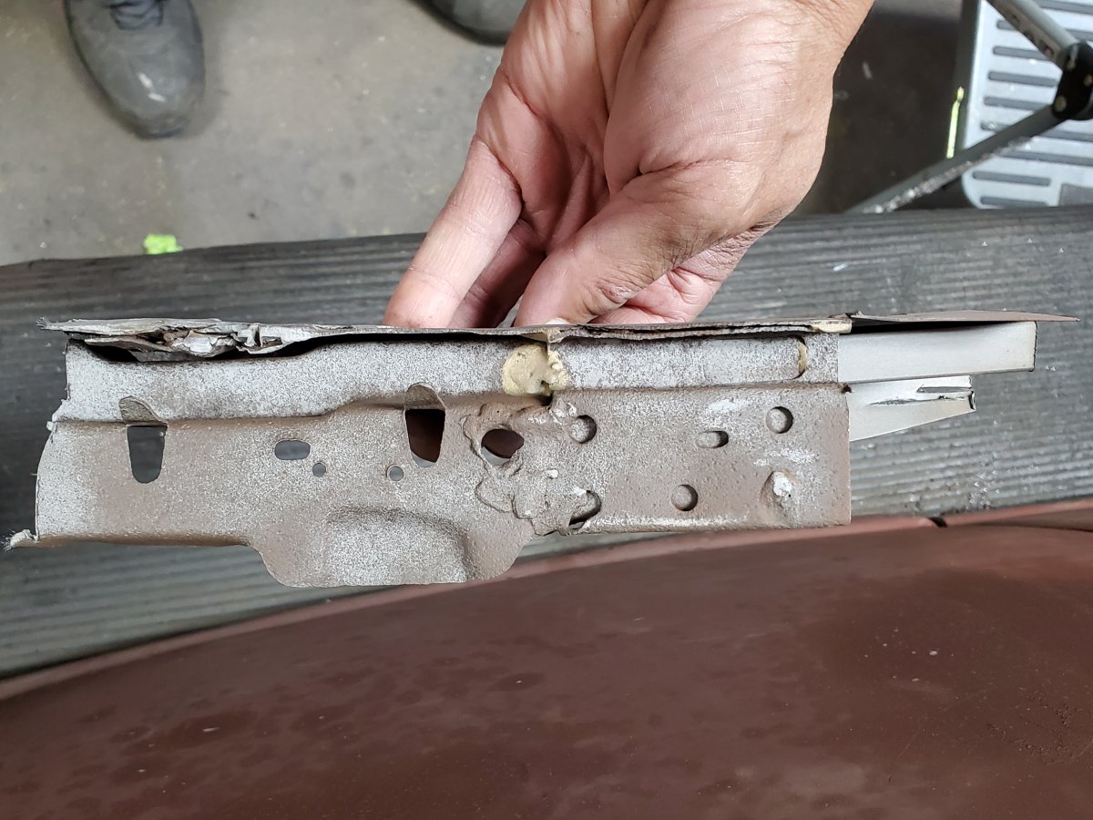

    Theres several inches of buggered metal here. A horrible filler patch and some mutilated jamb. I'd like to replace this horror as I'll be reminded of its presence everytime I get in and out. Maybe I can find a donor roof section to make it easier. The roof skin at the eyebrow is also ruined. Bad welds and wavy as my short hairs.

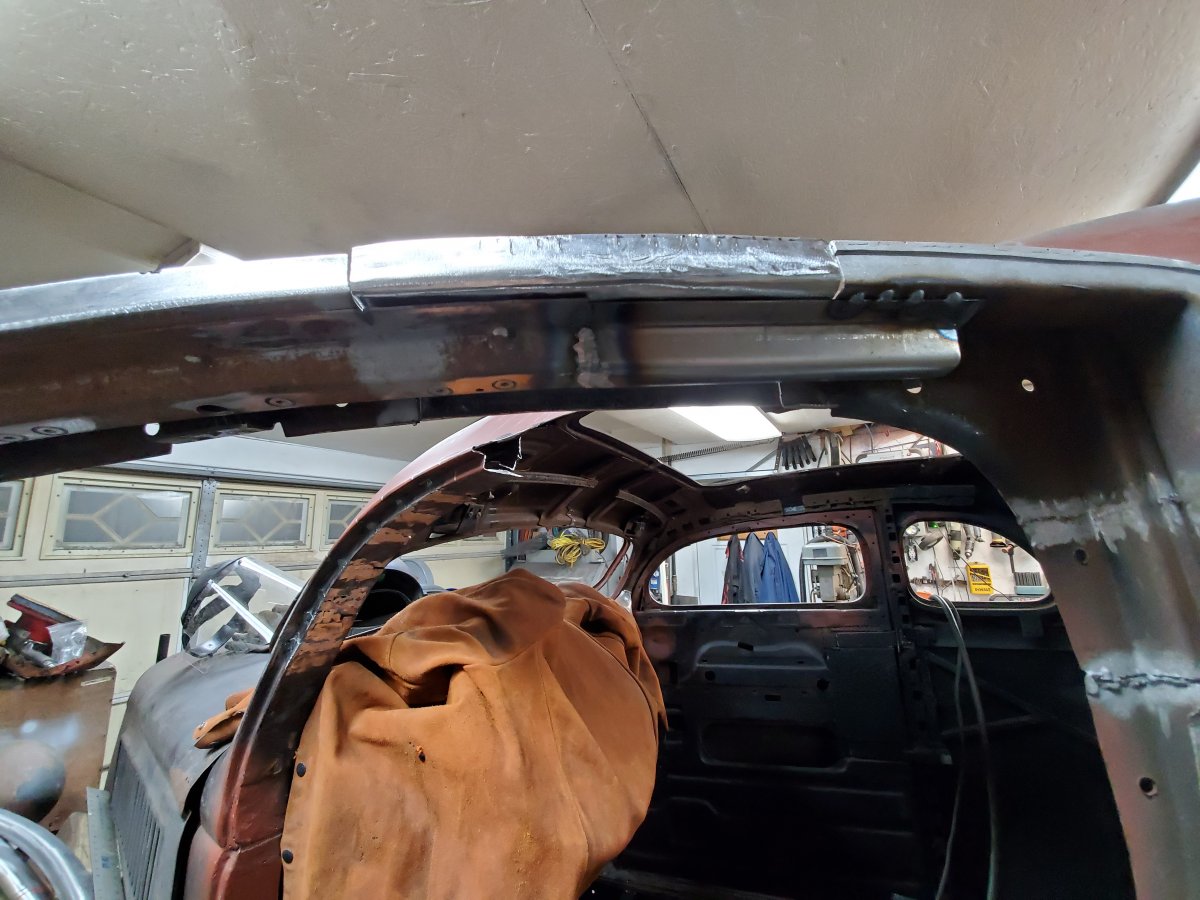

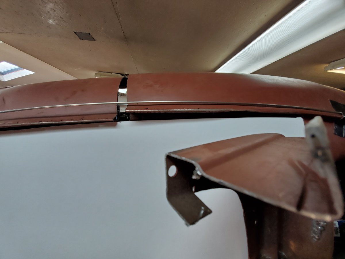

    Had to do something other than watch TV. I thought the skin was under stress and cutting it free of the eyebrow would show this but it didn't so that means it isn't. Since nothing moved so it's not as complicated as I thought. I now believe it's as simple as a crooked chop. Next I'll make a relief cut at the back of the windshield to lift the roof up slightly. I removed a portion of the roof frame to analyze. I'm sure I can fabricate what I need. I think it was the FoMoCo Kid that rebuilt his roof frame piece by piece. It wont be as nice but it'll be strong 20190727_171648.jpg 20190727_171717.jpg 20190727_171745.jpg 20190727_171728.jpg 20190727_171859.jpg

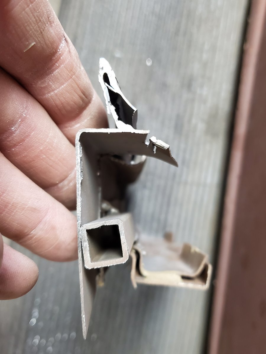

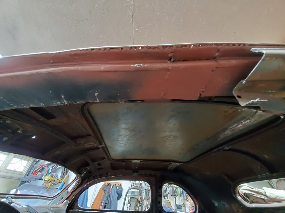

    Here's the roof frame for anyone who is curious as to its construction. This section has had too much carnage imposed on it to be left in place. The other side only requires a couple inches replaced. I'll pick it apart. Will have make it a few more pieces and weld them together but the end result will be the same. Also gonna try to make a whole new roof skin for this side to i can have full access for welding. If not I'll patch the original. 20190727_173633.jpg 20190727_173615.jpg 20190727_173547.jpg 20190727_173528.jpg 20190727_173519.jpg 20190727_173511.jpg 20190727_173504.jpg 20190727_173455.jpg 20190727_173633.jpg 20190727_173615.jpg 20190727_173547.jpg 20190727_173528.jpg 20190727_173519.jpg 20190727_173511.jpg 20190727_173504.jpg 20190727_173455.jpg

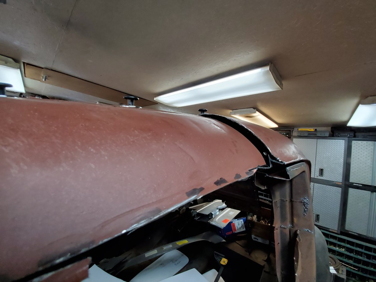

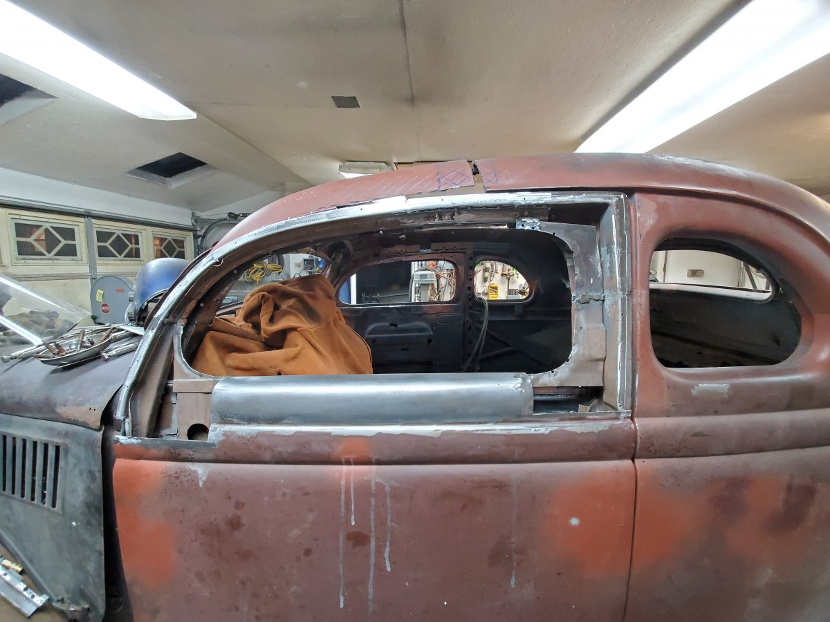

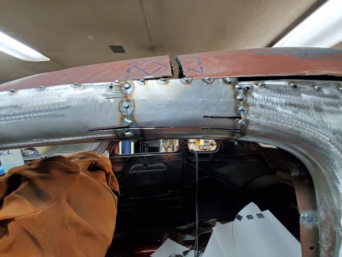

    Feeling better today. I can actually pick up something off the floor without my balls feeling like their in a vise. Made my relief cuts. Lifted up the roof and used some washers as spacers to hold the shape. Seems pretty close now. My goal is to fabricate the white shaded area in the english wheel. For the edge at the eyebrow I'll use a rounded die in the bead roller with a soft lower wheel to get the tight radius. Some 3/16" rod welded to the edge should give me a smooth straight round line . Now to locate some 18ga cold rolled sheet. My local shops dont carry 18ga cold.

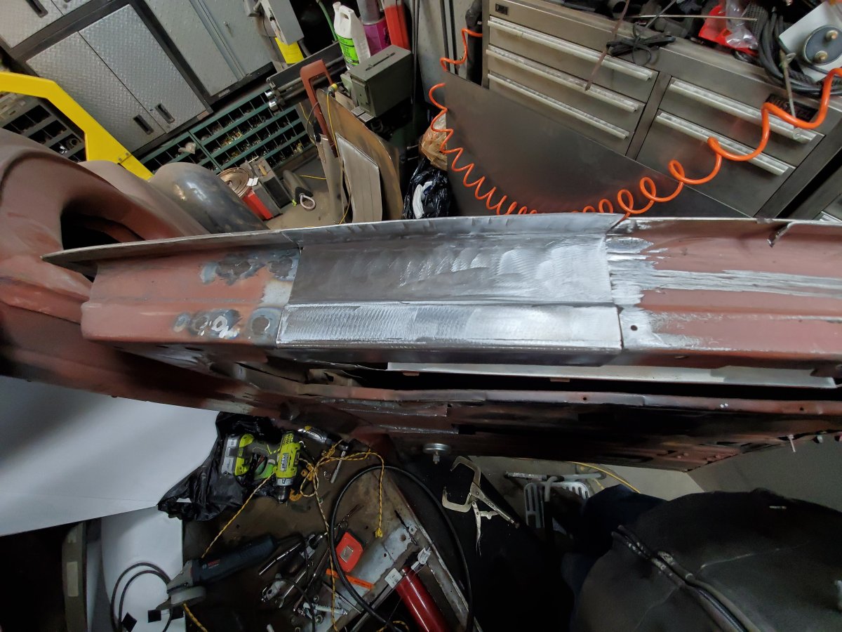

    My back is better so I put in a few minutes today. Working more on my 49 Panhead than the 5W. I jacked up the roof and welded up my relief cuts. I filled the relief cuts with 1/8 & 3/16" rod and bar. Came out pretty even I think. Step by step. 20190817_184125.jpg 20190817_184106.jpg

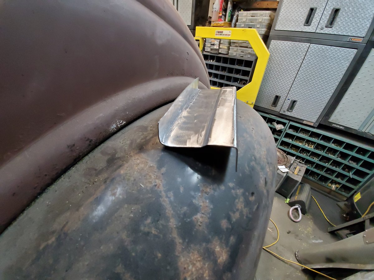

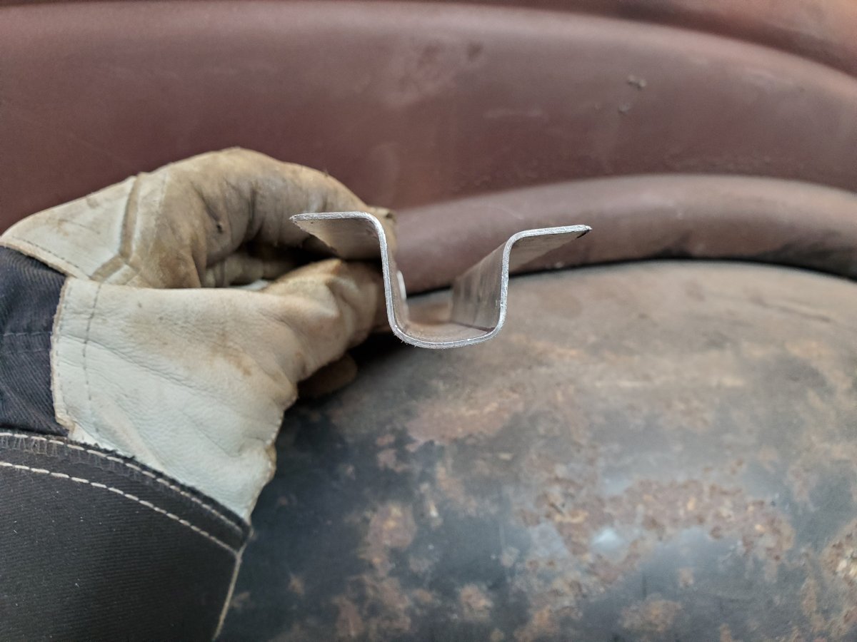

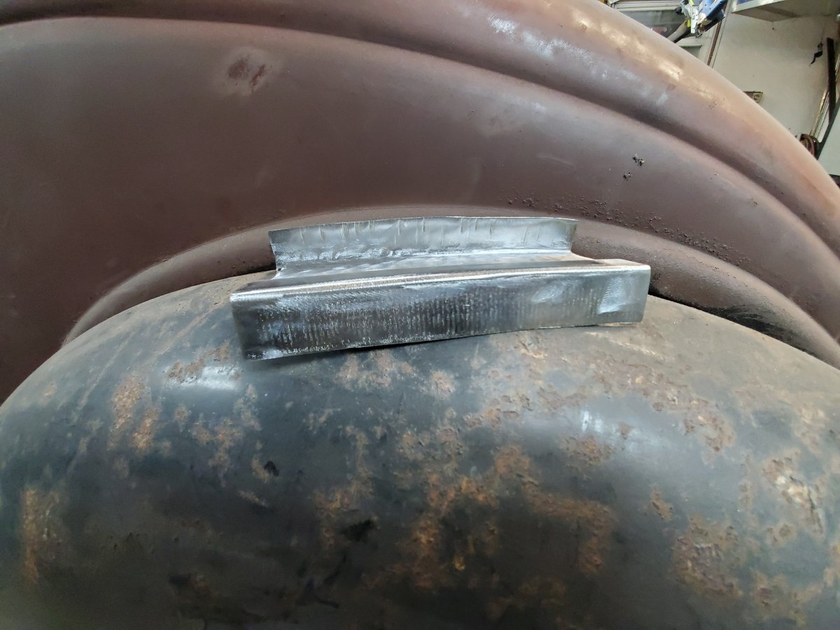

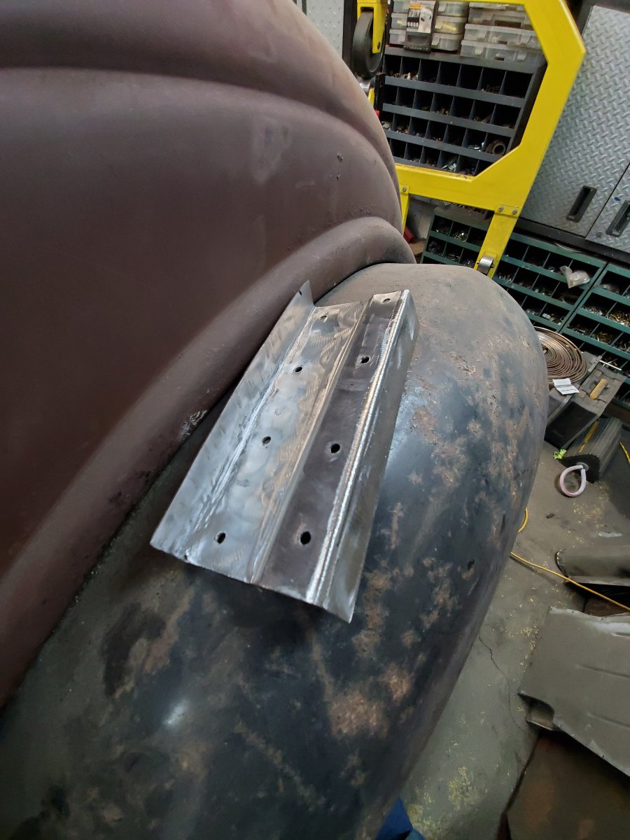

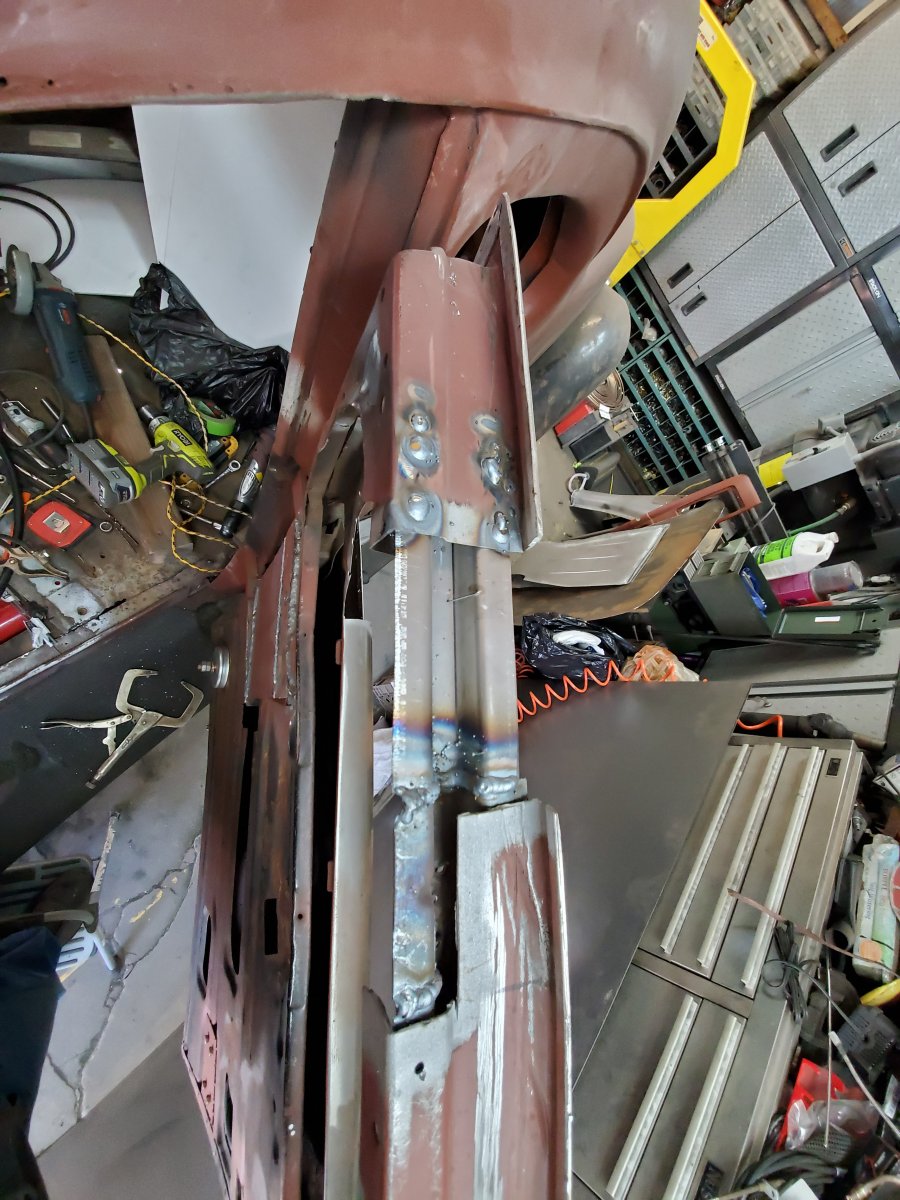

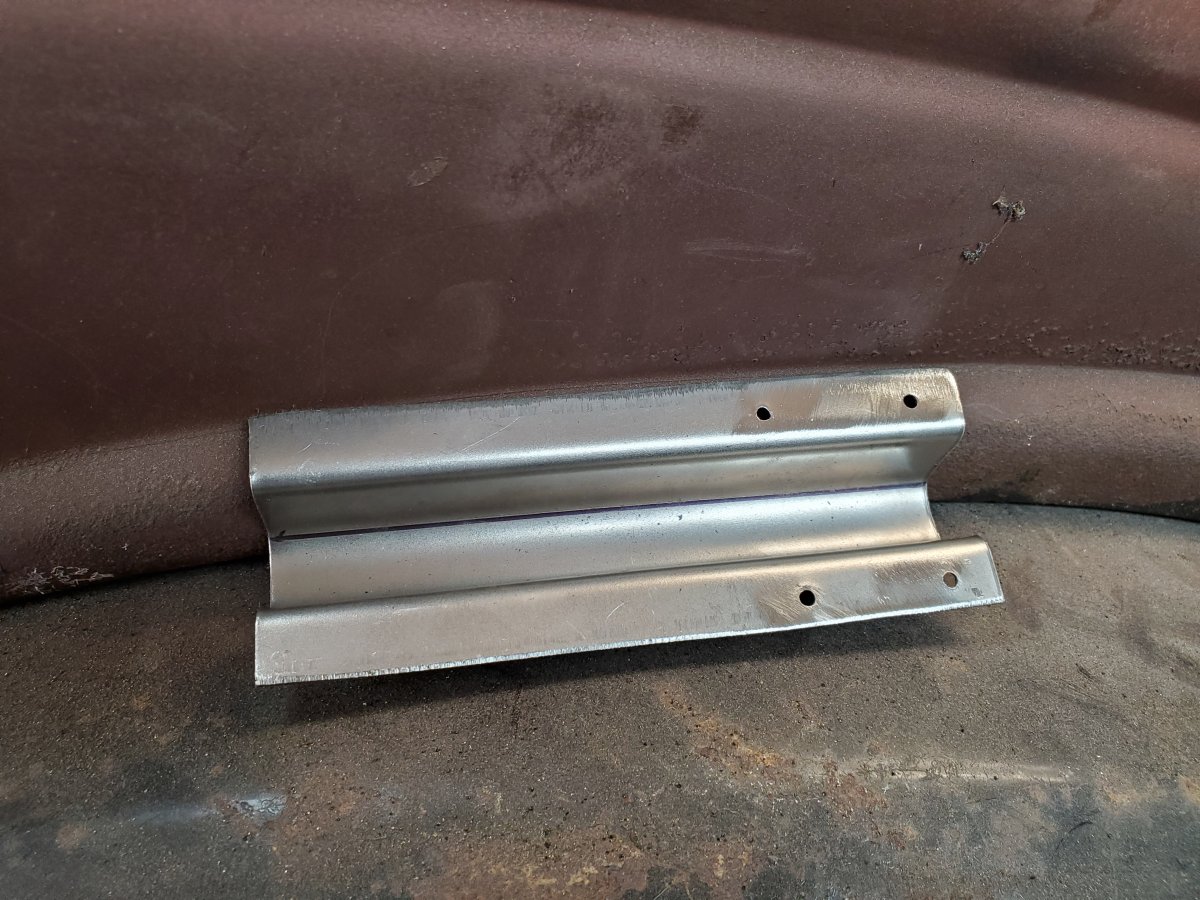

    Back at it finally. Started framing out the door after going through several complete car builds here on the HAMB. I realized that I'll never get improve if I dont try so I stopped psych'ing myself out and started bending test strips. I used one of those vise press brakes to make the inside door brace. Used the bead roller with flanging dies to make the step in the top of the door then the tipping die to bend up the outter edge. Had to use the tipping die as the bend isn't straight. All welded in and started fitting the outter skin. One big and one small patch left. Only a couple hours work but I've been putting it off for weeks because I doubted my skills. Not that my skills are anything to brag about but I'm learning :) . 20191019_212042.jpg 20191019_140239.jpg 20191019_195232.jpg 20191019_140307.jpg 20191019_143119.jpg 20191019_143131.jpg 20191019_143138.jpg 20191019_194017.jpg 20191019_194058.jpg 20191019_194103.jpg
