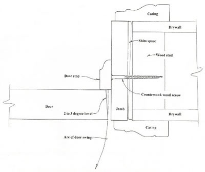

  23. Doors rubbing ,,,,
    Have you ever done much interior carpentry of hanging doors? In order for them to work correctly the hinge side is Square and the other edge is beveled with the leading edge being short. There’s a picture of the interior door and These cars are the same way.
    So if you were to change an interior door around and hinge it the opposite way it will never work. The hinges on the bevel will pull the door into the jamb and the square edge will not clear in the swing.
    On your doors,,, if you’re having a rubbing issue because of the hinge reversal just A little slice down the inside edge of the door and close up that kerf may be all you need. You’ll be putting that bevel onto the square edge.

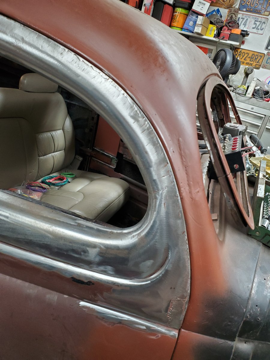

  26. Do it Over
    Joined: Dec 25, 2017
    Posts: 478
    Do it Over
    from NYC, NY
    I'm not worried by the dragging doors. My plan is to lower the front of the drivers door a touch via the hinges as it's a bit high there at the body line. If that isn't enough I'll cut a gap on the door and weld it to pull it closed. On the passengers door the rubbing is minimal but the door edge needs to be cut down as it wont close.

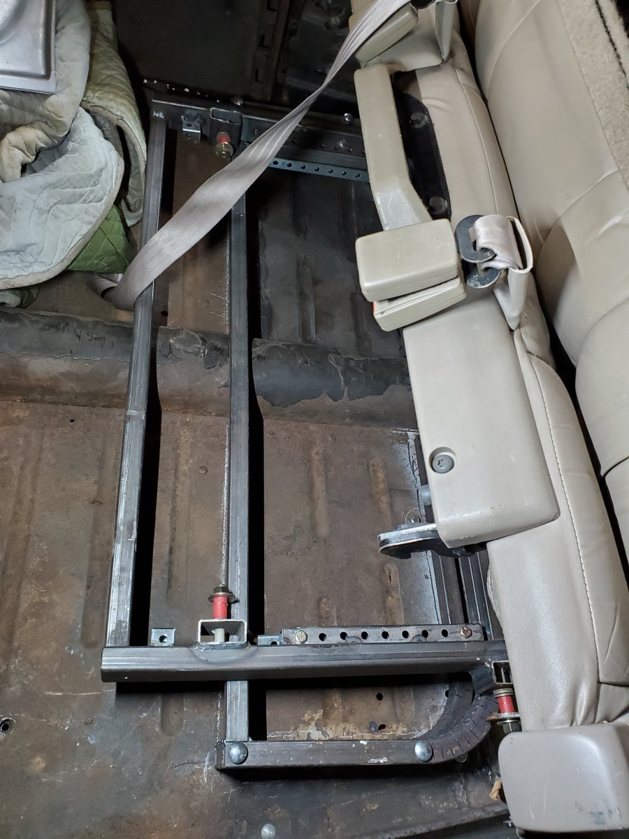

    The floors are fully welded in. Next time I'll all grind off the galvanized as it sucks to weld on. Lots of ventilation was employed. Also made my seat pedestal. Melvin insisted I bend two pieces of 1/8" plate to make mounting plates like a park bench but I wanted something with a radius I could carpet for a finished look. I used 1" square thin wall tube I had left over from the 1969 442 resurrection. I dont have a square tube mandrel for my tubing bender so I made relief cuts on the inside to create a radius I liked. I think it worked well. There's no slider to adjust the seat. I used some drilled square tubing from HD and bolts for adjustment. I'm 6'4" so I have it set back where I like it. If I ever sell it the new owner simply u-bolts the top rack , move it forward and bolt it back down.
    The seat is the 3rd row from a Suburban. Fits perfectly to me. It's got nicer cushion than the minivan seats. It fold flat and pivots forward/up for access under the seat. If the pedestal were hight it would stand straight up but now the seat touches the tunnel.

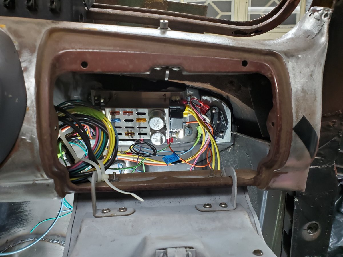

    Started installing the Ron Francis harness kit. My first time installing a complete new harness. Not too bad. For me it's the routing that requires the most effort. The runs are nice and long with is good but it was unpleasant to route, realize a mistake, remove, repeat, realize again, repeat again. Put the fuse box behind the glove box with will have a fold down back panel for access when needed. I'm trying to keep things simple are reliable so I'm running a GM ignition module after a Ford factory electronic distributor. Finally got the engine running and am please to find it is just as promised. No noises or smoking. I replaced all the gaskets and installed a new oil pump. Mounted the battery in the trunk. Once I get the dash wired and am sure all is well I'll wrap the harness. Melvin gave me a cool heater to install. He has the same one I his car except its chrome. Gotta get a new heater core as it leaks. Using stock 1948 Mercury gauges except for the AMPS which will get its movement changed out for a volt movement. I plan on converting the clock to a tach the same way. Hoping I can find an early 50's vertical radio to fit the middle of the dash then build a fascia to encompass it in with the speedo/clock.
    Continuing on my theme of mixing old and new for a/c I'm not using a normal belt driven compressor but an electric unit off a Prius or Leaf. I'll mount it in the trunk as far back as possible and upgrade to 3G alternator and second Optima battery. There will be a full partition a few inches behind the seat completely isolating the trunk area. Yeah, I know, big plans. Melvin says I dont need either heat or a/c since I won't drive it in the cold and don't harldy drive any of my antique fleet in the summer. Gonna do it anyway.
