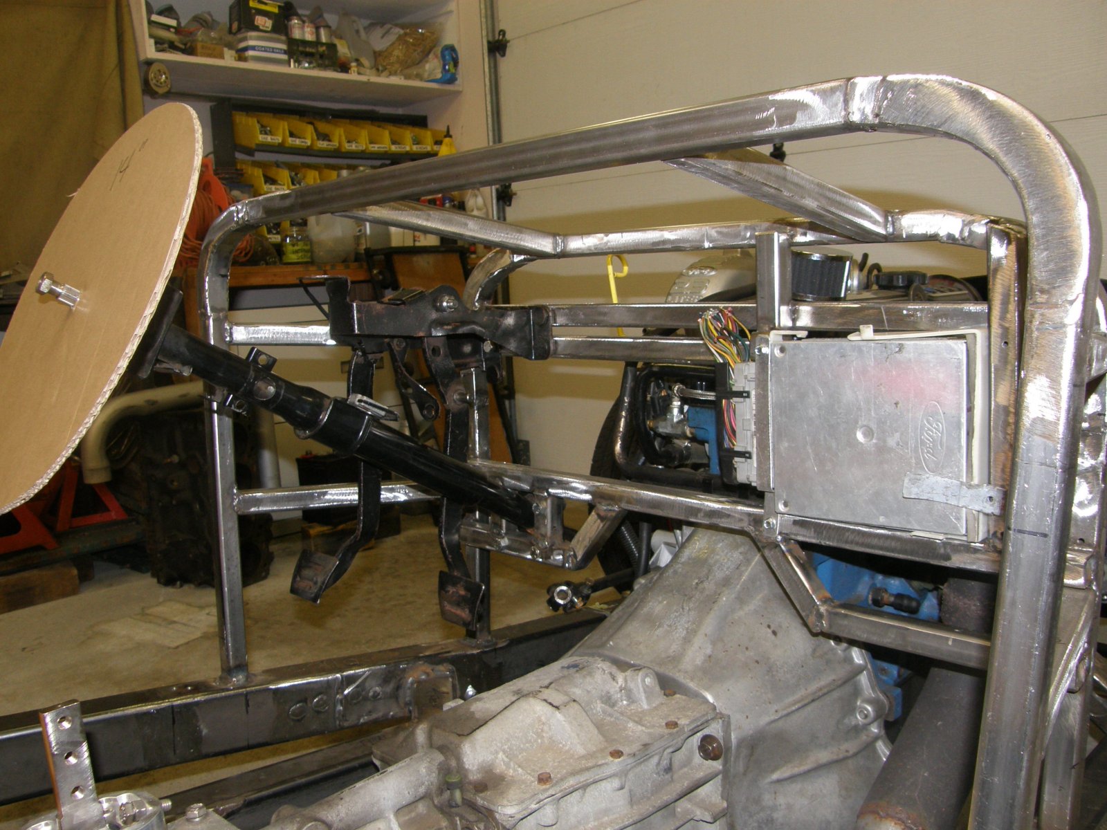

    I built a cowl cage for my roadster. 1" square tubing, 1/8" wall. Welded the 4 uprights to my 2"x3" rect tube frame then bolted the cowl to the cage with strategically placed 1/4" ****onhead bolts threaded into the square tubing.
    Just Gary likes this.

    Nice job!! I want to do the same thing and build some sort of cage in my cowl. Mostly to attach steering wheel and hang pedals. Thanks for the pic
