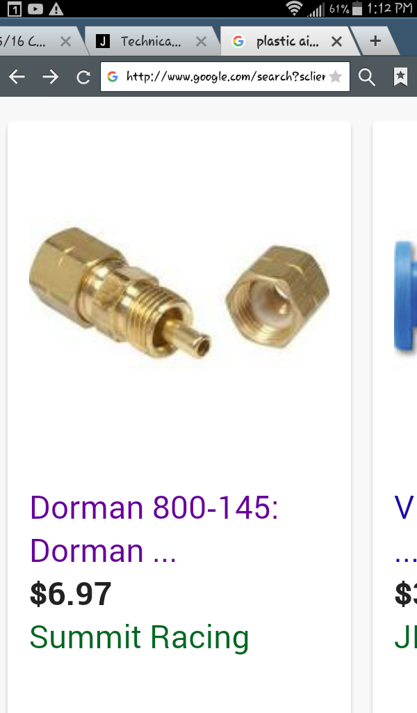

    Use copper line for this application, new ferral. When useing plastic line in a compression fitting there is a small piece of br*** that goes inside the plastic line and the ferral on the outside image:3018.png
