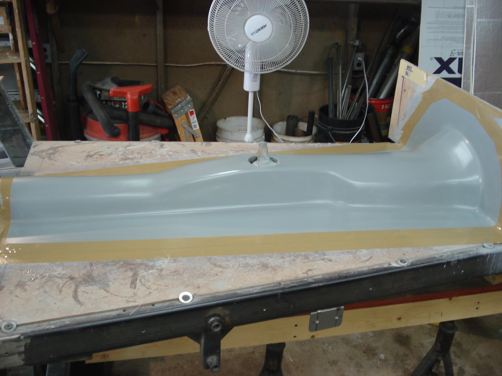

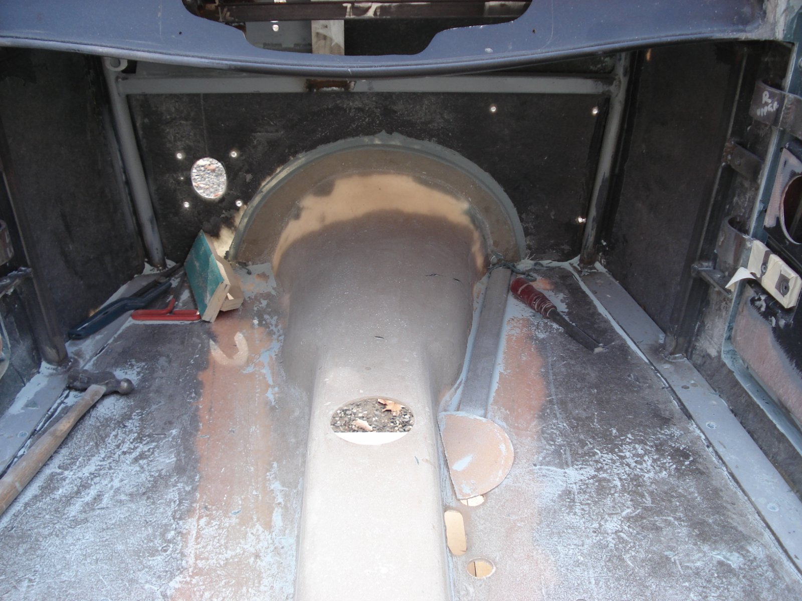

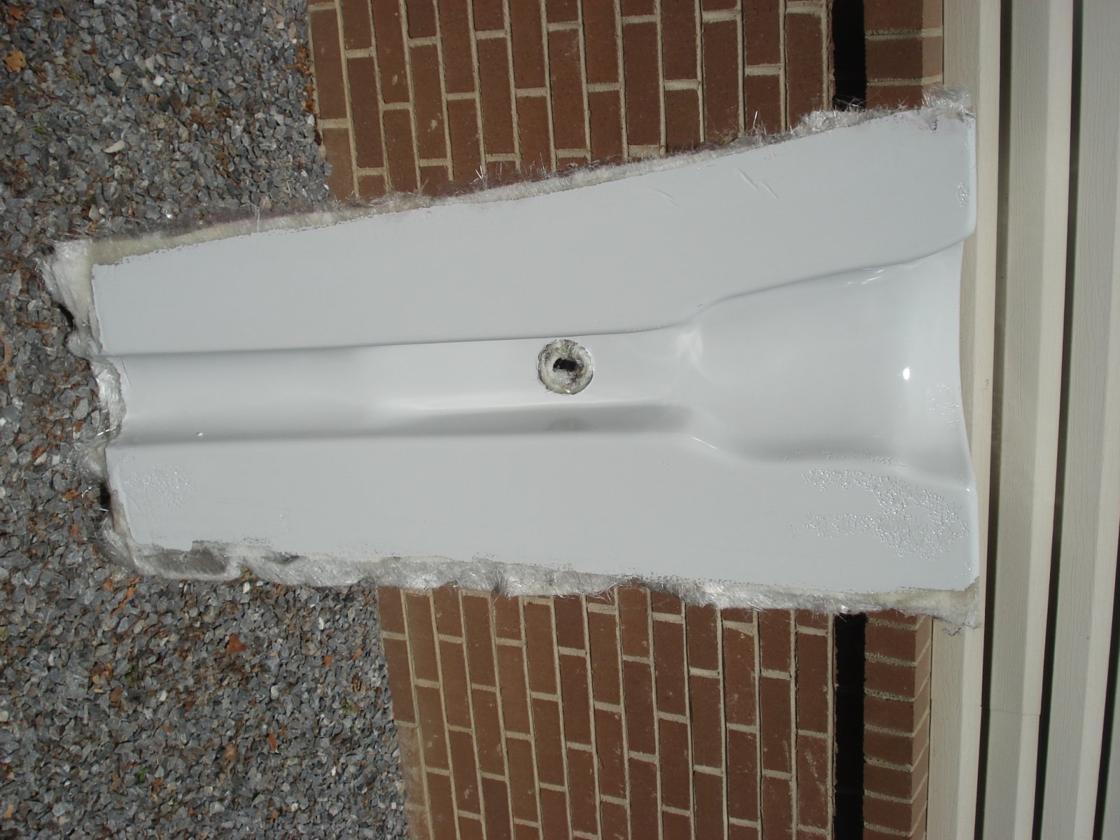

    I made my roadster fiberglas trans.tunnel. Local boat-hull shop guided me thru the process and sold me products from their inventory. Made the mold from florist foam , shaped and covered it with sheetrock compound , sanded smooth and put on multiple layers of primer. Waxed it and laid the 'glas over it ... Not cheap , and a steep learning curve ,but I did learn a bunch....and have since made a few more parts/ projects from what I learned
