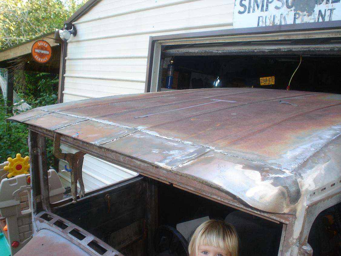

  2. I bought my car partially done, and it has a curved 2x4 cut to fit under the roof and screwed to the corner clamps and screwed down through plate above windshield
    they welded the visor on
    reinforce everything including the way henry built it
    I ramed a lot of self tapping screws in with a 3/8 air wrench and even some drywall screws through plate above windshield
    and spent hundreds of hours blending sheet metal to straight??

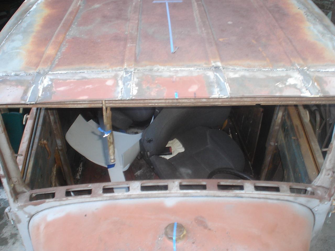

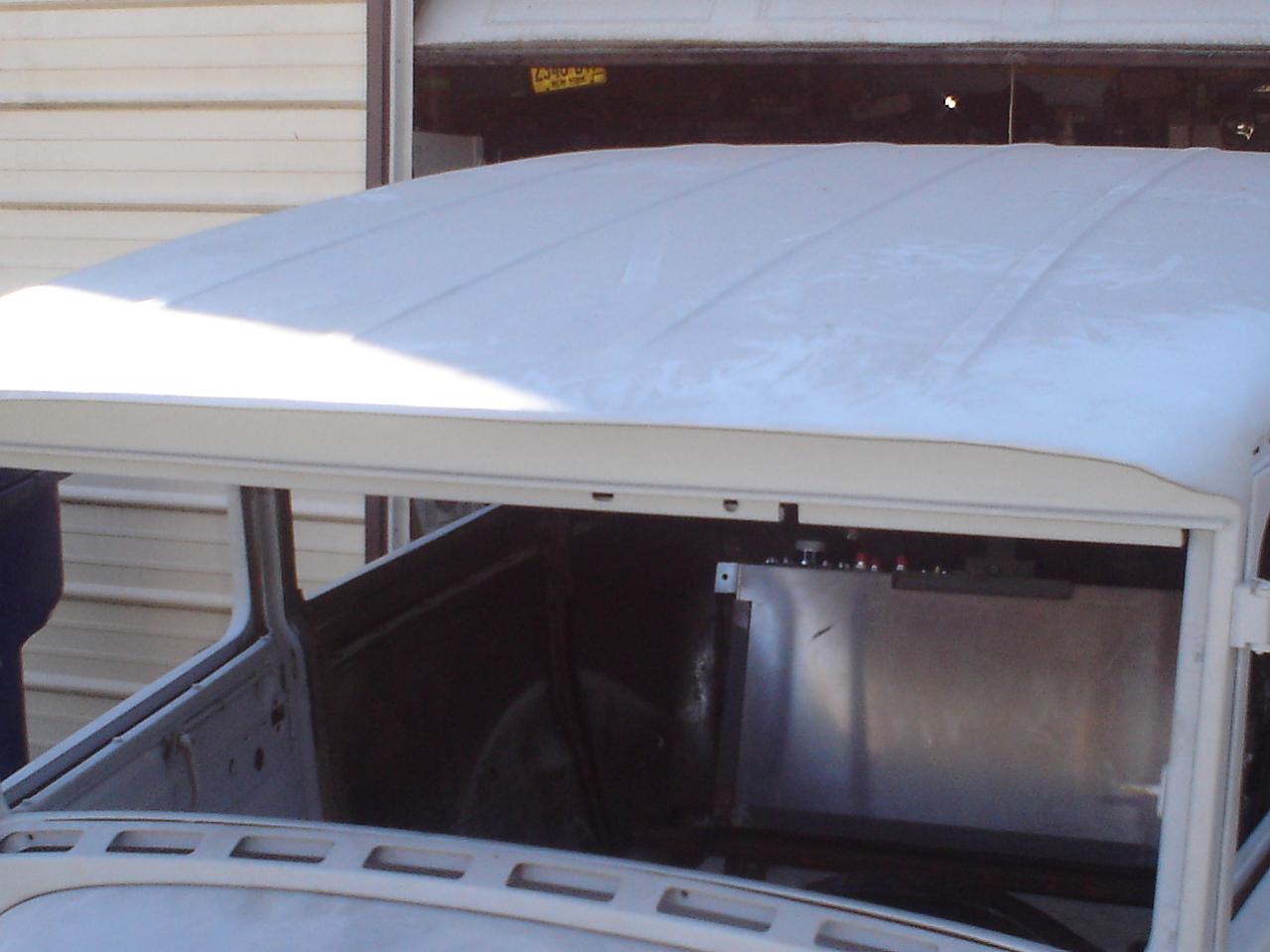

    My visor is welded on. I used a 84 astro van roof turned backwards. I tied the roof ridges into the visor with 6" long flat steel. This gave the visor strength and made the roof flow. Unlike yours I had to make a filler piece that went above the windshield and was welded to the bottom of the visor.

    Looks good motoandy I love the ribs running out to the edge of the visor.
    The visor does seem a bit flimsy.
