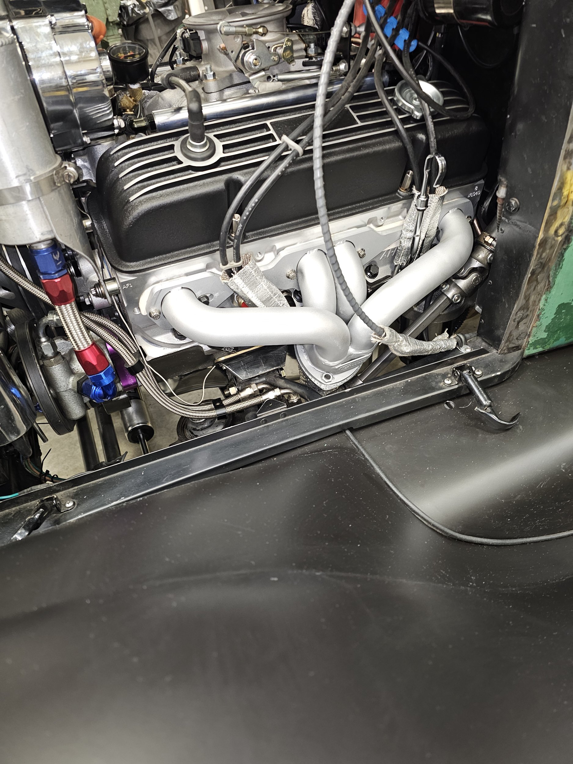

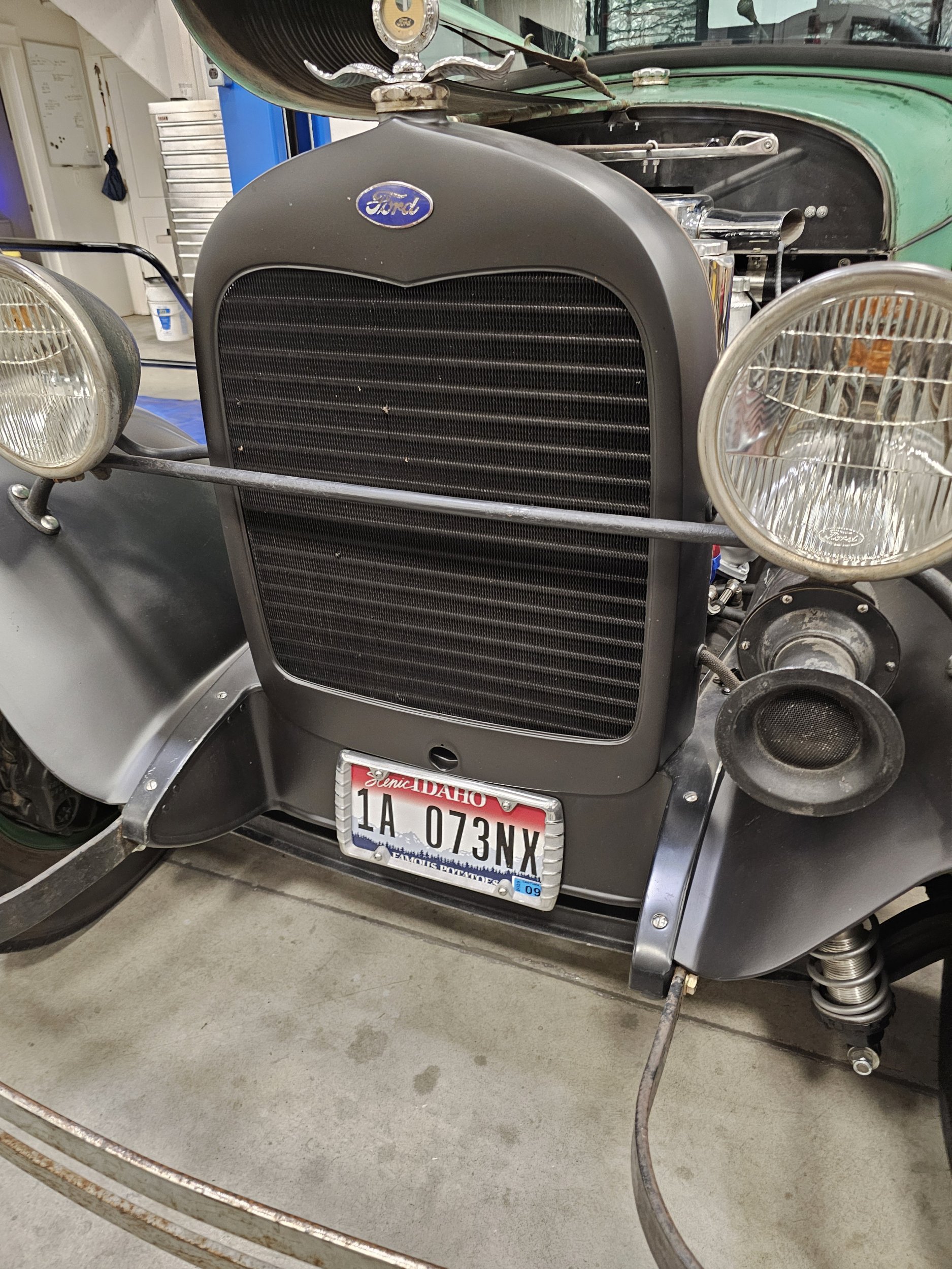

    If you had taken the picture just a little bit to the left of where you did, we could see the cooling system...more pictures?
    also, I hold my phone sideways to take pictures for things that end up being viewed mostly on computer monitors.

    And hit the “full size” ****on on the pictures

    Here are better picks.
