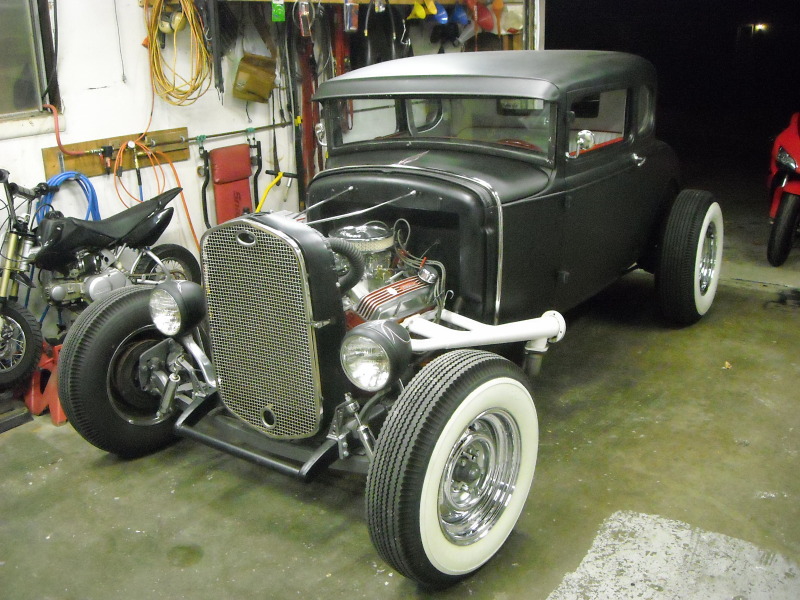

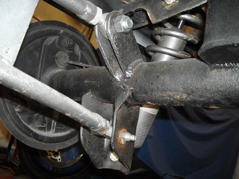

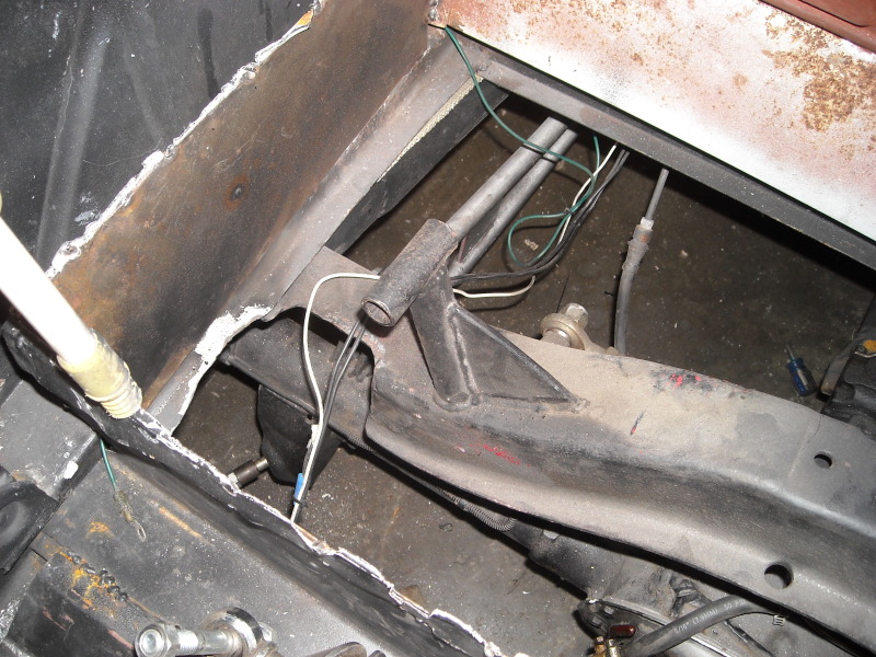

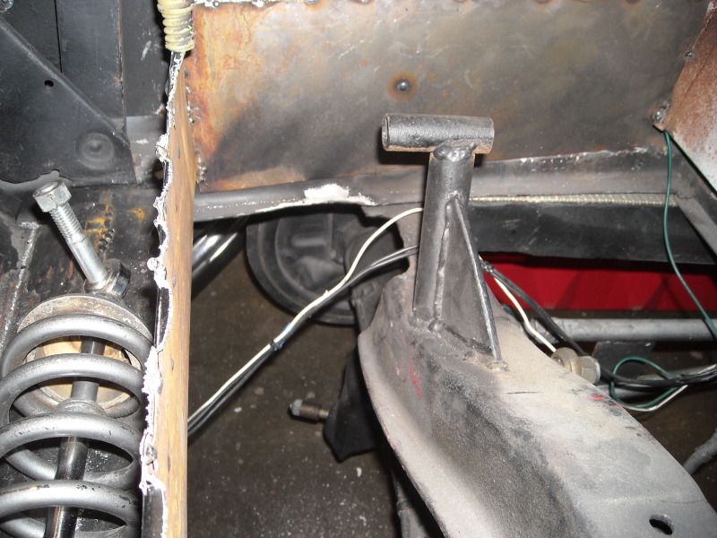

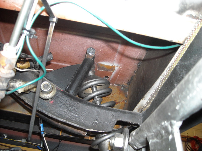

    Hey ya'll. Some may remember from my opening post (thanks for the kind words for those that replied), I recently picked up a 30 Model A. Well, the rear suspension is a total hack job, and I need advice on how to fix it quickly, cheaply, but right. The original crossmember was cut out on both sides real bad to make room for coilover shocks. A repo frame would be the best answer, but then I loose the original VIN, and I don't like the idea of cutting the frame up. The car currently have a 10 bolt chevy with homemade looking ladder bars and some cobbled up brackets.

    Ditch the crappy ladder bars, coils and cross member.
    Get a reproduction rear cross member, and a set of Pete and Jake's ladder bars, with cross member. Top it off with an Model A leaf spring and hardware, shackles and mounts.
    Classic, simple and effective.

    Having been in the repair business many years, someone wanting a fix that is quick, cheap and right brings back a flood of bad memories. If you can fabricate, the cheapest fix might be to get another stock crossmember and modify it, box it in to do the same basic function. Maybe you could move the coilover mounts on the axle too.

    Thanks for the help. I've seen my share of quick and cheap repairs, so my emphasis is on right. But I have a couple other projects going and would like to have this running with the nice weather breaks hear in Virginia. That said, I was thinking about making a square tube cross member like I saw in a web add that curves around the axle to the rear and mounting the coil-overs off of that.
