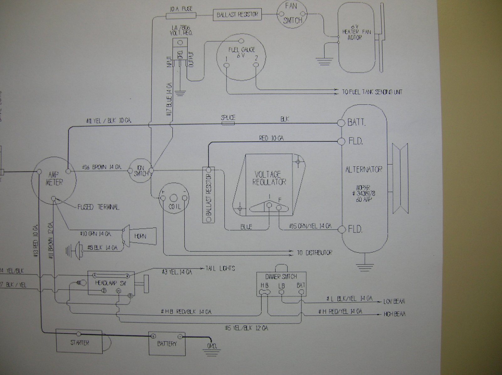

    In my sketched diagram below the amp gauge on the left shows how I wired it years ago. (I believe incorrectly). Everything worked fine, but I've recently discovered the generator, lighting, and horn circuit was not on the fused terminal of my amp gauge which it should have been. The other two terminals are not fused. The amp gauge has the fuse holder built into it. The sketch on the right is how I think it should have been wired according to the oem Mopar wiring diagram. But, it originally had a cut-out relay on a generator. I converted to 12v an added a 1970s Mopar alternator with electronic regulator which also has been working great for years. So, if I hook it up like the gauge on the right I will be running the newer charging system thru the 30amp fused circuit along with the lights and horn. Just not sure if that is a good way to go? The lead from my harness going to the amp gauge has three wires (generator wire, horn, and headlamp switch) all on one connector. I could change just the alternator wire from the fused terminal and connect it to a non fused one. If a short occurs in the lighting circuit then the alternator would not charge. I am electrically handicapped. Advice welcomed!

    I'd use a circuit breaker instead of a fuse.

    I'm sure you have considered using a voltmeter instead of the amp gage.
    Wiring is simple, just about anywhere you want, and hardly any current draw-unlike the heavy wired amp gage. An inline fuse or breaker of your choice and you're done. No potential for a "heavy" short like could happen with the amp., especially if in the dash, etc. Good luck.
    BTW, the 3 wires going to amp gage seems to be powered by the generator/alternator-horn and lights tag along for their power, tie 'em together and connect to the other side of the amp gage wire, complete circuit (series).

    I would suggest a partial rewire, avoiding the ammeter. That alternator is rated three times the output of the original generator, and the ammeter would become a welding torch instead of a gauge if you hooked it up as per factory.
    What you can do is use it as a terminus- ***uming you have the regulator wired correctly, the BAT terminal ideally needs to go to the starter lead, and from there a medium gauge wire up to the ammeter, where you connect that to the original GEN terminal, leave the BAT terminal disconnected and just power the car through the fuse as it was originally.
    That does mean the ammeter then does nothing; as said above you can replace it with a volt meter, which with an alternator is a much more useful gauge.

    Just leave the Ammeter there. [Ammeters are connected "In-series" whereas Voltmeters need to be connected "In-Parallel" to ground]
    If you've swapped out a Generator for an Alternator, you can increase the range of an Ammeter .
    To increase the range of ammeter, you need to connect a shunt resistance in parallel to the branch where the ammeter measures the current.
    The biggest issue is not the ammeter, but the wiring each side of it. This should always be upgraded anyway with an alternator conversion.
    If you kept the alternator rating to around 40 amp there would still be an improvement over a generator because alternators still charge when idling.
    The ammeter can handle a 40 amp current [without a shunt] but you should upgrade the wiring.
    The most amp load on the wiring is just after an engine starts [we rev it up and the smoke escapes:D]
    2 x 60/55 watt halogen bulbs only draw 10 amps on high beam.
    There should always be a fusible link between the Ammeter and the 12v source.

    I'm hoping to keep the original ammeter, and the 70s Mopar charging system. I've been driving my truck for many years trouble free with the 60 amp alternator completely un-fused. Just recently, after thinking about it, realized I didn't know what I was doing then. (And,still don't) :) Rather than a fusible link, I'm thinking of adding a maxi fuse in the circuit with a 40 or 50 amp fuse? My original style 6v harness uses 10 gauge wire for this circuit which I believe is ample? I think this would protect the wiring and possibly the ammeter if the alternator hit max. output for some reason. Am I making any sense?

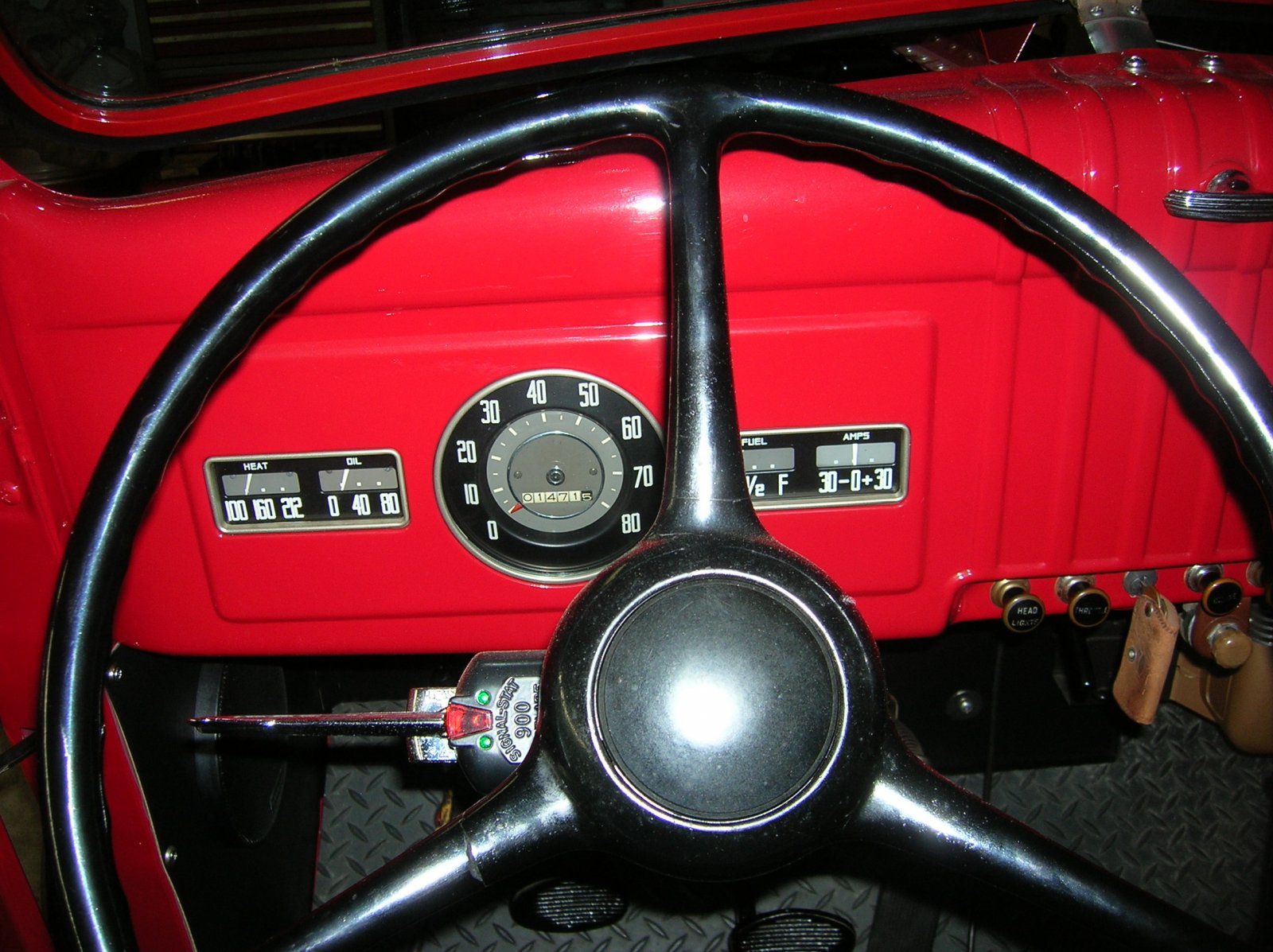

    Are you sure the ammeter didn't have a resister on the back instead of a fuse?
  22. Steve Lowe
    Joined: Nov 8, 2019
    Posts: 74
    Steve Lowe

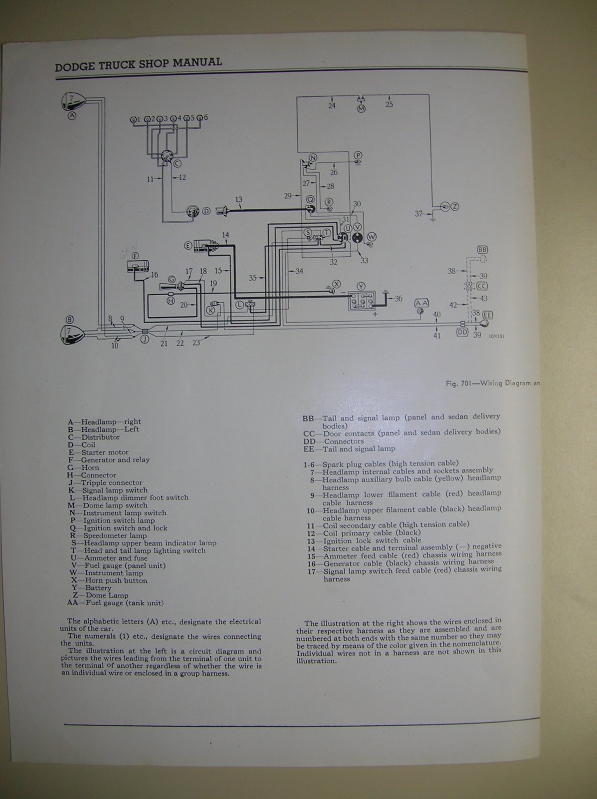

    No resistor. My ammeter has 3 terminals. Only one of the terminals is fused (lower terminal in photos) originally with a 20A fuse. Only the lights and horn were attached to that terminal. A short anywhere in the lighting circuit would kill all the lights. In fact, that was the only fuse on the entire electrical system on my year truck.

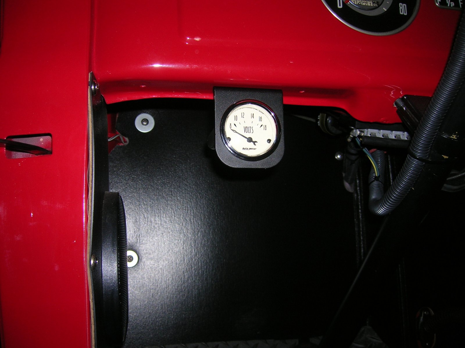

    Do your self a favor, use a Volt meter.
    They are available in wings series .
