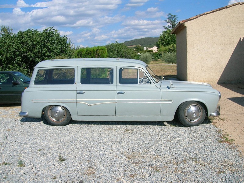

    Here is a simple way to do it without a lot of metal work. Cut the roof off just above the drip rail and make a new roof with 1" wide 1/8" thick strips of flat steel.
    Make 1 strip every foot or so, across the roof like headliner bows. They will have to be different lengths to make a nice curve front to rear. But you can cut a form out of a 2X6 to bend them over.
    When you have a nice shape add long strips front to rear to make a basket effect. Weld together, this is your roof support.
    Cover with expanded metal, then thin cloth, cotton padding and another layer of cloth. Adjust the padding by poking it around with long needles until you get the shape right.
    Now cover with a vinyl top or sailcloth.
    This is basically the way a Carson top is made. You could make any shape you want with minimal metal working skills just bending and welding on the bows. Then cutting and tack welding expanded mesh.

    the subtle look is exactly what i'm looking for . I don't want my roof to look flat at all ;)
    here is the photoshop i did : hard to figure it is chopped and decrowned :rolleyes:
    but it is :D i decided to keep it in 4 doors to fool even more ;)
    the chop is almost done... uh at least tacked:eek:. It's my first one , and i wanted to be sure everything is ok before welding it ;) on the pics the back door is not done, but i did it yesterday ;)
    it is chopped just 4 cm. not legal , you're right, but i think it's a matter of how cool are the cops, and they re cool when you're driving an antique, custom or stock .
    And noiw the best part : you've talked about late 50's simca side trim ? well it's the plan ! :D 59 Montlhery side trim with the front part replaced by another set from rear fenders to keep it straight ! i did a photoshop of it too
    on a Simca Montlhery, there is a brushed steel part inside the trim, but i will use it to two tone it . I ve got a NOS set a real good friend find for me ... very rare :eek:
    as for the grille, i'm not a big fan of bumper guards used as teeth... they look what they are :( you seems to know your french cars so i can tell you my plan. i will rework the front with a mouth and grill from a renault fregate, the one with the oval mouth, and vertical grill bar. the horizontal bar will be removed. i will use frenched simca versailles headlights rims, and 54-55 aronde tailites .
    Thanks for the words on my ex-sedan ;) i'm not fan of the look of the roof and overall proportions, but at that time i was afraid of chopping a roof... now i'm not :rolleyes: she will probably be next:D

    I took only 4 cm ! It is supposed to be very subtle :D the decrowning is going to be very subtle too , i don't want a flat top . The idea of that car is to improve the original lines, but not being noticed by the average looker :D
