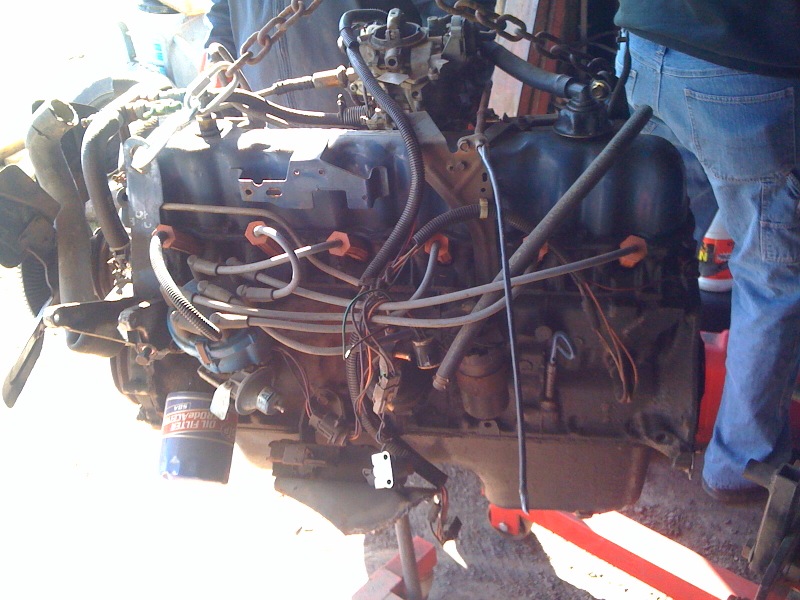

    My new 200 is gonna have to lose the 1981 model year distributor because I am taking off all the electronic, a/c, and emmissions stuff. I am having a hell of a time trying to find a points one. I thought that one from my 170 might fit, but looks like no.
    I need a source that may carry what I need.... it's a 1981 Ford 200 out of a T-Bird.

    It actually has pig tail wiring for a computer hook up. My car doesn't have a computer.

    The '80-81 200s had, to my recollection, eleven zillion thermo-vacuum switches and an absolute nightmare of vacuum, smog, etc. hoses, but no computer, and the distributor was a nice Duraspark. Oh, and a catalyst the size of a 2lb can of coffee that bolted directly to the manifold. The mid '70s in which this stuff was cooked up was pretty much the muddy bottom of Detroit's engineering slough of despond. The good news is that the late 200s have 4/6 of a 6-bolt SBF bellhousing pattern.
    I've got one sitting in parts around here, from a project a friend abandoned (well, didn't really abandon, just decided to use a 302 instead), not sure what I'm ever going to do with it...I always figured that horrid cat manifold would be a good place to mount a little turbo for a quick-n-dirty power boost. Treat it like a 2-liter four because that's about what it's got the airflow capacity of, unless you do a whole lot of headwork.

    all that junk is easily removed. most of it actually doesn't DO anything anymore anyway.... it didn't DO much when it was NEW. in the '70's and '80's everybody was trying every trick in the book to keep emissions AND costs down on every unit sold.... a lot of it just didn't WORK outside the lab. some of it made certain engines so unreliable that they forever carry the stain...... not really the fault of the engine, just the operating system.
    case in point: Ford's Variable Venturi Carburetor. worked like a miracle when it was clean, properly fed vacuum, and given good fuel.... but let that sonofabitch get dirty or lose vacuum........
    so clean off that 200 and backdate it with sixties hard parts.
